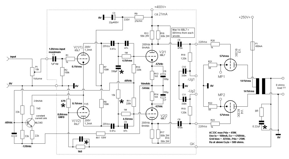

6C33C-B. PP or SE ?
Thanks.
Bellow is my diagram.
The RC values with * need to be chosen by experiment for best stability with pure C load and for high frequency bandwith = 65khz with pure R load.
Output transformer should be 1kohms a-a:4-8-16 ohms for 60W into AB and 2kohms a-a:4-8-16 ohms for 40W mainly class A.
It also will be possible 6CG7 or 6dj8 for input stage follow by EL84 and 6C33.
This design will be tempted to do.I also have a schetch.
