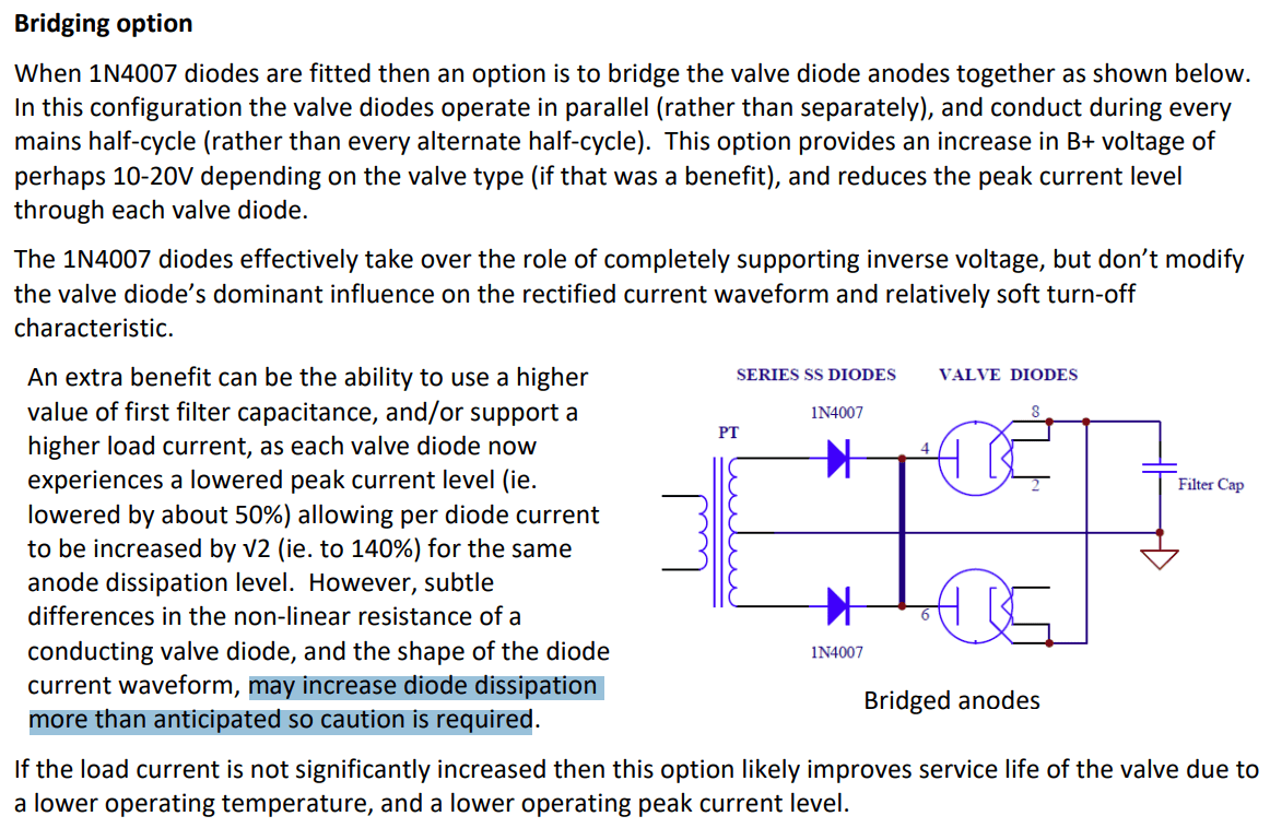

I totally missed that link. Sorry. So to be clear, we are talking about this SS-tube hybrid "bridging" option (diagram below)? Increasing rectifier tube life? Plus being able to use a 10uF first cap instead of the smallish specified 5uF too? Not sure I understand the highlighted warning - something like the heavy duty (3A) 1N5408 instead to be on the safe side with the diodes?
My suggestion was related to the relatively low current capability of a 5U4C given the likely load current. So it may be a way to still use the 5U4C and keep within tube ratings.
The caution comment relates to having a cursory view that this configuration gets you a 140% rating increase.
Seems like 1N5408 (3A) ought to more than do it. Those are big.

Up to 140% doesn't equal 'double'.Do I have this straight?
- Solid state diodes and the bridged configuration double the rated current capability for the 5Ц4С rectifier tube.
Thanks. Up to 171 mA then, not doubled.

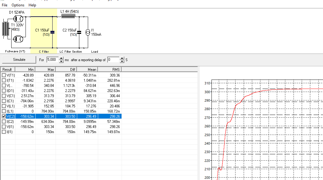

What am I doing wrong in PSUdesigner? Learning all of this is very confusing (for me).
power transformer 320-0-320 VAC with no load
power transformer primary 21 Ohms
power transformer secondary 48 Ohms per half
4H choke 54 Ohms
5Ц4С is equivalent to 5Z4 so I used 5Z4 in PSUdesigner

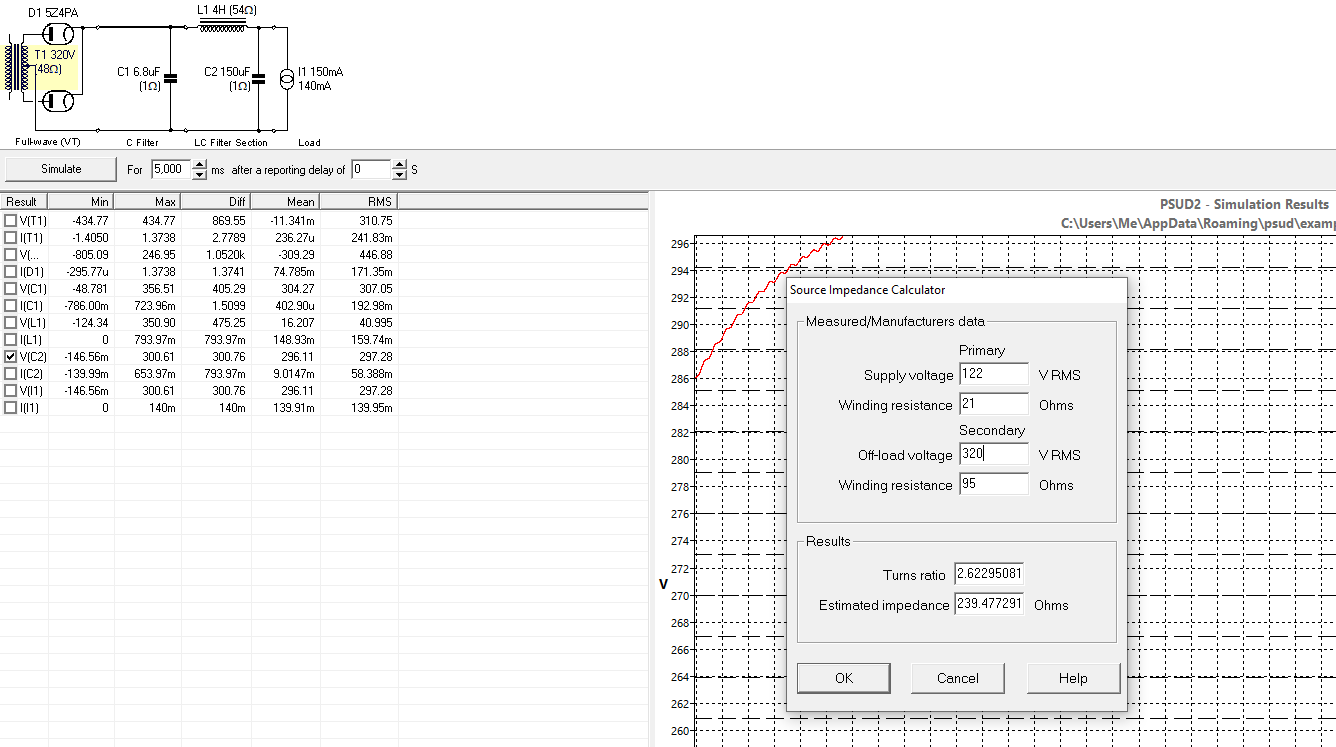

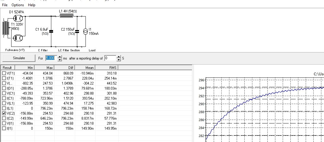

Even if I put two 150uF in PSUdesigner, I'm still not getting what I would expect, even though it's a 110V transformer being fed 122V. Schematic shows 310 volts and I only get 303 volts in PSUdesigner. If I put in a 6.8uF for the first capacitor to get closer to where we are supposed to be for the rectifier tube, I only get 294 volts. A "reasonable" target is 350-400V, correct?

The transformer has a calculator for effective secondary resistance - fill that out to get the appropriate effective resistance.
If you aren't using the identified rectifier tube for its model then expect some 'tolerance'.

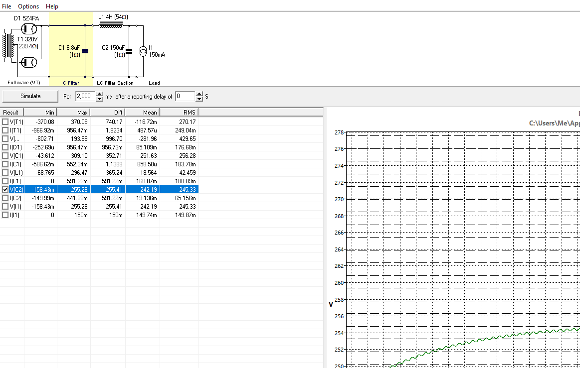

The 5Z4 rectifier tube in PSUdesigner is the Chinese copy of the 5Ц4С. I did try the included transformer calculator as shown below, and unless I am using it incorrectly, I get 255 volts with a 6.8 uF capacitor. I must be doing something wrong.
