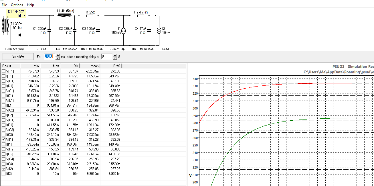

Unfortunately, if I am doing this right in PSUdesigner, it looks like we will be 50 to 100 volts below ideal if using the 5Ц4С, with only about 295 volts using a 6.8uF cap (4uF is specified). I was astonished at this result, and I find it hard to believe this isn't user error on my part. If someone can explain how and why it is so low, please do.
If this is correct, I see two possible solutions to get more voltage out of this power supply, with one being a different rectifier tube, and another less expensive way being solid state. My understanding is that 295 volts might work, but is too low for anything approaching ideal performance for the EL34.

Is this my other best option vs. switching to a 5AR4 or some other tube rectifier? I have all of these parts on hand, so zero expense. About 385 volts if I have done it correctly. A CL-90 would shave off another 2-3 volts I suppose.

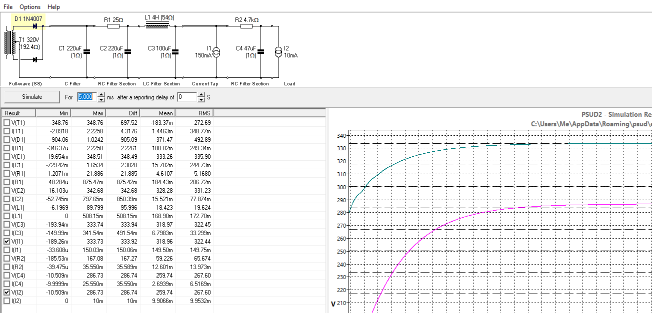

Use the PSUD2 calculator to determine the secondary effective resistance - you show 48 ohm, but I get 192 ohm when I use the calculator.
5AR4 may get you close to 350V, but note that the effective resistance of the power transformer is the most influential limiter of your output voltage, as a 5AR4 would be working well within its peak current limits.

Post #100 shows the calculator - bring that up again and input the same values but use 48 and not 95 for the secondary winding resistance.
And that is where I went wrong. Now I know. Thanks!

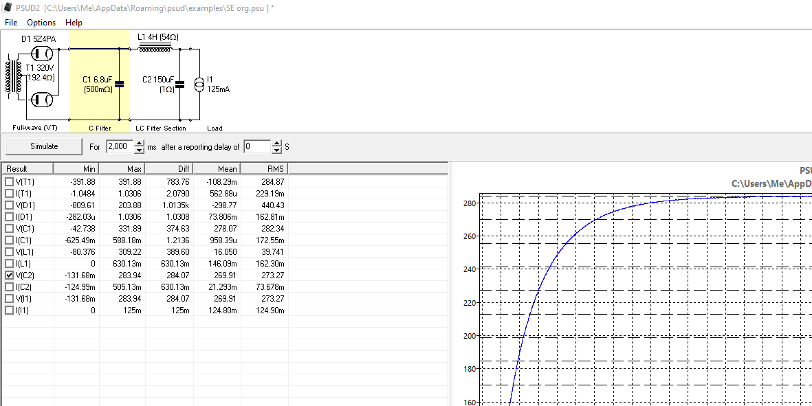

With the correct rectifier tube (included with the kit), 125mA draw, and 192 ohm transformer, I get just over 280V. Theoretically we might get the 310V specified on the schematic, but I'm ready to abandon the power supply shown on the schematic. I can do whatever I want since it will be point-to-point wired, and I am discarding all of the parts that came with the kit anyway, keeping chassis and transformers of course. I may still get bigger output transformers form China, especially if an impedence over 3.5k is indicated.

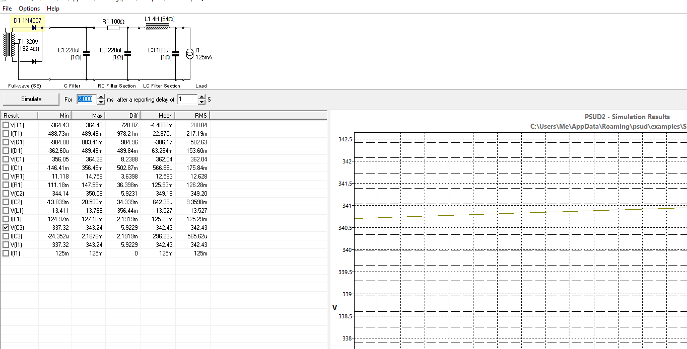

Solid state has the advantage of no out of pocket cost since I have everything on hand. Advantage: solid state. I can do CRCLC or CLCRC, but it seems that the power transformer and choke would be happier with the CRCLC option. The power dissipated by a 100 Ohm resistor looks like about 2.5 watts. I can live with the power dissipation. I could use 50 ohm I guess.

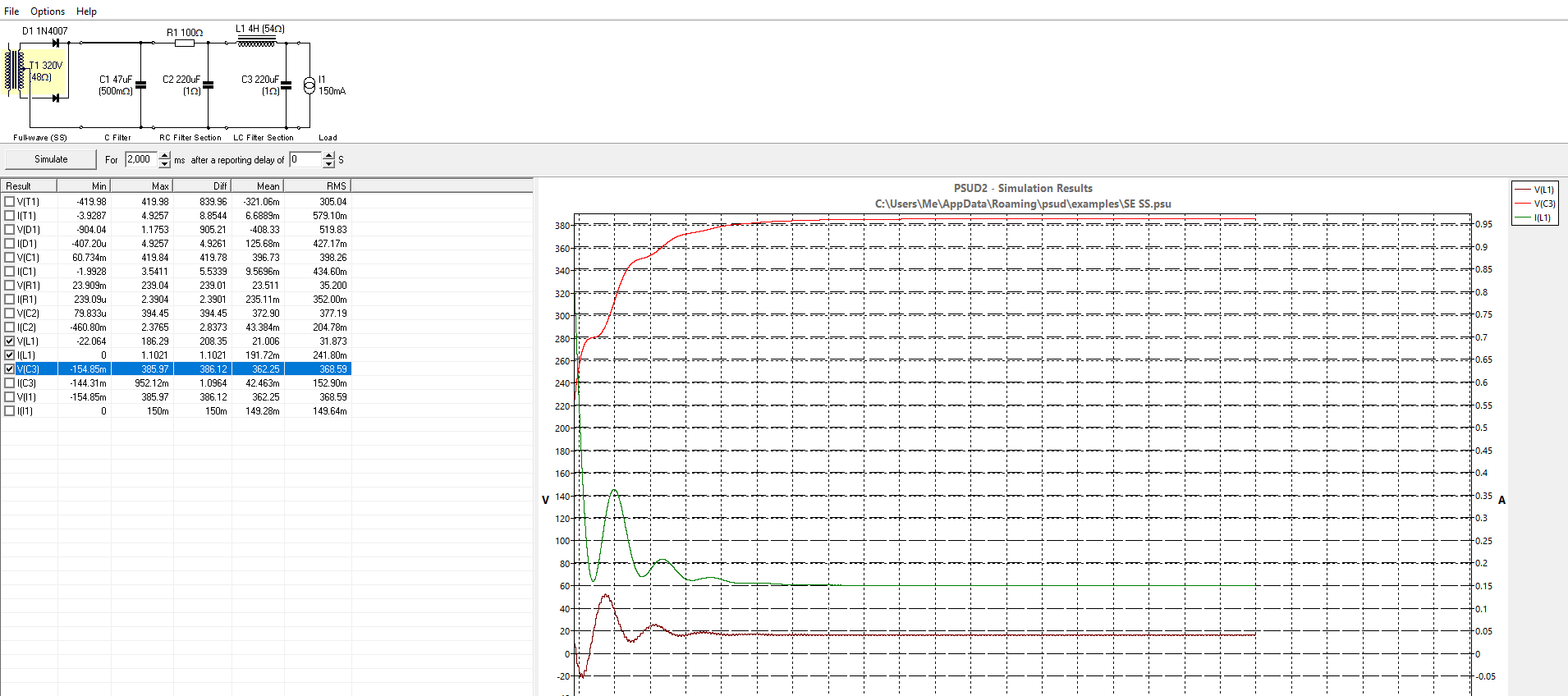

I don't think I am going to use tube rectification. I went in that direction in the middle of this thread, but when I went down that path, I didn't like the voltage drop. Thus, the solid state circuit option instead. Somebody told me to put the L in front of the R to make it CLCRC. I have no idea why. I have larger diodes on hand, 3 amps I think, and the caps on hand as well as the choke. I need to power a stereo single-ended amplifier, so one EL34 per channel at dissipation up to 90% if possible, plus the 6H8C driver tubes, one per channel. The transformer winding for the rectifier tube would go unused, which should make a relatively weak Chinese power transformer happier. It's large, but who knows how efficient it is.
I think earlier someone said that anywhere between 300 and 400 volts should be fine, with 350 a nice number. This one should be roughly 335 volts, so within that range. If it's a little more or a little less when built, still within range.

The choke 'works' better with some ripple voltage across it (ie. after the first filter cap), rather than further along where the ripple voltage would be lower.
