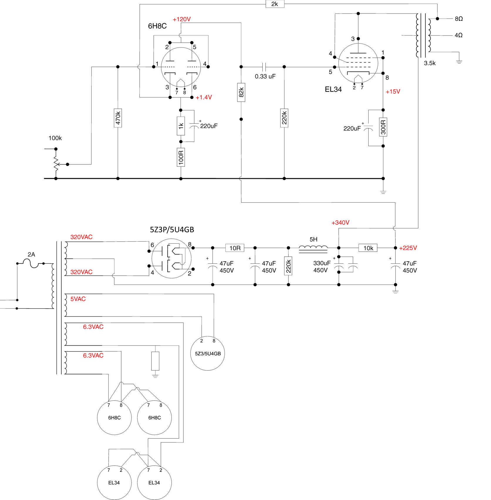

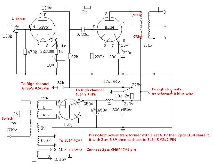

The original schematic and parts list has not been linked to,
It's hard to tell which truly is the original design, but I think it is the more complicated diagram attached to this post, named "old." It would be "normal procedure" to copy it and then try to reduce the parts count to lower the price as time went on. I don't think the values possibly can be correct though.
The simpler diagram attached to this post, named "new," appears to be a later version. It is not the schematic for my kit. Mine is the corrupted version that has two 150uF caps in the PS, which is almost universally the case now, whether kit or pre-built.

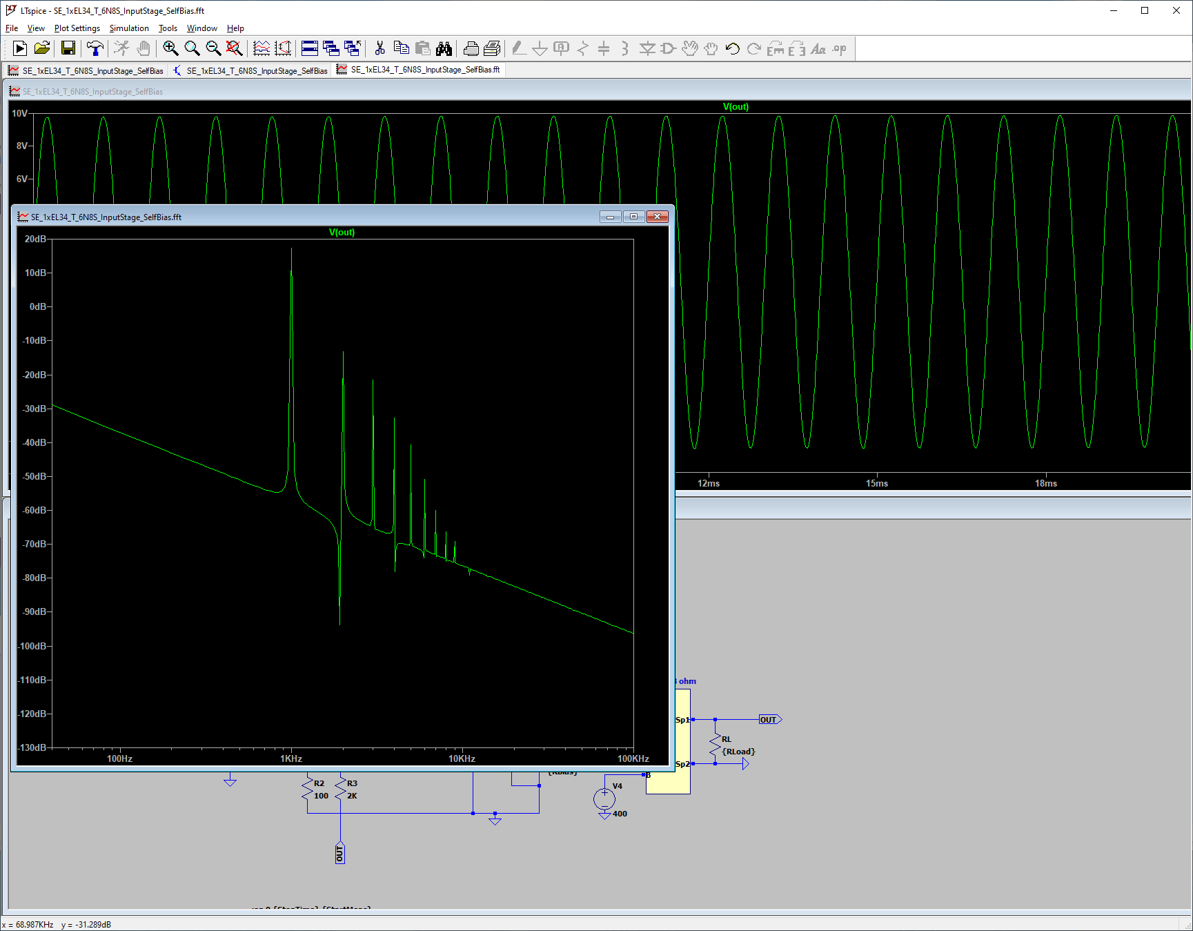

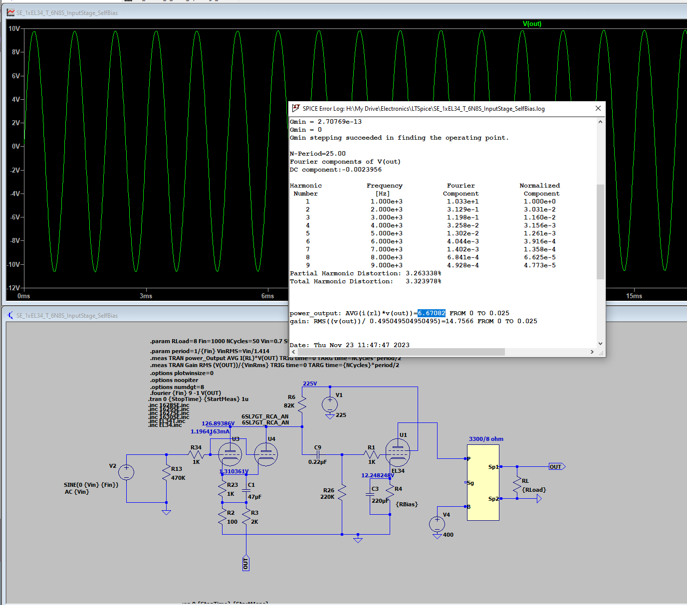

"Old" schematic's voltages are all wrong. No way you are going to get 15V in the cathode with a triode-strapped EL34, a 300ohms resistor and 340V B+. Based on triode curves it should be around 20~22V. The 10K resistor shows a drop of 115V, meaning 11.5mA. The paralleled 6N8S results in a 2.4mA over the 82K resistor. Basically that is all rubbish, the 6H8C biasing resembles the one for a 6H9C or 12AX7.
"New schematic: Reasonable voltages, but in pentode mode the biasing is too cold, 14W tube dissipation, it runs out of current very quickly, distortion is very high. I simulated it, increased B+ to 400V and reduced the cathode resistor to 220 ohms to bias the EL34 hotter, it works, distortion is a bit high though (this is, as usual, simulation. Your result may be different)

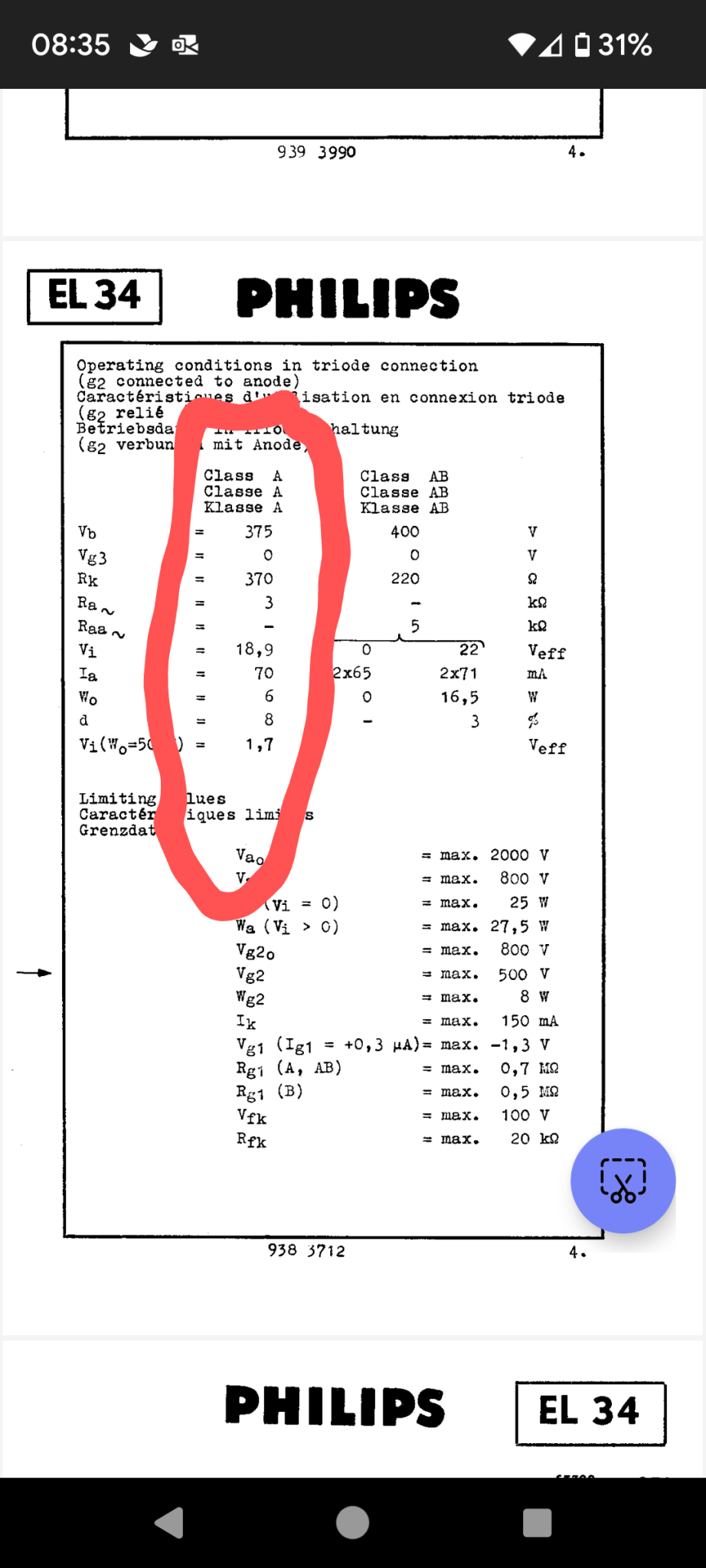

Using Philips recommendations, triode strapped, 375V B+, 370 ohms bias (24W total dissipation), 6H9C as first stage gives a decent result.

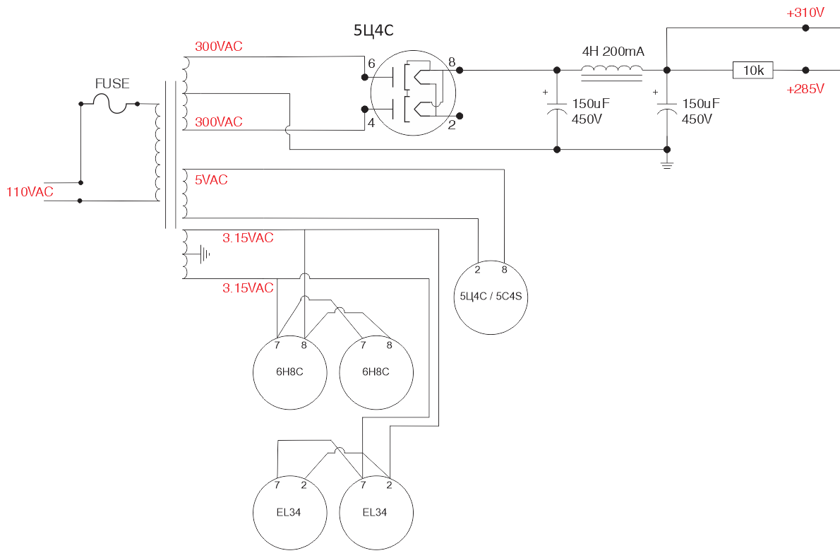

What is the solution to this problem without adding a whole lot of complexity to the power supply?
1) I want to replace the Russian 5Ц4С with solid state rectification in this power supply, and I don't want to jack up the voltage. The voltage drop across the rectifier tube is about 45 volts, correct? How do I get rid of the excess voltage from solid state rectification without harming the power supply performance and preferably improving it? If I can use solid state and get a performance improvement at the same time, great!
2) I also need to drop a little more voltage because the transformer is rated for 110V and I have 120V from the wall. It's a single-ended, 6H8C - EL34 amplifier, and I don't know what the current draw for that might be. The choke is rated at 200mA. Specifications call for 310V and 285V out as shown. Wall voltage is 120VAC going into a transformer designed for 110VAC.
3) If I decide to use tube rectification, what is the expected lifespan in hours for a longer life replacement tube, and which tube type to use? 5Ц4С is rated only 500 hours. I really want the convenience of solid state like my other three tube amps. Only 500 hours is a real pain, and the cost adds up as I put a lot of hours on my system.
I can make simple changes, as the amplifier hasn't been built yet, but I do not want to add a whole lot of complexity to this schematic. There has to be some reasonable solution.

I've actually worked with this rectifier tube quite a bit and it's actually quite good if you obey the first capacitor limits. Replace that first oversize 150uf with a 22uf, leave everything else just like is shown above, and it will work just fine. The reports of short life for that tube are in amps like this, with a giant first cap. These designed in China amps are famous for doing this! Note the data sheet even says 5uf is the limit. I've found you can fudge this a bit, up to 22uf, if you aren't running the tube at it's max current rating.
If you then find that rectifier tube has a short life after doing this change and you actually like the way these cheap amp sounds (I doubt it's gonna sound world class, likely has super cheap output transformers) then look at a more robust solution. Again, I've worked on a bunch of amps using this tube and that "service life of at least 500 hours" doesn't reflect how long these last if used correctly. It will likely outlast the output tubes wired as I suggest.
Going directly to SS takes a couple of things off the table. The tube rectifier isn't going to introduce switching noise that SS diodes can introduce and also provides a slow ramp up of the B+ high voltage. Plus to implement what I am suggesting will cost you one 22uf cap...

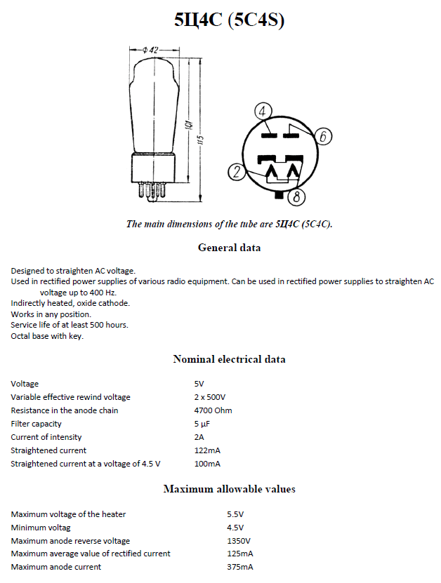

posted datasheet "Filter capacity 5uf"
Yes, post #1. I translated it from Russian by running OCR on it and then using online translators.

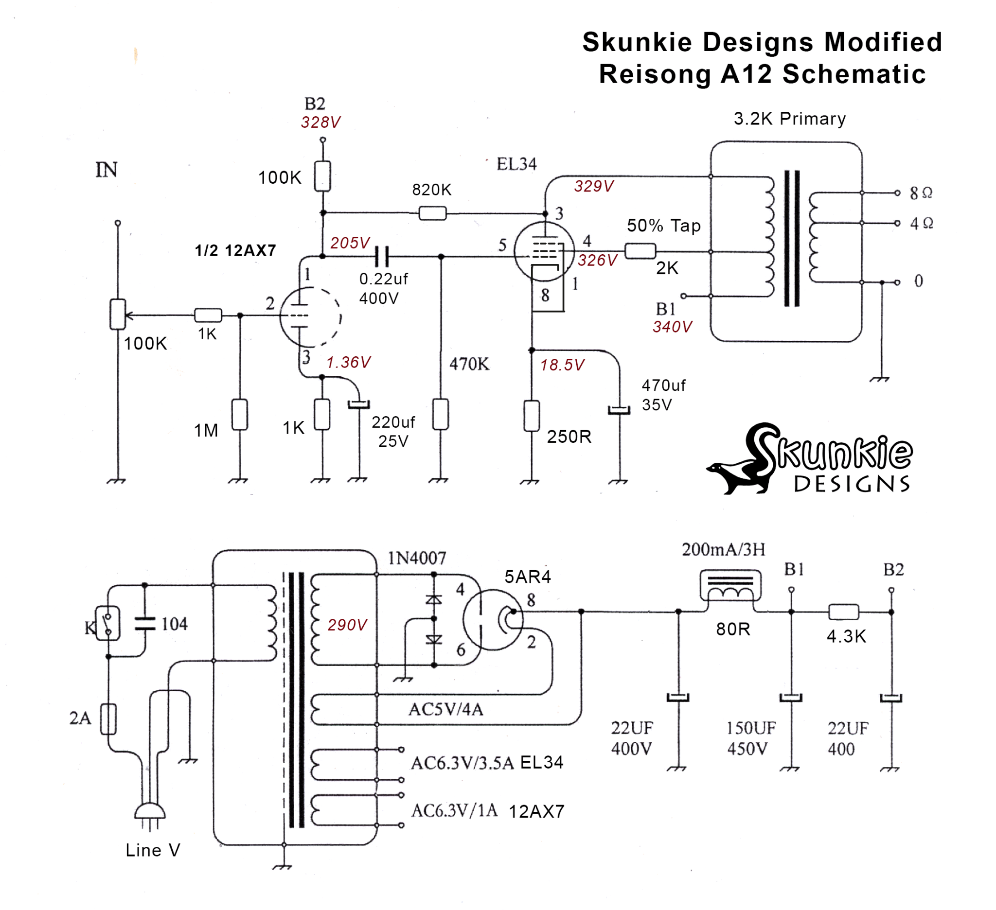

340-350V B+ should work OK, you might try lowering the cathode resistor to 250ohms later? Build it and measure the cathode voltage you see on the actual amp, I've learned what is expected based of data sheets doesn't always = reality on the actual amp. For an SE amp, I like seeing 85-90% of the tubes dissipation limits. And we don't know what the primary impedance of your OT is do we? That would tell us more about where the voltage across the tube should be.
Attached is where I ended up with the little Reisong A12 to get it sounding good and making decent power. It used UL transformers and you are running this as a pentode with GNFB so might have to adjust for that. And God forbid, I used plate to plate Schade feedback in my mod. I'm sure I will get burned at the stake for doing that!
