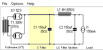

Going solid state and choke input as suggested by @trobbins seems to do the job, but I do not know the transformer and choke DCR though.
I haven't put anything into PSU designer yet. Maybe later today. I looked online for "representative" DCR for the transformer and choke. I don't need exact values right now, just a ballpark. So I came up with this:
example: Hammond 272FX power transformer DCR = 2.619 Ohms
example: Hammond 159S 4H choke DCR = 65 Ohms
target voltage = 315VDC
From a post above: Calculate using 150mA to keep some safety margins
  • When I posted this yesterday, I had no idea what a "choke input" power supply was. That's one of the purposes of this exercise - for me to learn. I am trying to learn power supply design basics. I looked around online, and it seems that choke input was popular at one time. Why not now? Is the choke in danger of overheating or anything like that?
  • In post #16, why use the 4.7uF capacitor in the CLC configuration? Why not leave it out, and why choose the value of 4.7uF? In my previous build of the Huaji Audio kit, many people suggested reducing the cap in that position to lower the output voltage. I never have understood why that is the case (smaller cap = lower voltage output) or what the disadvantages of that approach might be.
  • Is 315V correct for this schematic? Should it be lower or higher?

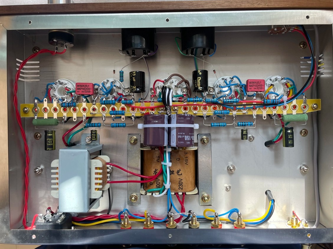

I have obtained this photo of the inside of one that is sold already built. Sure enough, they do have it wired as in the schematic, and the transformer is marked 230 (115) VAC and 300V. It makes no sense to me as it seems that the rectifier tube would blow very frequently, like every 100-300 hours. I am left scratching my head on this one because the amplifier has been on the market for a long time. Perhaps rectifier tubes are so cheap in China that they just replace them constantly.

Opening PSUdesigner now ...

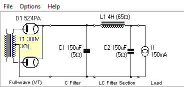

I found online that the American "equivalent" to 5Ц4С supposedly is the 5Z4, and I see a 5Z4-PA in PSUdesigner.
DCR of 2.619 Ohms? That can't be right? This arrangement in PSUdesigner produces a failure warning. I assume that I have it set up correctly as shown.
I figured there must be other people with different variants of this amplifier, and I finally found a long thread. https://audiokarma.org/forums/index...nd-rectifier-tube.848552/page-6#post-14377594
It seems that it's common to put two 150uF caps in the PS with the 5Ц4С, causing it to blow frequently. 5Ц4С appears to be only a $5-10 tube, so maybe they just plan to replace it every year, or in my case every few months. I'll read that whole long thread as it seems to have a lot of suggestions.
Yes. As others have said, 150uF is way too much for HV rectifiers with a 10Watt filament, or for any gas filled rectifier (Mercury vapor, etc.). The issue is that current peaks exhaust the space charge, then try to strip cathode coating surface layer. Modern HV rectifiers are crap on a crust (for some unknown reason - why is it so hard to make rectifier diodes? - makes no sense), and need to be babied even more.
