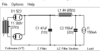

Apparently someone with no knowledge has changed the schematic a few times over the years. The original design I found called for a 5Z3P tube not 5U4C, a 47uF cap not 150uF, and finally a 150uF (or 330uF) cap. That produces 298V in PSUdesigner, if I have done it correctly, close to the 310V specified. However, 47uF is still higher than the 32uF max recommended.
A later version shows a more complicated design like this. It appears to show that they acknowledged the output of the transformer would be about 320V instead of 300V when running on 120VAC instead of 110VAC, inserting 10R to get rid of some voltage? The other values shown don't work though, so something went wrong.
If I can figure out what the tube rectifier circuit is supposed to be, then I can move on to imitating it with diodes. I think maybe the bottom one of the two designs above is the intended physical layout to run on 120VAC but with the wrong values.

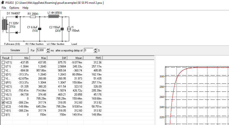

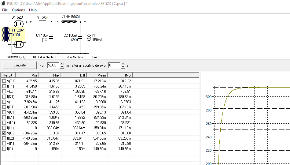

So why not just do one of these two options? Wouldn't either one work? Problems with each one? I stuck a 25 Ohm in with the 5Z3 to get rid of a few extra volts. Not sure how many watts would be dissipated by the 200 Ohms in the solid state option. Am I in the ballpark with either option?

Solid state rectifiers are a way better choice, and there is another way to fix the over-voltage situation: place one or more zener diodes where the 200 Ohm resistor (R1) is. You can drop about any voltage to like as long as you get the power dissipation right.Stephe said in another thread to use 5Ц4С with 4.7uF and 150uF, and a 12V bucking transformer, plus add a bleeder resistor for saftey. Great, BUT the bucking transformer is a real PITA if it can't be located inside the chassis, and I don't know the dimensions yet.
A valve rectifier has datasheet limits on the peak current during operation. The datasheet in post #1 indicates that is 350mA for the 5U4C. In your 5Z3 PSUD2 sim, the continuous peak is circa 550mApk, with a transient hot-start peak of circa 1.5Apk. 5Z3 datasheet indicates a 675mApk rating, but no rating for transient level (although that can sort of be deduced but is arduous).
Note that the 5U4C is likely operating within spec when the input cap value is 2uF and supply resistance is only the 37 ohm (ie. no added 25 ohm). It will depend a lot on the power transformer effective resistance, which you don't know yet, so it isn't appropriate imho to malign the use of the 5U4C if the total B+ current is not above 125mA, which may be reasonable even for a stereo configuration as the schematic shows 2.5mA per channel preamp, so with 60mA per channel output stage then makes 125mA total nominal.
Interesting. How do I calculate what Zener diodes to use and how many? Do they dissipate heat? That power has to go somewhere, right? Pardon my newness if I ask silly questions. I had no idea this might work. There must be some downside as nothing is free and everything is a tradeoff somehow.

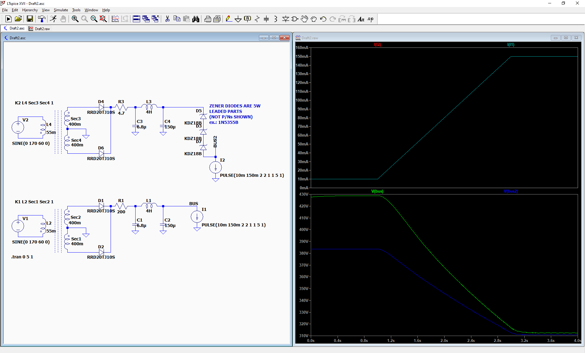

The Zener approach improves the regulation a bit - if that matters. Below is the ckt I came up with to allow comparison
I totally forgot that I have a circuit simulator. I don't remember how to use it though. In your example, what is the output voltage, which appears to be BUS2, when input is 320-0-320? How much power dissipation and heat is generated by the Zener diodes?
The output voltage shown on the graph is based upon your shared simulations. The diode losses total ~9W (all three), whereas the 200 Ohm resistor dissipates ~11W.
I see. Thanks. It's always a tradeoff. Save 2 watts but use three Zener diodes instead of one resistor.
