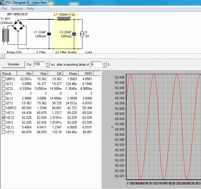

Those who have a Hammond 193V in the drawer might try to use them in their power supply.

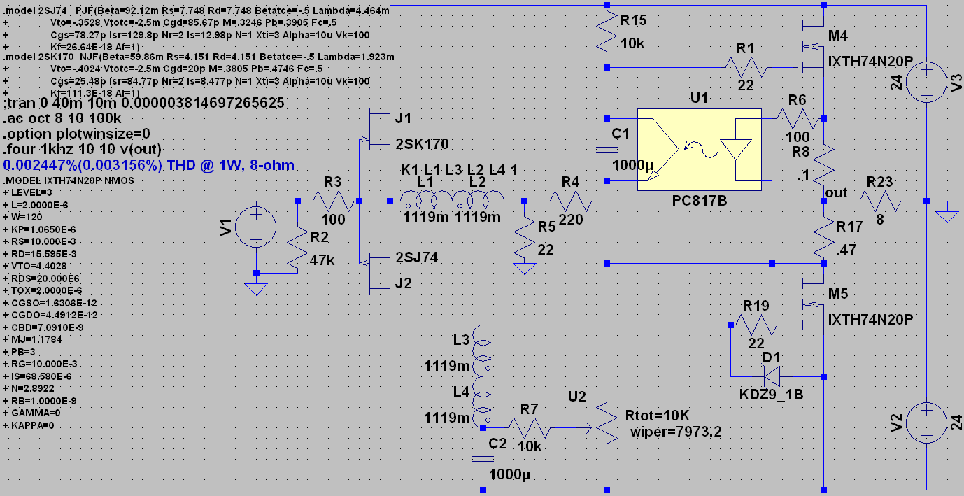

It seems this circuit can easily be converted into a DC-coupled version, but does such a circuit retain the desirable properties (e.g. Schade feedback)? Would there be worries about significant DC offset while the amp comes up to temperature? SPICE suggests it should be a solid performer, but it has lied to me before...
I have four IXFH74N20P that I bought a while ago for a project that has not yet got off the ground which might make a nice scaled-down version of this amp. I was thinking 24V rails and a 2A bias, which makes dissipation for each FET just under 50W. Although the parts are TO-247, they sport considerably lower junction-case thermal resistance than the usual IRFP240. Could I get away running them so hard?
If no one sees any obvious problems with the operating point or DC-coupled circuit, I may start the process of acquiring the remaining parts to give it a go...

Attached is a draft of my idea for the DC-coupled BAF circuit. I imagine the simulated THD is very optimistic, but does it look workable to others?
(For the record, the .1 + .47-ohm resistors simulate best, but I will have to experiment in the real world to determine which resistor values work best.)
If you have issues with dc offset drifting too much you might need to add 0.1 Ohms at the source of M5.
Start with what you have in your schematic.

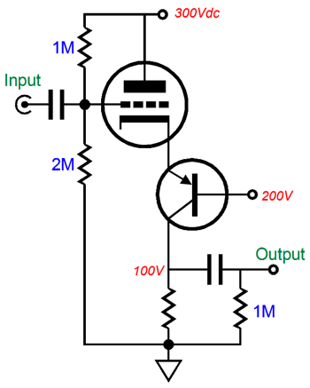

I think someone has been reading the TubeCad Journal.
The Inverted Cascode
John Broskie would call this an inverted cascode.
Depending how you reference the different devices to ground you can call this an inverted Cascode, a Bastode or a vertical long tailed pair(without the tail)/differential amp. It has been used in RF mixers and (de)modulators since the early sixties (since the first reasonable good RF P-channel devices entered the market).
It is a highly linear and fast little circuit. I am surprised that I have never seen it used in audio before, since it is (was) a very common RF circuit. I am sure someone somewhere use this circuit for audio, but I have never found anyone else then John Broskie (Tubecad) write anything about it.
I first learned about it from a girlfriends father who was a amateur HAM enthusiast who built his gear himself. This was back in 1989. At the time I did not believe it could be used for audio since I did not understand much about electronics.
It dawned on me when reading Nelson Pass articles about the I/V converter and about cascoding that a P-channel device could be used to drive a common gate to get a DC coupled input for signal or feedback, and all of a sudden I remembered this old RF circuit that I had not thought about for many years. I found some nice schematics on Tubecad verifying my ideas so I built a version of it and have been experimenting with it since.
