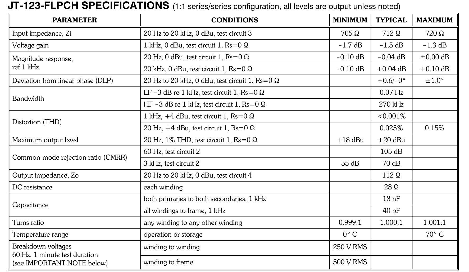

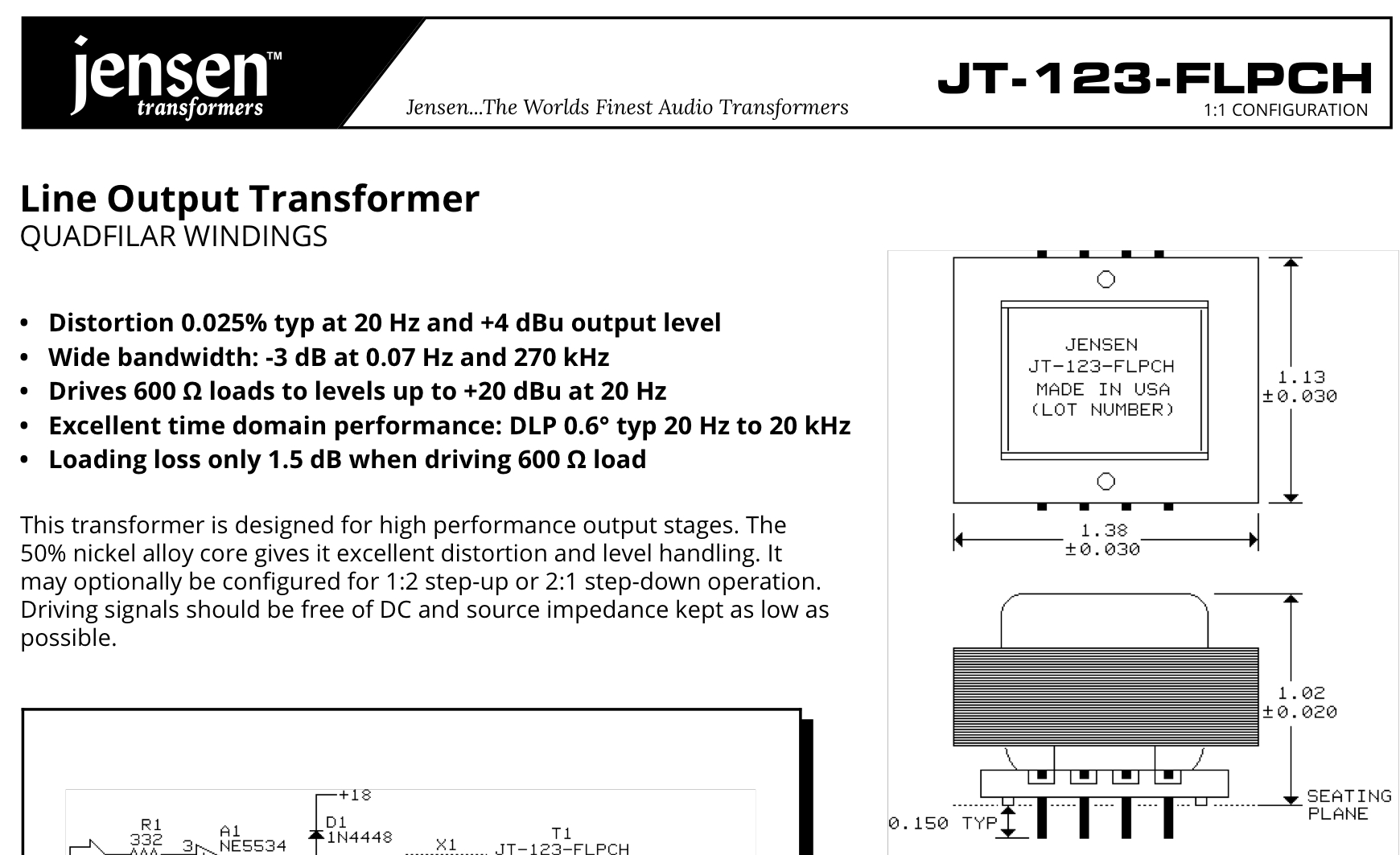

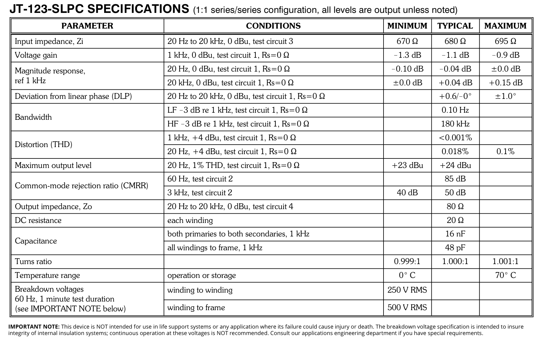

Is this the correct input transformer: http://www.jensen-transformers.com/wp-content/uploads/2014/08/jt-112p-2hpc.pdf
I'm using JT123FLPCH
Thanks 2pico.
Never helps to look in the wrong place for the wrong thing

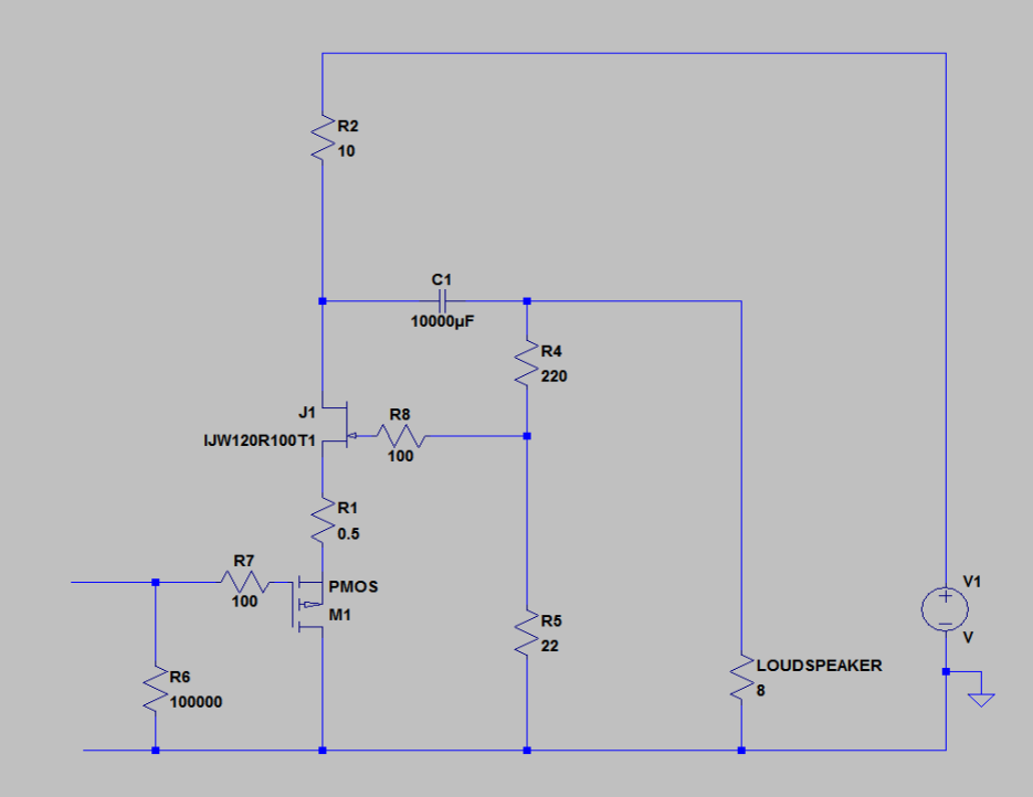

Somewhere in my pile o' stuff I have some huge "ashtray style" IGBTs from Fuji or the like, purchased in a spirit of speculation from an Ebay retailer that parts out monster motor drives - their huge, reasonably priced heat sinks have featured prominently in various of my class A projects. So, IGBTs are not great on linearity by themselves, but in a "buffered Schade" implementation with a P-channel mosfet to provide some drive, maybe we can break the 50W barrier for a simple Class A single ended amp, with some decent sound along the way. One man's trash is another man's treasure...
Here is a version I would like to try:

You'll have to explain how that circuit works for my dumb brain, all I see is source follower with cascode.
I can't see how you'll get gain out of that.
