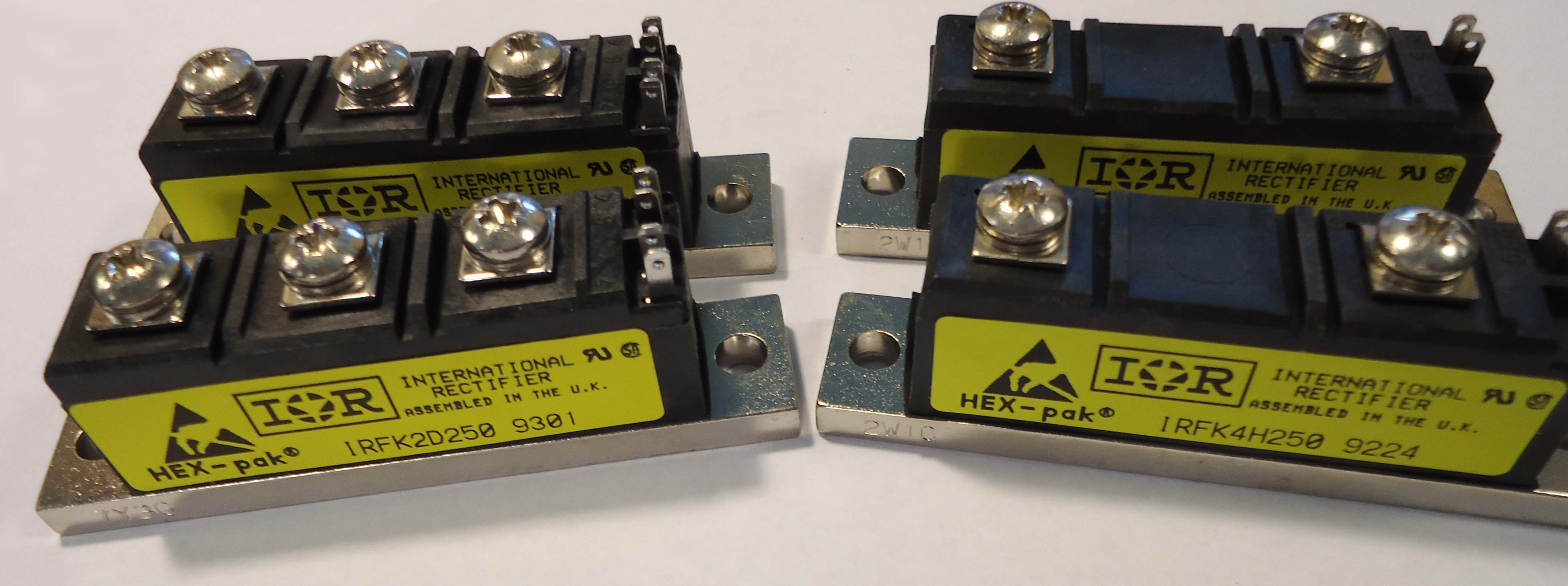

Neither do I, that's just not the road I'm traveling. If I can find my IGBTs without having to shift the whole house, I'll post a picture of them - they're beastly.
I like picture books. 😀

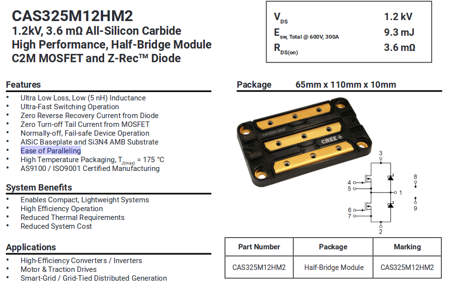

I like those Cree devices. The best part is the "Ease of paralleling" in the spec sheet. 😀
I can imagine a 2 kW cacoded version of the BAF2015. Say 700 volt powersupply and 100 ampere of constant current... The local steel plant would complain of reduced voltage to their electric arc blast furnace available from the powerplant whenever you fire up our surround system... 😀
Better to live near a large lake so you can watercool the amps. No more Ice-skating wintertime though....
For more than 20 years I've been meaning to do something
with my supply of these.
Do I see a 100 watt Schaded SoZ on the horizon?
