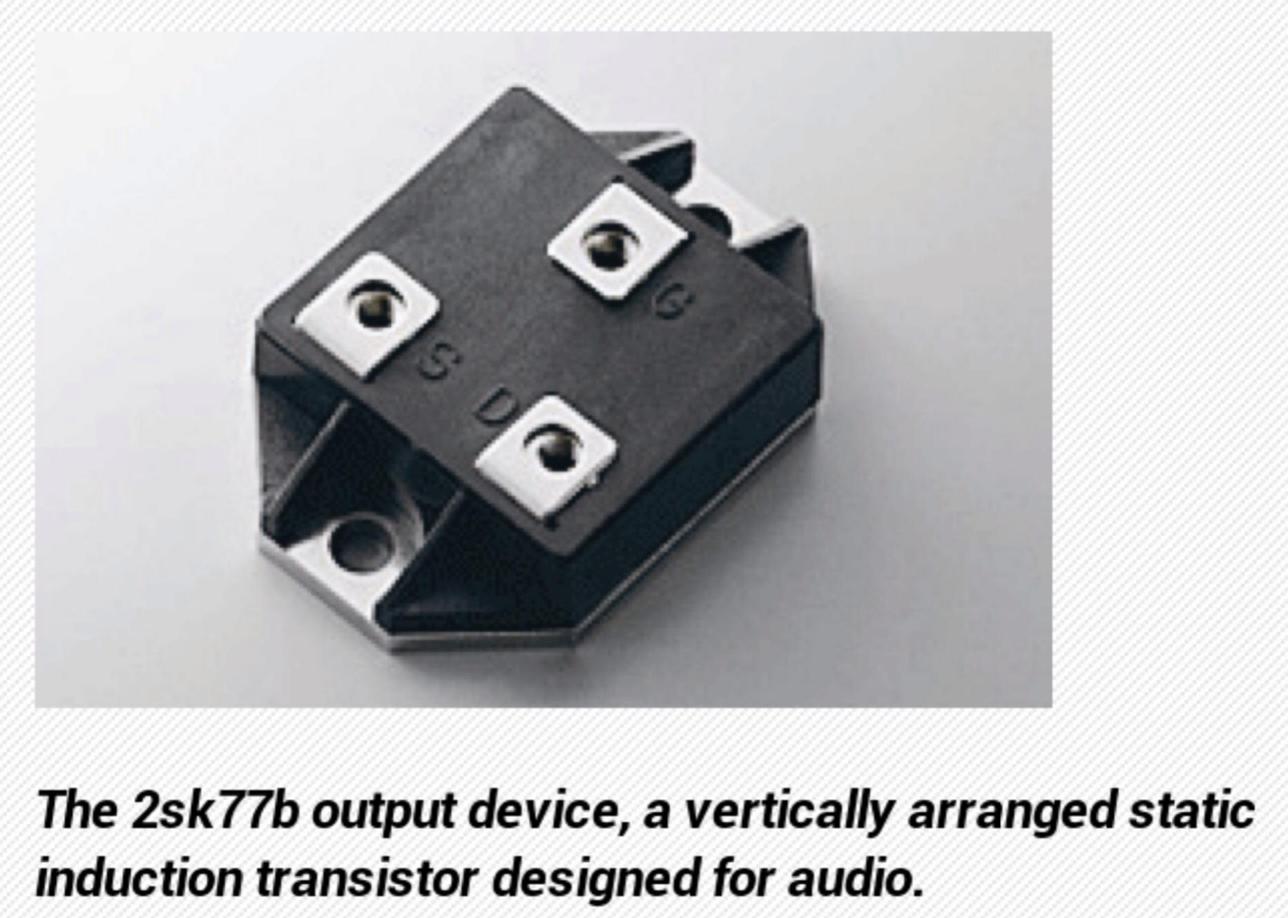

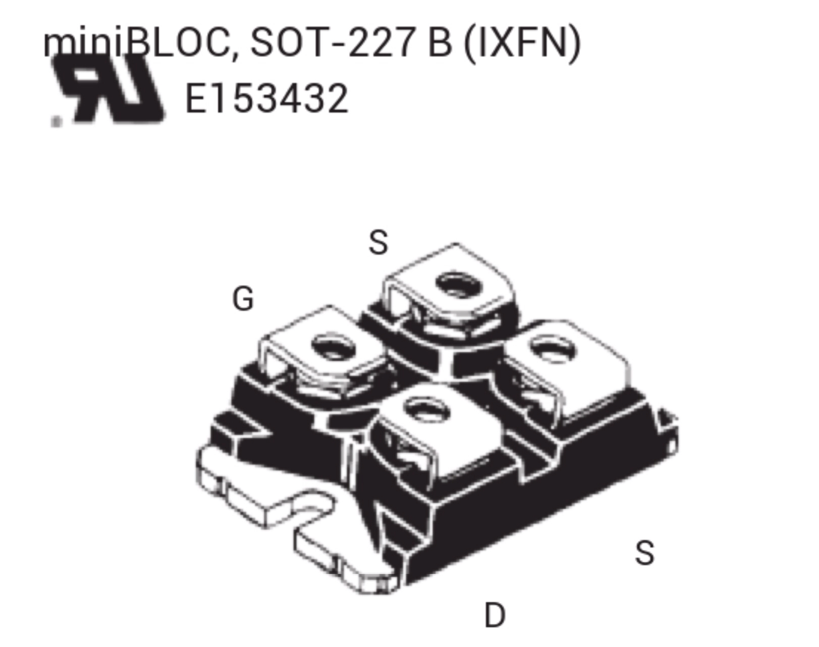

There is also IXFK140N20P which is identical to IXFN140N20P but in TO-264 package
IXFK140N20P IXYS | Discrete Semiconductor Products | DigiKey
To-264 are cost economic but they don't have look of Digital-Do-Main 2SK77B 😀
Schade version SIT simulation with hockey puck IXFN have similar triode curves,
all parameters and yes that " style" package.

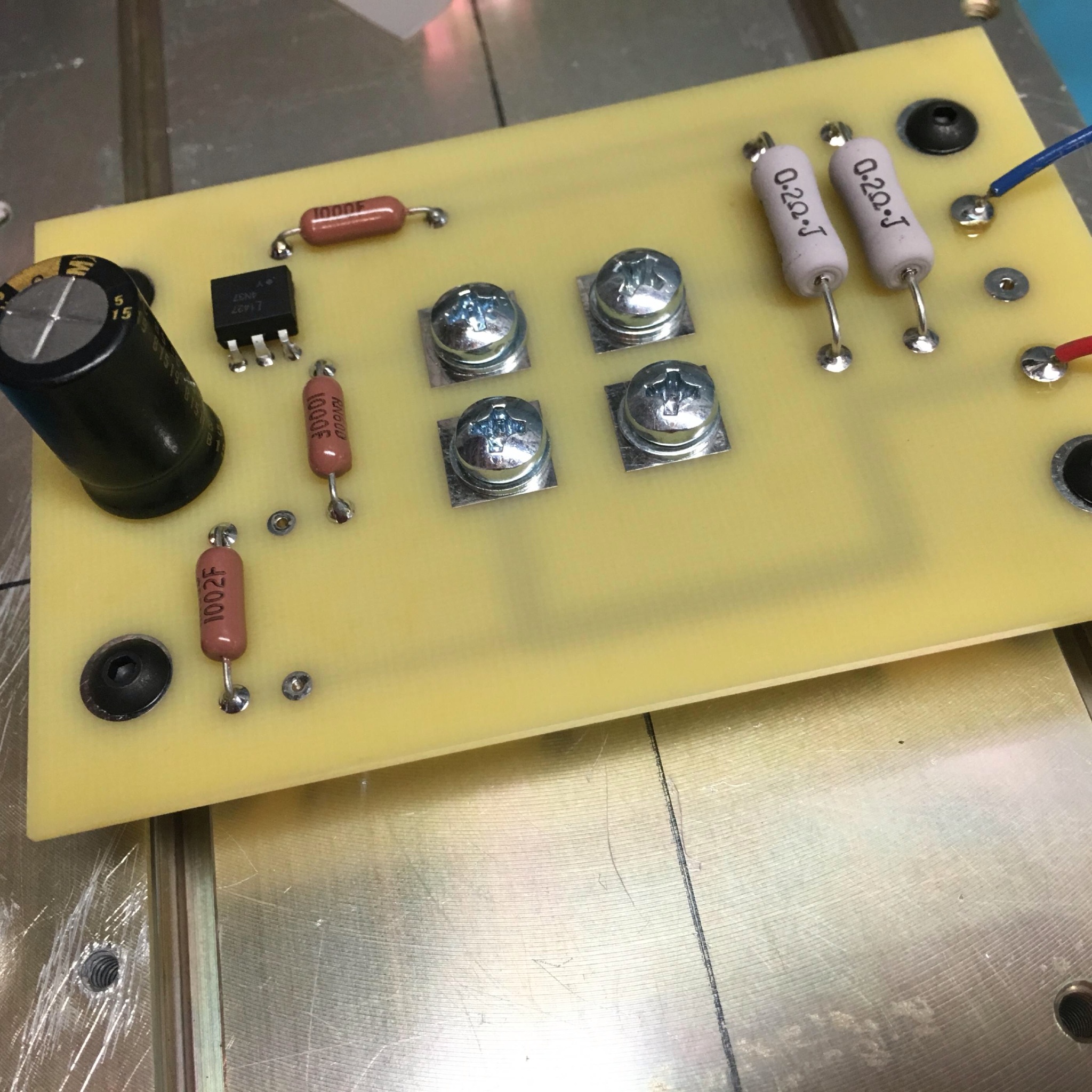

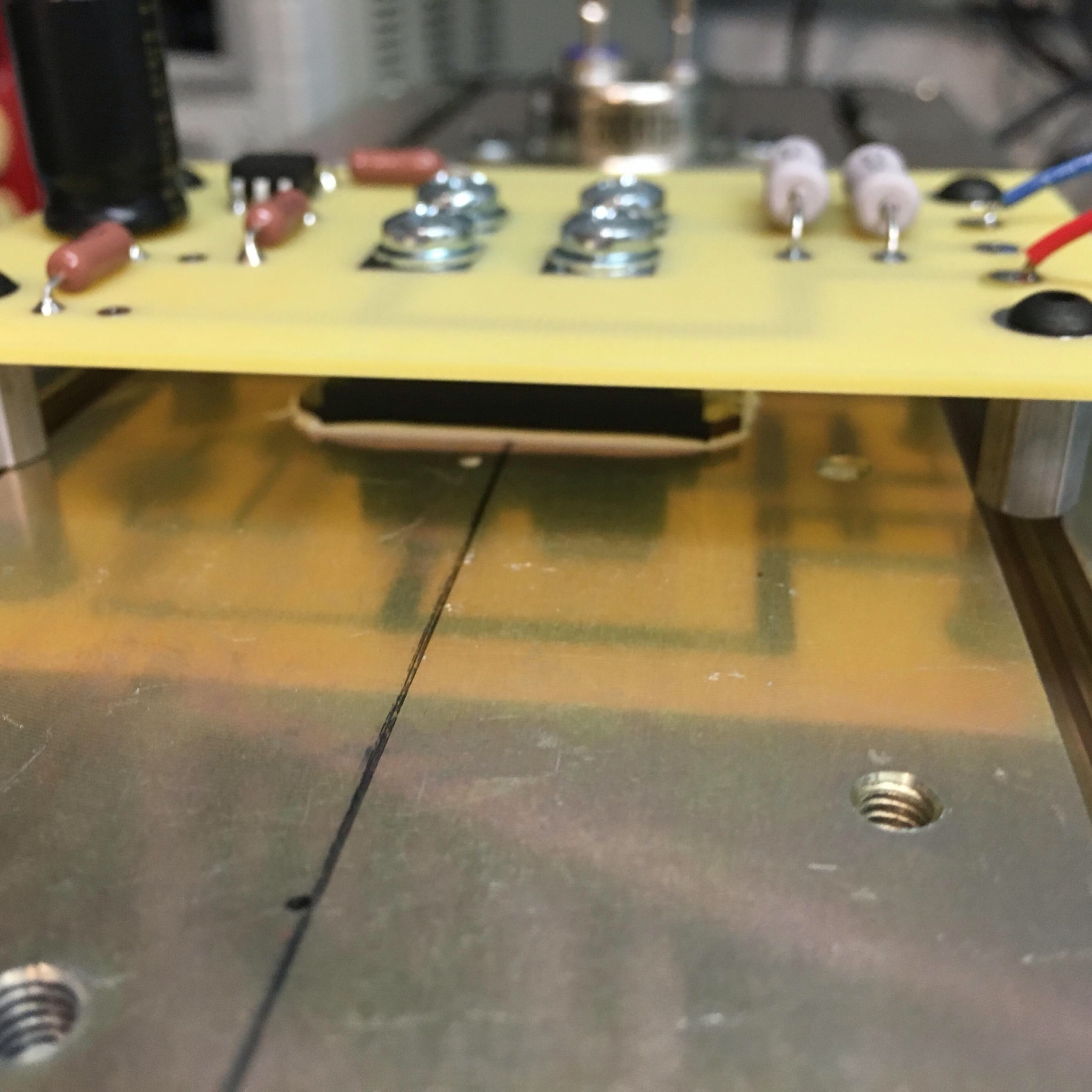

I like it very much Sir Rothacher pcb's solution show on the photos above.Thx to Audiohobby.com.

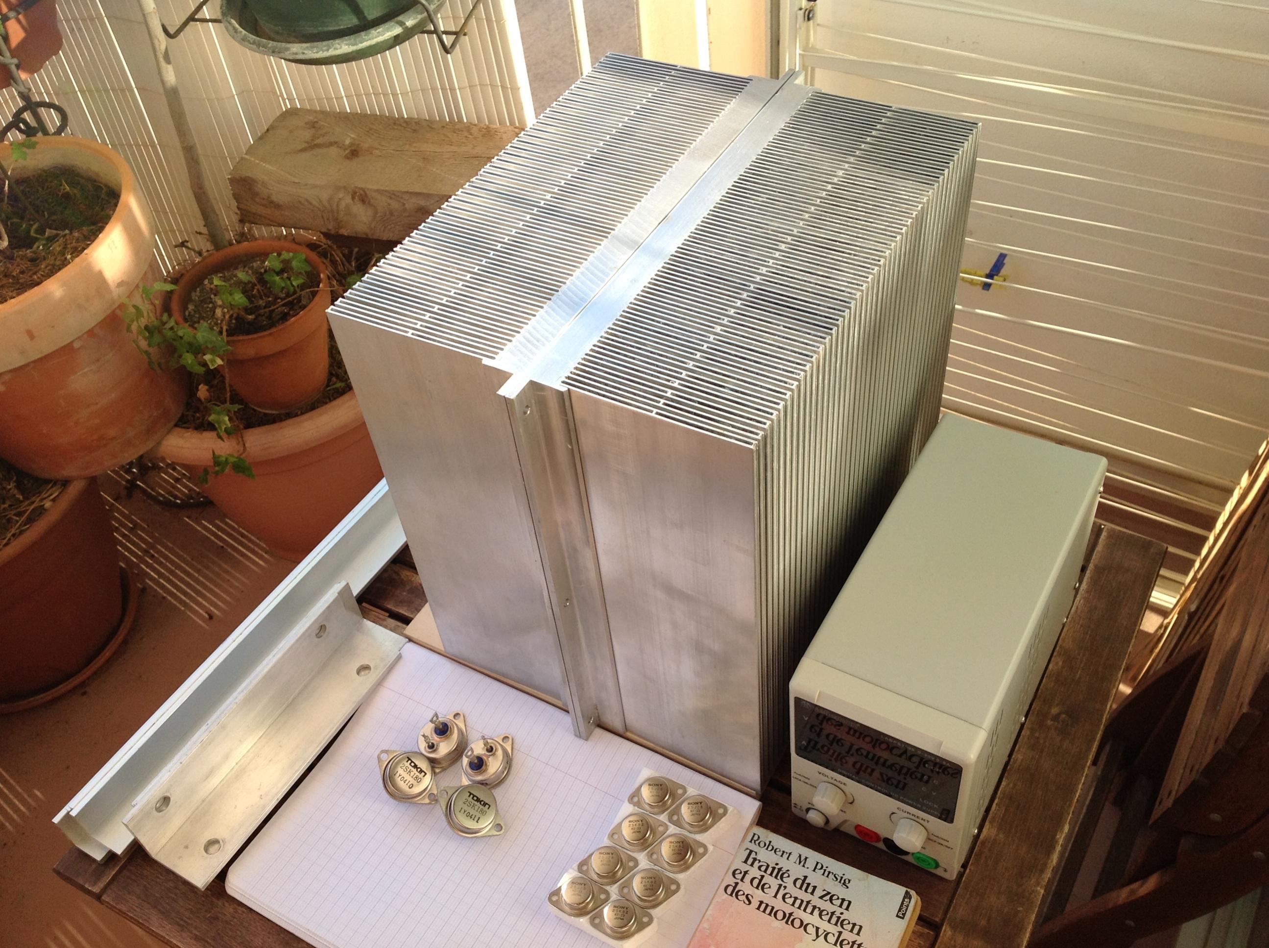

What is amazing in " Schade 50 nuances of Mosfet " ?
Its probably the only SE 50 watts amplifier i know with one semiconductor in audio path [ and his CCS]
have 20 dB of gain so no need for preamplifier stage [ less costs ] , passive resistors potentiometer is ok if you use cd player or DAC. Need huge heat sinks or nice liquid cooling.... i have find two candidates for experiments.

Yes this one is very special. I'm still slowly gathering the rest of the parts for this amp.
You have some nice heat sinks there

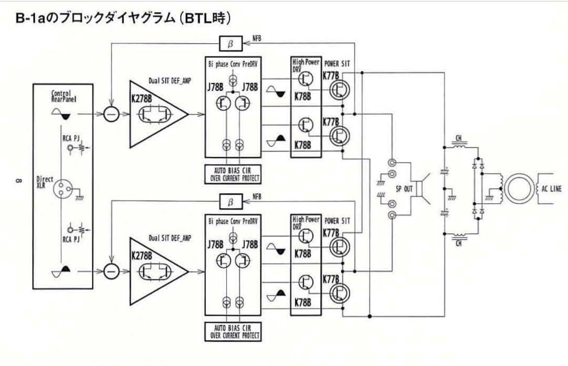

No doubt with biger Vfet build modified or similar amp to 2SK77B are possible but
all IXFN interesting aspect are how similar " triode sound "
we can obtain from " pentode " mosfet.
Guys into pentode tubes circuits say " triode " connection.
Mr Pass speak curves look very the same if compare.
I like very much single-ended topology , original B1a was push-pull.
