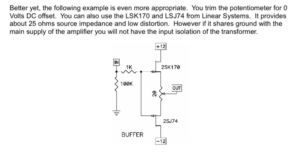

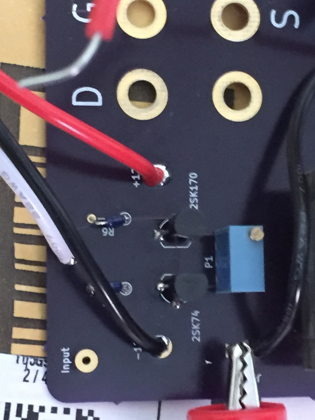

To ground or not to ground? That is the great question?
In the process of getting my multi kilowatt schade ready I'm now testing
my 2sk170/2sj74 buffer I included at the input. As seen in the pic below I have a separate +/-12 supply for powering my buffers. The question that puzzles me is should I tie the ground of my buffer supply to the ground of my main amplifier supply?
