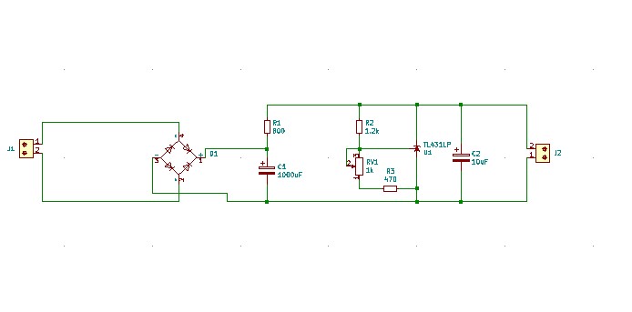

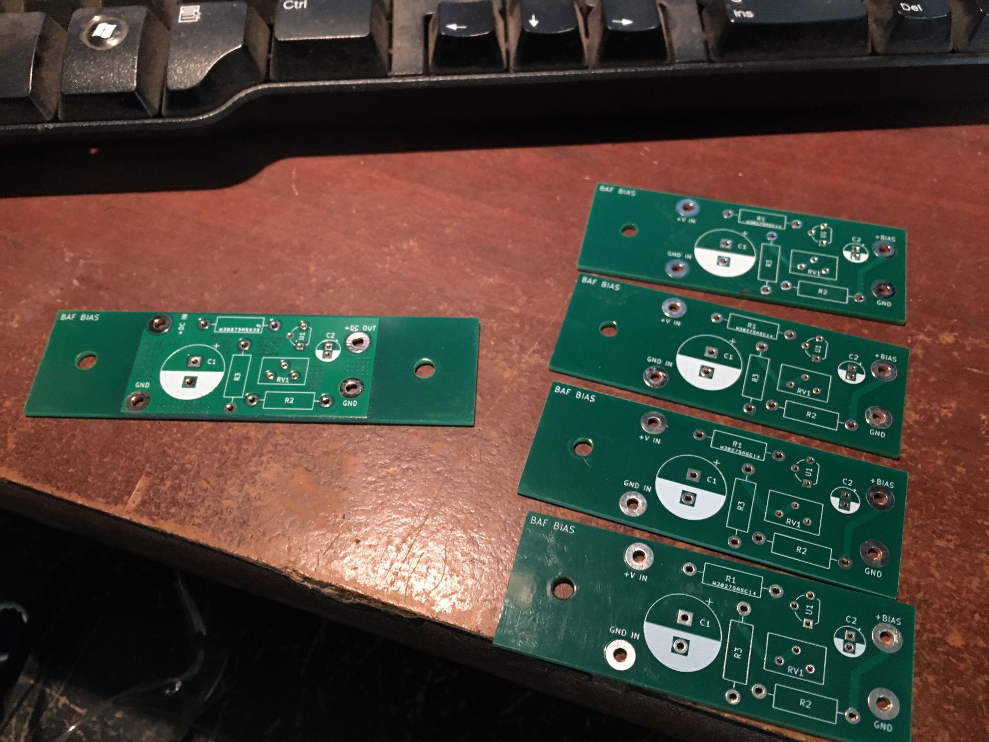

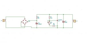

My TL431 bias circuit worked well unloaded and or with a 10K resistor as a load. I can vary output voltage and all is fine. When I hook it up to my mosfet circuit it lets out the magic smoke on startup. This is odd because when I use a lab supply for the bias supply all is well.

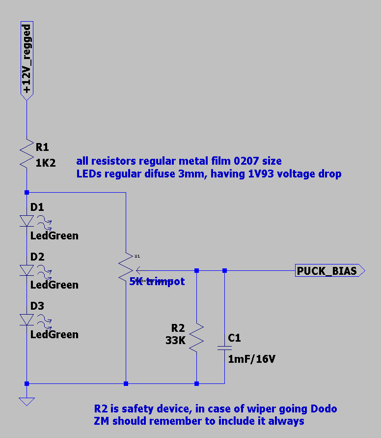

you can try using string of leds, they have nice negative TempCo, maybe handy for puck gate
say that 3 greens and one 1N14148 in series will cover puck Ugs needs
if you need help for calculating values, just buzz
Thanks to your help I’ve made great progress so far. Using a lab supply for the bias of the one mosfet things fire up perfectly. However I did learn that Vgs is super sensitive right down to the mv. But once you got it, you got it! If I can remember correctly Vgs for the bottom puck is around 4.12v. A bit lower than I planned for the 5-8V TL431.
Your LED idea intrigues me. I really enjoy trying new things and experimenting.

just remind me - you have +15V regulated there ?
Nope. +/-12v as recommended in the diagram of the buffer posted in this thread.
Dan
okidoki, not much of difference for little divider
will use +12V
later, you'll get sketch
