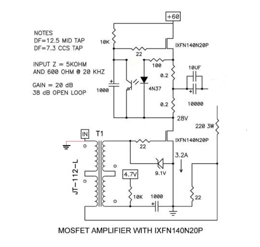

feed the lower mosfet drain with +30V independent from the CCS if you can. 6-7V on the bias seems a bit high, I found somewhere between 3.8V to ~4 wakes it up properly.
Great idea. I'll do that and posts the results as soon as time permits.

no need for separate testing , if you already confirmed that Mu half is working as prescribed
now just do what you need to properly bias lower part of amp, so drain of lower one is on intended voltage level
It isn't so I'm trying to see if I missed anything. More soon..................

power dissipated in part is current * voltage across it
if you want to have a functional amp, you need to have so-so equal voltages across upper and lower mosfet
in contrary, you'll have just space heater
in short - you must have an amp properly set...... or just toss it through window and be done
so, instead of chasing your own tail ( and making me/us to do the same), try to elaborate - what is the problem ?

that looks about right, pretty much the same values I got for a stock CCS tested independently. You could test the lower end independently or just connect it to the CCS as ZM said, cause you at least know the CCS works. Make sure you got that 5K pot in your bias supply, or it may not go low enough to turn on the lower fet correctly...again that 6-7V that you mentioned earlier doesn't seem right.

Why do you have your input grounded in the second pic?

well, whenever I'm setting up an amp or verifying proper operation, it just eliminates any unusual-ness
...... Plus it was from ZM...we follow him blindly
and, yes, ZM already being half-blind ....... what's that saying about mine ...... and your intelligence?
OK. With the rest of the circuit connected as seen below without the two output wires connected.
For the CCS
Vgs is 3.24vdc
Vds is 56.7vdc
Current drawn is 3.4amps
For the bottom half
Vbias is 6.3
Vgs is 6.43
Vds is .057vdc
