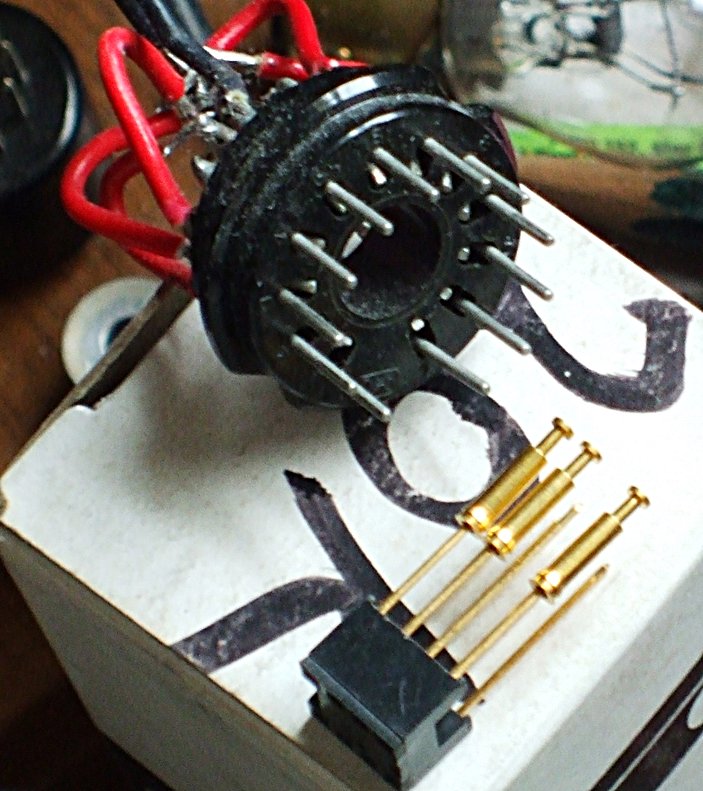

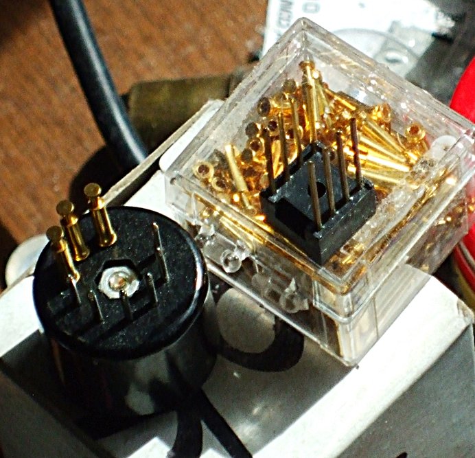

I use a socket adapter for pin configuring the curve tracer. Push-on single pin sockets have wires going to banana plugs to fit the tracer. Heat shrink tubing is placed over the single pin sockets. The single pin sockets fit noval pins, so they work with 7 pin, 9 pin, novar, and compactron bases. (but not octal or magnoval) So I have a home made adapter from octal to compactron base.
Could put such wire/socket pins dirctly on the PC board (banana plugs not needed)
Would be super if there are direct tube socket to wire wrap pin type sockets around. The single pin sockets could just push-on to the wire wrap pins then.
Could reverse that for normal tube sockets, I suppose. Put a row of labeled wire wrap pins on the board, and each type of tube socket gets short wires with single pin sockets on the wire ends. Plug them onto the board according to pin-out.

If one could find some single pins that fit an octal socket, could just put an octal socket directly on the board. Then wire a socket adapter to short wired single pins.
Unfortunately, the old headphone single pin plugs/jacks don't fit octal sockets, so some new pin type needs to be found.

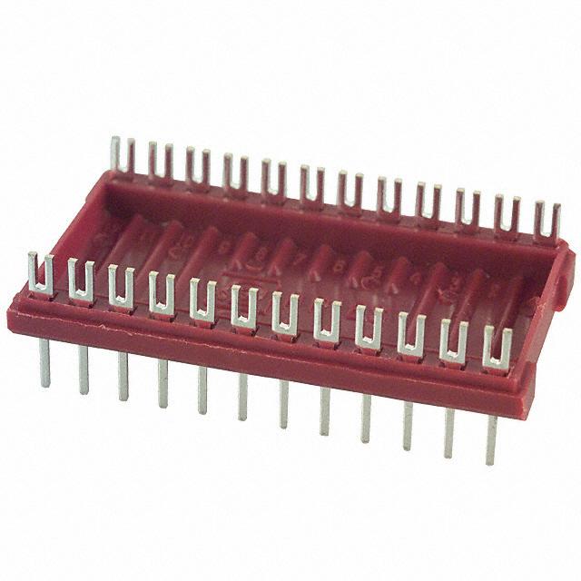

Could put a 24 pin IC ZIF socket on the board for each tube, and make the tube socket adapters wire up to a 24 pin DIP header. Dedicate 2 or 3 IC pins for each tube element for reliability and current handling, with some insulating guard pins around the plate and screen pin(s).
Could even skip the DIP header, and just put some stiff wires on the tube socket, bent into position to fit the ZIF socket. Would give a whole new meaning to "integrated" tube amp. Filament current might be a problem without redundant contacts however. Someone needs to come out with a ZIF tube socket.
Perhaps those IDE drives' power connector female plugs might fit?

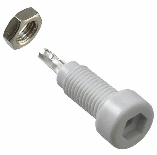

You can use Pomona or Cinch panel mount "tip jack" or "pin jack" for monitoring the DC bias and balance potentiometers. Available from all the usual suspects and most electronic surplus outlets.
