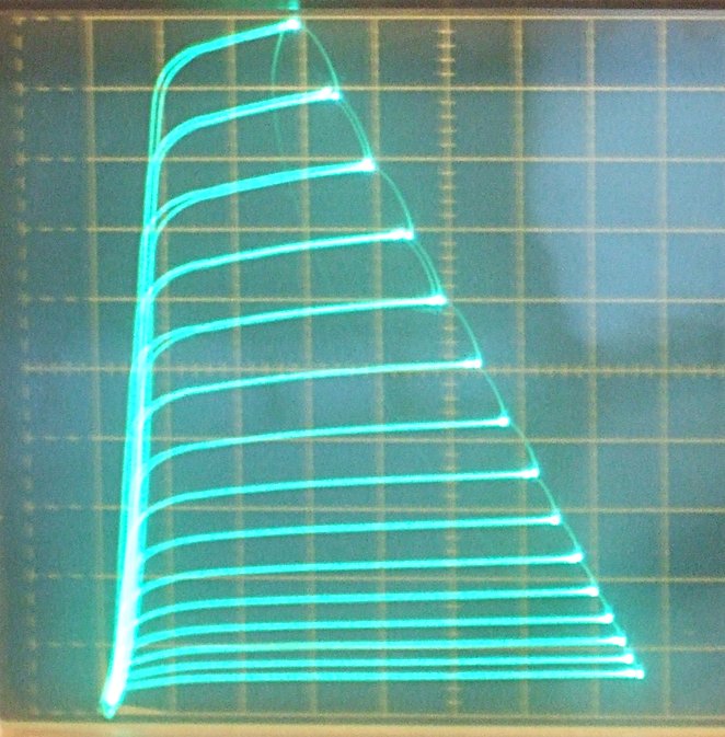

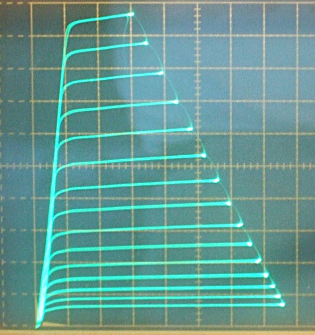

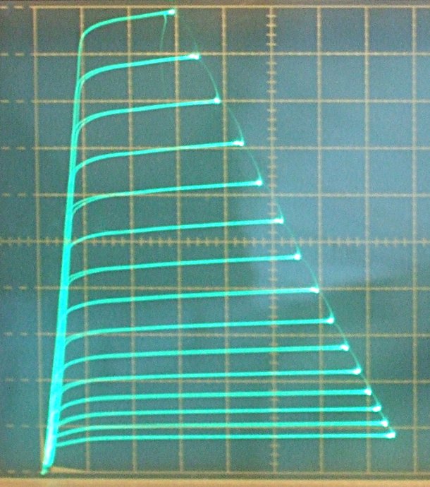

Here are some curve tracings for 6EW6, 6J11, and 6BN11
All are at 2 mA/div Vert.
50V/div Horiz.
0.08 Vsteps on grid1
1) 6EW6 Vg2 = 133 V, RCA
2) 6J11 Vg2 = 96 V, SYL
3) 6BN11 Vg2 = 125 V, RCA
6J11 and 6BN11 looked identical inside, probably made in the same place.
I adjusted Vg2 for each of them to get the same max curve. So the supposed offset in bias for the 6J11 would be hidden. Using Mu = 70 for the 6BN11 or 6J11, a 0.5V offset in Vg1 would show up as 35V difference in Vg2. Which is just about what I see, 96V and 125V.
6J11 and 6BN11 look the about same to me, other than that offset. Hard to get identical tubes to match this well! Close match for both to the 6EW6 too, except 6BN11 agrees best with the 6EW6 for Vg2, I was expecting the 6J11 to agree the best. So I think maybe that equivalence table should say the 6BN11 is equivalent to the 6EW6, and the 6J11 has the offset modification. ???

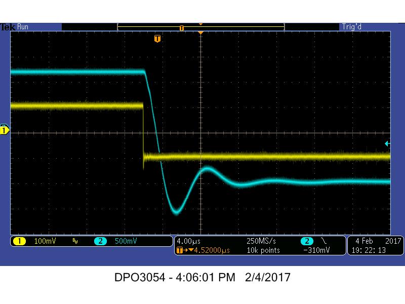

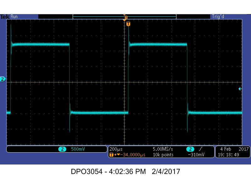

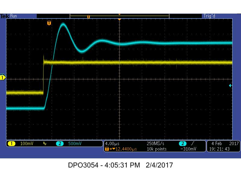

Feedback compensation and IMD
After more testing and listening... I discovered an HF oscillation when driving certain speakers. Back to the bench...
It seems the 33pF compensation cap was making the amp unstable with an open load. Same happened with a speaker that had very high impedance at >30kHz (which many do).
The oscillation could be cured with a 10 ohm load resistor across the output. But I opted to remove the compensation cap. So the NFB is now again just a resistor divider. This causes a little overshoot when excited by a square wave.
For good, or for bad, depending on your philosophy - that makes the HF response extend to >100kHz. So the amp is flat from about 5Hz to 100kHz.

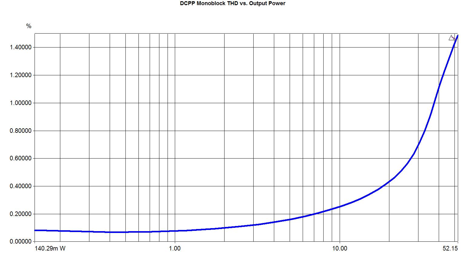

I also did some quick IMD measurements. SMPTE IMD @ 1W out is about 0.01%. At 10W, it rises to about 0.2%.
Hera are some scope shots showing square wave (5kHz) response and rise/fall with the comp cap removed. Note the time scales. Slew rate is > 1V/uS. More over/undershoot than I would like, but also the input square wave (yellow trace) is very high bandwidth, higher than any normal audio source...
Pete
