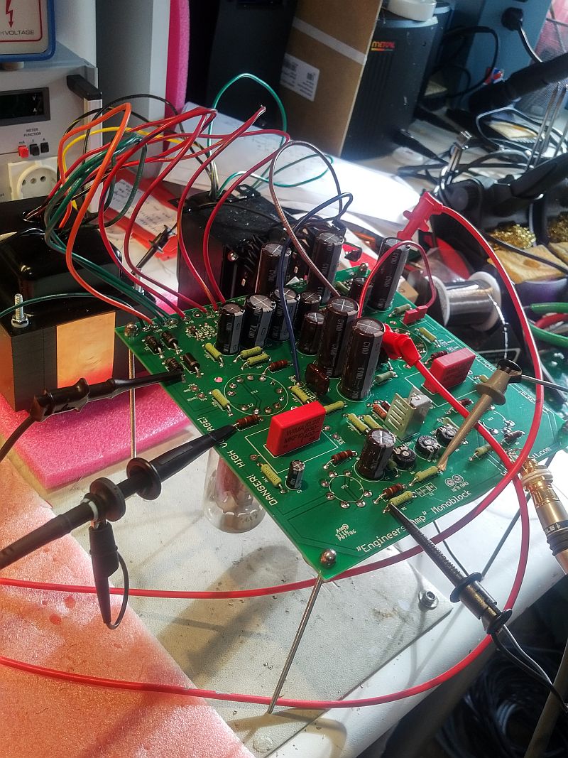

I've got several Dynaco MKIII's hanging around. I wonder how well these OPT's would work in this design? Primary impedance seems to be the same.
I was looking at new mkIII transformers, comparing prices against the Hammond and what Edcor has to offer. Using existing mkIII's would save you a bundle, even thou the Edcors are quite cheap compared to the others.

Just checking here for my own sanity, because I am going to have to ship across the ocean, but these are these right Edcor OPT's for the amps: CXPP60-4.2K
The Hammonds + Shipping are resulting in eye bleed.

"are these right Edcor OPT's for the amps: CXPP60-4.2K?"
Those CXPP60 should work fine. Might have slightly different mounting holes from the Hammond 1650N, I don't know. The Edcor OTs are good quality. They are blue. The Hammonds are black. If that makes any difference.
Anyone able to comment on how much buzz/hum from the Hammond power xfmr 290FX versus the 291FX? I know the 300 series (373FX) are dead quiet, but they cost almost 2X.
For 440V B+, one could use an industrial (Ebay) 120V to 480V xfmr with an inductor input DC filter. The inductor may cancel out the cost savings though.
It might be cheaper to just use a 120V:480V industrial xfmr with a cap input (610V B+), and then up the size of the OT to 100 Watt. Rather more dangerous B+ voltage to work with then, only for the experienced builder. Expect some hum from an industrial power xfmr. however, they don't put any extra steel laminations in those.
