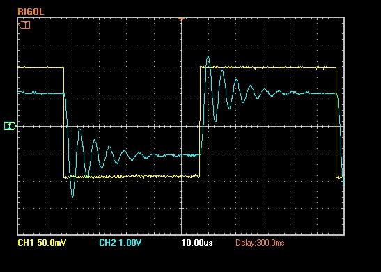

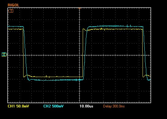

Was the squarewave plot with feedback or without, and a nominal non-inductive resistor load? Assuming it was with feedback, then at least the amp is stable in that condition. I can see the original comments in post #55 on stability. Are you using the original output transformer? Did you attempt to improve the damped ringing on the squarewave with capacitance across the feedback resistor (a small radio tuning capacitor is quite practical for that role) ?

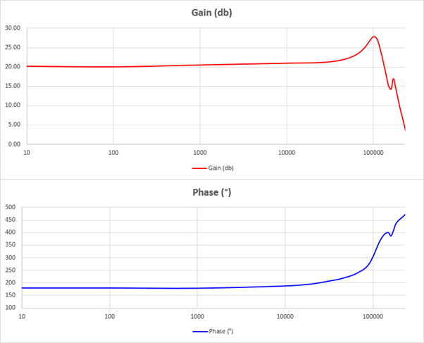

Both the square wave and bode plot were without feedback into a 10W wire-wound resistor. I'm using toroidal output transformers. I'll checkout #55.

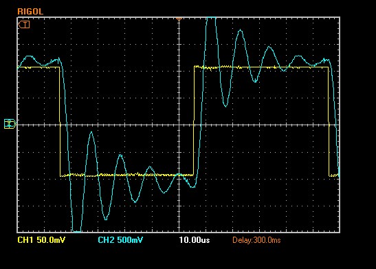

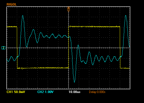

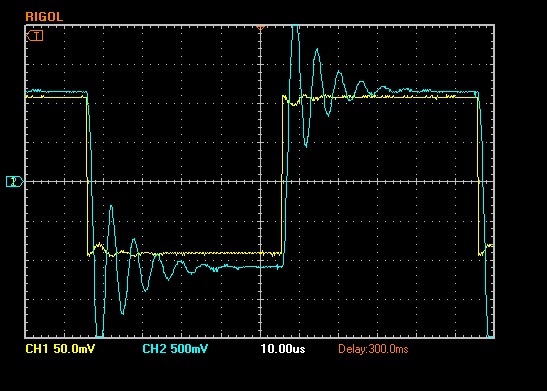

As per post #55 I've done testing with and without the 33pF capacitor. These are without:
The 2 peaks in the frequency response at ~110kHz and ~190kHz are visible in the square wave response. The ~110kHz ripple is higher amplitude than Pete's result in post #55.

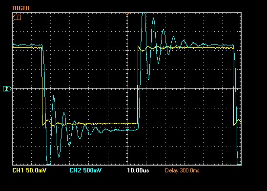

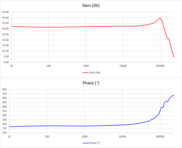

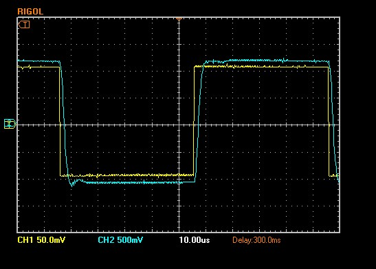

These are with the 33pF capacitor
The second peak is much reduced and the square wave response does look better:
Nearly as good as Pete's result in post #55. I'd go with that but...
I replaced the 8Ω load with 1k. Very shortly after the square wave appeared on the output, a screen full of HF oscillation appeared and I quickly powered-down.

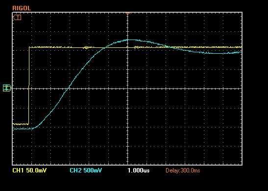

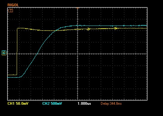

Hi. I’m looking for some compensation advice. Given the oscillation caused by the 33pF lead compensation I’ve investigated lag compensation but I can’t get a result like that in post #55 or in the reference mentioned below.
Here are some results with 330pF and 22k between the anodes of the differential pair. 10kHz response looks like this
Slew rate is ~0.5V/us.

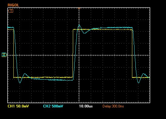

1kHz looks like this (actually 47k but 22k is similar
It takes 200us to settle.
I really tried to do the job properly using the approach described in Amplifier Compensation - Prevent Oscillation and overshoot in Negative Feedback Loops, but was never able to construct a Bode diagram as described. I had to resort to trial and error.
The amp doesn’t oscillate into a 1k load.

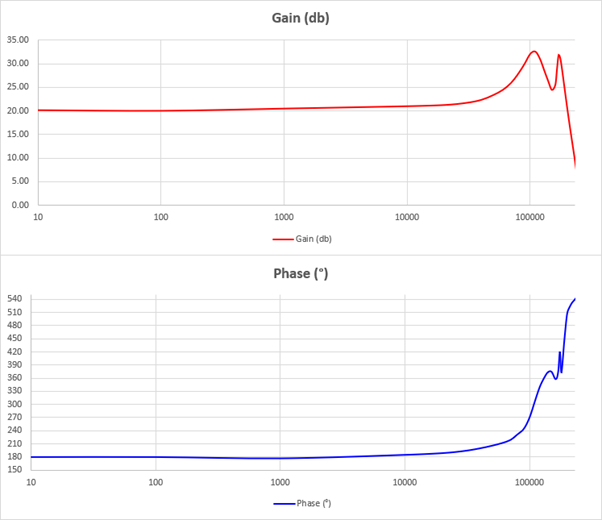

No compensation

They were both from the other channel. I've taken both channels back to uncompensated. In that state they're close to identical. Left channel again
and right channel
I'll redo all the amplitude and phase vs frequency charts again. Laborious but needs to be done.
At this point I'm leaning towards omitting the compensation. In use the amp will have balanced inputs. the input transformers are 3dB down at 100kHz. There's not going to be high levels of HF coming out of my DAC.

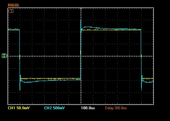

After re-reading all your posts I decided to have another read of Amplifier Compensation - Prevent Oscillation and overshoot in Negative Feedback Loops and it all finally made sense.
I followed the procedure described and calculated that I needed lag compensation between the anodes of the differential pair of 62k and 63pF, and lead compensation of 26pF across the feedback resistor.
With 11.6dB of feedback, gain is 20.6dB.
10kHz square wave output for the 2 channels now looks like this:
and
I’m happy with those. The slew rate looks to be slightly more than 0.5V/us.
Gain and phase look good with the gain flat to 20kHz and 3dB down at 140kHz.
