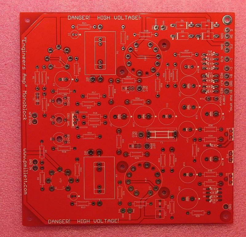

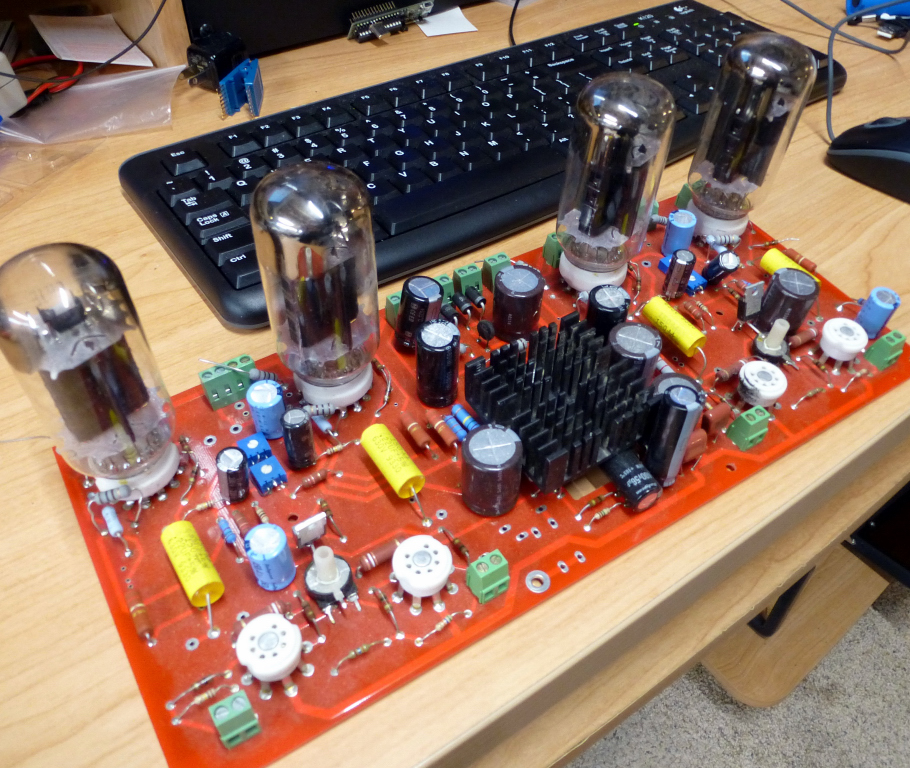

As some of you already know I designed a PCB for a 50 watt monoblock version of the "Engineer's Amp". It uses 6HJ5 tubes, B+ of about 410V, and does an easy 50 watts out into 8 ohms.
You can see the details on my web site: Engineer's amp 50W monoblock
I have one assembled into a chassis now. I will be doing more measurements soon. It works very well 🙂

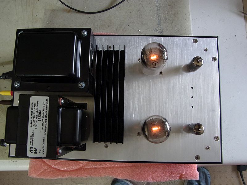

I don't remember blowing up a single 6HJ5 although I did find a few that were bad out of the box. They were gassy, some glowed (they were trashed), others had the creeping bias current syndrome that will eventually lead to runaway. Some of these may usable in an amp with a mosfet driving the grid, so they were marked and saved......somewhere.....maybe.
I moved all of my stuff twice before settling into this place. We had to leave Florida on 3 weeks notice, so what was an organized move turned into utter chaos, and I'm still looking for parts of projects that were planned, or in progress when the chaos hit. The worse part is finding most of a project, but the key bits are still missing after over two years. I found all the parts for a guitar that I was building except the neck......It shouldn't be too hard to find a guitar neck, but it's still missing.
While looking through an unmarked box for something else, I found Big Red #1, the original experiment. Two other boards were built, one was left in Florida, the other is part of another stalled project. Number 1, looks complete except for the missing input tubes, but the original 6HJ5's are still there.
