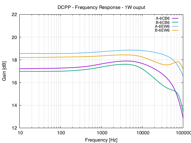

Based on your input on an old thread I tried 6EW6s in my DCCP. I've yet to write all this up (or indeed trace where the difference between channels comes from) but here is a frequency response comparing 6EW6s to 6CB6.
As one would expect, with the greater gain there is more to feedback, therefore flatter response?
I've no idea on the distortion levels, but tuning it in using an FFT to get as low spikes at 2kHz and 3kHz sounds good to me.

All of my testing was done with the local (plate to plate) feedback only. I never needed or liked any GNFB in my versions, even the 125 WPC flavor. The 6GU5 provided the most gain, which was needed to get to 125 WPC.
The gain in this amp is influenced by the Gm of the tubes, the plate load resistor in the input tube, the plate to plate feedback resistor, and GNFB if used. I tweaked the first three, and left out the GNFB to suit my needs for the 125 WPC version. The stock version probably has enough gain for most applications as designed, or slightly boosted by swapping tubes with the stock parts values. I didn't (and still don't) have enough 6EW6's to give them a fair test, and all of mine are used.
