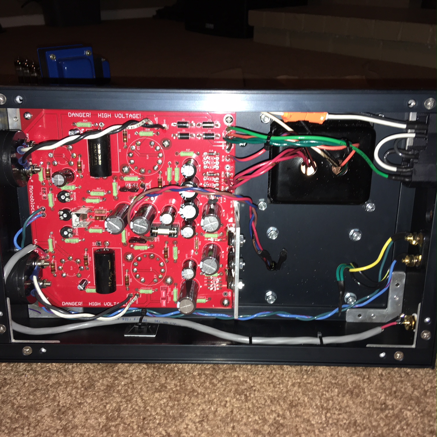

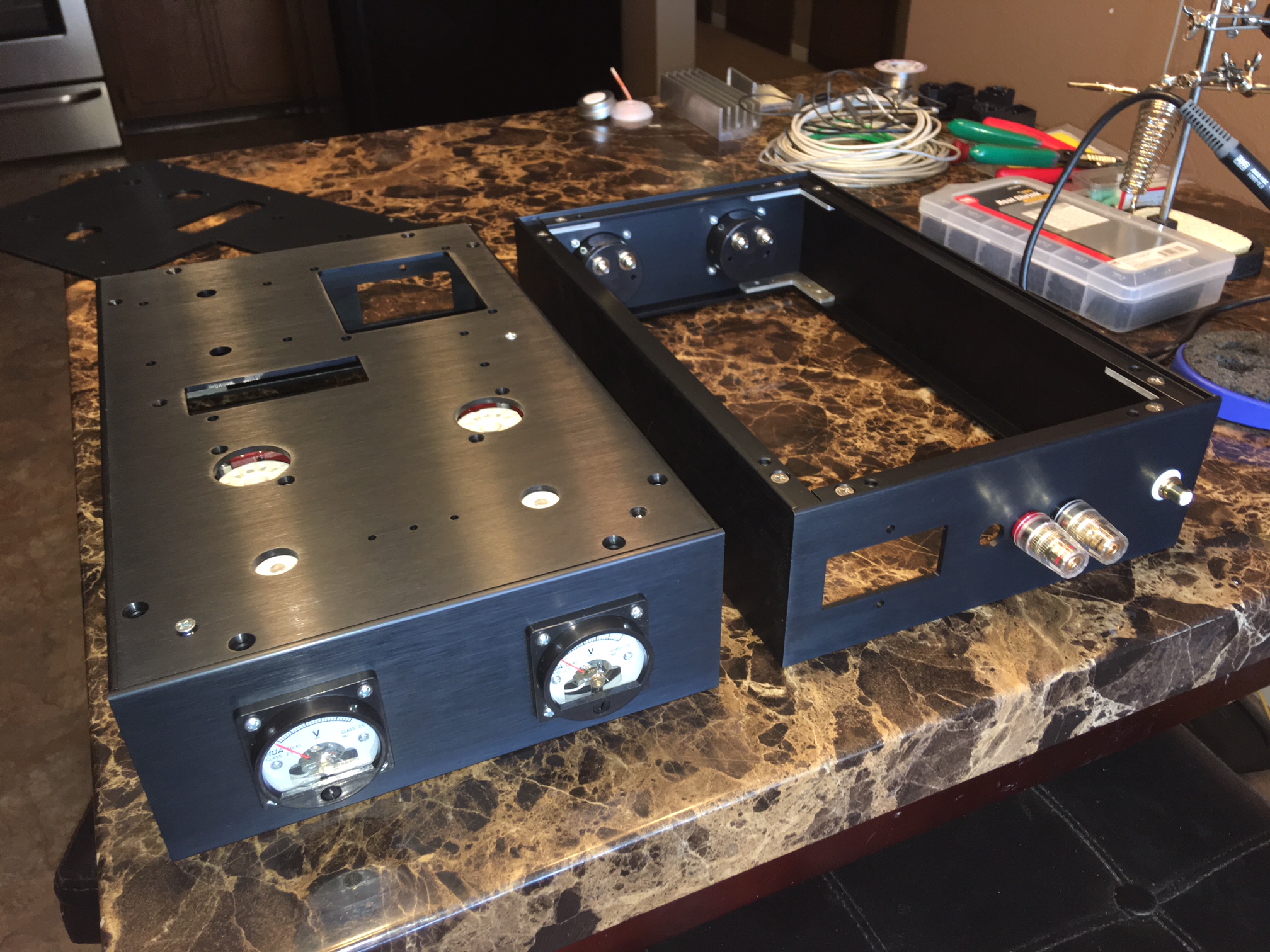

Thanks for all the feedback on your builds. I did get my chassis in this week. Spent a few days trying to find all the proper hardware. Ended up using #6-32 by 9/16th stand offs. Unfortunate I ended up breaking two thread taps in my heat sinks and pretty much destroying the pieces trying to remove the broke off taps. So rather than trying to sand them down I opted to order a couple new heat sinks and plan to have the machine shop drill and tap them for me this week.
I am very happy with the work that Landfall Systems did on the chassis. Those guys really delivered. If I had it to do over though, I probably would have ask them to make the chassis just a half inch taller to allow for a little more room between the pcb and the meters.

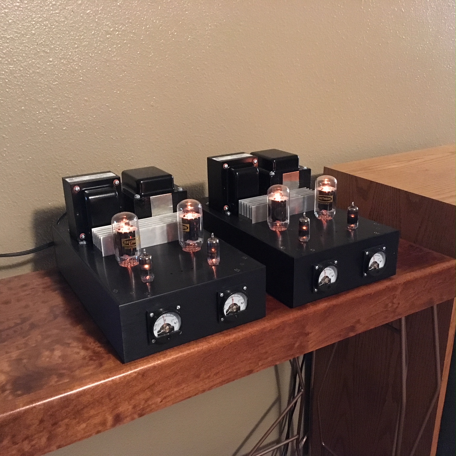

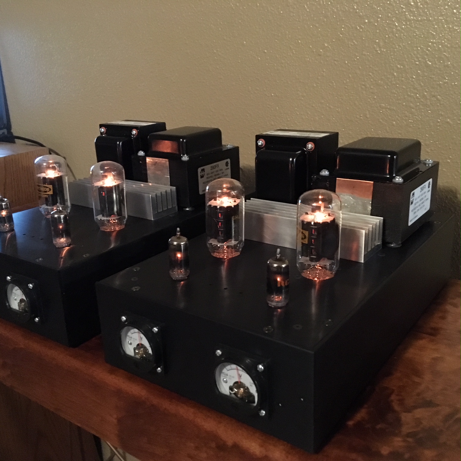

Here are a few pictures of the finished product. Due to space issues I had to mount the bias meters on the outside of the chassis. I am still looking for an alternative 0-1v bias meter. These ali express units do not seem to be very accurate.
I think I got lucky only one of my units was slightly out, but you can adjust the calibration with the screw on the front, you just need to turn it really slowly. I basically attached all of mine (in parallel) to the same constant known voltage in order to do the calibration.
