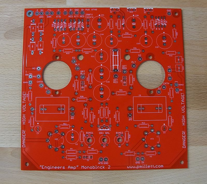

New version of PCB without sockets
Hi All -
I now have a version of this board with no tube sockets... just holes so you can chassis mount sockets and wire them up however you want. So you can use whatever tube!
Pete

Afterhaving built the DCPP and being totally satisfied with the quality ofthe amp, i decided to buy the pcb's first version (on the way) forthe 50w monoblocs.
The problem is that currently it is almostimpossible to buy 6hj5 tubes (I thought it would be easier up until startlooking for them). What is the best substitute for 6hj5? and what changes do I have to make?
As I am nota specialist like many of you (this will be the third tube amp that Ibuild), I ask you to have a little patience and try to detail thechanges that I must do as best you can.
Unfortunately there is no drop in substitute for the 6HJ5. The 6HD5 is the same tube with a minor pinout change. It is also rather scarce.
There were over a dozen tubes that fit the original single board DCPP amp and rather minor changes were needed to run 6HJ5's in that board. It may be possible to go the other way in the mono board. The 6HJ5 has the G1 and G2 pins reversed compared to the common sweep tubes, so the stopper resistors were crossed over to make the changes.
I have not seen Pete's mono block board, so I do know if either of these mods are easy, hard or impossible.
6HJ5 / 6HD5 was unique for a 24 Watt sweep tube in not having a plate cap, and using a somewhat different Compactron pinout from other sweep tubes (grid1 and grid2 flipped). Electrically it is very close to 26/6DQ5 and also to 21/6LG6. 6EX6 is also close except somewhat lower gm1 (use a -NEW- 6EW6 driver tube in place of the 6CB6 for more drive signal, pin compatible).
Unfortunately, the grid stopper resistors for grid1 and grid2 are on opposite sides of the tube sockets on this board. But could still be crossed with some insulated wire extensions on the resistors.
The bigger Compactron sweeps like 35LR6, 6LB6, 36/6KD6, 42/6KN6 have a little more gm1, so would still be easy to drive by the board, just a different base pinout. (Most have the grid1 and grid2 flipped from the 6HJ5, plus a plate cap)
The 21/6LG6 is a 28 Watt Compactron base sweep tube, electrically similar to the 6HJ5, but a different pinout, and has a plate cap. The 6V heater version is rare and expensive, the 21V version is cheap. Could use a common 24VDC regulated supply adusted down to 21V for the heater (separate wires to the isolated heater pins).
26/6DQ5 and 6EX6 are octal base with a plate cap. Can be found inexpensively. A total base re-wire needed obviously. (the new multi option board version would fit well for these)
21/6HB5A is another Compactron base tube with just 1 base pin conflict (pin 2) and no plate cap. It is only rated for 18 Watts dissipation versus the 24 Watts diss. for the 6HJ5, but has the same size plate. The 6V heater version would almost be drop in except for pin 2. Some 6/21HB5 tubes have a grid 1 cooler fin up top of the top mica, so clearly can handle more than the rated 18 Watts. (the 6HJ5 has the grid1 cooler fin and the same size plate)
35LR6 has a similar Compactron pinout to the 21LG6 and a plate cap. Its a 30 Watt tube. Higher gm.

Thanks very much for your help.
I will analyze your suggestions while I do not receive the pcb's but I start to think that the best hypothesis of building this amp is to order the new version and choose another alternative to 6HJ5 / 6HD5.
Any other suggestions or alternatives are most welcome.

Unless more 6HJ5s show up, time to get the new multi-tube monoblock PC board.
