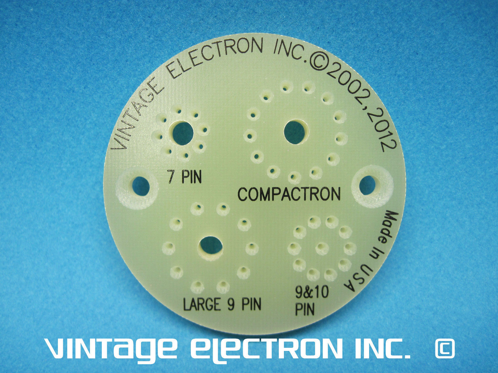

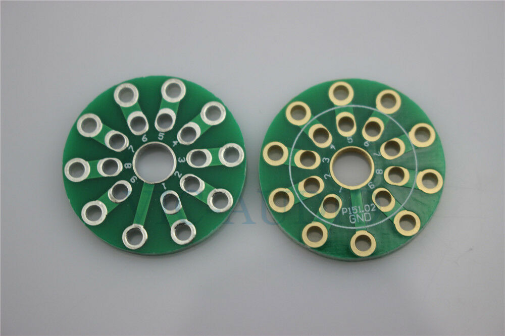

I've been using some 7 and 9 pin tube adapter PCBs to change the pinouts of tubes. Like the 7CM base 6GU5/6CB6/8136/6EW6/5JK6 drivers to 9 pin tubes like 6JC6, 12HL7, 12BY7, 6197.
If we had a 12 pin Compactron PCB adapter, then any TV Sweep tube could be used on the original 50 Watt Monoblock PC Boards. The 1 mm pins are available on Ebay. Use a pin straightener to hold the pins in formation to solder to the adapter PCB. Then put a socket on a second adapter PCB and wire the two adapter PCBs together as needed. Of course, nothing wrong with using the original 6HJ5 tubes if you can find them.
