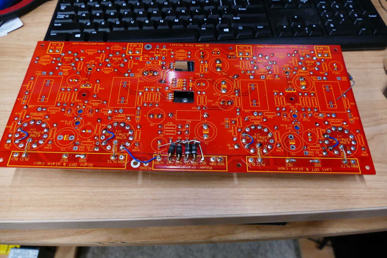

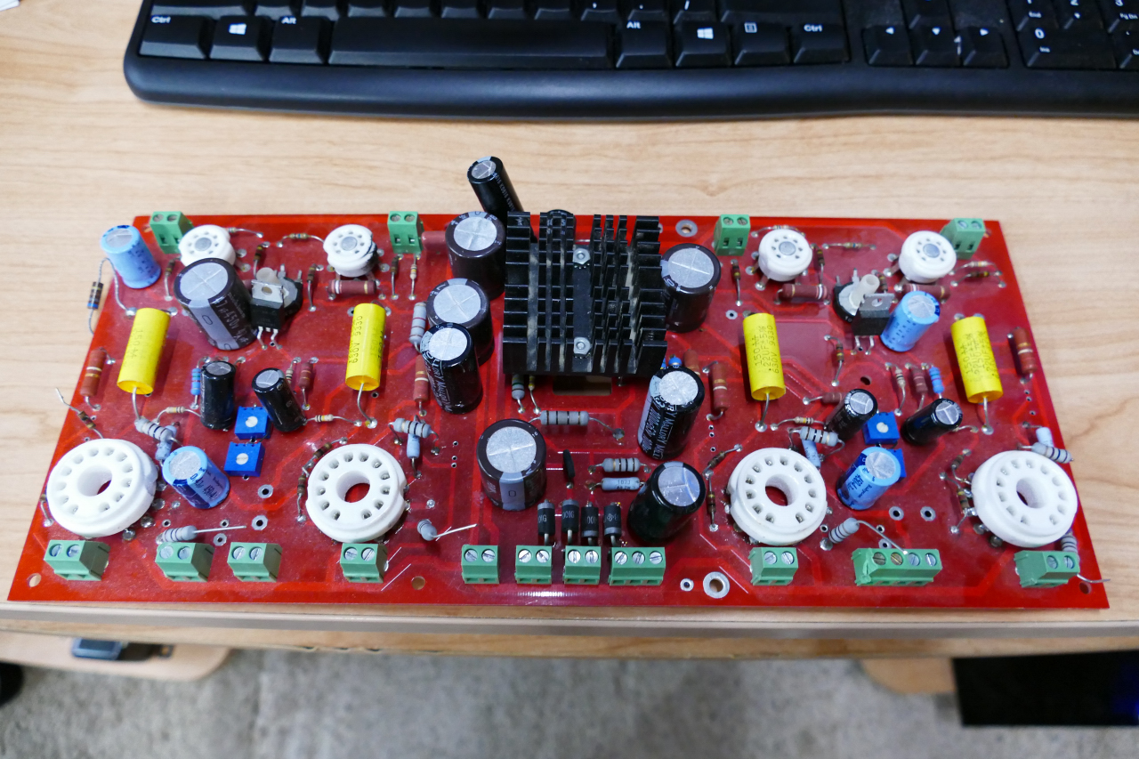

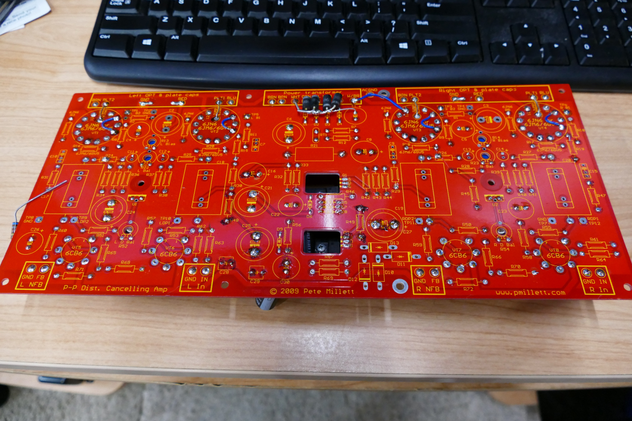

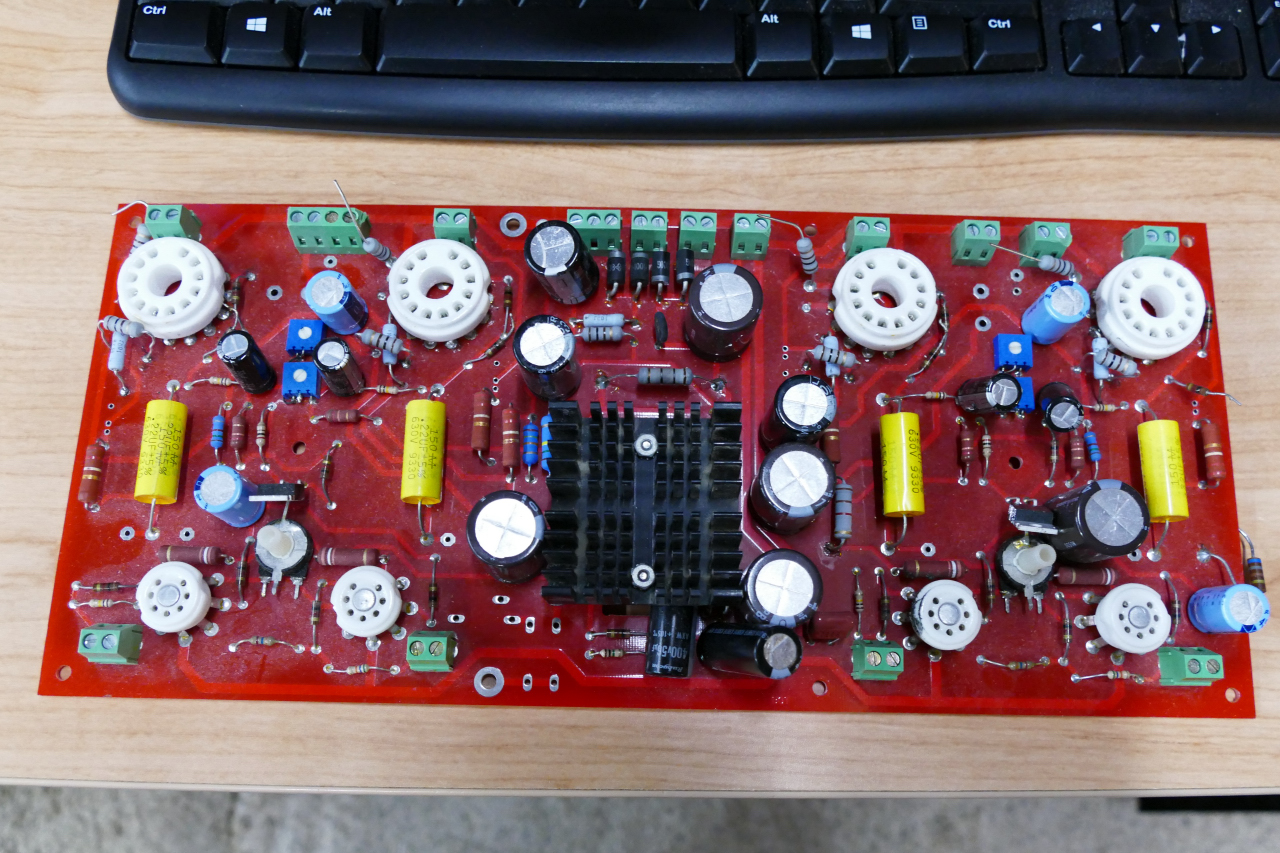

There was a third board, actually my first, that I got just for experiments. It is the board seen in all of the pictures. It was never built up into a complete amp.
Keep in mind that all of these experiments and amp building happened about 10 years ago. The cheap surplus power transformers are no longer available. 6HJ5's have become rather scarce. Some minor modifications to the board were needed to accommodate the 6HJ5's.
I found my original "experiment" board a couple years ago in a box full of old boards. I am enclosing pictures of it. The crossed over resistors near each output tube were needed to swap the G1 and G2 connections for the 6HJ5. I believe that the added diodes were to accommodate the cheap power transformer that needed a FWB rectifier. The board will draw too much current at full power for the small diodes in the parts list so larger (3 amp) diodes were used.
