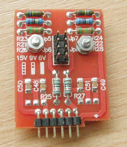

Thanks guys,
This clarifies most of the problems. However, few are still unclear.
It seems that TEZ4/D/15V indicated in BOM is not correct. It has only single windings and the secondary winding is connected to pins 7 and 9. It should be rather connected to 6-7 and 9-10 if I remember correctly (I don't have the board here with me).
Ha, ha. And the picture you attached shows just the oposite 😀. I guess it just doesn't matter.
This brings me back to my remark #1 - remarks in Romanian on the schematic. I don't understand it. Are you saying that the diodes are exactly as indicated on the schematic or there should be some modification?
Mark
Mark,
Tr3 can be 1+1; 1+2; 1+3; 2+1 ...... 3+3. Any combination, as long this can feet the board and is 110V/220V to 15-18V output.
We wanted to offer more flexibily, but seems that this produced more confusion.
However, please follow my previous advice and use what trafo make you comfortable:
TEZ4/D/9-9 from TME is OK.

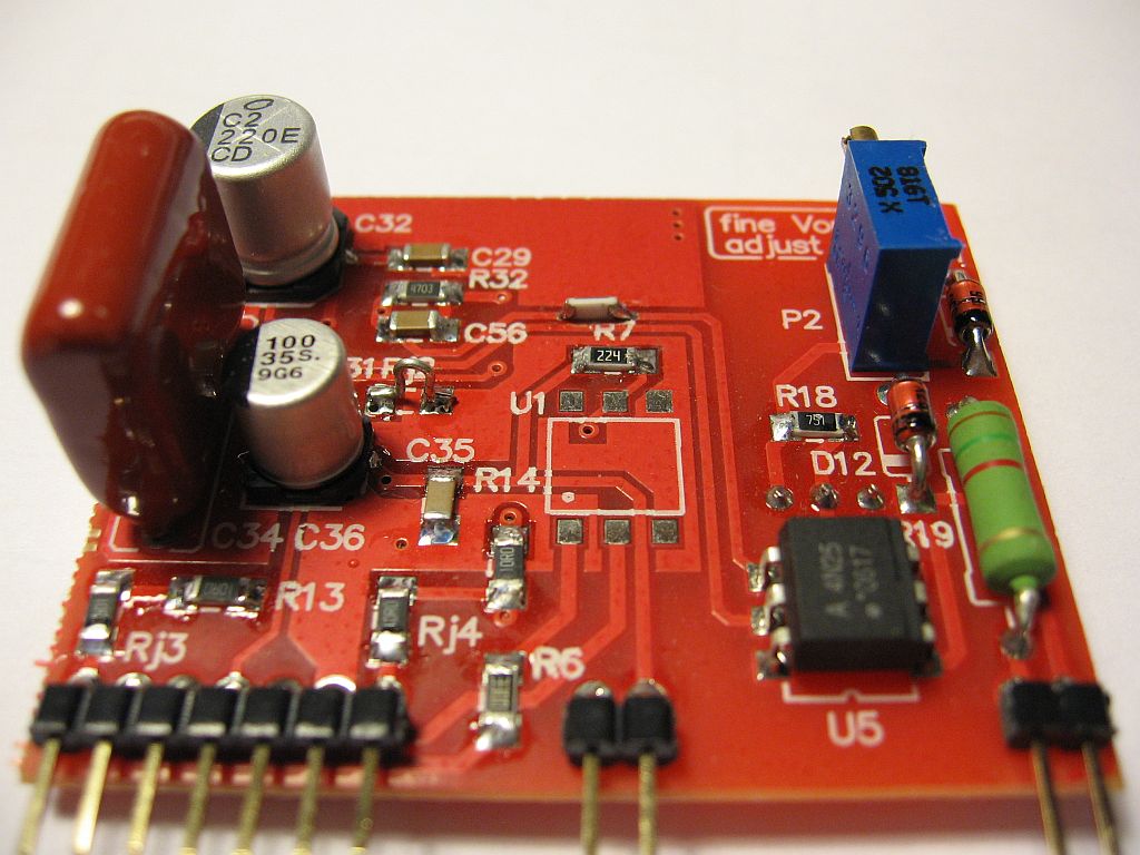

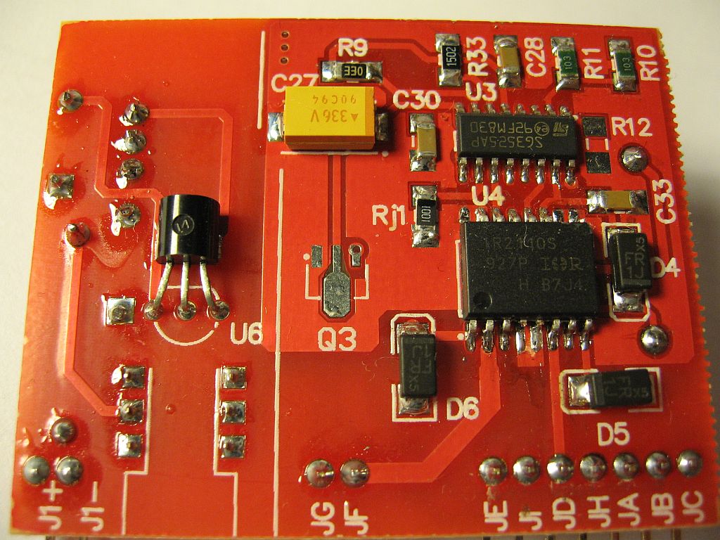

I have attached few more pictures. Hope this will help you and answer your questions.
Components marked with green are only for tubes version, or are present in both versions with different values.
D13A/B/C are exactly as in schematic. We just wanted to simplify and use a double diode, but again this generated confusion. :-~
Tibi

Markus,
As I said, the board supports a lot of types of linear transformers. Previously I indicated a 2 primary windings transformer (110V+110V) which is not your case. Also, Jp1 & Jp2 help you to switch between 110v and 220v mains, FOR THE ABOVE type of transformer.
If you have TEZ4/D/15v, I guess it is not a problem to you to connect pin 6 to pin 7 and pin 9 to pin 10 on the board. 🙂
C38-43 (2200uF/63V) are indeed for SS version and alternatively C58-59 (470uF/400V) are for tube version?
Both types are present in the schematic just because this was the way to put them also on the pcb board.
Regards, Geani.

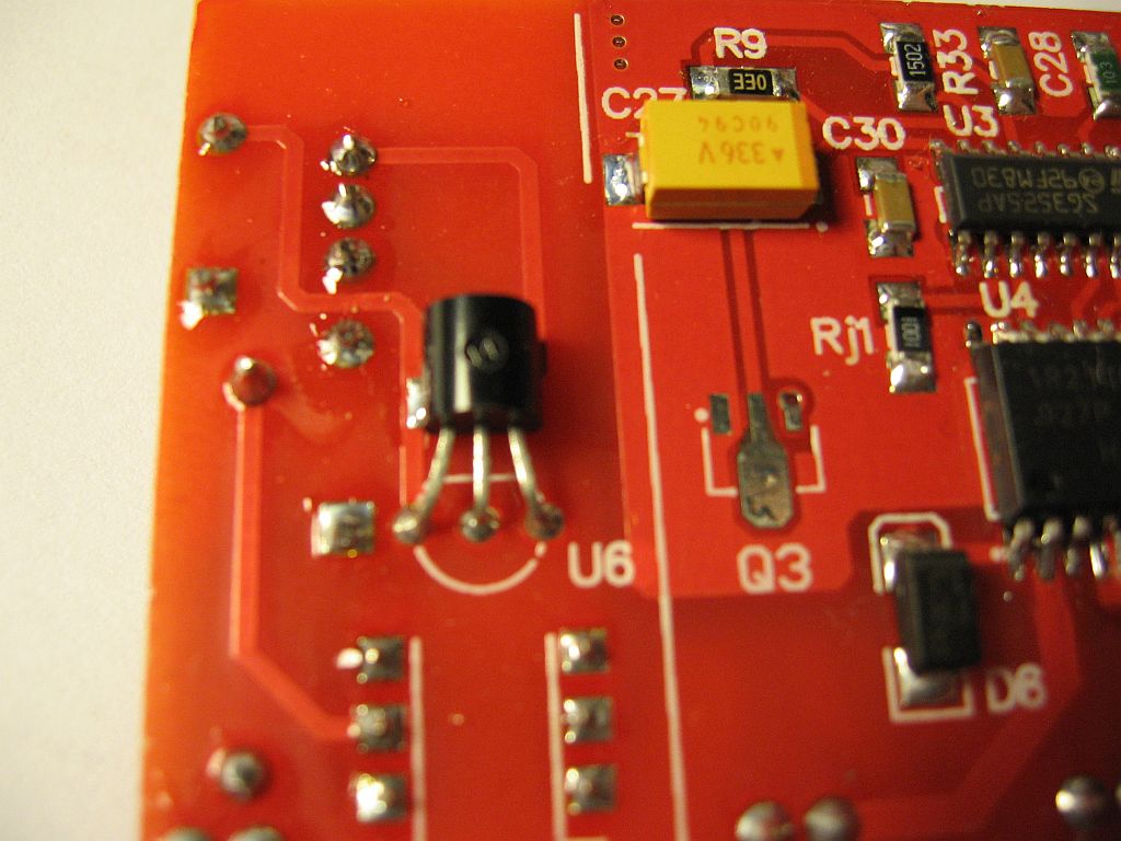

Thanks for the photos. I assume that additionally few pins of IR2110 should be disconnected from the ground.

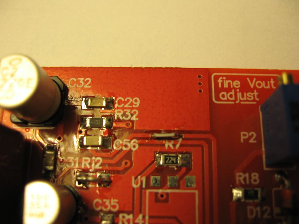

I'm not that experienced as Microsim so I'll keep on asking questions which arise when assembling the SMPS.
I have a problem with C46, 47, 52, 56 (1000uF/25V). They are marked as "tube" version in BOM. But I think that they are input and output capacitors for LT1086 in SS version, right? If yes, one of the capacitiors (C52) is exactly in the same place as jumpers on "C" board are. Of course I could remove these jumpers (since I'm building SS version and I think that the jumpers are not needed for +/-15V) but I'm worrying whether I made a mistake when assembling the supply. Can you post a photo of SS version assembled and show how the jumpers on "C" board fit in the same place as C52 capacitor?
Could you also explain Jp3 and Jp4 in SS version? I found a drawing that says that they should be connected only for "tube" version but I think that at least Jp4 should also be be connected for SS version (in order to get +/-15V).
EDIT: could you also explain R33? I cannot find it in BOM and on the schematic it's listed as 15k. On the other hand, on one of the photos posted it is replaced by two resitors (voltage divider).
