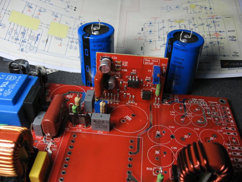

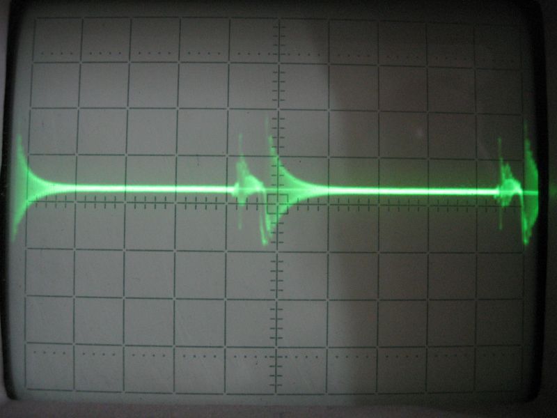

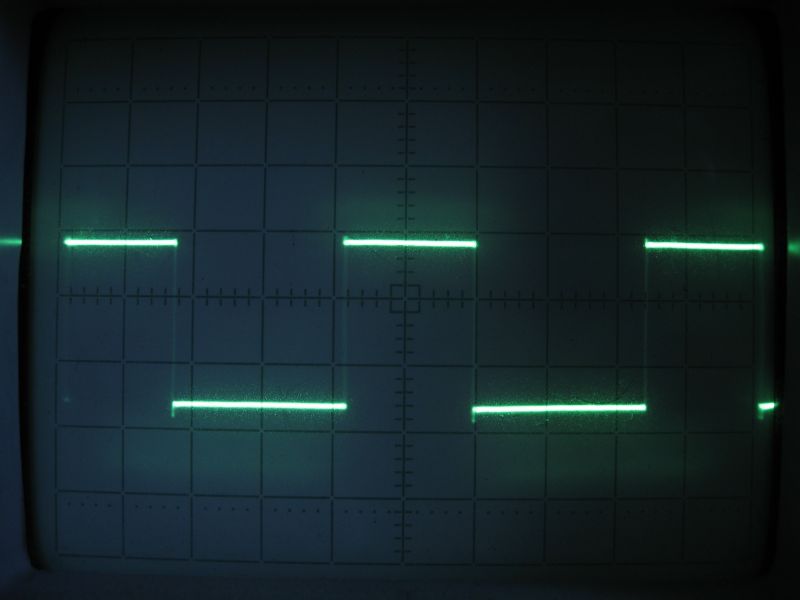

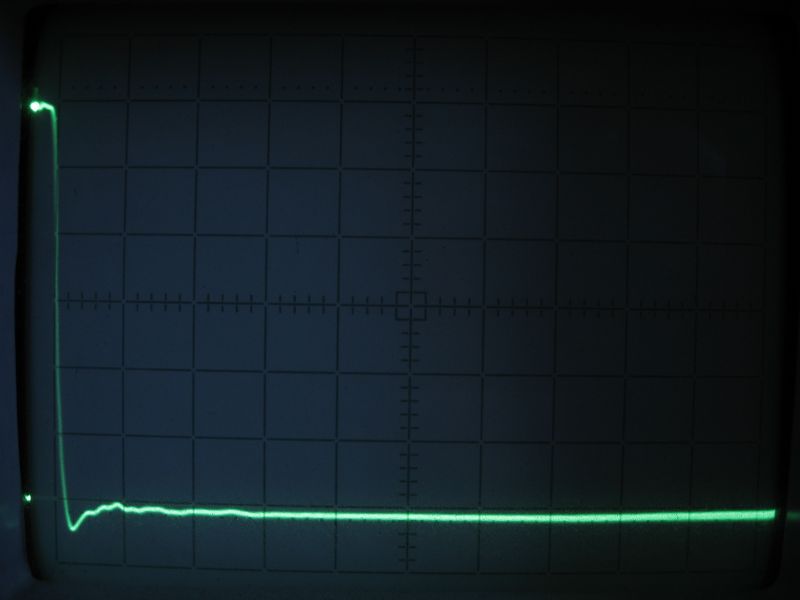

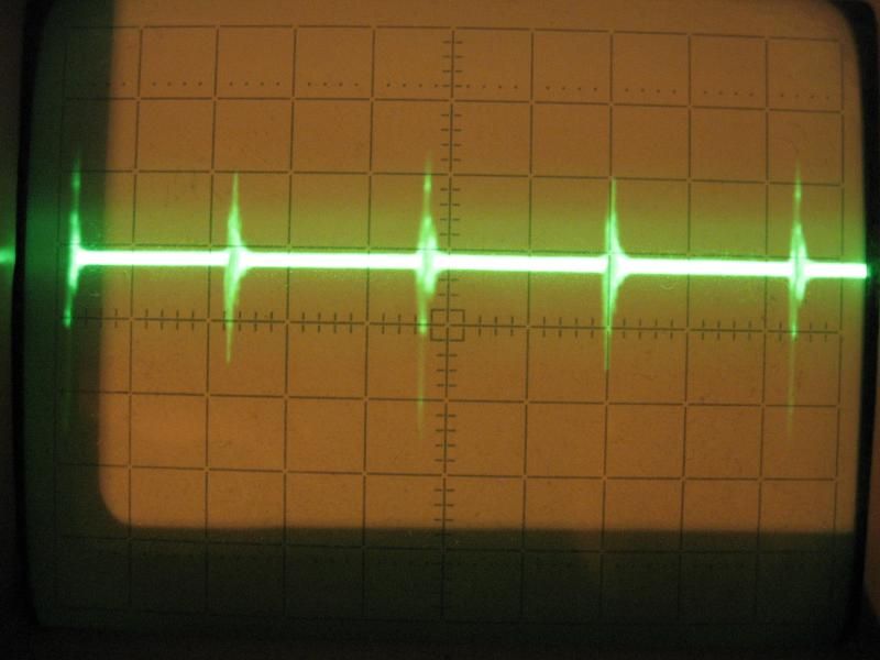

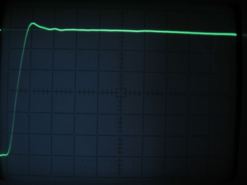

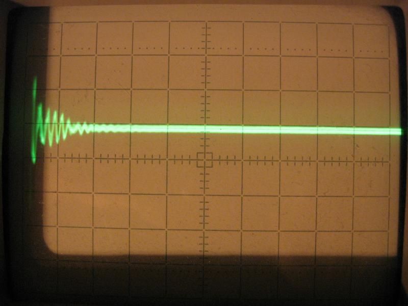

Due the fact we use a linear supply for PWM module, the MOSFET low side chopper drive, is very clean and not affected by load.
From left to right, first two pictures 2V / div. Last picture 5V / div.

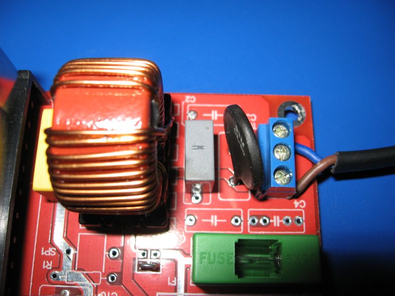

The SMPS is very stable and able to output almost any voltage from
+12V to +350V and +/- 12V to +/-175V.
An auxiliary variable supply was provided for tubes filament or any other application.
We are going to run a group buy at factory price with all SMD components ready mounted.

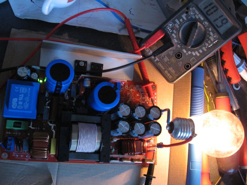

simple and good. I have a question.
what is volts out with no load and 400W? (resistive load)

For this SMPS total no load output is 102,1V
At 400W load output is 100.8V
I'll come back with more measurements.

Some suggestions:
Try to eliminate the small 50/60Hz transformer. A little auxiliary SMPS can provide isolated +/-12V and +5V while powering the primary side too, and allowing for remote turn on of the main SMPS without losing +/-12V (and/or +5V) during standby. I usually do that with Power Integrations Tinyswitch ICs and off-the-shelf transformers, part count is low, essentially using as much space as the 50/60Hz transformer, but it provides a wide input voltage range, current limiting and regulated outputs.
What you used in the transformer looks like paper and it's not a good idea because it becomes conductive with humidity. Try to get the usual polyester tape (Scotch 1298, 1318 or 1350).
The amount of RF ringing on the output is unacceptably high, it looks close to 200mV p-p, and even worse, it's probably common-mode interference. This ringing comes from a resonance that has to be damped, probably in the primary side when MOSFET d-s capacitance of the one turned off resonates with series inductance (including both TO-247 packages, PCB traces and supply capacitors to complete the loop).
Capacitance from output diodes can also resonate with trasnformer parasitics and output capacitor inductance. Damping this is quite easy: ferrite beads in series with the diodes (or just small ferrite rings on diode legs).
Otherwise, the overall layout looks good, and the will to reduce inductances and loop areas is appreciated 😉

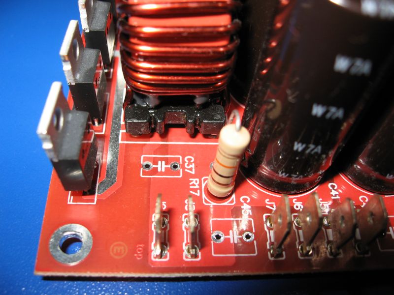

Thank you Eva for your suggestions ! I really appreciate your advices.
We suggested to use waxed paper for winding isolations, but I'll make one trafo with your advice - polyester tape.
The presented SMPS dont have 10nF output filter capacitors mounted, due the fact we didn't sourced all components for this board yet.
There are missing input filter capacitors as well.
When mounted these will clean ven more the output.
