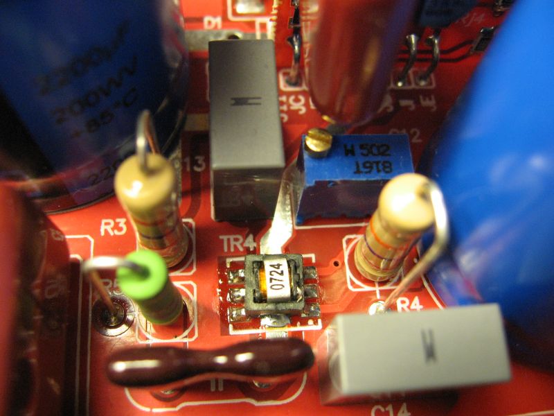

This is how to mount Tr4 and over-current protection.
Tibi

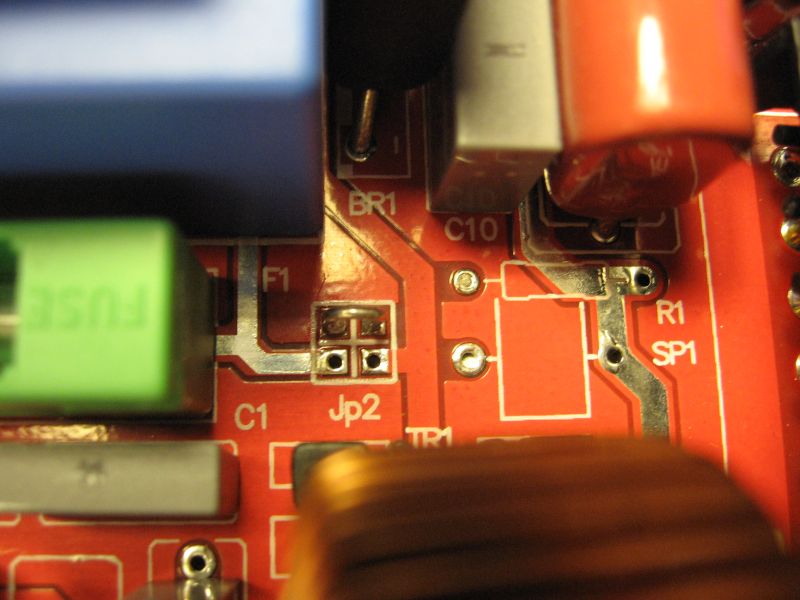

I started assembling the SMPS and I have few questions:
1. The schematic V.2 contains some (I assume very important) comments. The problem is that they are in Romanian - translators like babylon do not translate them correctly - at least in some cases the translation does not make sense. Would it be possible to change the comments into English?
2. TR1 input filter - I cannot find a suitable filter with designed dimensions. Did you do it on your own?
3. TR3 is drawn on the schematic incorrectly - as 3+3 windings wheras I supose it should be rather 2+2. I also cannot find such a transformer with double primary windings which makes Jumper 2 useless. What is the desired output voltage of this transformer? Since you use it for +15V power supply, is it 2x7.5V or 2x9V? Can TEZ4/D/9-9 from TME be used?

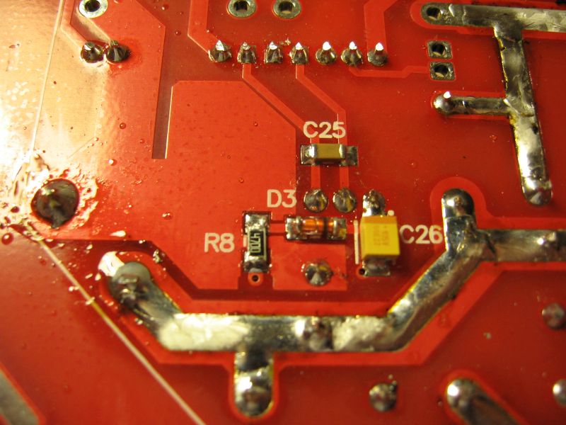

11. The problem with R12 is not clear - can you post a photo how it should be soldered?

3. The board provides various options in using TR3, including transformers like this one BLOCK|AVB3.2/2/9|TRANSFORMER, 3.2VA, 2 X 9V | Farnell România As I presume you have 220v mains, TEZ4/D/9-9 or TEZ4/D/15 are just perfect and Jp2 is useless. For TEZ.. 9-9 don't forget to connect pin 7 to pin 9 to obtain 18v on 6 - 10 pins.

11. R12 is ok where the footprint indicates. For more stability, you should follow the trace from F1 (U5) to R32, cut it and place R12.

Hello Mark,
1. Yes. Please address any concerns or issues you may have here and I'll do my best to answer.
2. You are referring to physical dimensions? Some components we have been purchased from a local distributor, but mainly these are from TME and Farnell. Seems that Tr1, made by Wurth Electronik , is no longer available on Farnell. I'll search for an substitute and let you know.
3. Yes, you are right. The trafo we use is 2+2.
You can use TEZ4/D/9-9 from TME, or TEZ4/D/15V which was indicated in BOM.

11. See below picture - red square.
It seems that TEZ4/D/15V indicated in BOM is not correct. It has only single windings and the secondary winding is connected to pins 7 and 9. It should be rather connected to 6-7 and 9-10 if I remember correctly (I don't have the board here with me).
