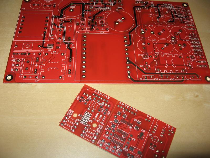

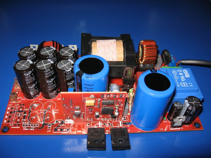

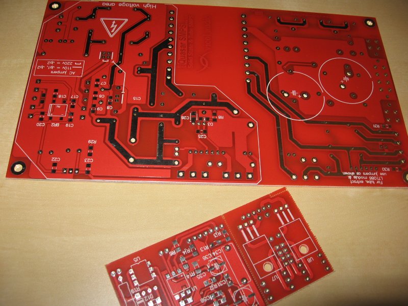

The very soon release of our project. SMPS for solid state and tubes, ver.2
From the version 1 we have improved our design as follow:
- very short path between capacitors and choppers (reducing EMI)
- very short path between IR2110 and gate choppers
- splitting control ground from chopper ground
- improved current protection
- remote control
- 110V and 220V operation
- flexibility - pcb will accept different types/sizes of capacitors
- litzwire winding for greater efficiency
- low loss EPCOS ferrite core
- +/-50V with fine trimming or +350V
- regulated + 9or12or15V and -9or12or15V or two regulated +6,3or12V at 1A

We had few minor pcb mistakes which have been corected and we'll release gerbers (from corrected version 1) to public domain. 😉
We are preparing pcb version 2 which will be more flexible and probably partially monted (SMD parts).
The new board will allow tube fanatics to have a SMPS source as well. 😀
Tibi

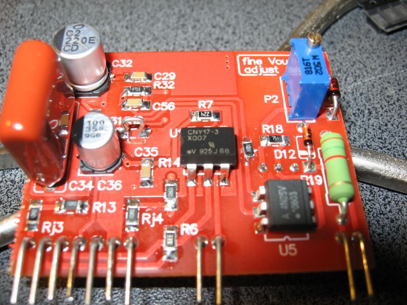

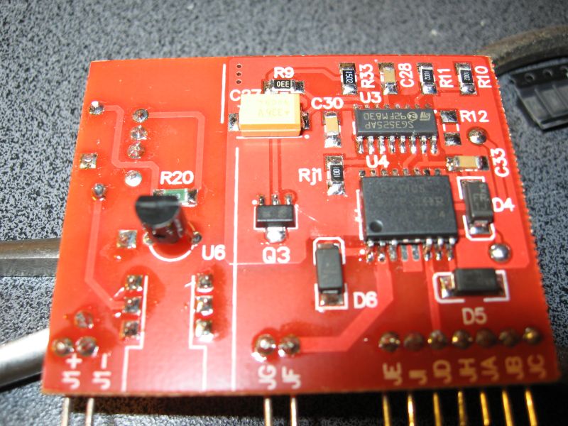

there is no shrt circuit protection out there, either current limit before shut down, i can offer that in return for two pcbs. if you wish
Version 2 have short circuit/current limit protection. You may see block schematic on vicol-audio web site, under products -> 1KW audio SMPS.
Tibi

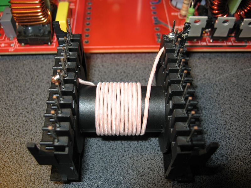

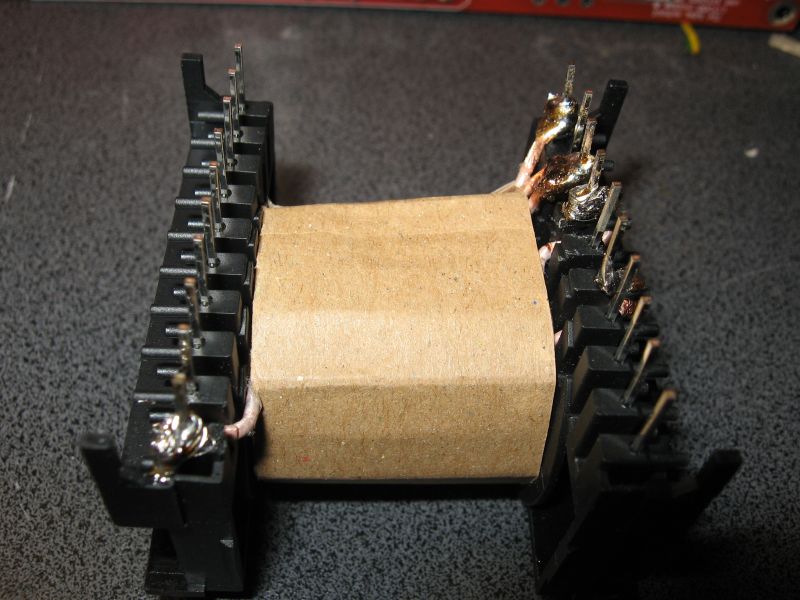

Making the trafo.

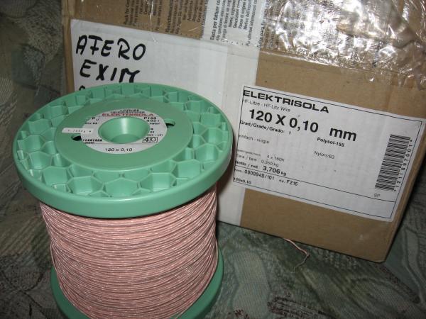

Making the trafo for a 2 x 51V output.
Use Litzwire 120 x 0.1
1. wind half of primary 12 turns
Tibi
Tibi

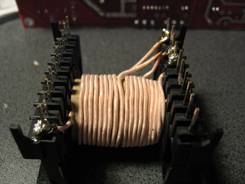

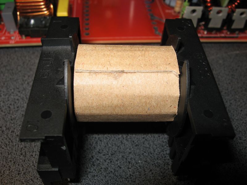

Making the trafo.
2. isolate with waxed paper
Tibi
Tibi

Making the trafo.
3. wind 2 x 9 turns secondary

Making the trafo.
4. again isolate with waxed paper

Making the trafo.
5. wind second primary part, 12 turns.
You may add an copper shielding. I didn't had copper foil so ...
The trafo is ready to be mounted.
Tibi
Tibi
