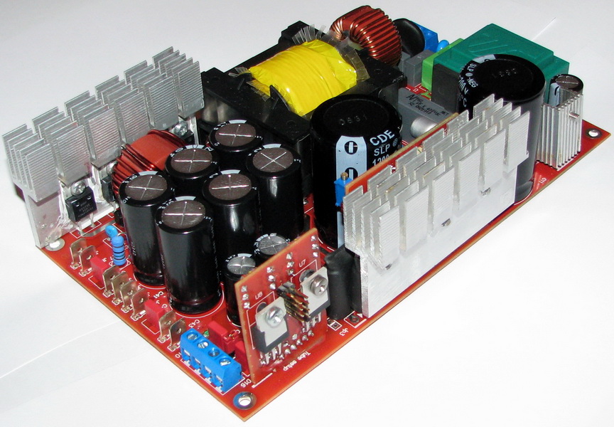

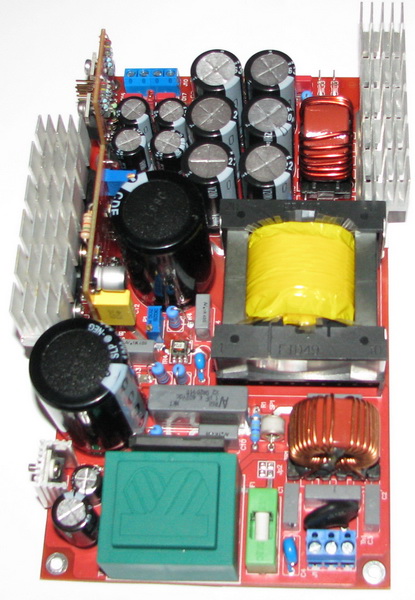

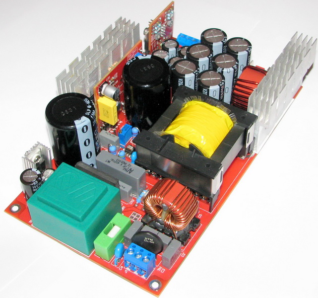

....my SMPS board is almost ready just missing some SMD resistors and can do some tests.
pictures of the SMPS
Regards Alex .
