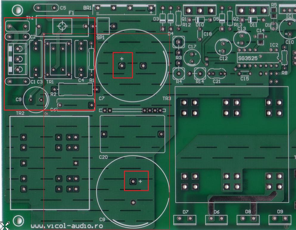

2 +2 turn are not suficient for regulate + /-15Vout.
PCB is dangerous not have the proper clearances on High Voltage area.
Pout can not exceed 600W (with FAN) for 2 ch audio amplifier🙂

Spacing on PCB I think you are right, but not sure.
Dont know about those two turns, but I think it wont deliver that power without proper heatsinks, and a FAN.

I have seen on this thread perhaps first PCB. ... this is absurd, pad on high voltage capacitor is 0.3mm!, at switch-on is clear that explodes.
This means that the person who developed PCB, ON has no knowledge of SMPS, this is tragic! endangers people.
Which exactly capacitor you mean? I will check it at home.this is absurd, pad on high voltage capacitor is 0.3mm!, at switch-on is clear that explodes

this is pcb post at first page (this thread).
4 +4 turns I think are good ( produces 23-24V on regulators (+ / -15V)
This is our first version pcb and pcb was completely redesigned.

I would like to know if the specific problem mentioned have been properly dealt with, please
About better and more secure solder pads on supply caps, right ?
Man, I once had a 20mm spark jump, just because of a loose screw on a supply cap

do not know the complete schematic and not even the latest release of PCBs.
But first pcb public in this thread, puts people at risk.

@AP2, you are refering to the first version of the board. People here are building V2. You can see it on the photos on page 7 or 8 of this thread.
