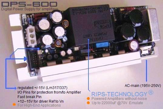

copy this .. if you can understand how it works🙂
This is what I am talking about, You should tell us from where you got this design?
Dont tell me its yours!, Cos I saw that, and fixed one very close to it.
So dont ask VICOL to copy it, cos HE wont copy. Also do like vicol and post FREE design, NOT copied designs 😀
VICOL design is not a copy!
I also like that black box: hahahah
Whats inside it?
Thanks Microsim for the support 😀. I already contacted a professional company concerning this output transformer and they ask me several detailed questions because they want to make the transformer following some security rules. They build similar transformers on a daily basis so I assume they have a reason to ask. We need detailed information on the transformer. And since such order will take several days, I need the info as soon as possible.Markus2006

Tell us what is the defrence between AMPLIFIER SMPS, AND (What We Know) SMPS?
I assure you, that I have schematics that you never saw in your whole life!
Try to be logic man!
By the way, picture above for PFC, Or complete SMPS with PFC 700W?

I have just created a psu with only 300uF at 70V to emulate 22000uF ... I think you know what that means.

It all begins when you were asking I think about how many turns tvicol, (this is already wrong) becouse tvicol must post their project with relevant safety tests (if project is public). I saw that were wrong turns, I spoke, saying that 4 turn on regulator for entry is correct + / -15. perhaps tvcol has not calculated that even under curent burst, this voltage is modulated by PWM.
I remain of the view that the errors on the PCB show a lack of knowledge by putting people at risk.
tvicol sell through this forum its PCB and no one checks that at least is not dangerous to young people who have no experience. in italy this is prohibited by law.

Maybe this is boring but I need the specification of the output transformer. I talked to professional company that makes such transformers on a daily basis and they said that there is a (security) bug even on the first photo of the transformer, which shows the first part of the primary winding. You can see it here: http://www.diyaudio.com/forums/power-supplies/149702-50v-smps-quasar-amps-others-8.html#post2038195 - post #77.
The guy from the company says that one cannot connect end of the primary winding to the right side of the bobbin (due to security issues). All primary windings have to be connected to the left side of the bobbin (if they start there) and all secondary windings have to be connected to the right side. And you cannot mix "primary" side with "secondary" side - it's dangerous. So the photo shows it incorrectly.
It seems also to me (correct me if I'm wrong) that the pins of the bobbin are counted incorrectly. If you look at the bobbin from the top, pin #1 is in the left-top corner and the numbering goes counterclockwise. I think that the project assumes that it is clockwise starting from the left-bottom corner. As a result you may easily end up with a "mirror" version of the transformer.
There are also other security issues (like specific "security margin" between widings) that were not mentioned here. That's why I'm happy that I called professional company and ask for details. I recomend to order the output transformer from such a company. This is critical component of the SMPS.
That's why I will insist to get precise specification of the transformer taking also into account various security issues.

to Mark.
is normal that the company asks the specifications of the transformer,
the specifications of a transformer, usually are 2 pages A4.
This means that it is not easy (it's easy when you look at it).
I examined the schematic and PCB (1-2 red solder).
the PSU can work ,is to be understood as a basic regulated SMPS, does not include soft-start, this may be a problem if there is a short-circuit during start-up.
does not include steps necessary to avoid introducing imd on amplifiers.
if can help you, PCB 1 and 2, do not have sufficient clearance (very too small) in the high-voltage area.
Even the arrangement of components in this area is not good.
this is my opinion. (pcb and trasf re-designed with appropriate knownow)
(even the wire to wrap the primary is wrong) this transformer has 2,67:1ratio. (wire-size) of the primary is not good.
If TVICOL adjust the PCB and publicate the measurements on amplifiers and test on security ... I think it can sell more.

This is very well known fact. On page #17 I posted example specification from Power Integrations.Hi,
to Mark.
The lack of soft-start may be a problem. Isn't SG3525 providing a kind of a soft-start?the PSU can work ,is to be understood as a basic regulated SMPS, does not include soft-start, this may be a problem if there is a short-circuit during start-up.
And how this information can possibly help me?if can help you, PCB 1 and 2, do not have sufficient clearance (very too small) in the high-voltage area.
Here you can help but instead of saying that everything is wrong, just say what wire should be used (and why).(even the wire to wrap the primary is wrong) this transformer has 2,67:1ratio. (wire-size) of the primary is not good.
General remark: you mentioned previously that the pads for high voltage capacitors are only 0.3 mm and the whole SMPS is going to explode on start-up. I checked that the pads are 4 mm and the tracks in this area are 5 mm or more. So your remarks until now are highly inaccurate. Please try to focus on what you are trying to say. Instead of saying that everything is wrong, try to tell how a specific problem can be solved.
