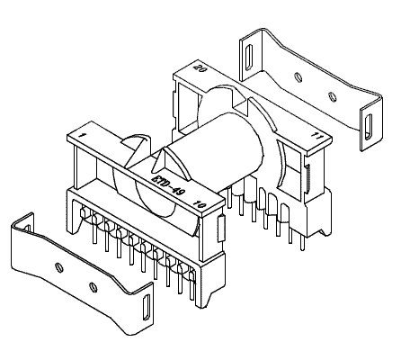

... But in your specification there are three issues that should be corrected, clarified.
First, you use incorrect pin numbers. ETD49 bobbin has pin #1 in the left top corner, and the numbering goes counterclockwise. The pin numbers are even written on the top of the bobbin. Your numbering is "mirrored". It is not a problem if you wind the transformer on your own. But if you give this specification to a professional company, as a result you will get "mirrored" version of the transformer. Such a transformer cannot be used with the board you designed. So pin #10 on your drawing is actually pin #1, pin #20 is pin #11, and so on.... It means also that the pin numbers on the schematic are also incorrect. Do you see it? ...

At the time of drawing the schematic I didn't have specs or pin numbering for the Epcos coilformer. Only this datasheet with no such details.
So, as for the trafo specs pdf you may take into consideration the "top view of the pcb" detail and do the proper numerotation. According with your coilformer notation.

I think that this drawing could help.
Mark

Looks good. It's worth to notice that this is BOTTOM VIEW (at the pin numbers are OK).
You reversed the beginning of L3 + L4 but you also reversed the direction of winding (clockwise). So I think the results are the same as I wanted it to do (as long as L3 and L4 are in the same direction).
Can you give some more details of the copper ring?
Mark
yes, L3-L4 runs contrary becouse direction is inverse. Result same.
copper foil, this ring suppresses the flow outside of the transformer. can also be very often to dispose of some of the heat (not in this case).
important that the width is within the margins of the spool (5 +5 mm from the edges).
this transformer can be built in 20 different ways, but these...are trade secrets🙂

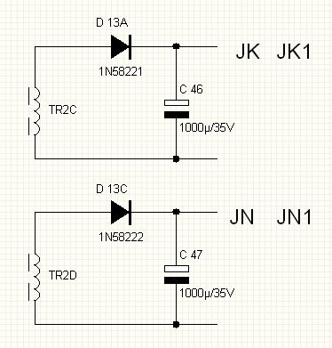

While waiting for the transformer (already ordered), may I ask for some clarifications of other issues? I need information regarding R12 and D13 diode/s.

2. Second remark - D13:
"Placa suporta 2 tipuri de conexiune: a). 2 diode independente, notate D13A & D13C (1N5822);
b) o singura dioda, cu anod comun (in principal, pt varianta sursa filamente), notate D13A & D13B (MBR3045). In acest caz, se inchide conexiunea la Jp3"
I need +/-15V and I have MBR3045. I thought that it's simple but when I look at the fact that MBR is "common-cathode" and not as you write "anode comun", and that you put a "MBR40xx" symbol at D13A diode and "MBR30xx" symbol at D13B and they have common cathode I'm getting confused. Additionally, I'd say that jumper4 should be shorted and not jumper3. Can you clarify this?
The PCB support two tipes of connexion a) 2 independent diode, D13A & D13C
b) only one diode, common anode ( mainly for filament source) D13A&D13B. In this case you will close Jp3.
Thanks Sere for the translation. But this does not answer to my questions. In my case, I need +/-15V and I have MBR3045. Can I use it? Which jumper should be shorted? Is it the diode common-anode or common-cathode? I see common-cathode on the schematic. What does it mean "mainly for filament source"? Can it be used "sometimes" for other power supplies?

Markus2006 ..for +/-15V and MBR3045 u have to use two independent diodes(MBR3045) with anodes soldered together (MBR3045 is common cathode, TO-3 case, anode -pin1&2, cathode -case ) and JP4 closed.
"mainly for filament source" .. this way of making conections is intended to power tubes filament. Low voltage 6,3-12V & more current. When u close JP3, diodes ( windings to be precise) are paralleld. For tubes close jp3, JK-JL, JN-JO and you will have two unregulated filament sources. You can use it for other power supplies when you need bigger current, nondifferential voltage.
Hmm, the more you explain, the more I'm confused. MBR3045 is a double diode and it's not in TO-3 case but rather TO247.

Are you trying to say that MBR3045 cannot be used for +/-15V power supply, or what? I'm guessing that the Jumper4 should be closed (Jp3 open) and I should use real independent diodes, like e.g. 1N5822: Expresie c?utat?: 1N5822 // Elemente ?i piese electronice componente - TME ? Electronic Components
I don't need high current. Most probably it will be 100-200mA.
