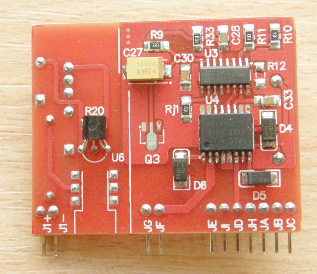

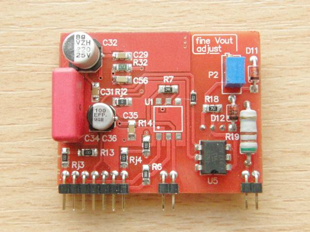

I had some time to work on the SMPS. It works but I have problems with voltage adjustment. There are two problems:
1. TL431 - incorrect resistors values,
2. error amp in SG3525 is not working as expected (this may be related to R12 change).
Ad 1. Maximum voltage for TL431 is 37V. It is set by resistors divider (R18, P2 and R20). With the values designed (750R, 5k nad 10k) calculated range of voltage change is from 36V to 52V which is definitely wrong. I decreased R20 to 3k3 and now I can change the voltage on TL431 from 15V to 30V. Also the current through TL431 (and 4N25) seems way to high (Zener diodes get very hot). I think that R19 should be increased.
Ad 2. There were some changes related to R12. I don't think that the change is correct. The error amp in SG3525 compares voltage from voltage divider (R10 and R11) with voltage from transoptor. If you disconnect R12 from ground and put it in series with IN-, the IN- is "floating" and you cannot adjust the voltage (there is no voltage difference).
So as a result I get 2x58V but I cannot adjust the voltage.
Any advise?

1. The role of TL431 is to work as a CCS and maintain a constant current through feed-back Zeners.
By adjusting P2 you will change current through zeners, but output voltage will vary in a small range.
By decreasing R20 obviously you are moving the CCS to the high current region over or near -Izmax.
2. Error amp in SG3525 is an inverted operational and this is one main reason why R12 was changed.
3. This is normal, as you are running now CCS at higher current, Zener´s will get hot.
I explained above why R12 was changed.
To get another voltage output you need to replace zenners.
Example. For +/- 60V output, use two 61V zeners or three 39V zeners.

OK, I made it running but I'm still not happy (especially with TL431). With compnent values on the schematic (Zeners 15V and 51V) I got only 2x32V on the outputs. I found out that if I add another Zener diodes in series, I get expected output voltages. I get 2x48V with 15+20+10+51 Zeners. I put 2 resistors on the outputs (8 Ohms/200W) and the output voltages were almost unchanged. The D7-D10 diodes and the switching transistors are getting slightly warm (but not hot). So everything seems to be fine except TL431. There is 0V between anode and cathode. I 'd rather expect that it works like a variable Zener diode (exactly as it is described in the datasheet). The IC is OK (I replaced it with a new one), it is not shorted and of course I'm not able to adjust the output voltage. I didn't test it but I think that if I short U6 (anode and cathode) with a wire, I get the same results - so it seems that U6 is not working at all.
Tibi, can you measure voltages on D12, D11, U6 and R19 in your SMPS? And what are the output voltages?
Mark
Mark
Markus,
The SMPS will give you exact the sum of zeners values from feedback network.
So you have 15+20+10+51=96 wich is exact what you get: 2 x 48V at the output.
Output will stay unchanged even with very high loads, over 800W will see a sighly decrease of 0,5 -1V.
TL431 was designed to work as a constant current source, please don´t expect to work in any other way.
