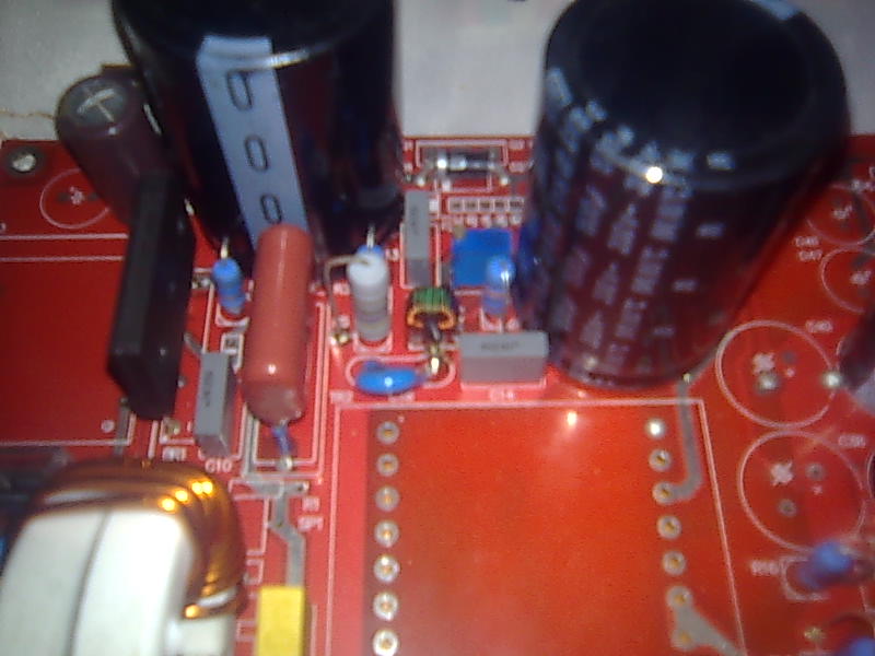

Thanks for asking. Yes, there is some progress but not that much as I would expect.
I've got the output inductor but replacing the old inductor didn't change much regarding the output noise. Another issue is that the inductor is slightly too small. It should be most probably 34 mm but due to lack of space on the board my inductor has 27 mm diameter. I assume that it will limit the output current but that's fine for me. I need only 500W output power.
I didn't change the feedback loop according to your schematic because this would require redesign of the printed board. I only added 47n capacitor between cathode and the reference pins of TL431. This improved stability of the feedback loop (and decresed slightly the noise on the output). I know that the compensation should be calculated and not guessed - I will do it in the nearest future.
The biggest gain is with snubbers. But here I found out that calculating the correct parts requires that I know the ringing frequency and the leakage inductance of the power transformer. It seems that the ringing frequency is about 10 MHz (assuming my poor oscilloscope shows it correctly). At the moment I'm looking for a simple inductance meter to measure the transformer. Anyway, changing the snubbers helps a lot.
Another question: on the secondary side shouldn't the snubbers be in paralel with the diodes - I've seen such schematics?

if you have no space for a bigger inductor try to find a High-flux type core and use this for the output inductor.
add a 2k2 resistor in series with a 22nf cap instead of a single 47n cap on the 431 legs.
i suggested you to connect the snubbers on the transformer windings because is the only resonable place to put them due to the faulty layout. they will perform almost as they are connected in parallel with the diodes.
the self resonance of the transformer happens at a frequency much higher than the working freq. usually in MHz-10's MHz range, due to the parasitics of the transformer

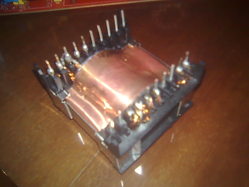

Answer:

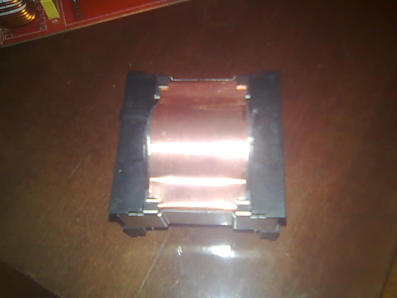

numarul de spire se calculeaza in functie de inductanta necesara dupa formula L=Al*ts^2 unde L este inductanta bobinei in uH, ts numarul de spire, Al permeabilitatea miezului.
the number of turns should be calculated with the following formula: L=Al*ts^2 where L is the inductance value in uH, ts, number of turns, Al is the core permeability.
recomand o valoare a inductantei de 40-70uH pentru fiecare infasurare, valoarea nu este critica, dar o valoare mai mica va creste curentul de varf prin tranzistorii din primar va cere un curent de sarcina mai mare pentru ca sursa sa functioneze in mod continuu, iar o valoare prea mare va satura miezul la curenti mari si tranzistorii din primar vor lucra cu curenti de varf mult prea mari.
i recommend an inductance value of 40-70 uH for each winding, the value is not critical, but too low will increase the peak current through the primary mos-fet's and the smps will work in discontinuous mode, and a larger value could saturate the core when the output current is higher.
miezul recomandat e un tor de 30-36 mm diametru exterior, culoare verde deschis cu fasie albastra pe o parte, bobinat cu 2 conductoare de 1.2mm diametru, 42 spire. una din infasurari va avea capetele inversate intrarea cu iesirea !!! nu recomand miezurile ieftine galbene cu alb, au pierderi mari si se incalzesc. la frecventa la care se lucreaza si amplitudinea tensiunii varf-la-varf nu e o problema capacitatea parazita dintre spire, deci se poate bobina in mai multe straturi, oricum exista capacitate parazita intre cele doua fire prin care circula curenti de polaritati diferite din moment ce sunt bobinate in paralel. e nevoie de snubbere calculate sa amortizeze oscilatiile care pot distruge diodele.
for the output inductor use a 30-36 mm outer diameter powder core green-blue strip winded with 2 wires of 1.2 mm diameter in parallel, 42 turns. one winding must be 180* out of phase. i don't recommend the yellow white cores, they have high losses and become hot. at this working frequency and pk-pk voltage swing there is not an issue to wind the core with multiple strands, anyway there are two parallel wires which carries opposite currents with significant capacitive coupling. snubbers are highly recommended, sized to damp the oscillations which can kill the rectifier diodes due to overshoots.

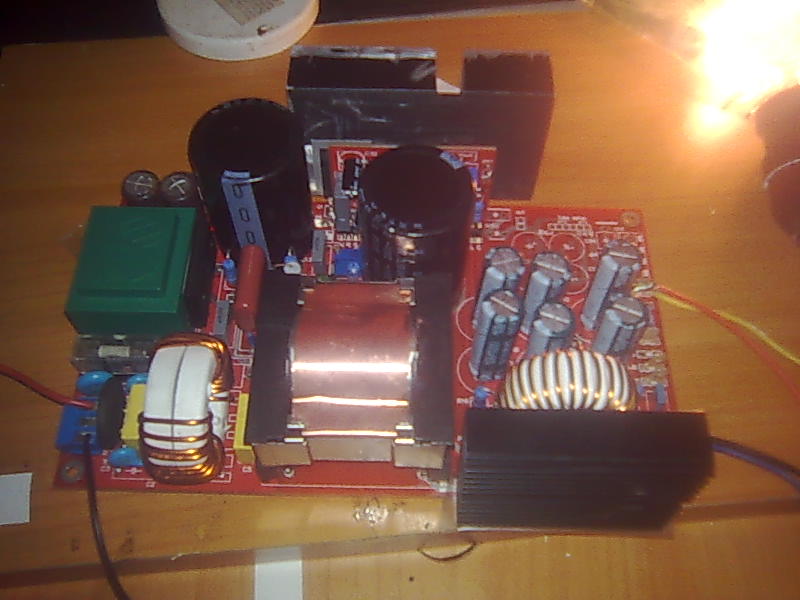

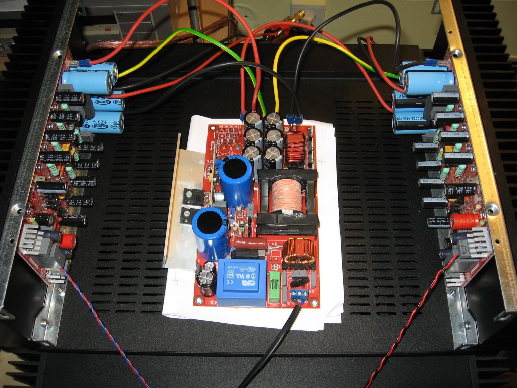

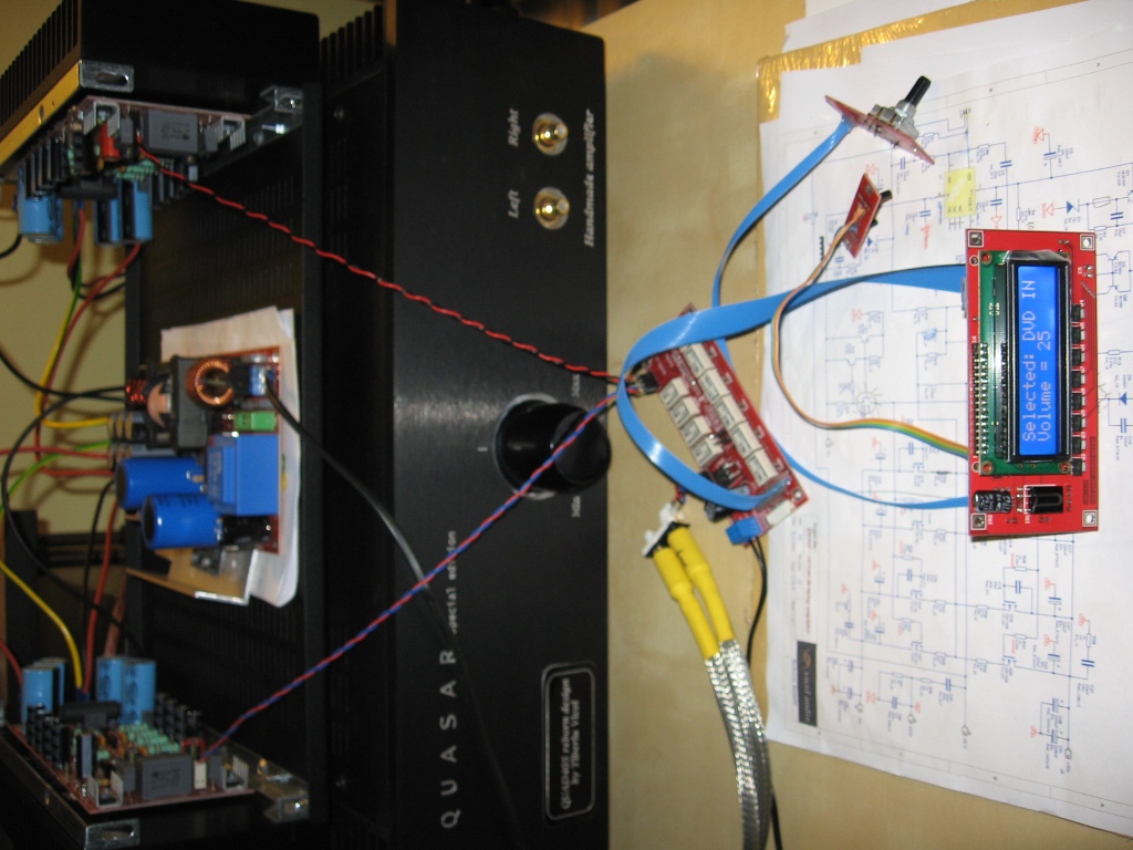

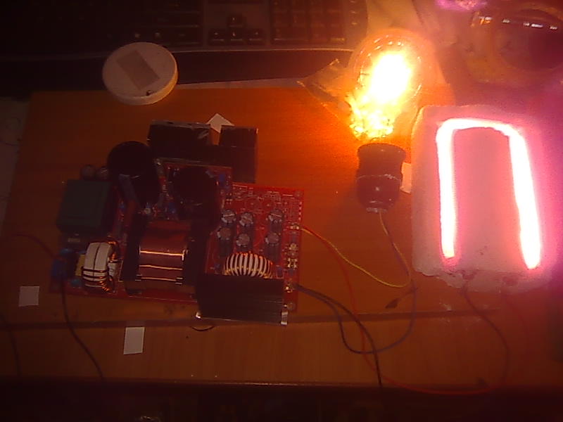

Good morning to all of you, scz my poor english. I made this source after i have red all the information from the romanian forum, and it worked from the first time, if i can i will post some pictures
