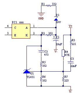

there are few more problems than those which you mentioned till now.
since the "rats already abandoned the sinking ship" and seems that there is no chance to get help from them anymore (either because they don't care or simply don't know) i will provide you some help to make this ..... work.
take the schematic which was posted before and make the following changes:
first of all, i consider that the pcb is made according to the schematic, if so, change the following:
1. secondary snubber: R15, C37. it has wrong values and it is useless because is placed after the output inductors. use instead 2 snubbers with capacitor value of 470pF and resistor 22R at >3W in parallel with each secondary winding.
2. for the output inductor use a 30-36 mm outer diameter powder core green-blue strip winded with 2 wires of 1.2 mm diameter in parallel, 42 turns. one winding must be 180* out of phase.
3. use the arrangement from the attached schematic for the error amp. this has also compensation and is working stable.
4. decrease the values for Rj3 and RJ4 to 3.3R otherwise the MOS-FET's might blow-up soon due cross-conduction.
5. change C56 to 22nF and add a 33K resistor in series. the upper resistor with just smd marking should be 56k.
6. chage R8 IMEDIATELY BEFORE THE C26, P1 AND TR4 WILL CATCH FIRE !!!! THIS IS A SERIOUS PROBLEM!!!! PLACE IN PARALLEL WITH C26 A RESISTOR WHICH WILL SET THE MAXIMUM CURRENT FOR EXAMPLE 47R not bigger value than 100R.
7. add a 4k7 resistor in series with the pot. and change the pot to 1k otherwise you have very narrow overcurrent limit.
8. on the pcb, cut all the pins of the IR2110 which are not connected. there are few pins which are not used to provided the necessary clearance for to withstand high voltage. this aspect was completly ignored in the design, can see from the pictures.
9. increase the value of C34 to 0.47uF or the ic will enter in UVP mode in certain situation. can connect in parallel a 10uF cap.
10. decrease the value of C9 to 2.2nF to regain the loop stability. in case of instability, remove this cap. you can hear the transformer buzzing or making annoying noises when the loop is unstable.
please make the changes and tell us the result.

Christi, you are right. When I started this SMPS, several guys claimed that it is too difficult for me (I had never build such a SMPS). But I build it and it works. It has some problems but I intend to solve them (hopefully with you guys :D). I had to learn a lot about TL431, about feedback loop, transformer winding and stuff like this. I'm very grateful for your help (Christi and AP2).
One question Christi; in your schematic of the feedback loop it looks like you are tracking the voltage between V+ and V-, which I tend to consider a mistake. What happens if you put an unsymmetric load on the output? Will the output voltages be still symmetric? I had such a case with an 200W MOSFET amp which had unsymmetric input stage. And as a result, the voltages were unsymmetric. I think that it is enough to track one voltage. The other voltage will rely on transformer winding closely coupled (if this is the correct term). Have you done such test?

the feedback which i'm using alows a very tight regulation between both rails, even if one is unloaded and the other is fully loaded. for example, a A1000SMPS with output set at +-60V, if i load one of the outputs with 8A, and the other one, zero load, the output voltage will be about 59.7 on the loaded one and 60.3 on the unloaded one. and the voltage between the + and - rail will be the same, 120V. who have a A1000SMPS can have a try :).
the idea is simple. first, the output inductor helps a lot to cross-regulate the outputs, since is winded with equal number of turns, in parallel, and has a very low lk. inductance. just remember that one of the windings must be 180* out of phase. then the error amplifier is biased from GND as well, not only from positive rail.
Markus, have a try and tell us the result.

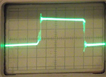

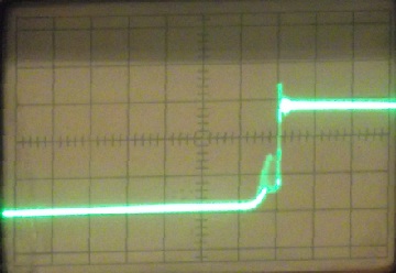

I did some tests with snubbers on the secondary side of the transformer. The signal does not look good and after adding a snubber directly on the transformer secondary winding it does not change much. Can you take a look at the photos below? You can see that the rising edge of the signal looks bad (but please take into account that the oscilloscope is not of the highest quality). Can this be caused by gate resistors, or is it leakage inductance of the transformer? Most probably adding correct snubbers would require a much better oscilloscope.
The load was 200W.
Mark

return at smps...(Fortunately your oscilloscope shows in very slow transient mode .. eheh!)
RFI-EMI is up corner of square wave.
very high harmonics (needle in fast oscilloscope will be very large).
I do not have the present scheme with modifications. perhaps I can see some value eg. what is value of snubbers on primary? (RC)
