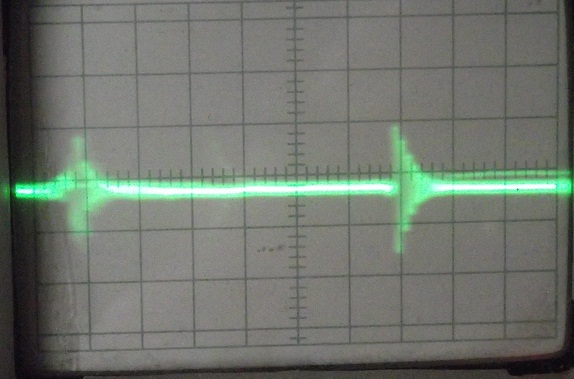

I can do only part of it. It's due to fact that I'm leaving tomorrow for 1 week (I'll be in Montenegro - I hope it's not that hot there ).Hi Mark,
You can show measure on output dc (noise) with oscilloscope?
also pwm on primary trafo (with 50%load at output)? (or pwm at secondary power in ac) if you not have ISO probe.
I see this for understand problem of noise at output.
Please take into account that my oscilloscope is not of the highest quality (and I don't have a current loop).
The photo of the noise on the output was taken with 100 mV/div. The noise level greatly depends on the feedback loop settings.

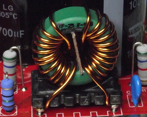

I think that I know the reason for the noise: a typical common-mode choke cannot be used as an output filter. Such a filter should use a different magnetic material and the windings should be connected differently. At least that's what I think. I need some time to verify it.
At the moment the most important issue is the feedback loop.
I did some tests but I had only 4x100W resistors mounted on a heatsink and during the tests one of them started melting - I need a beeter load.
Mark

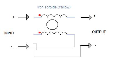

Hi Markus,
yes, in fact completely wrong, the toroid (material) and also the winding.
you have a toroidal iron powder (yellow)?
In this type of output circuit, the toroid to be used as impedance block and not as output filter. (in the picture the toroid used and the type of winding is typical of the EMI filter.(Ferrite and common-mode winding)
Simple 2-wire coil in parallel but the polarity of input must be reversed (see pic)
on 30mm diameter, it is possible to wrap 14 turns (2x1, 24) or 16 (2x1,12)
after this it is convenient to Add the linear filter output (this psu does not have)
Regards
Regards
Thanks AP2. I'm glad you have confirmed my findings; a different material and a different winding connection. I'll test it when I come back from Montenegro.Hi Markus,
Is there a chance that it will decrease the noise on the output?
BTW, I checked that this noise is not audible in a speaker (I used 200W amp) but I still want to get rid of it. Can you give more details on the linear filter on the output you mentioned?
