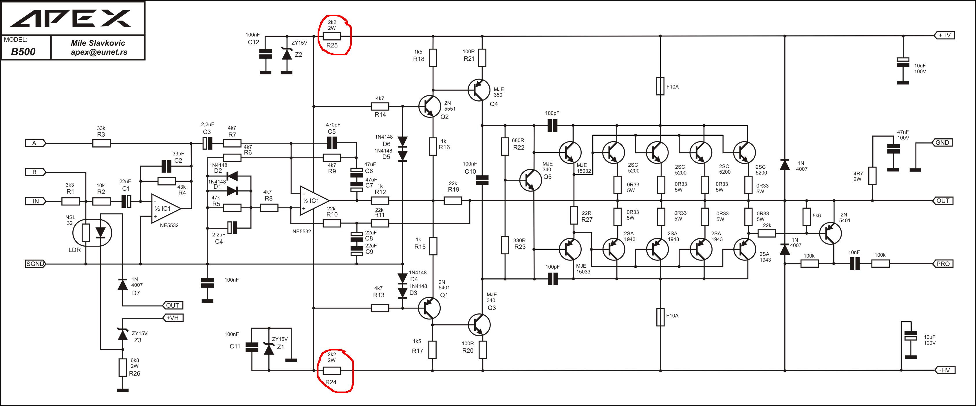

Nice work, small offset positive or negative is normal.
I suggest to use red LED, did you measure ldr resistance whan led off and on?
2k2/2W must be hot, for +/-85V use 3k9/5W or two 8k2/2W in parallel.

Hello Apex,
Yeah I did use red LED, the green one is only for testing.
Test procedures made with red LED/LDR assembly:
1. Resistance when LED is off roughly it's @ 800K - 1M.
2. Resistance when LED is on it's @ 300 Ohms.
I have seen lots of post for the step driver circuit and some have corrections. I wonder what's the correct circuit to use and the proper wiring for the said circuit. Can you post the right ones please?
Thank you once again!

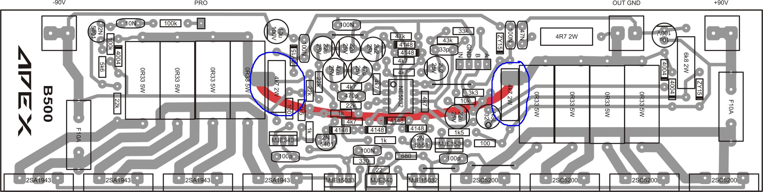

This is the pcb i will be using for regulated psu 75-0-75, is it fine.

marked🙂 in blue

Hi, Apex.
I have some minor problems with your B500 amp:
1. When I connect +/-63V, there is about 50mV on output.
2. 400mV on input.
3. Resistor 22ohm is little darken, but no change in resistance.
I had used 2 pairs of output transistors 2SC5200/2SA1943, and MJE15030/15031, 4K7/2W resistors.
ZD12V and TL072 are only changes. And I didn't have 33pF capacitor, so I put 47pF. 😱
Can you help me to locate source of the problem? Please sir.
Regards 🙂
