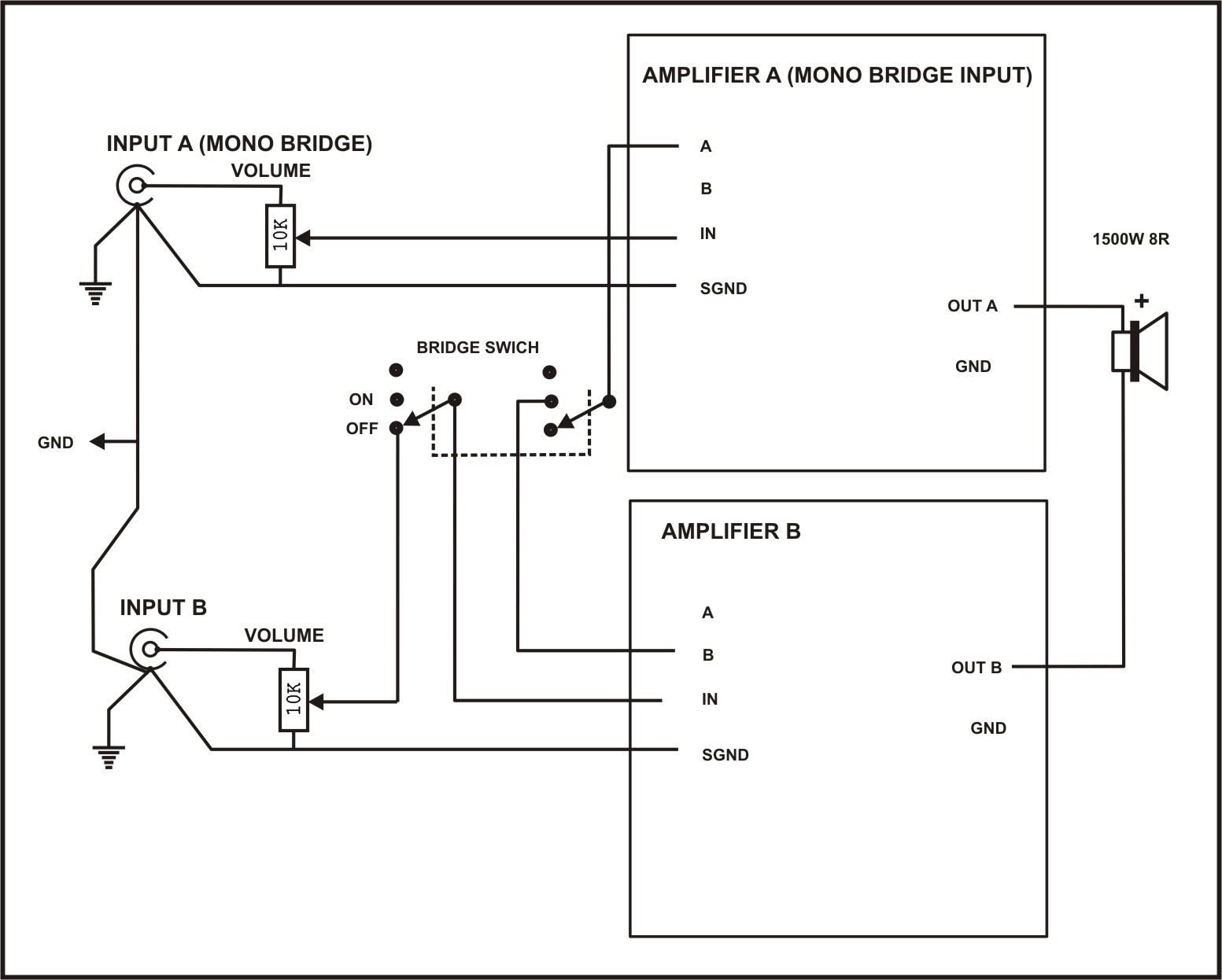

thank u man i want to builb this but i am not sure what should be connected on ponits A and B, and PRO. please help i need this cct
Point A and B is only for bridge mode, and PRO connect to PRO pin on PA protect. Amp will work without connect A, B and PRO pins.

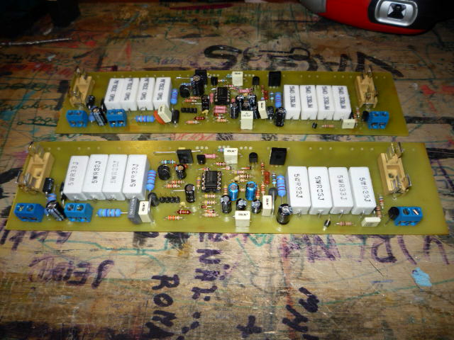

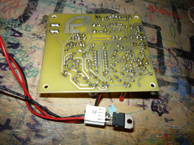

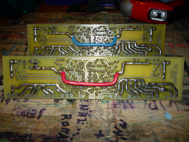

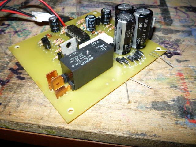

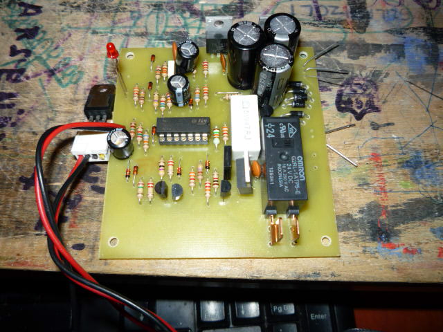

Hy! I post some pics, comment it if you want.
Apex: I modified the protect board, i hope you don't mind. I used my favorite relay, and so the board needed to be modified.

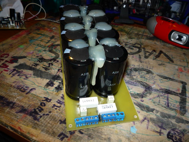

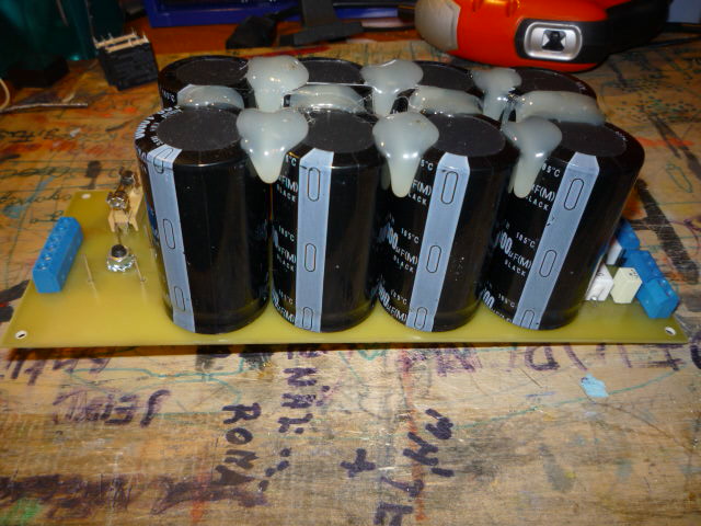

I also made a psu, 80.000uf/100V total, i hope this is enough for 2 of this B500 amplifiers.

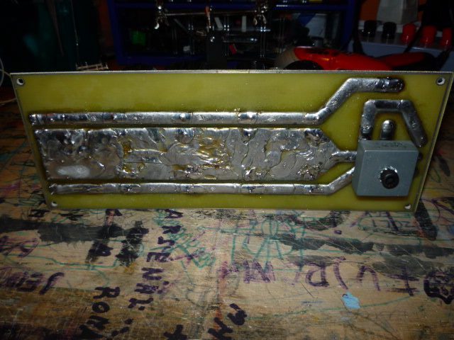

My PSU PCB
Hy! I am really happy, that someone is interested in my work, as soon as i get home from work, i can attach the PSU PCB in sprint layout format (.lay) 😎
which power supply do u use?can u share the layout and top.
Psu lay
Hy! Here it is as i promised.
I used the diode bridge as shown on the picture
View attachment psu.zip
It is very simple, as you can see, only 1 diode bridge, fuse holder, capacitor bank and 2x100nF/100V at the end.

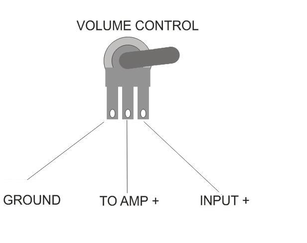

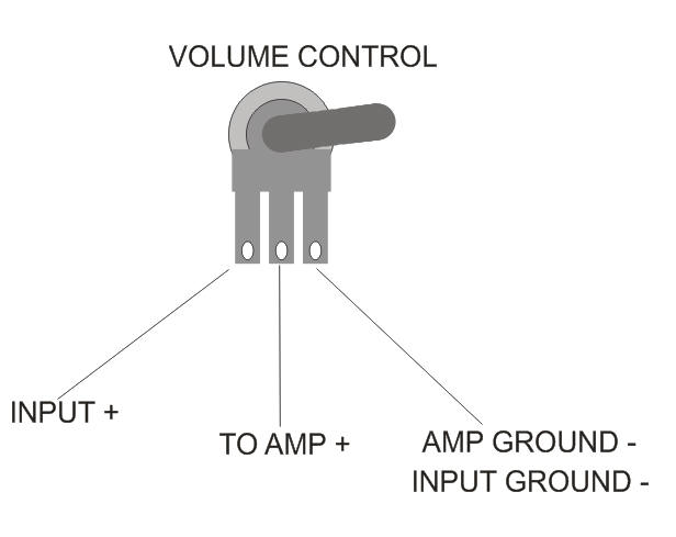

Hi.
with the knob towards the operator and the 3 connections pointing down, you have a pot that gets quieter as you turn the knob clockwise.
Most listeners prefer clockwise for louder. This requires you to swap common (Sig Gnd with Input)
You can "see" this mechanically.
Turn the knob fully anticlockwise. The wiper will now be positioned at the stop next to Input. Wiper taps off maximum signal level (=loud).
Turn the pot fully clockwise till the wiper hits the Common stop. The wiper now taps off a near ground signal level (=quiet)

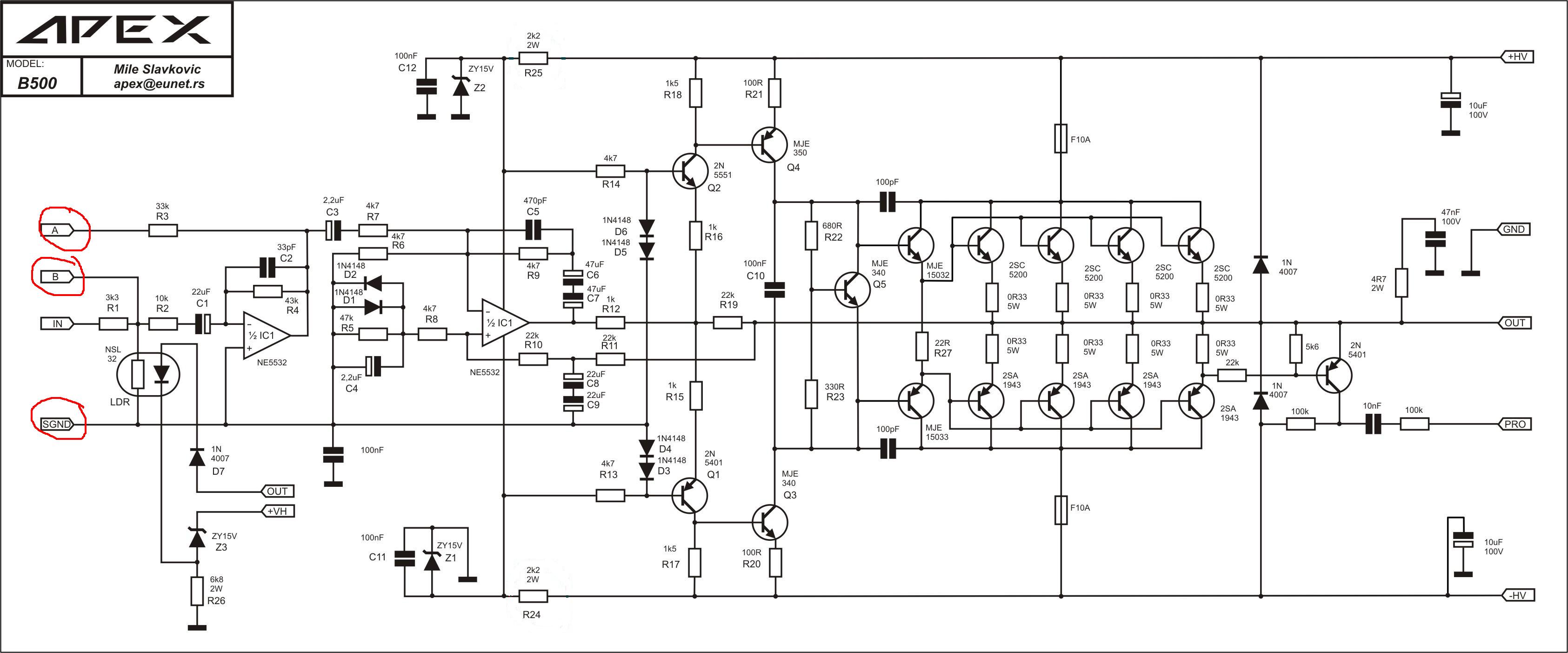

how to use volume pots in a balanced input amp(like b500 in grouond A+B )🙂
apex,
A, B pins are for bridge no for balanced input, go to post #54.
sir,
not this bridge,
but i mean balance input using one channel only grnd,a,b
sir,
not this bridge,
A and B pins can not be use as balanced input without change schematic.
