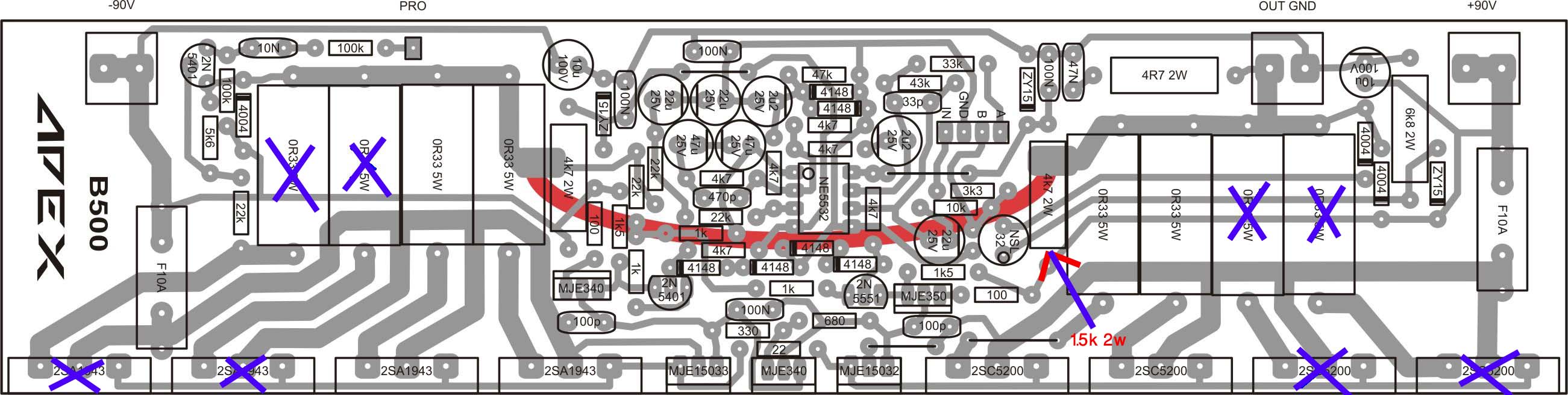

Hy Apex! Please help me! I measured the amp last time before i pack it together, and one of the panels show 0.3V dc offset! The other one is fine, that is 0.2mV. How could I start to measure and where? Would it help if I post pictures?

Measure voltage across Z1, Z2, R20, R21. Try to use mached 2N5401/5551 and MJE340/350.

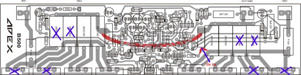

Checked voltages
Hello! I checked the voltages, the L and R indicates wich panel I am talking about. The R is the one with the high DC offset, the L was good so far.
L Z1: 14,2V
L Z2: 14,4V
L R20: 446mV
L R21: 440mV
R Z1: 14,7V
R Z2: 14,3V
R R20: 444mV
R R21: 438mV
I used matched transistors (from the same series, and they were chosen from 15's batch with multimeter's HFE) and i used the closest possible values.
When i connect signal gnd to power gnd every reading is just fine (7-8mV offset on both panels) the 300mV offset only occours when the input pins left floating or the signal gnd is not connected to power gnd.
If it is a solution, to connect them together, then it will stay in this state.

Voltages are OK. Use this GND wireing if there is not hum and noise.

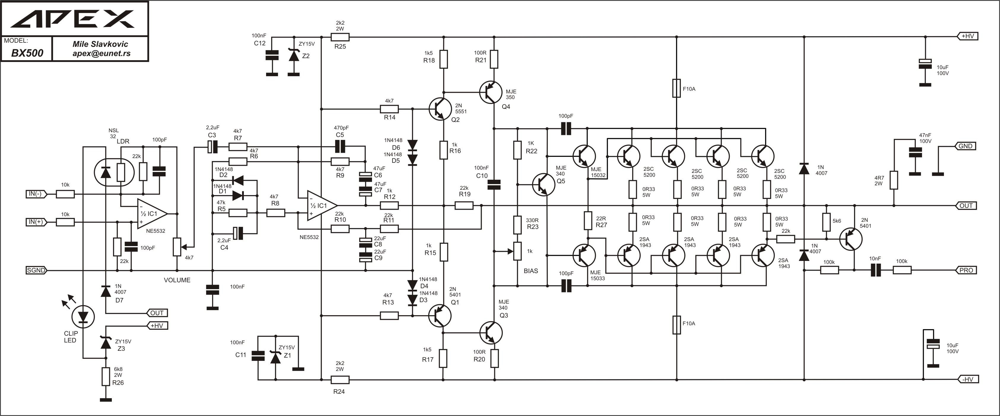

BX500 PCB design
I cosidering to add signal led, fan control, VI limiter, triple darlington...
Hi Miles....you mentioned that you were going to add these three things, are you redesigning the B500 pcb....I have added the indicator leds to my personal version of the pcb, but would like to see what your design comes out like...it is getting a bit too much for me to modify now, but I do like the XLR input stage you added a few days ago, it makes a lot of sense and actually saved me another board that had a preamp on it...less is better..still waiting to see how you will redesign the B500 to become a BX500.....
