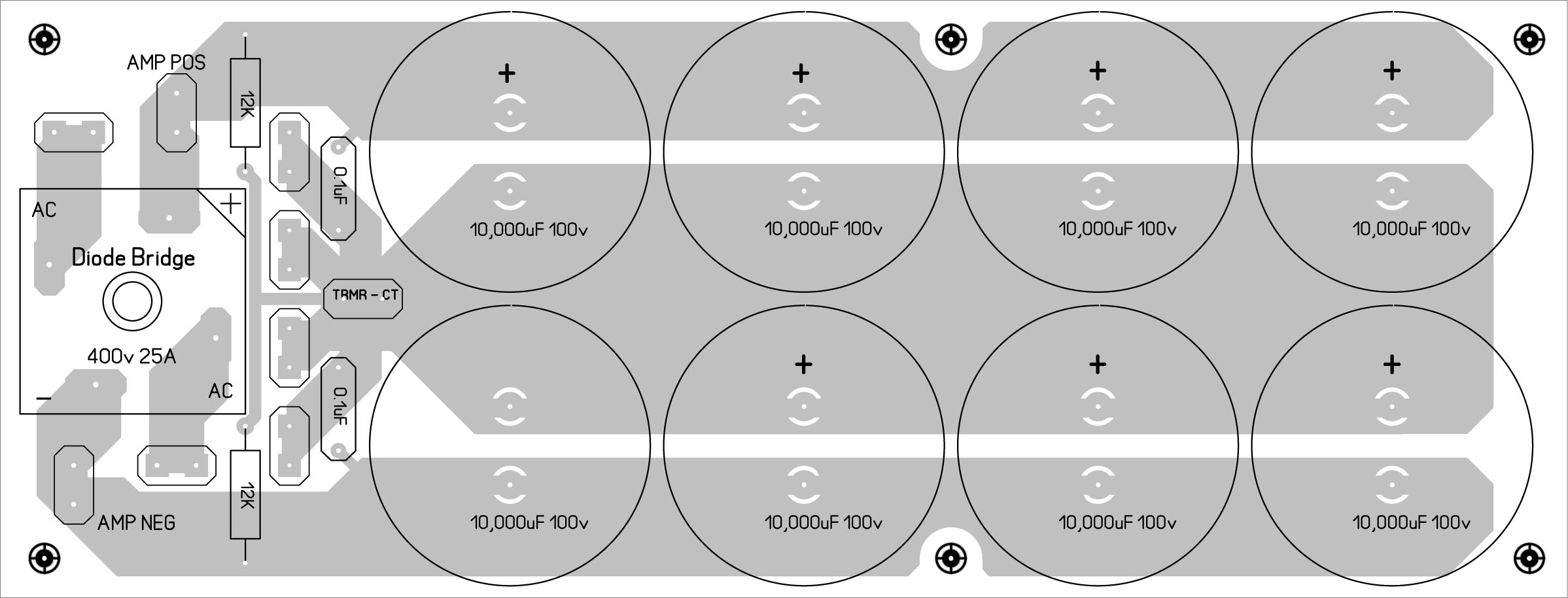

Regulated PSU for dual B500
mean while can you post a circuit board design for a dual B500's PSU

Hi Miles....thanks for all your help and designs...I have a question, this Regulated PSU you listed, is similar to the PSU-5 that was listed some time ago, but this design has two more 10000uF caps and another pair of 2SC5200's....do you have a updated circuit board design that will carry these last modifications.....I am still going to use the Amp Protect board, I just want clean power supply. I am build a pair of B500's back into a MC2 T1000 amp case...it failed late last year after several years of abuse in a night club....it has a good toroidal tranny and other bits, but I would rather rebuild it using all APEX designs.....will post pics as things happen.This Regulated PSU can be use for B500.
thanks...
toroidal tranny..
hey gooseneck....was not going to 'unwind' the tranny....am going to use it as it is....as I said 'it is from a T1000 MC2 amplifer' that burnt out...and is too costly and difficult to repair, so am going to use all the hardware from the T1000 to build a dual B500...ok..the T1000 is a dual 500w / 4ohm amplifier, so the tranny is just right for the project, the PSU gives 90v +-, 15v +- and 24v.no its not a toroid transformer...difficult to unwind...

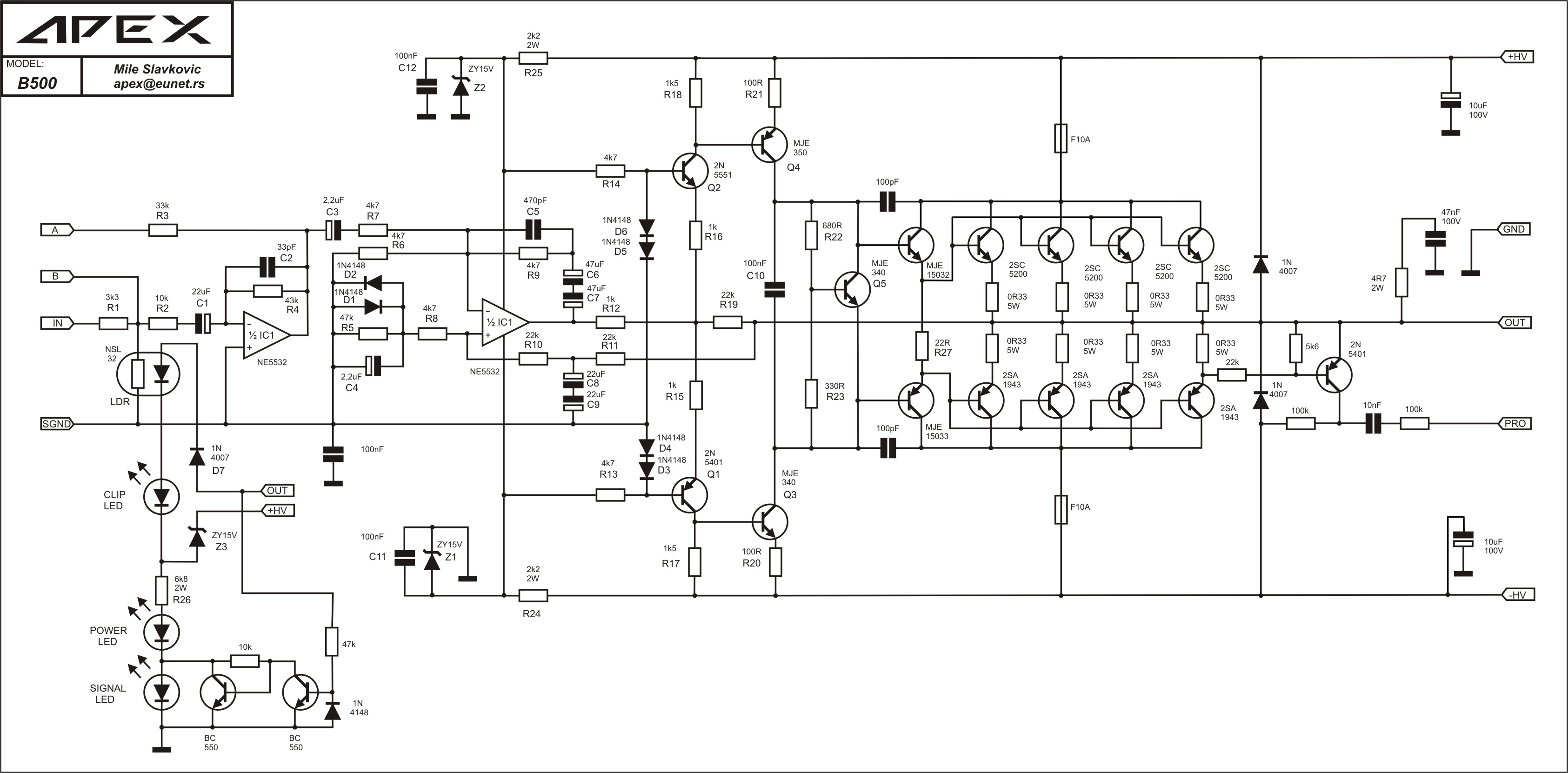

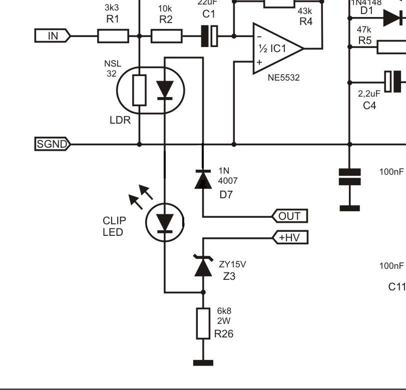

Hi Miles...was looking for a 'clip LED' addition to the B500 and found this circuit you posted the other day...even went back into my files and modified the pc board layout to accomodate the clip LED....and the component layout.Add LED in series with LED integrited in NSL32, and you have clip/limit indication.

'Bridge led' can be add in series with 'power led' and shorted with bridge switch...
B500 with led indicators...
thanks Miles, will now work on a small 'add on' board to power up the LEDS'Bridge led' can be add in series with 'power led' and shorted with bridge switch...
B500 with LEDS...
actually am going to add these extra LED's to the existing B500 PCB, bit of a squeeze but hey, why not, if any one else is trying this, please post your results...thanks Miles, will now work on a small 'add on' board to power up the LEDS

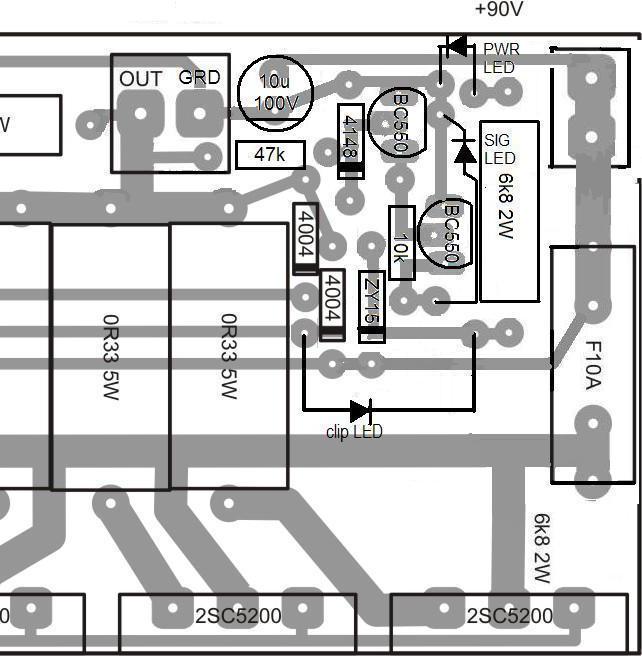

B500 PCB with Clip, Signal & Power LEDS

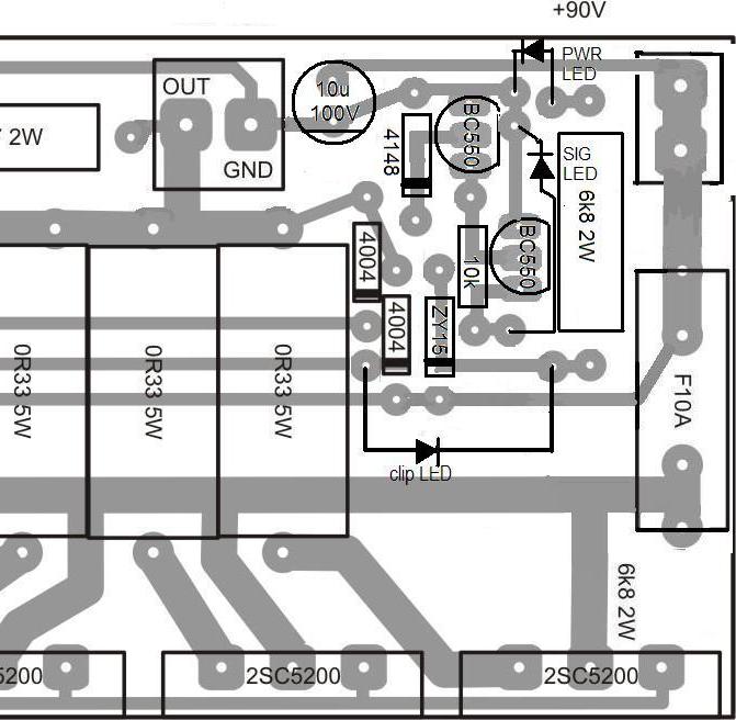

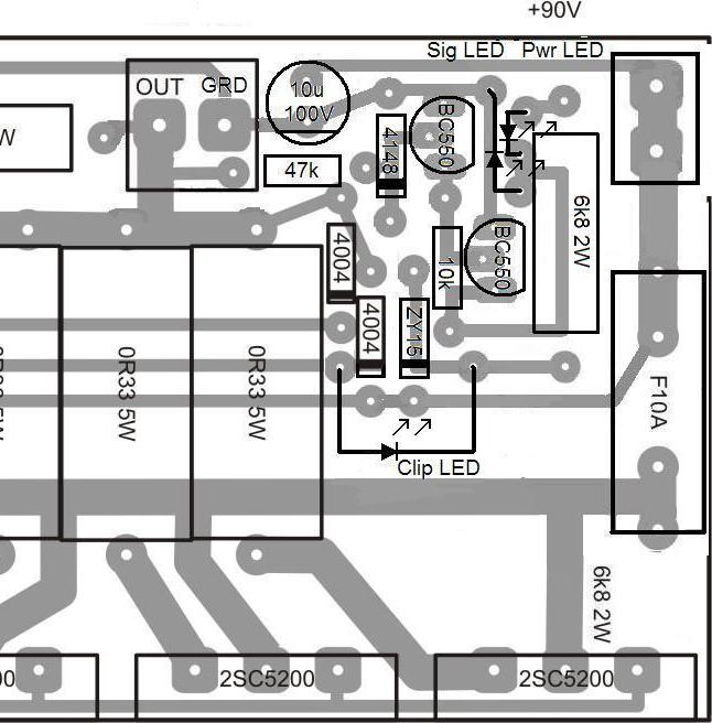

Hey Miles, could you check out this possible PCB layout and tell me if it is ok...a bit of a squeeze and all done in MSPaint...cause none of the pcb & circuit design programmes can read JPEGS and I did not feel like redrawing the entire circuit just to get these LEDS onto the PCB...so I did it the old fashioned way.
Wish you would load up a design file, so the PCB could be altered properly...it would also give a better image for etching.

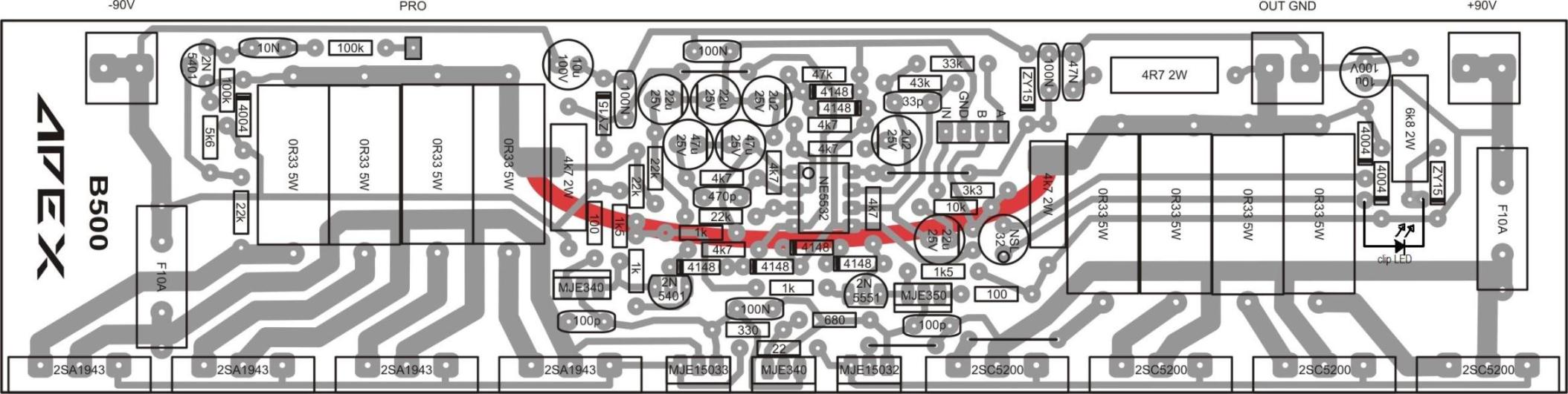

Any way hope you other guys have fun doing what you are doing. Here is the busy end of the B500 board with LEDs..the rest of the board did not change....looking forward to your comments Miles.

You forgot 47k...
B500 amp with LEDS...cntd
thanks Miles, a second pair of eyes is always good for checking stuff...
actually on my pen sketch drawing that 47k is there and I even made space for it on the layout drawing by moving the 100uf cap out of the way, but forgot to put it in the 47k.....here it is now...thanks for your time Miles...ciao

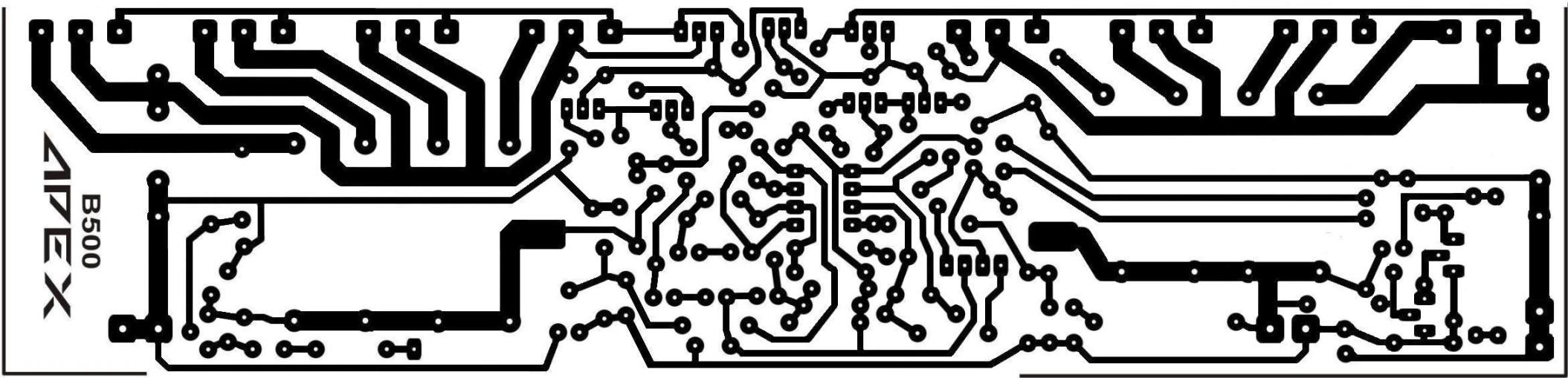

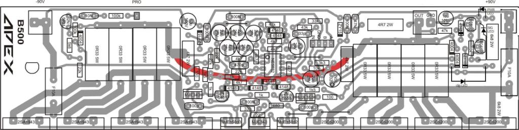

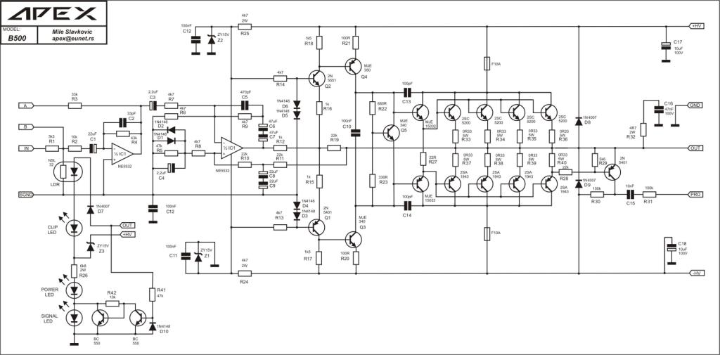

B500 with LED's

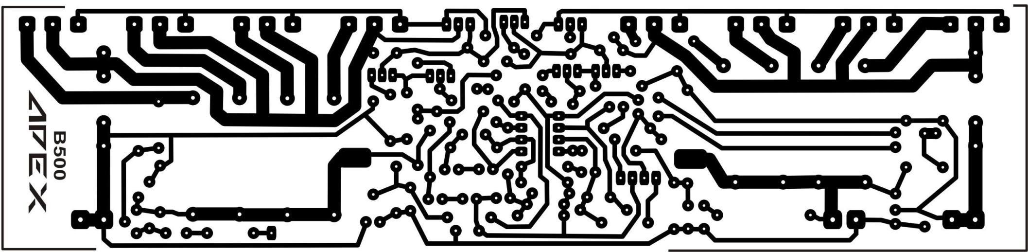

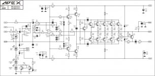

Ok here is modified B500 circuit that Miles generated and then all the components overlaid over the pcb with the 47K as it should be, and then the copper side of the pcb....would like to see what others think of this?
I am now shopping for all I need, a lot of the R's and some of the C's will come out of my stock on hand, the rest I will get from Sim Lim Square in Singapore.

You have mistake on your pcb: power led catode must be connect to signal led anode not to gnd.
