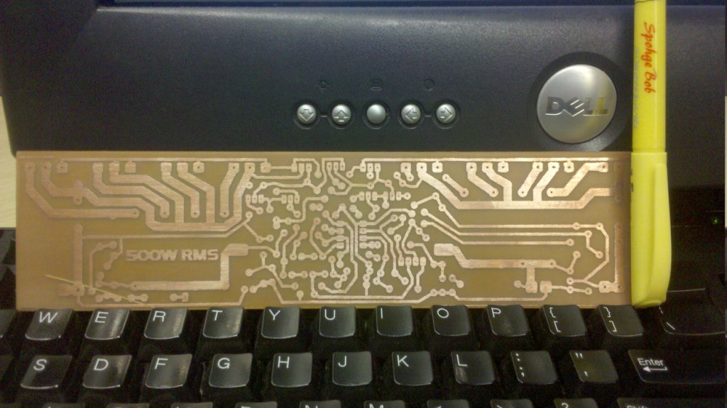

hi, blueice23 how did u made the pcb? lazer toner transfer method or screen printing?

Hi Nazirdigi,
Yes, it was indeed made with laser toner transfer method. I will make a stencil soon so that i can print it using silkscreen for better quality.

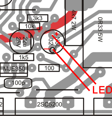

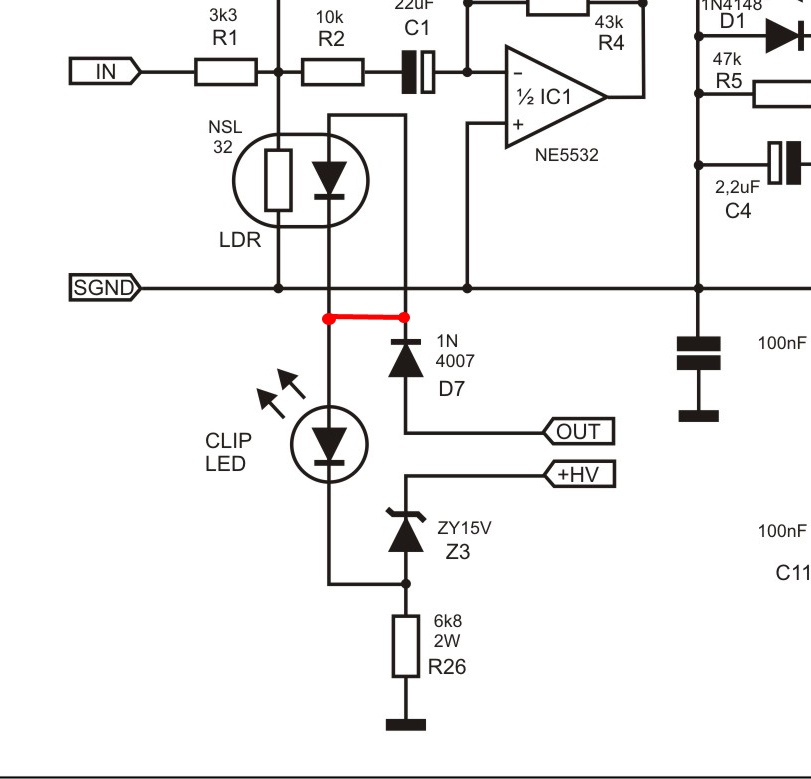

IS THIS CORRECT?Add LED in series with LED integrited in NSL32, and you have clip/limit indication.

Yes, if you don't want use limiter.
IS THIS CORRECT?
WHITHOUT CLIPPING.
WHAT IS LED DOING?
IS THIS CORRECT?
WHITHOUT CLIPPING.
WHAT IS LED DOING?
LED will blink at high power🙂

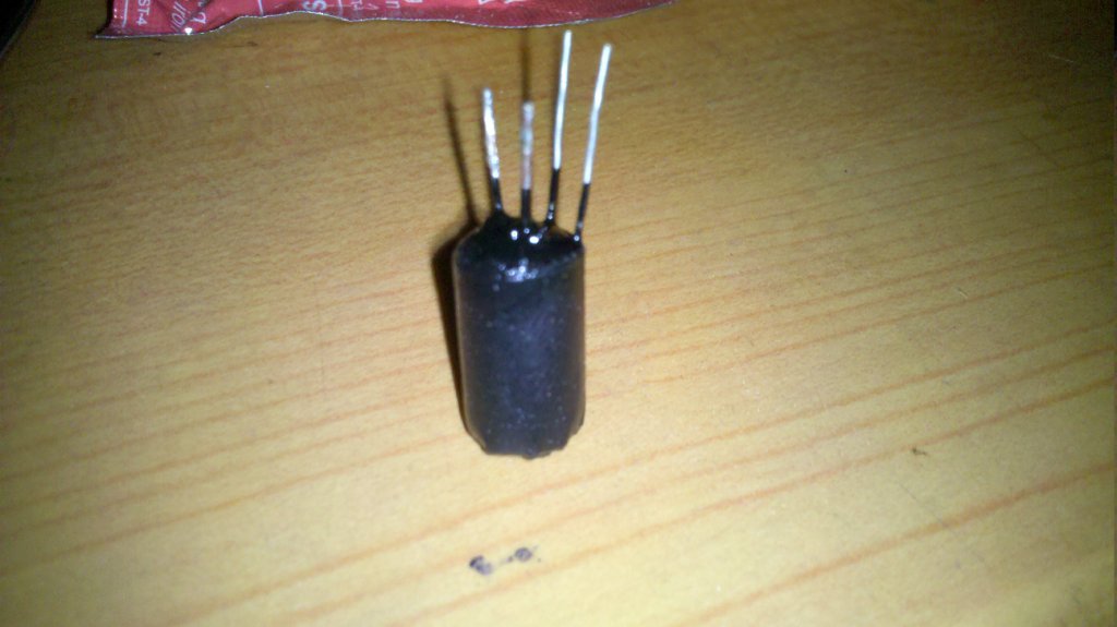

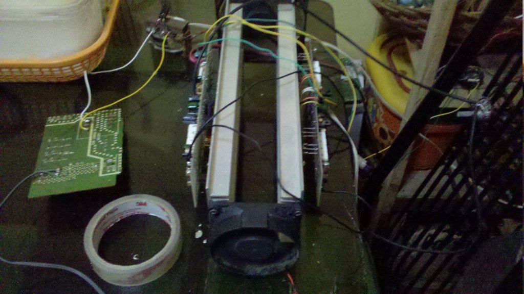

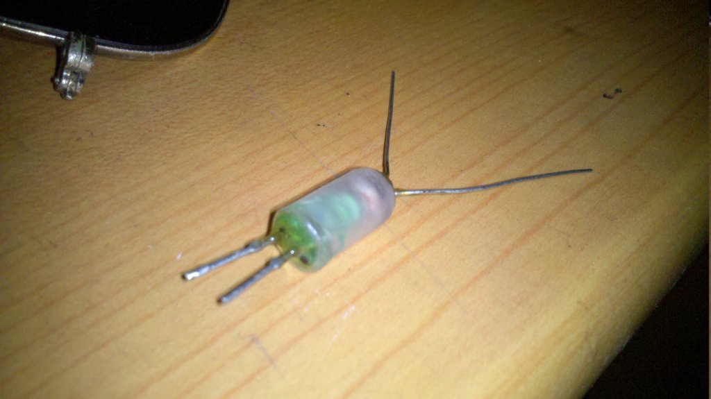

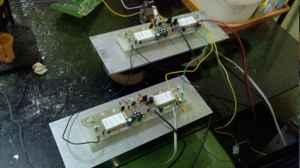

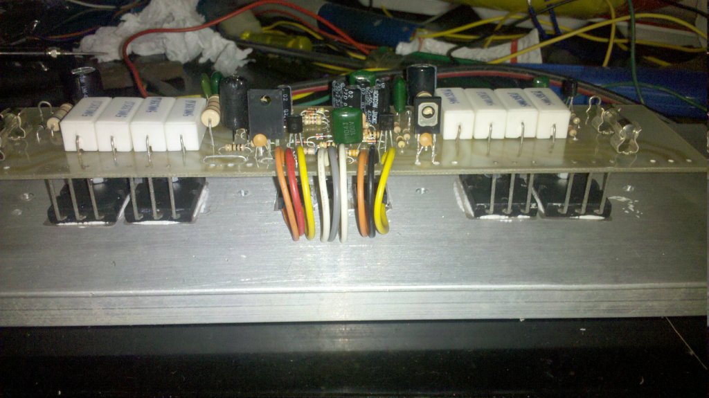

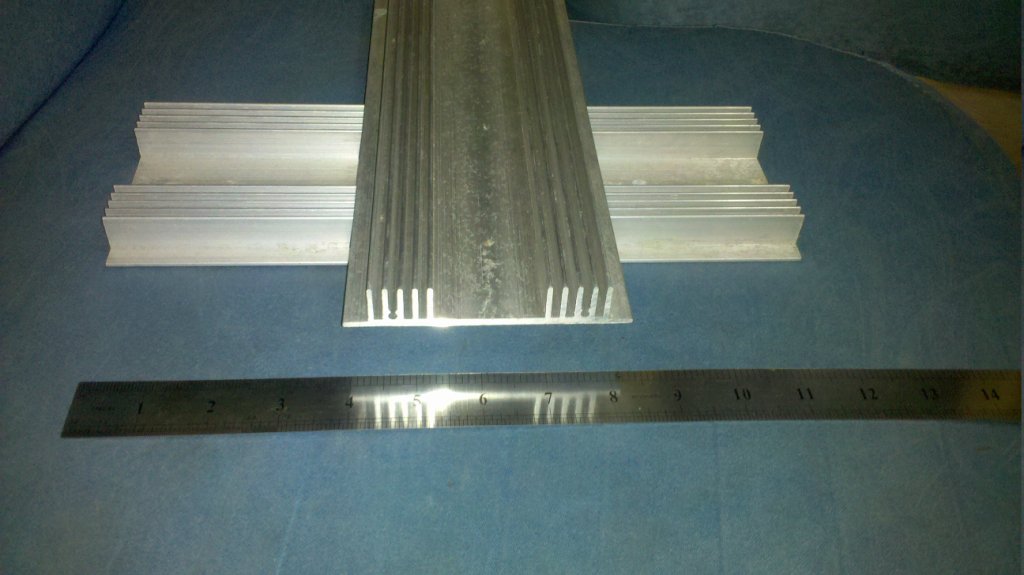

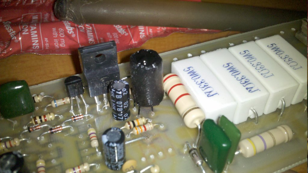

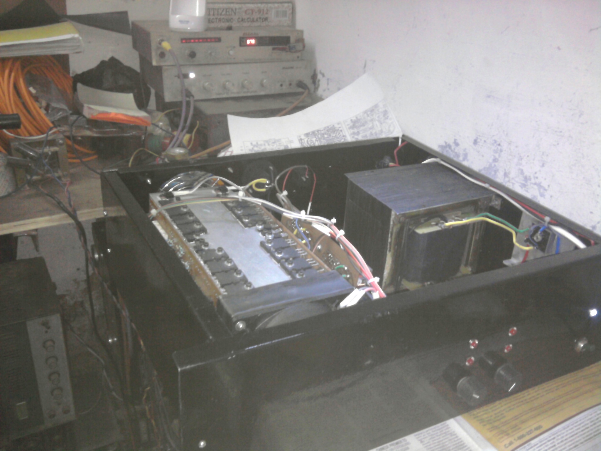

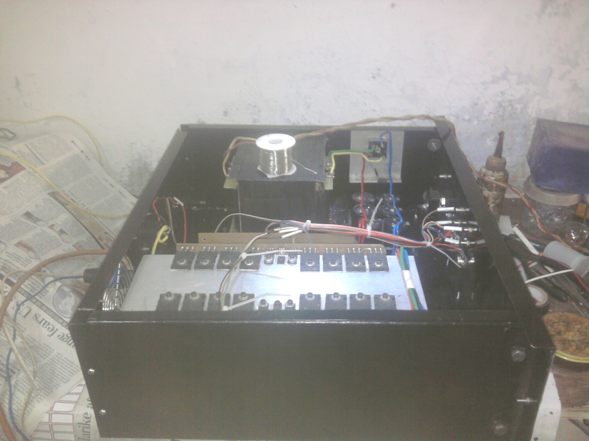

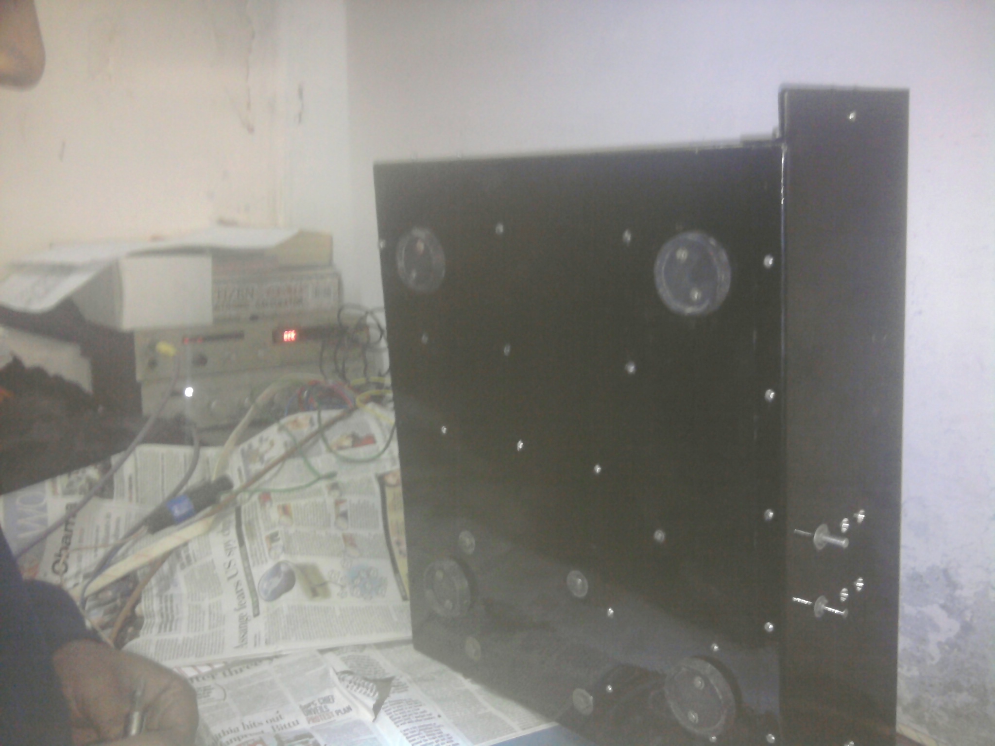

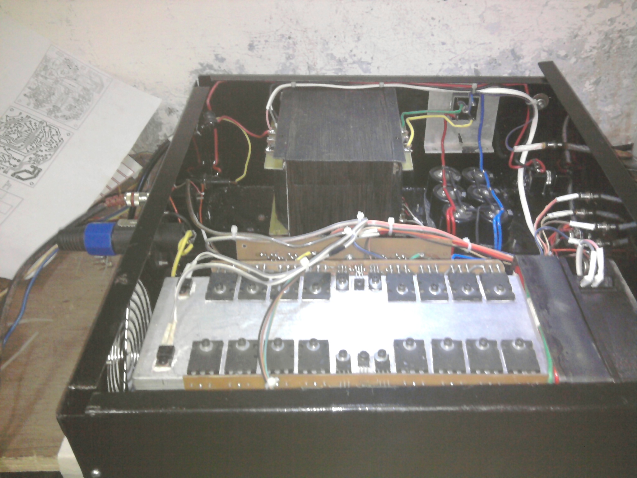

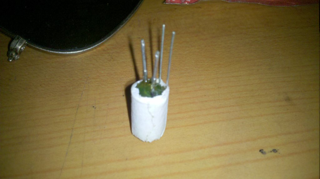

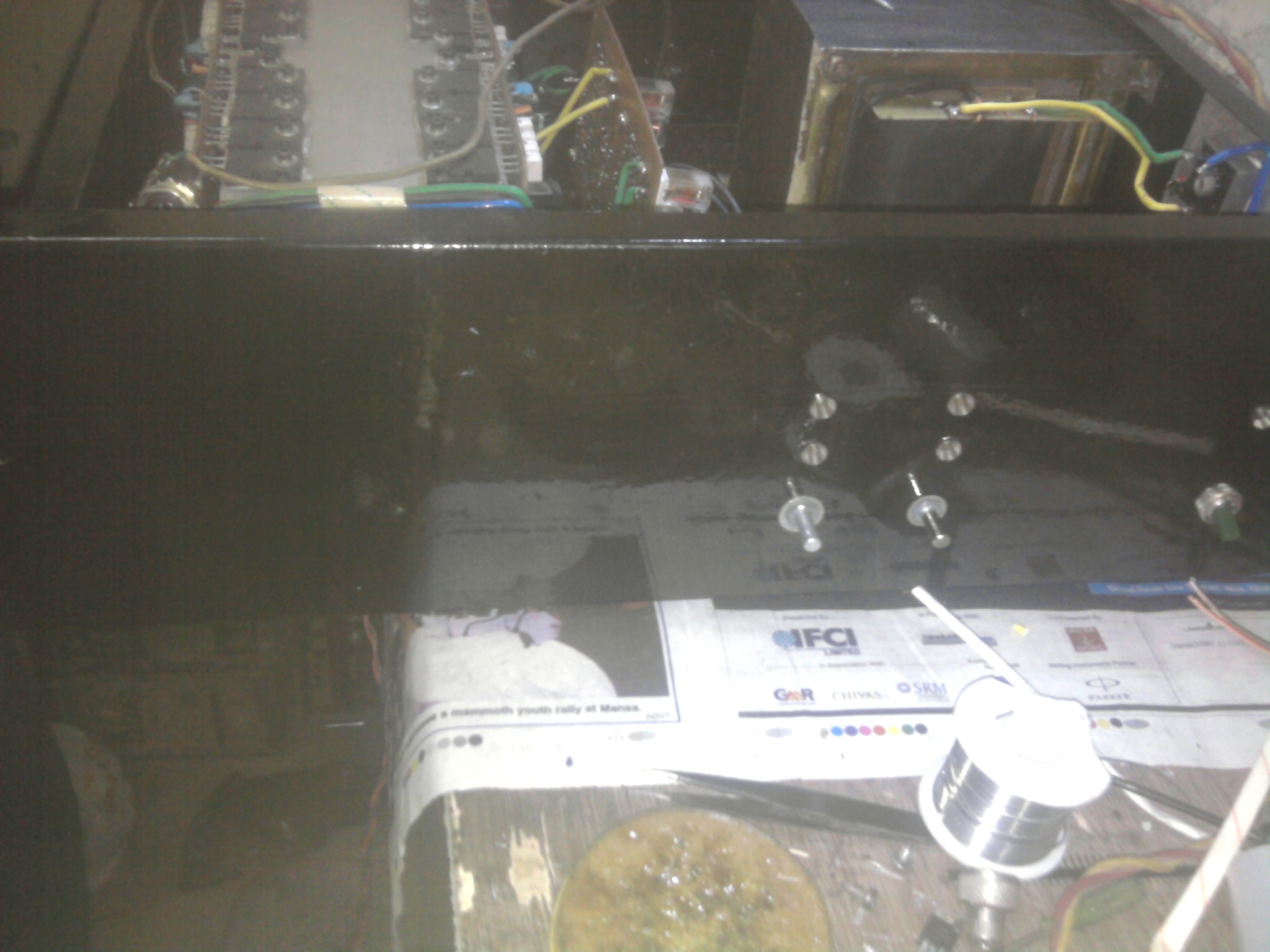

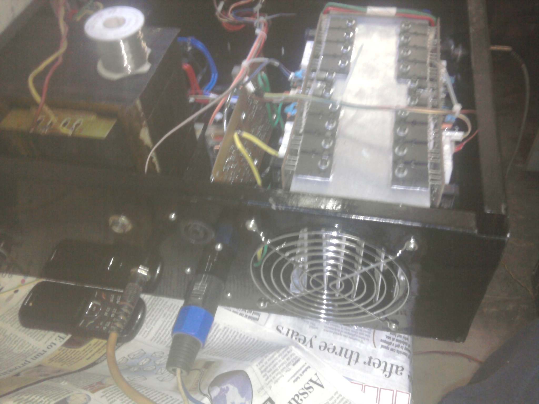

Hello Apex,
Sir, here are the pictures of the B500 I made. I have also attached the LED/LDR assembly as well as the ML3 tone control PCB ready for drilling.
I have used the following:
1. +/- 50Vdc @ 6Amp for testing
2. Opamp LM358.
3. Pre-Driver transistors are MJE340 / 2SA1837
4. Driver transistors are 2SA940 / 2SC2073
5. Output transistors are 2SA1943 / 2SC5200
6. Manex 8" sub rated 200 @ 8 Ohms.
7. DC offset voltage is @ negative 0.05miliVolts with and without speakers (positive test lead is connected to the speaker output and the negative test lead is connected to the ground).
Is this normal to have negative DC offset for the B500 amp? My previous amplifier designs have positive DC offset.
To what value I may need to change the R24/R25? I have used 2.2K @ 2w and I have noticed that it's hot. Can I change the value to 6.8K @ 5W for +/-85Vdc voltage rails?
Both channels having two pairs of output transistors each were playing at full volume (no tone controls yet) from 07:00 A.M. to 05:00 P.M with minimal heat. Great sounding amp, Loud and Clear! I will bridge the amps later and upgrade it to have the step driver circuit.
Thank you so much for the assistance and for sharing the B500!
Blueice23 😎 😎 😎

Nice work, small offset positive or negative is normal.
I suggest to use red LED, did you measure ldr resistance whan led off and on?
2k2/2W must be hot, for +/-85V use 3k9/5W or two 8k2/2W in parallel.
Thanks for shareing picture and expirience with B500.
Regards
