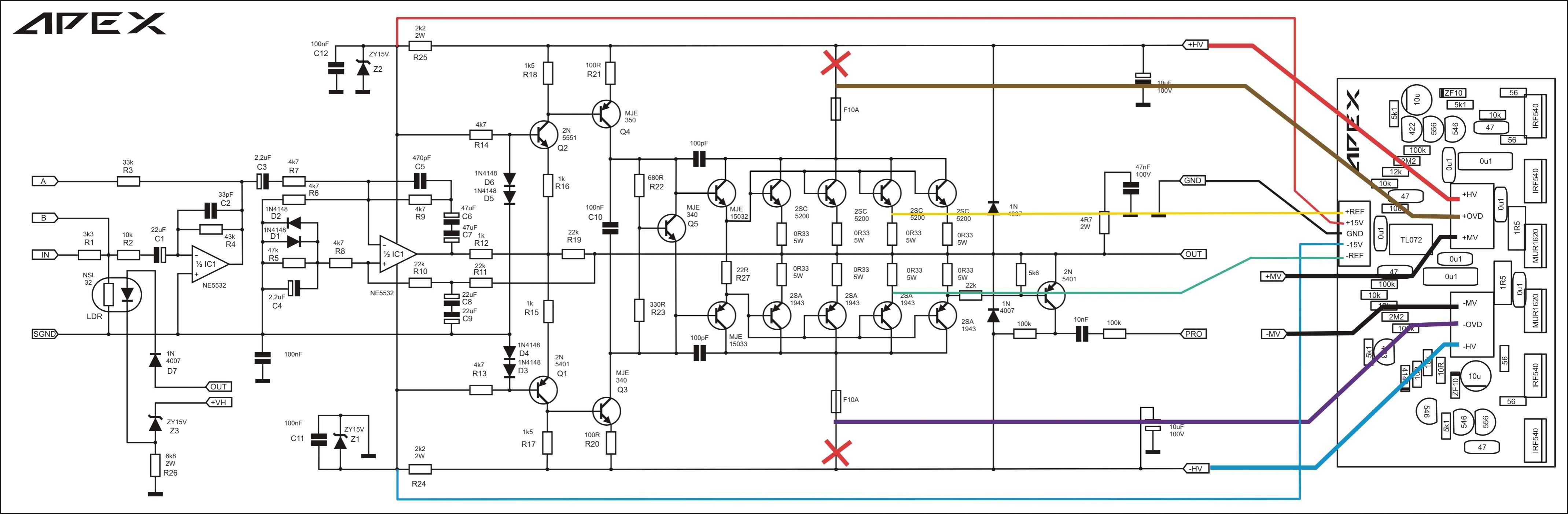

Use this circuit with correct +/-15V polarity,
Regards

Use circuit from post #1200, circuit in your attachment have wrong +/-15V polarity,
Regards

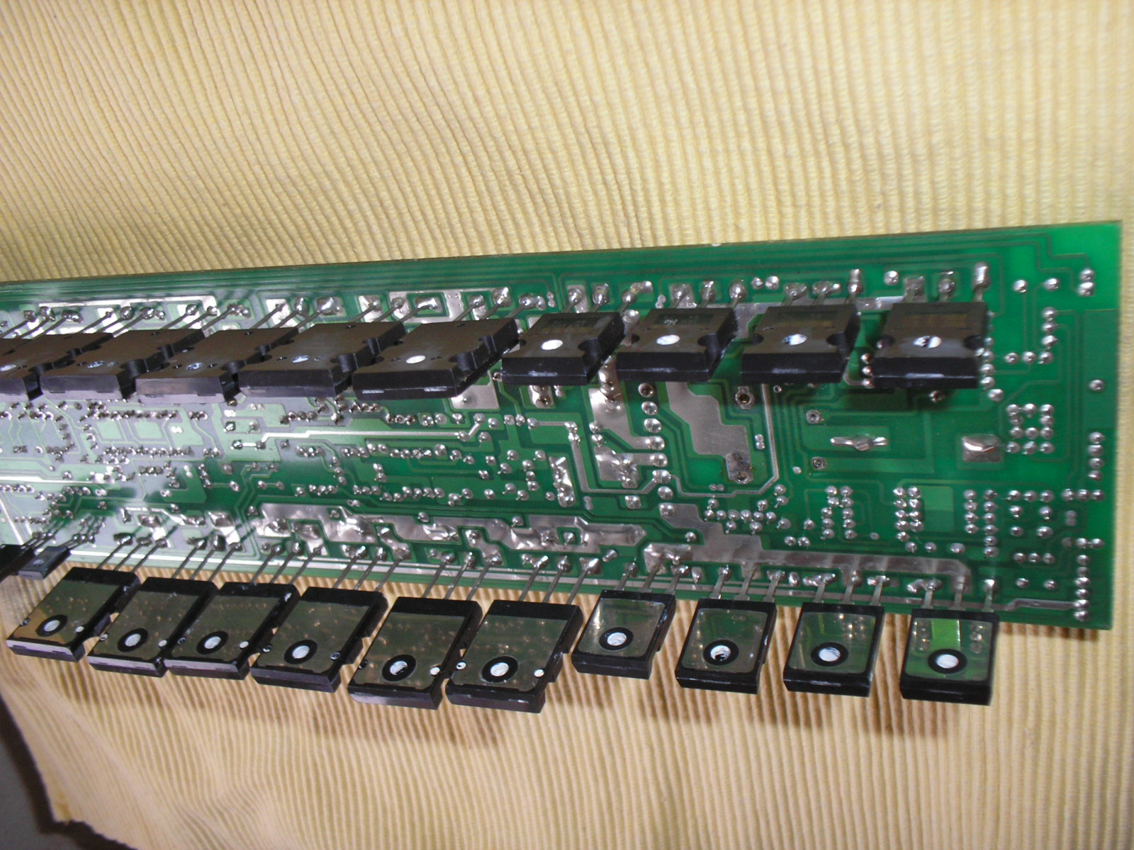

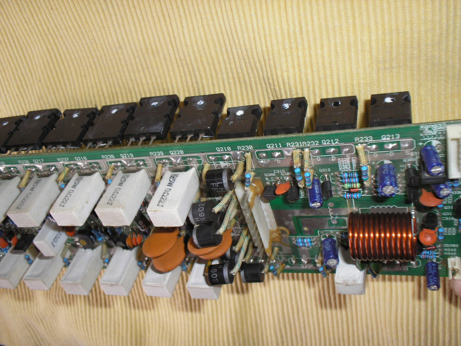

What is rail voltage? Can you post pictures with heatsink for your B500?

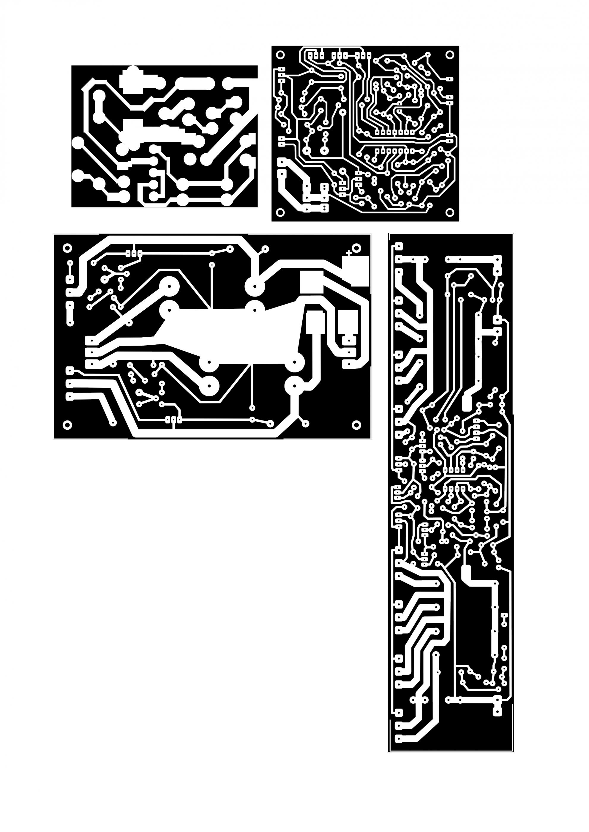

mr apex sir do u have b500 pcb layout in pdf format.
APEX B500 PCB.pdf

Sorry Apex..picture this B500 will post next time after I take foto this PA...
I used 2 pcs trafo 8A with 0-57vac and result 57vac-0-57vac..and elektrolit capasitor Philips 2 x 17.000uf/100v..
