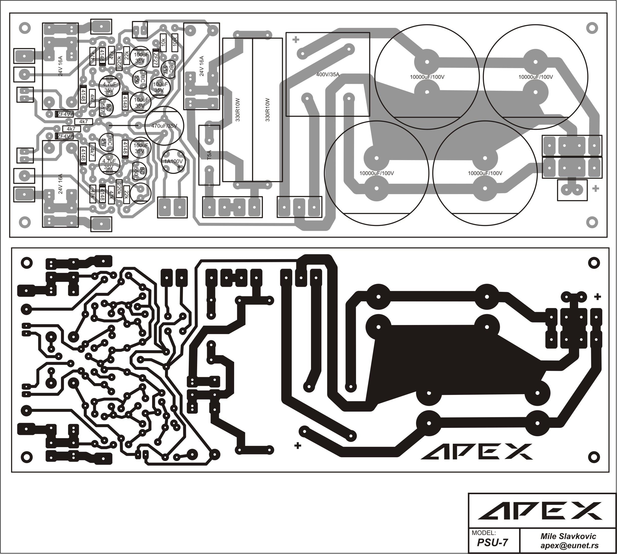

60-0-60 6 amperes transformer is it correct for mono B500.
Should i use a single transformer with dual windings or dual mono.
i am asking as i need to choose a chassis accordingly. I transformer is very big i may not be able to get chassis for it.
what is the size of this pcb.
i will be using it with b500. is it stereo power supply or mono.
is it regulated.
also gide with soft start pcb.
This is not a regulated PSU. It only has SOFT START and PROTECTION engines aboard.
