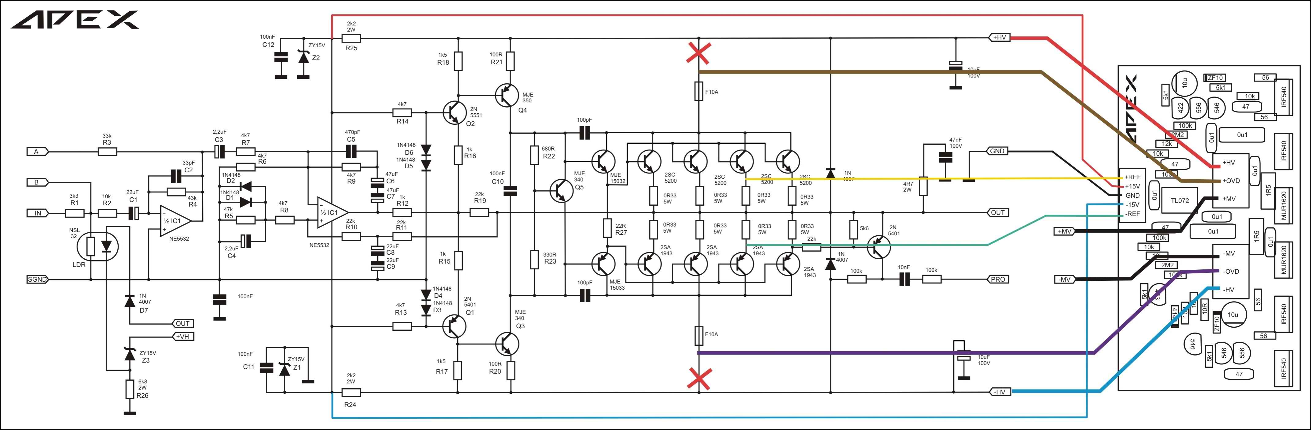

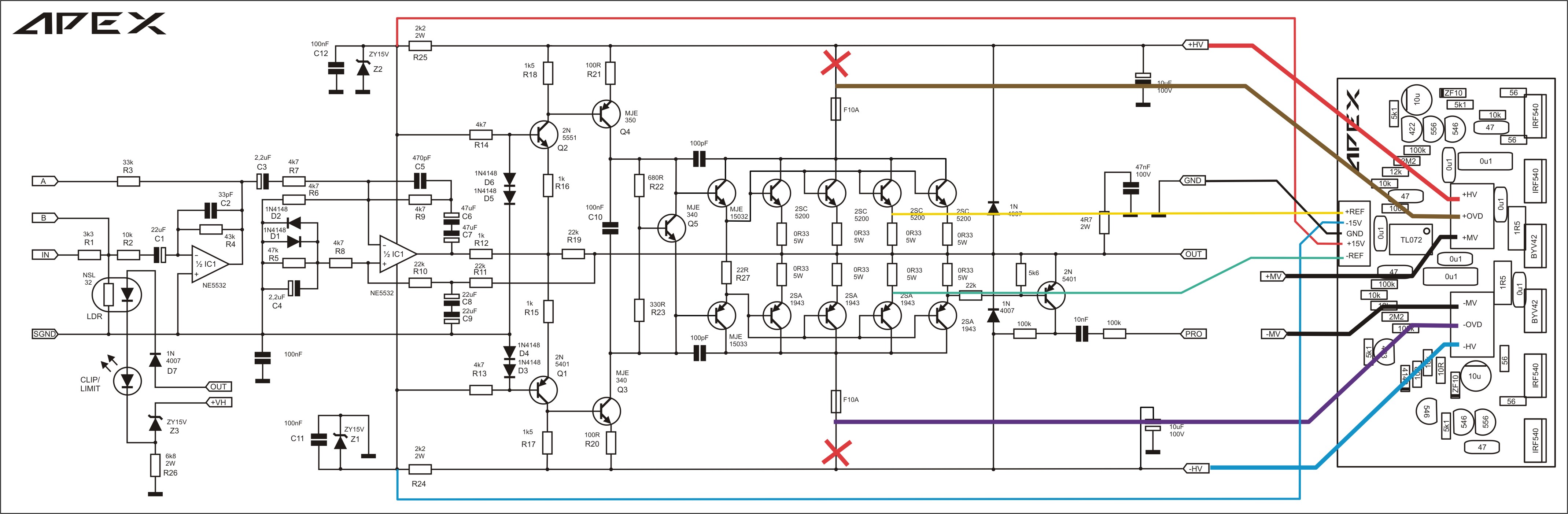

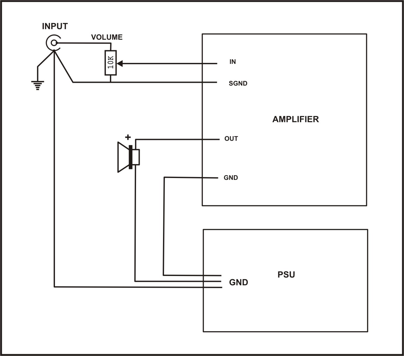

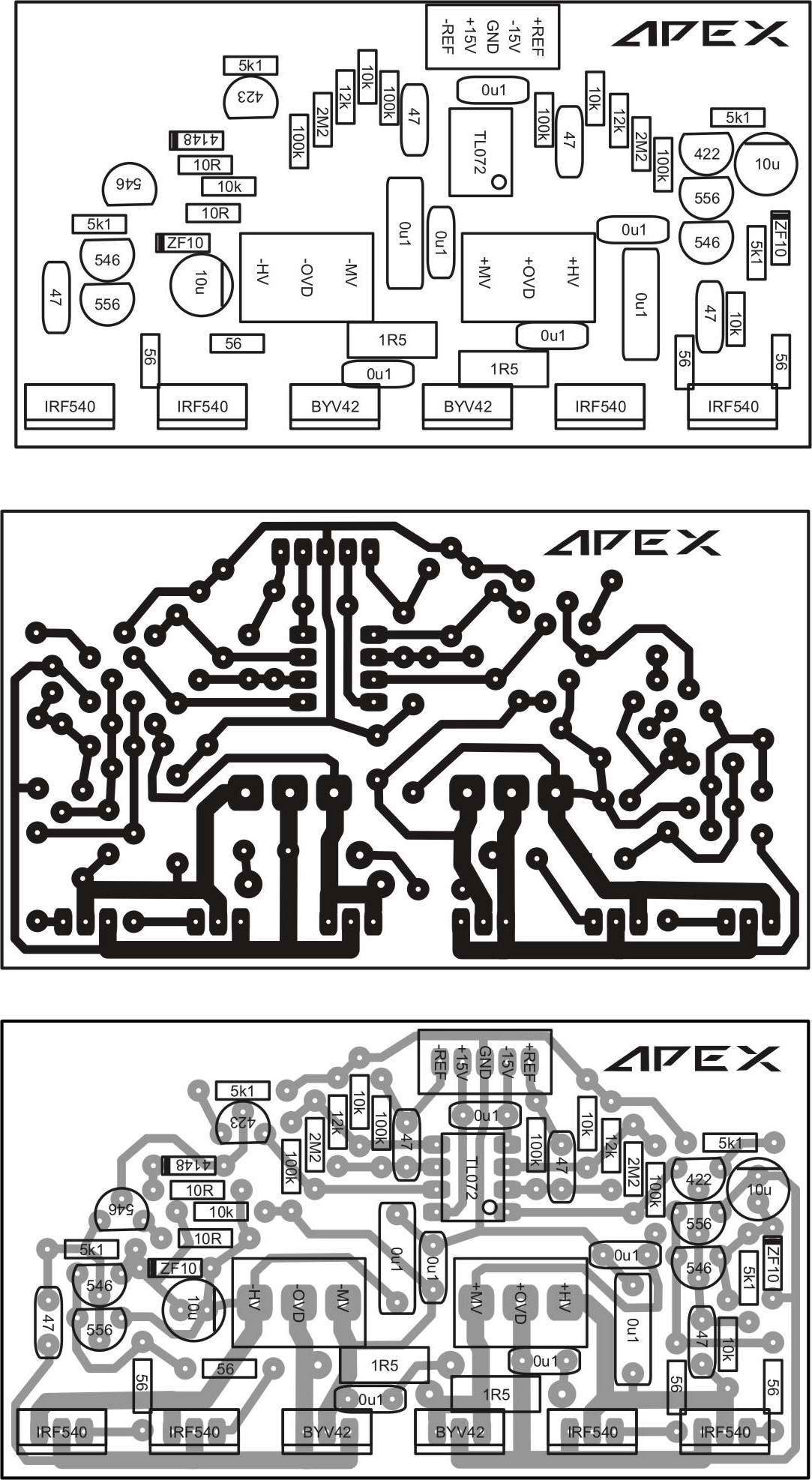

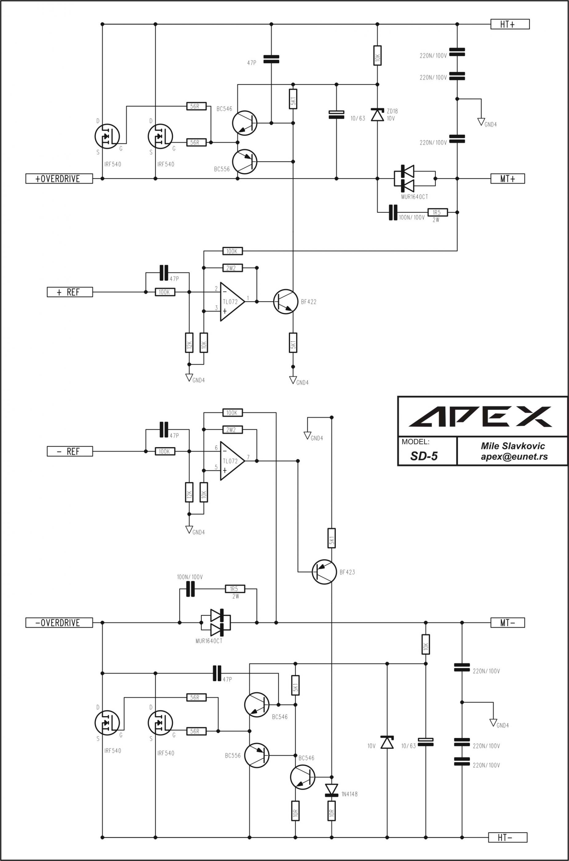

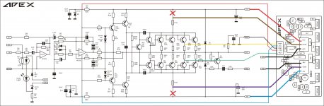

500W PA amplifier with Limiter
Limiter circuit around IC1a inverting phase and give extra gain to amp, use this circuit without limiter for simulation.
Regards
Thanks Apexaudio!
The reason why i'm simulating the circuit is to find out how it would perform in real life situation. So, this would only mean that the amp is inverting the signal and making it out of phase if it has the limiter circuit?
Signal input using point A to S-gnd is jut like running the amp without the limiter as suggested. It gave me no output signal. How about configuring the limiter circuit as a non-inverting input stage?
Thank you again for your assistance!:)
