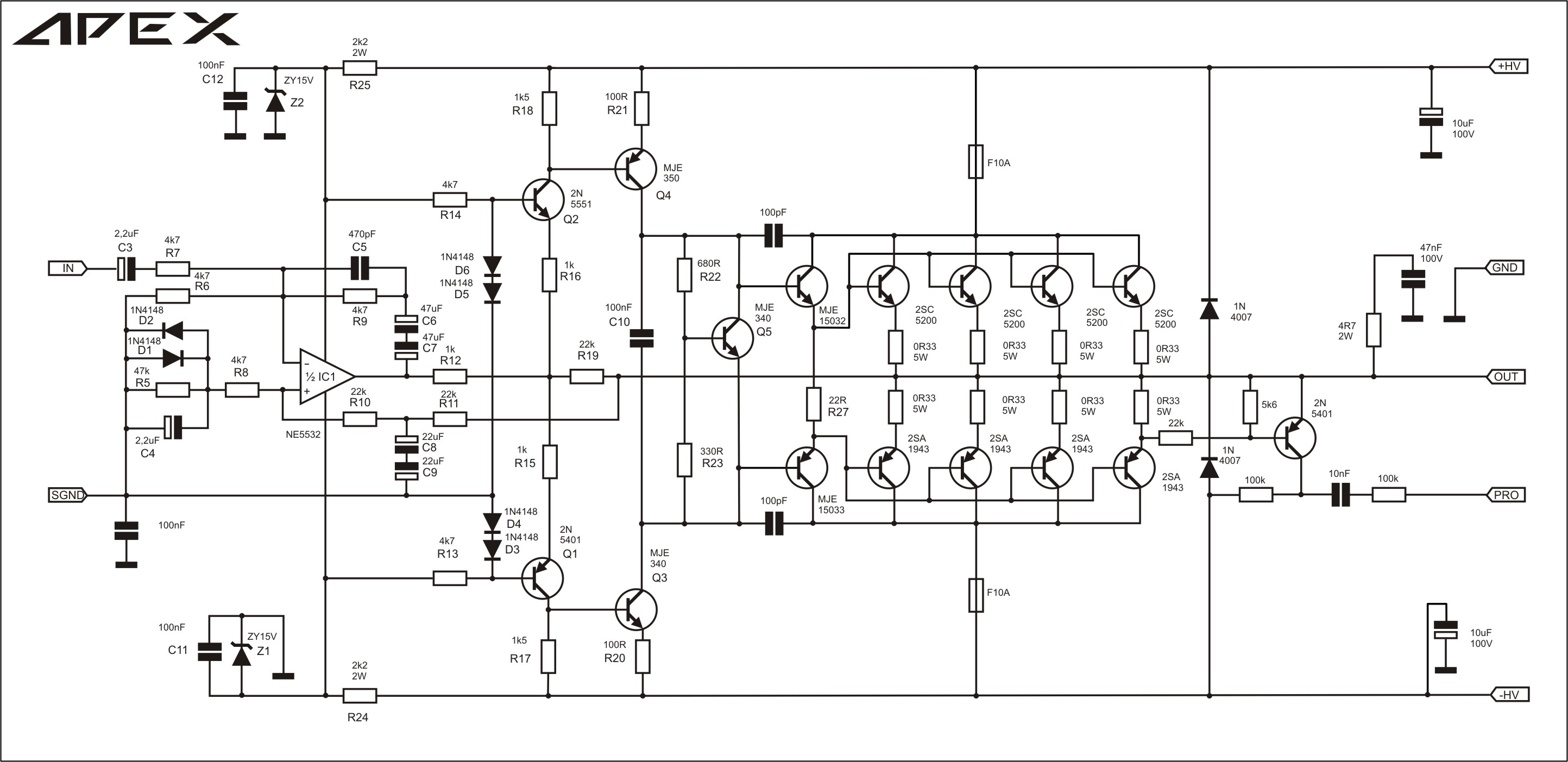

Hello Apexaudio,
I have read the threads for the H900 and your B500 amp. I'm interested to build the B500.
To start with, I have simulated the circuit using Multisim 10 (Like most of my amplifiers before they made it to production and construction.) However, the output signal of the B500 is 180 degrees out of phase.
Here are the values I've used:
Voltage rail: +/-90VDC
Input Voltage: 500mv @ 1KHz, 0 Deg.
Output Voltage: 50V peak to peak @ 1KHz, 180 Deg.
The amplification is quite good considering the ratio is 1:10. I will post the screenshots and the test results here soon.
Is there something that I did wrong? I have check the input stage of the opamps. BTW I used the TL072 instead of NE5532. Please enlighten me.
are you comparing apples to spiders?the amplification ratio should be 1:100
500mVac input signal and 50Vpp output signal are neither 1:10 nor 1:100.
You must convert the voltage measurements so that you are looking at apples only.

Limiter circuit around IC1a inverting phase and give extra gain to amp, use this circuit without limiter for simulation.
Regards

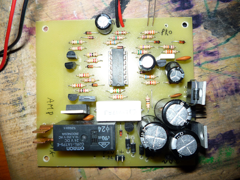

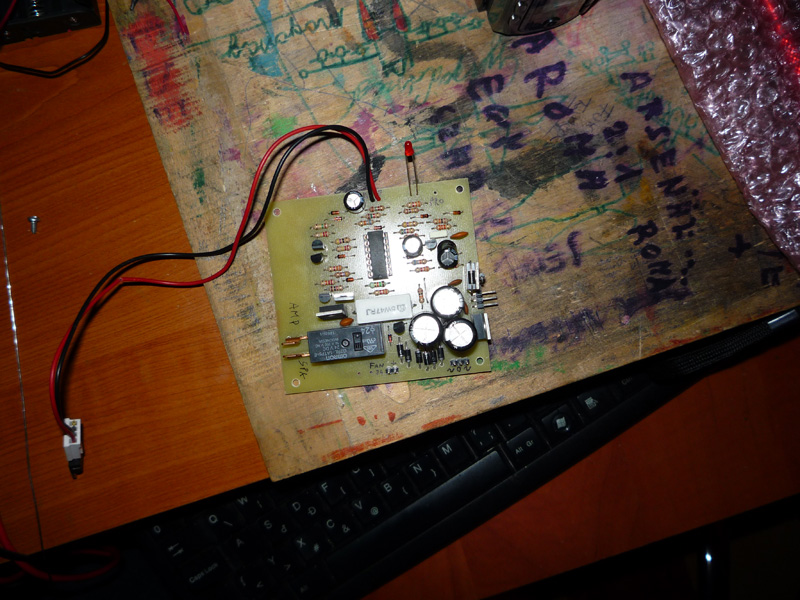

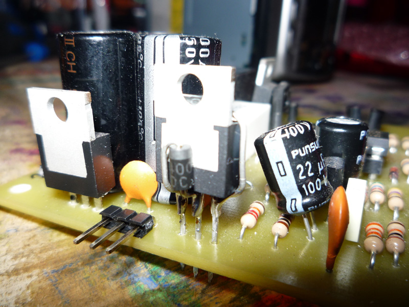

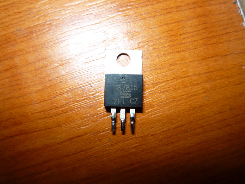

Update, ladies and gentleman!
I bought a few 7815's, their manufacturer is National, and thrown away those annoying TaiwanSemi ones. Results: No malfunction so far, yesterday turned on/off sequentally the circuit (with 10s delays) for about 10 minutes. Everything seems to work very well. So i'm happy so far. I'll make other tests today, i'll keep you informed.
