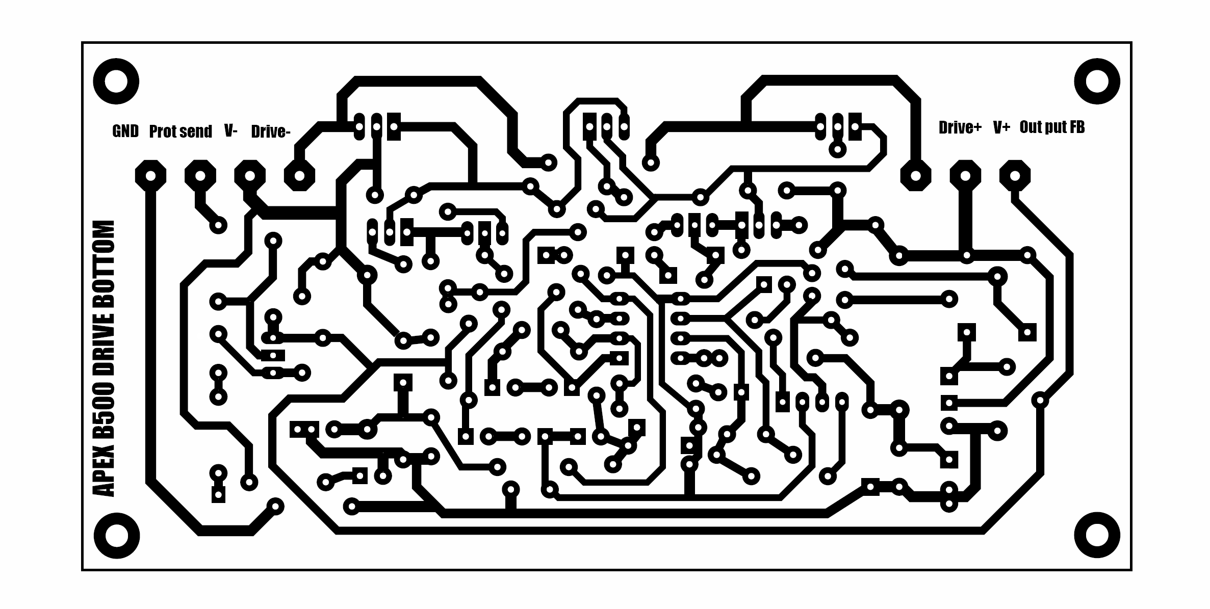

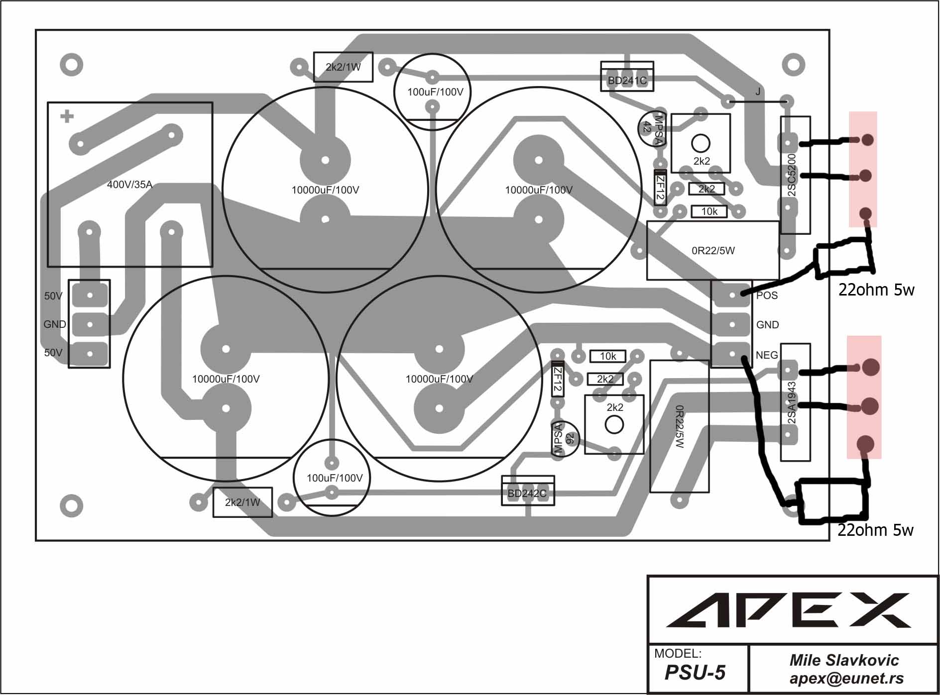

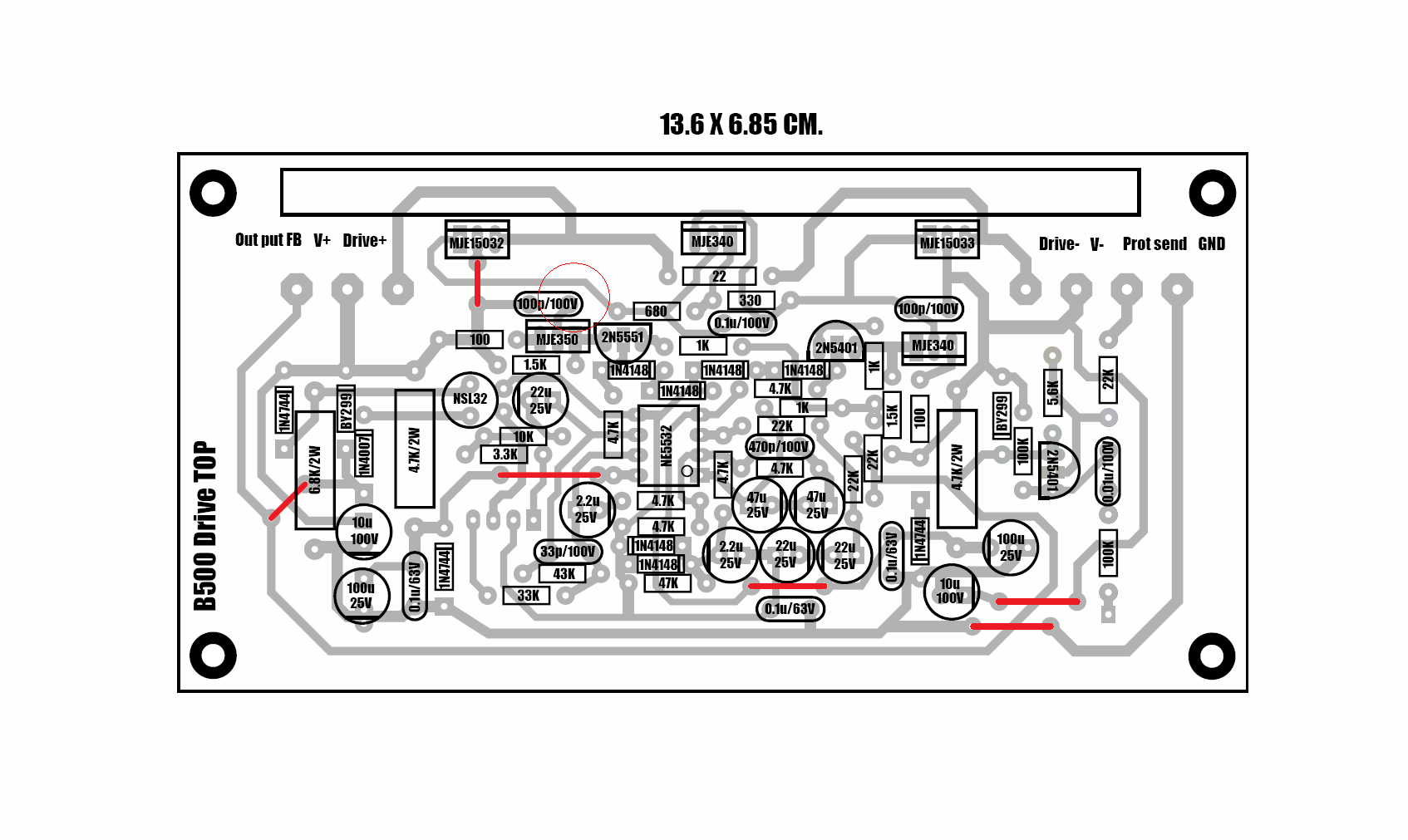

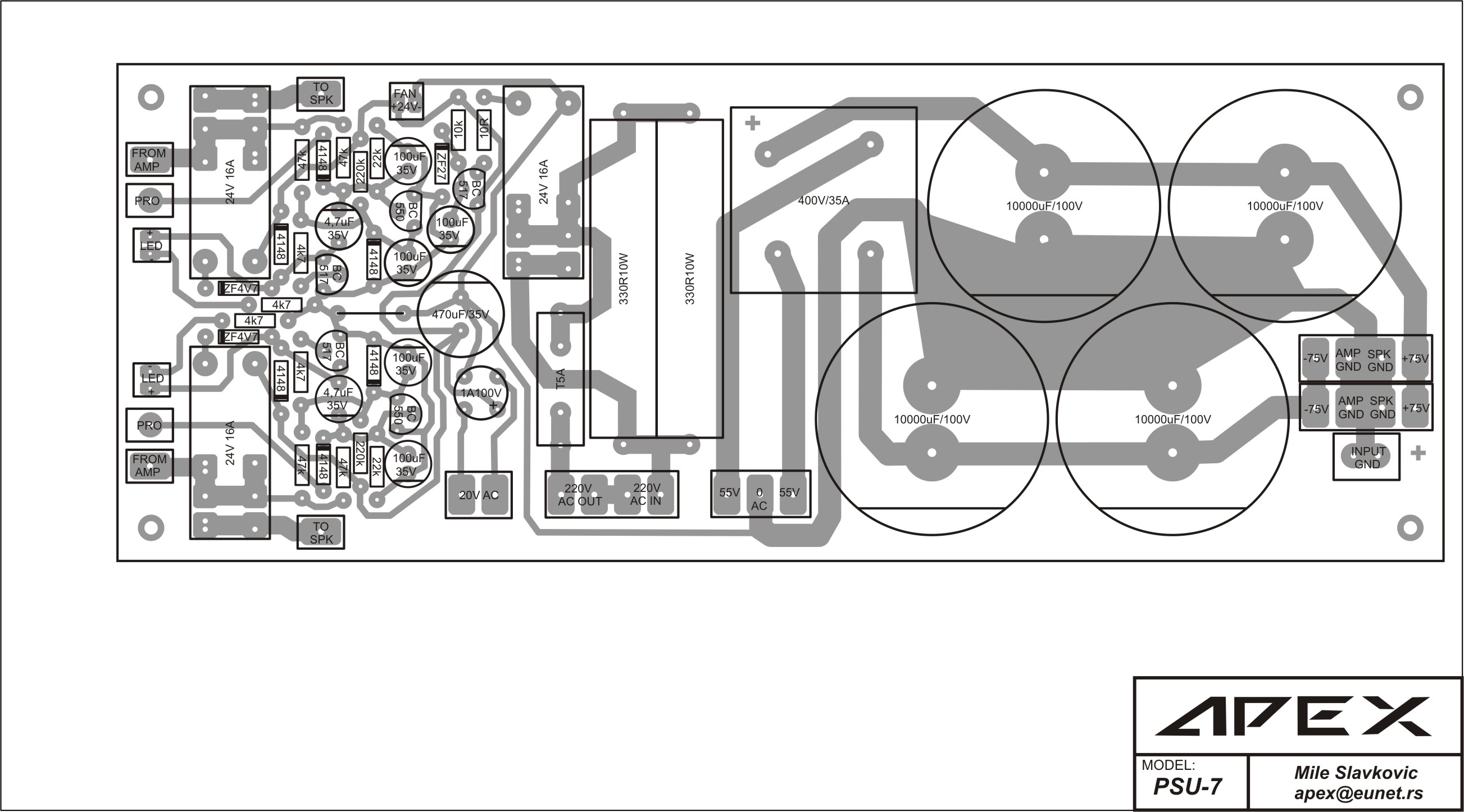

i am sorry to ask this question ,pls post the b500 pcb layout and parts layout ,board size,protection board size,soft start board size.
nothing is happening my dear i use 5200-1943 as drive because i have no 15032-33.
so u can use 5200-1943 its simple.

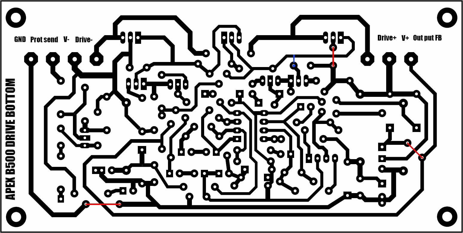

nd there is a mistake in pcb i show as a blue line ..make it and enjoy..😀😀
thank u
Hi aman khalsa and all.
Thank you aman khalsa for final check B500 easy drive and i corrected for PCB.
Regards.

hai apex.i build your b500 amp.using 2 pair power output.when i supply +-50vdc amp cannot work but when using example +45 and -50.it will work.so it work when negative power supply more than positive.and when at 9 o clock still ok.but when 10 to 11 it will unstable.what my problem apex?
i follow your pcb 100% same.
Post some picture showing wiring and close up picture so we can help you
since Apex is not online
ok i will post picture another day because i chatting at cyber cafe now.when i use 2 pair power output it should change resistor value for adjust bias?or u think my ground connection problem?
maybe you have problem with your wiring,, i run B500 on trapo 55vac -/+75 work fine no problem
