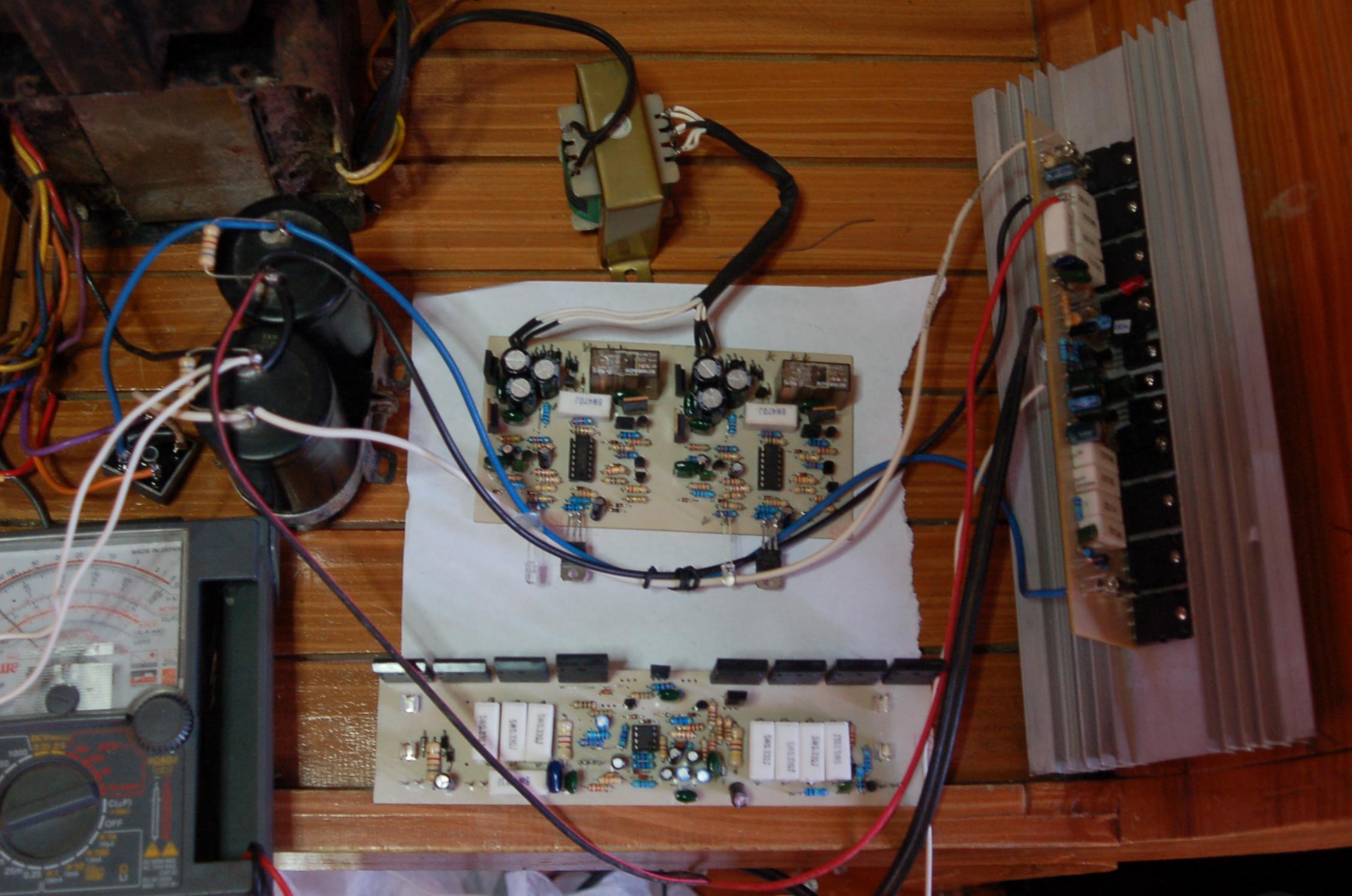

hello mate,hi apex audio
greetings want to ask you that can you please tell me if i am
wrong
1 pin 7 of ic TLO72 should go to base of transitor BF422 but 5 no pin is going to base
2 from 5 no pin 10K resitor should be ground
3 1 no pin of ic TLO 72 should go to base of transistor BF423 but 3 no pin is going to base
4 3 no pin should be ground via 10 K RESITOR
PLEASE TELL ME IF I AM CORRECT FOLLOWING SCHEMATIC
hopimg you can help me
thanking you
andrew lebon

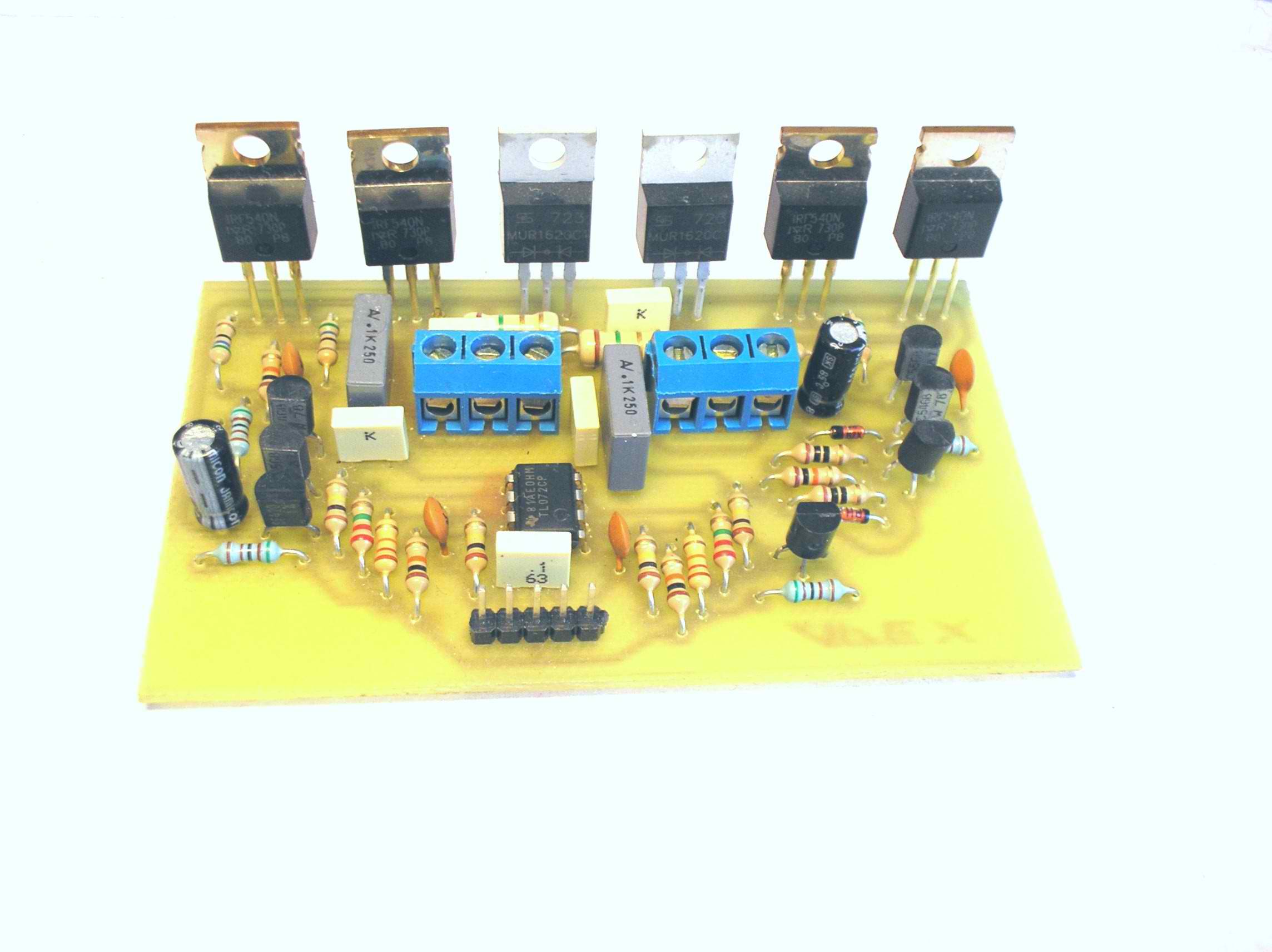

which tlo step lay out are you using?
the corrected step lay out is in post923 and 928
hi engel dela pena
greetings check schematic against pcb component layout
after correcting mistakes on negative side negative out voltage is correct
will do positive side now and reply
thanking you
andrew lebon

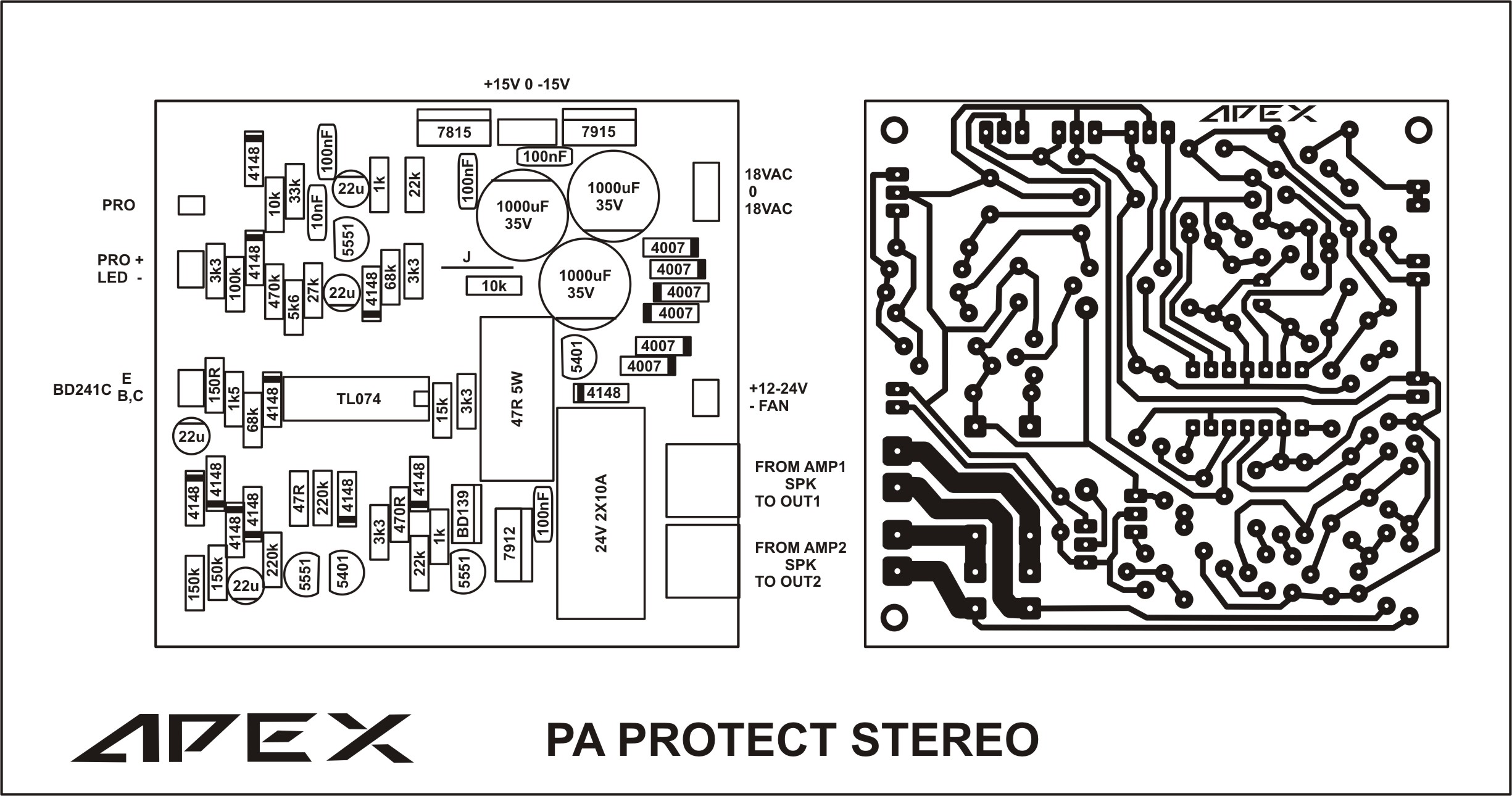

B500 can run without step driver ,,step driver is just an upgrade so b500 become h class,,about protect circuit its on the thread and i use it for my b500 and h900 works great
There are lots of protect circuit in this forum . so which one u use? if u can post the pcb layout it is very usefull.
thank u for your reply.
protect circuit APEX
APEX protection circuit can be use in any amps

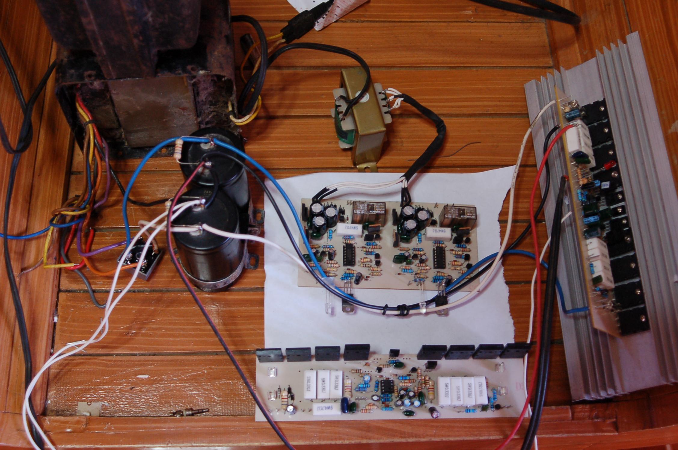

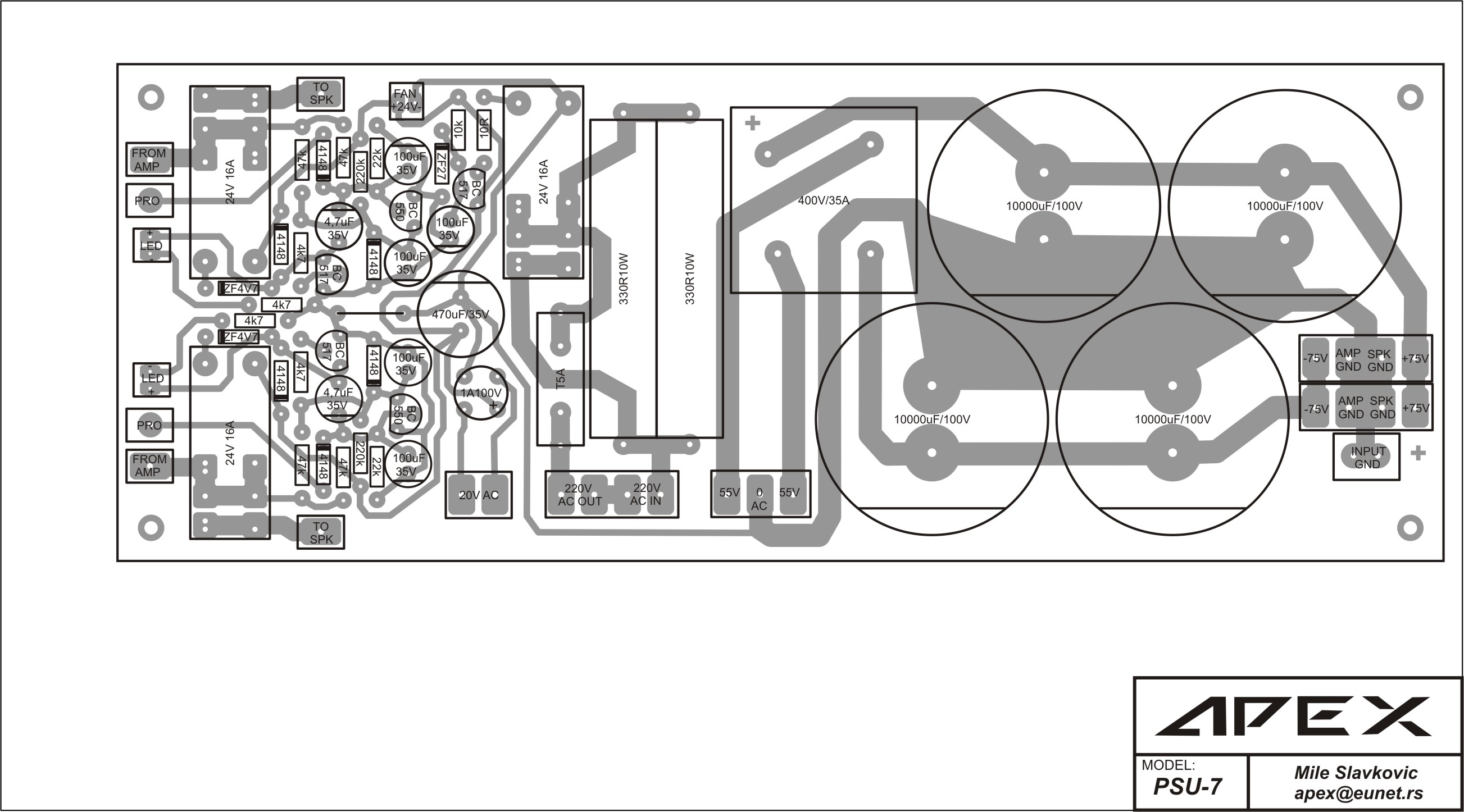

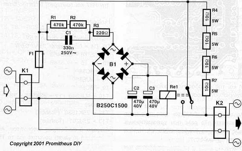

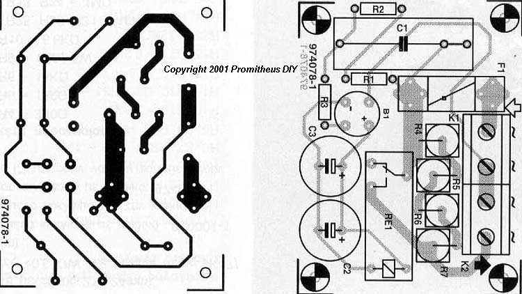

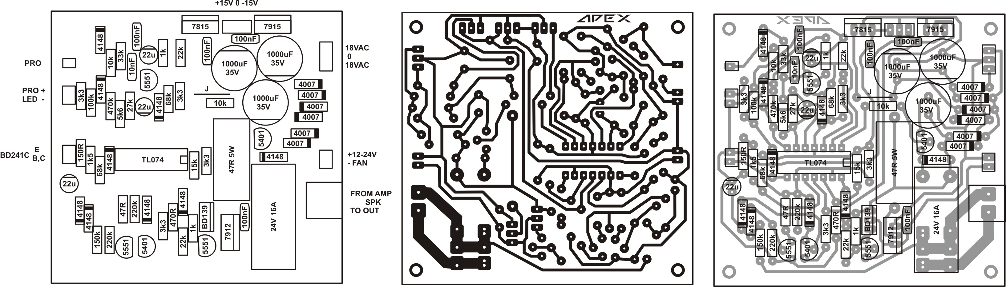

thank u for the spaeker protection pcb . but i read in this thread this is for h900 not suitable for b500. is it ok for b500?
i think that this circuit has softsatrt and protection circuit is for b250 i think ,,and the other is regulated psu for b500.ypu must ask APEX AUDIO for clarificationwhat is the pcb size?
what about this protection bcb?

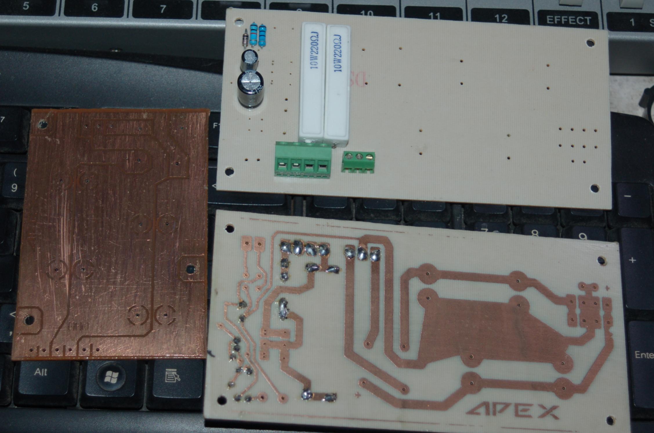

which power supply u use?

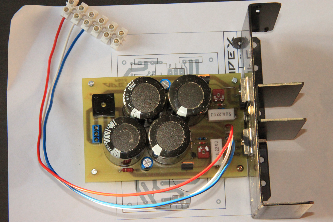

i am going to try the regulated power supply.i attached it.

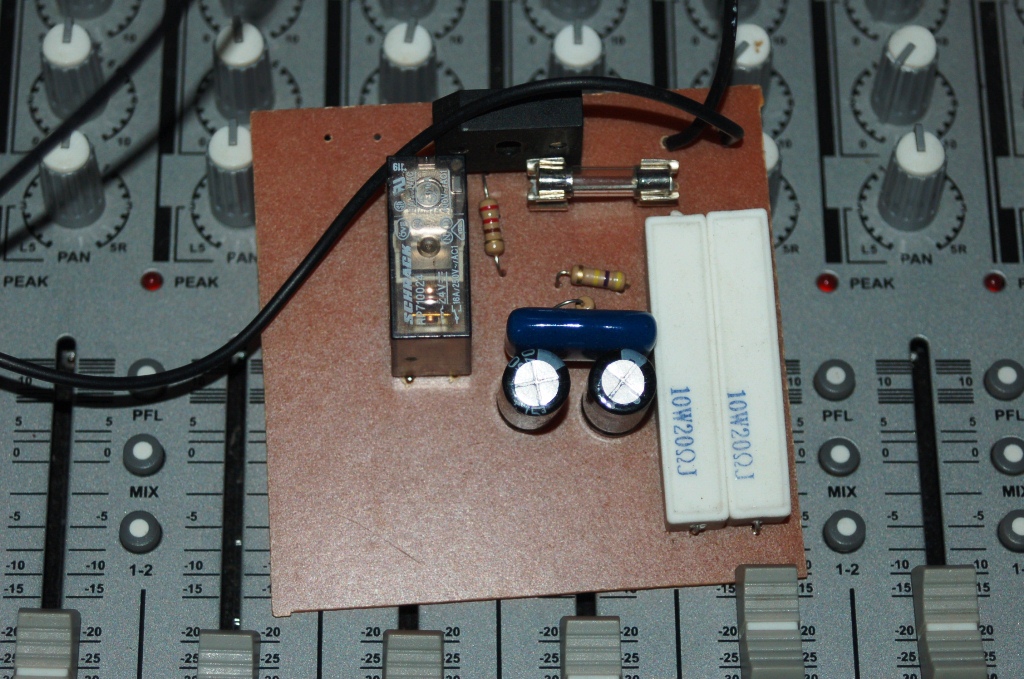

which relay uusing?
you can use that psu with softstart for b500

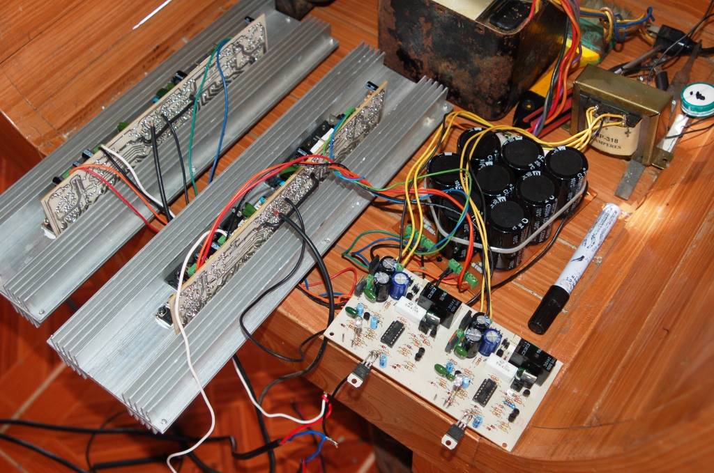

My unfinish PSU for B500 with Softstart i cut the protection Circuit
