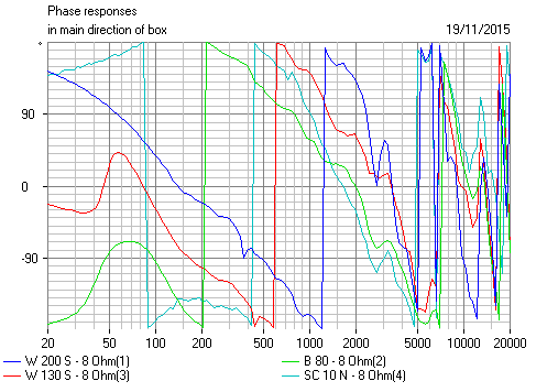

1) Regarding your phase graph. Could you explain to me what the highlights are. I'm one of those 'it needs to sound great, who cares how it measures' kinda people. You are my exact opposite, I like that.

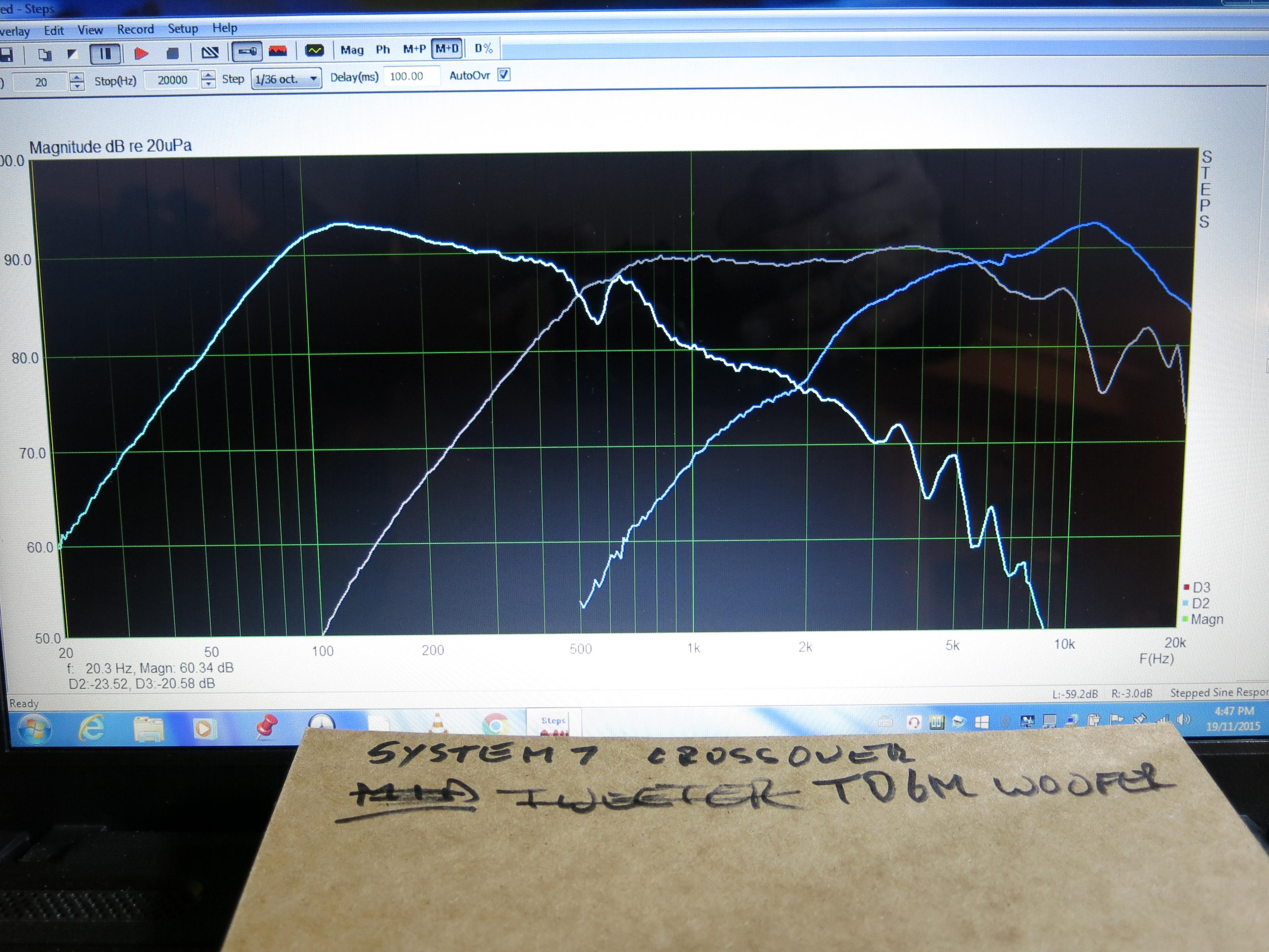

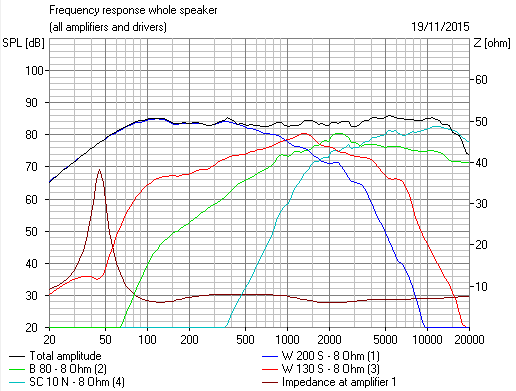

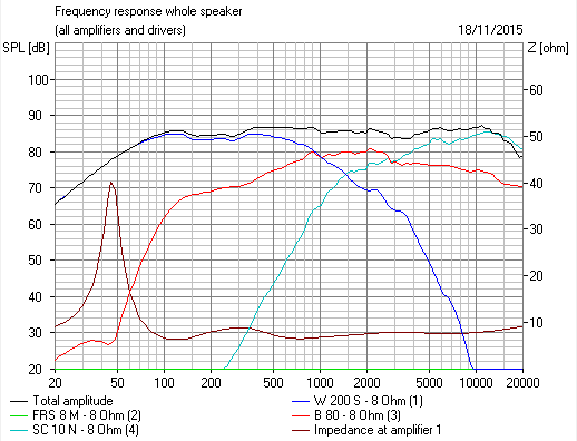

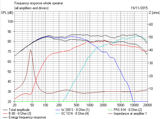

Bill, I'm just playing with a new toy here, but I'm getting the hang of it now.
Power response is typical 3 or 4 way flat. Tweeter distortion might be improvable. There is no difficulty or any bad effect in adding a 10uF to the tweet to make it 3rd order. Takes the Fs down 6dB.

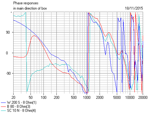

I don't know what to make of the phase yet, but it looks a bit 90 degree in places, which is OK too. Component values are not all that critical, it just seems to bend everything around changes.

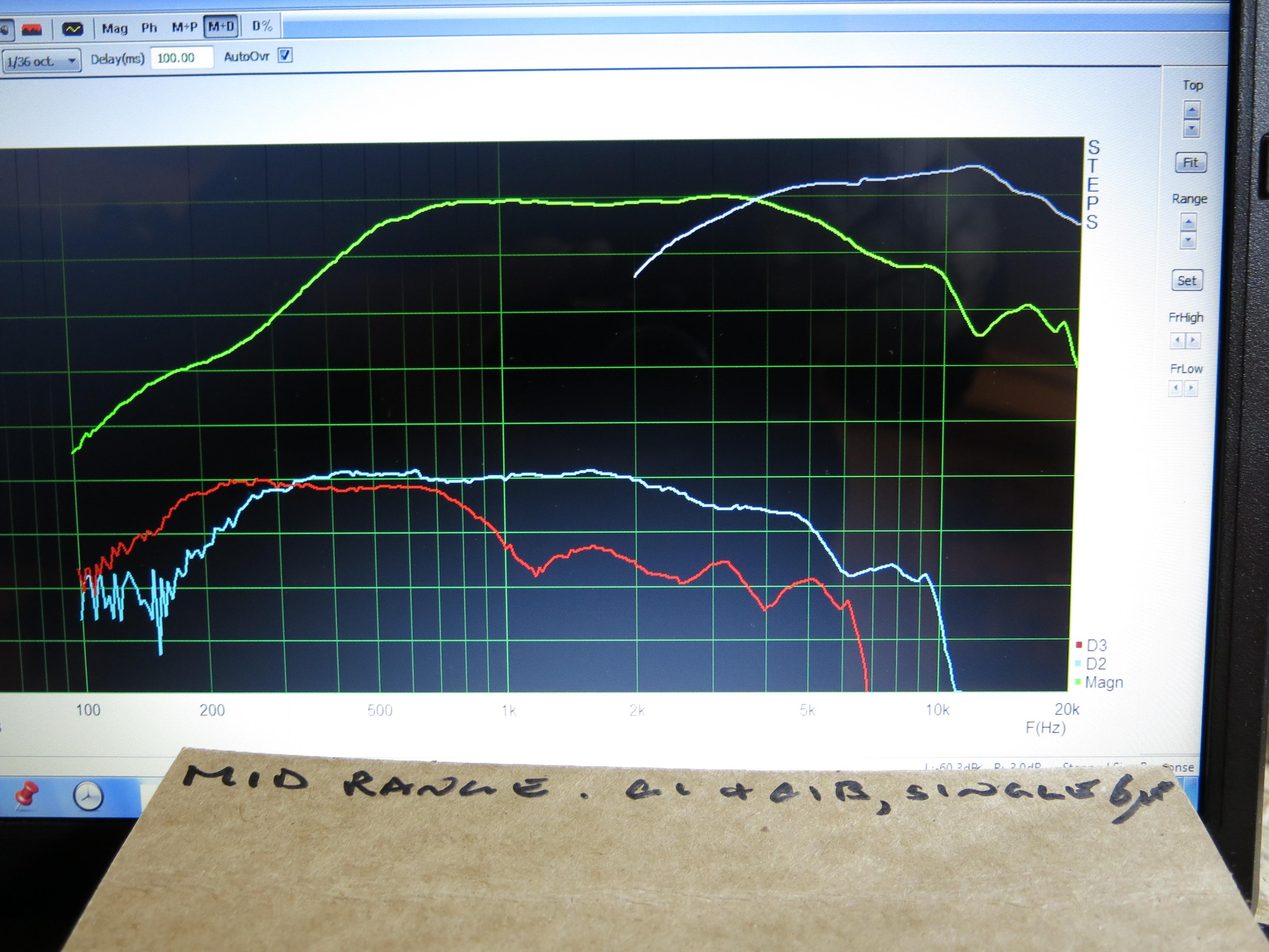

Picture 1) New day, new start, new 6uF at C1 and C1B distortion measurement.
Picture 2) Can This Be!!!!!, distortion is down, and I mean across the board. I had to measure this three times to make sure. This with two caps of different values, 3.3uF and 2.7uF. Look how low D2 is in the crossover region (4200Hz)
Time to go measure what two identical caps in parallel look like.

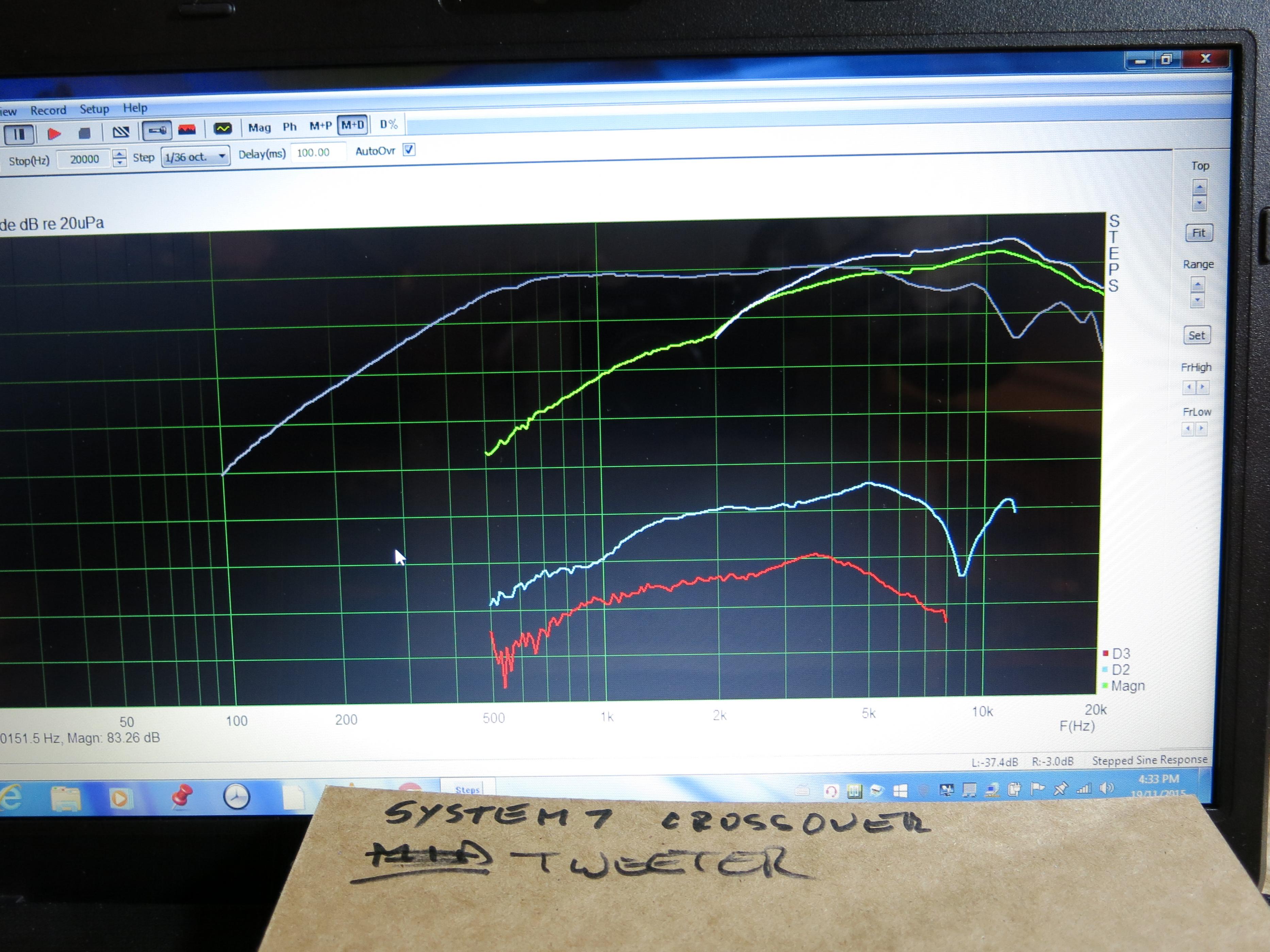

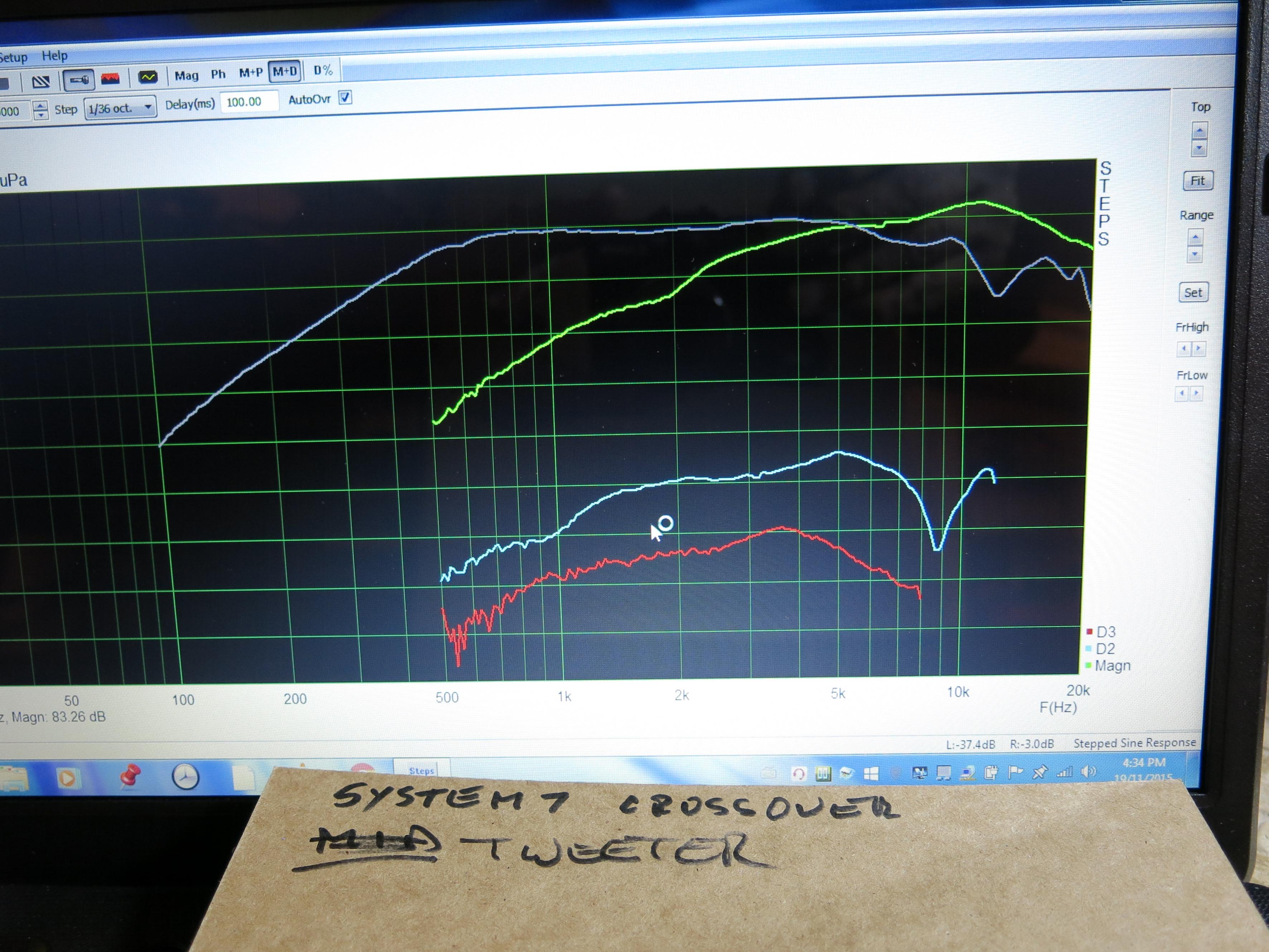

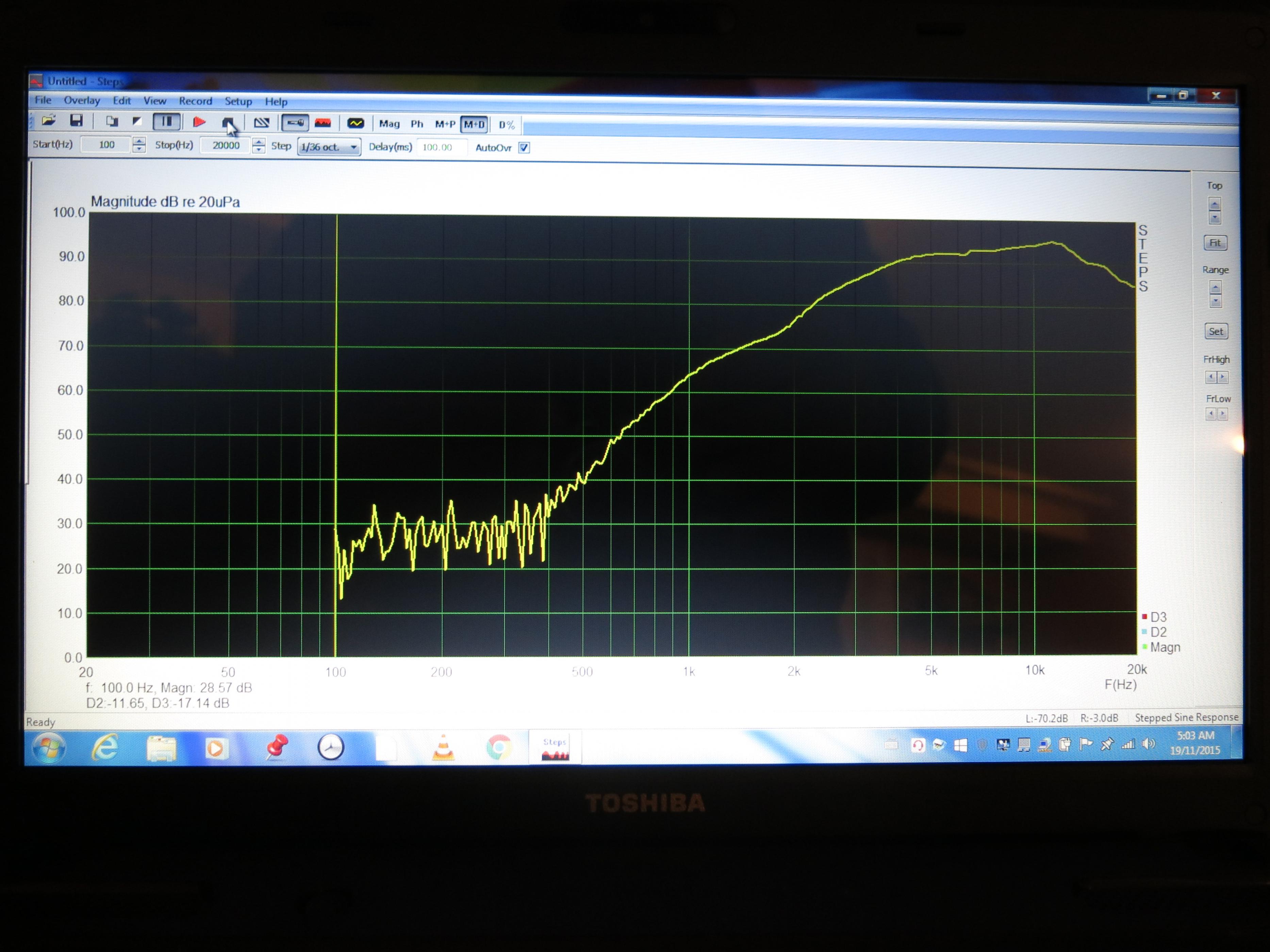

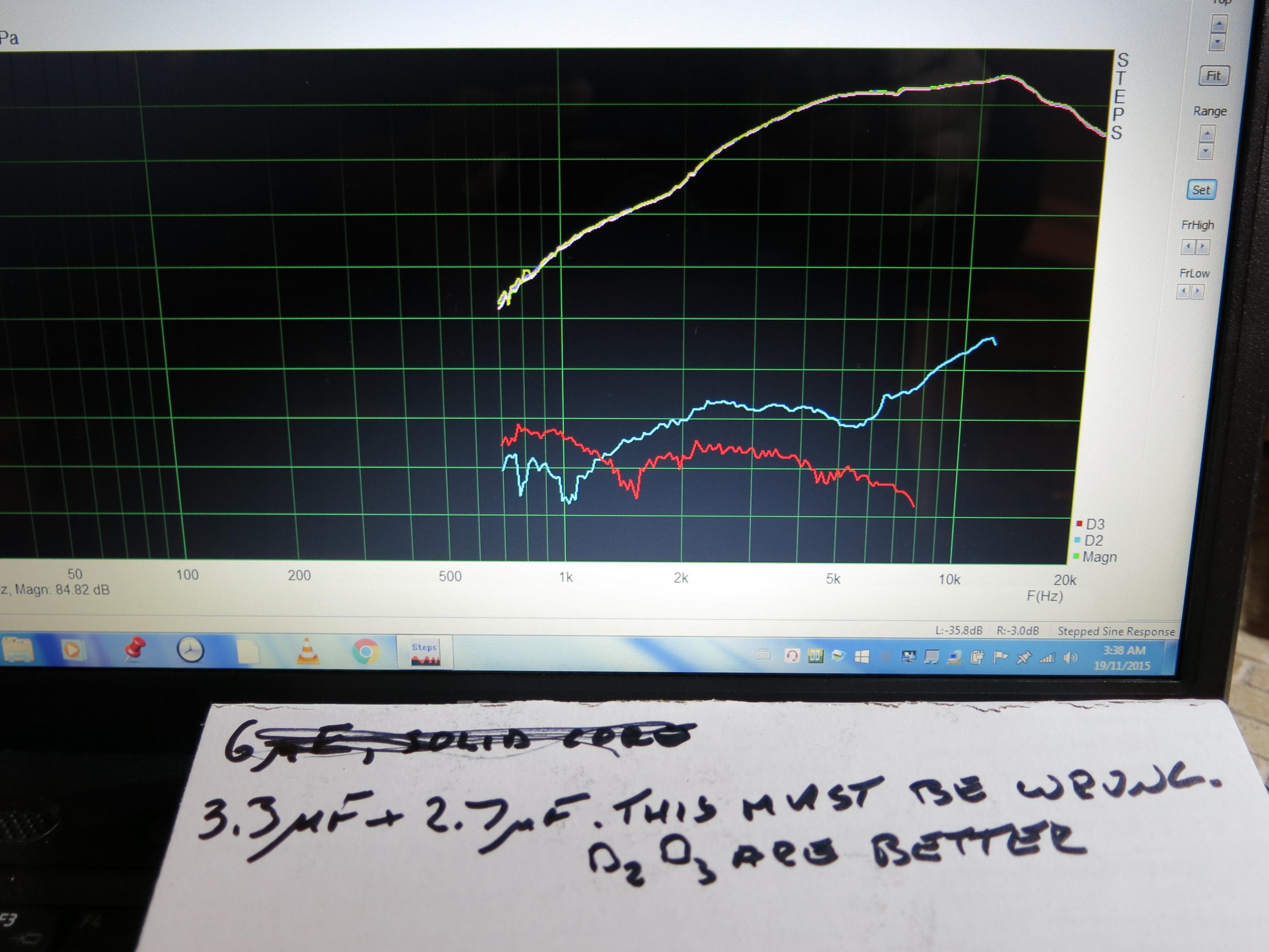

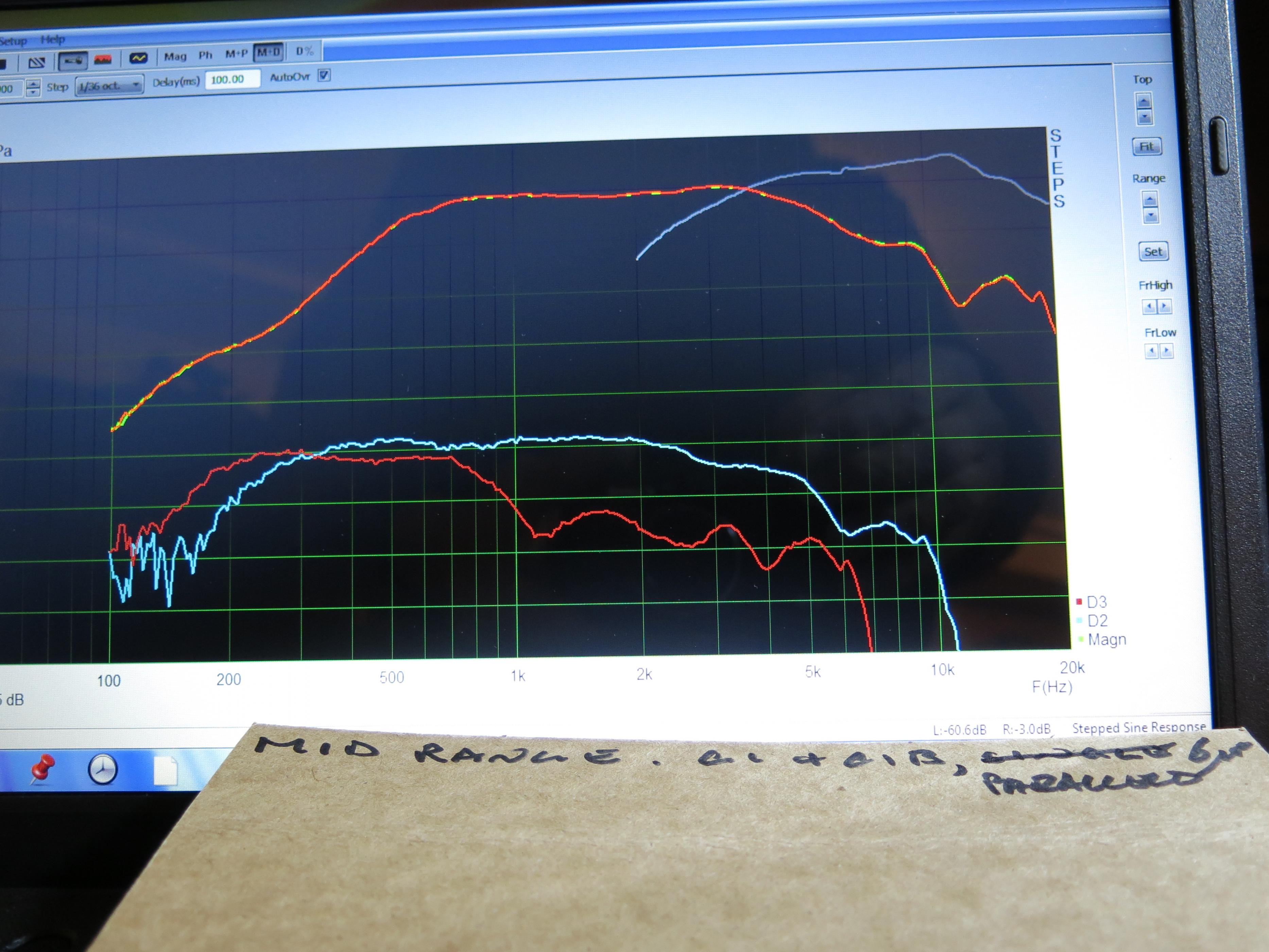

Picture 1) Tweeter measurement with 6uF. This is for reference.
Picture 2) This is the midrange measurement. The tweeters capacitors are 6uF each.
D2; 40dB till 2000Hz. Drops till it crosses 30dB @ 5100Hz. ~24dB till 9500.
D3; Under 40 till 700Hz. Mid 30's till 3700. Dropping below 20dB

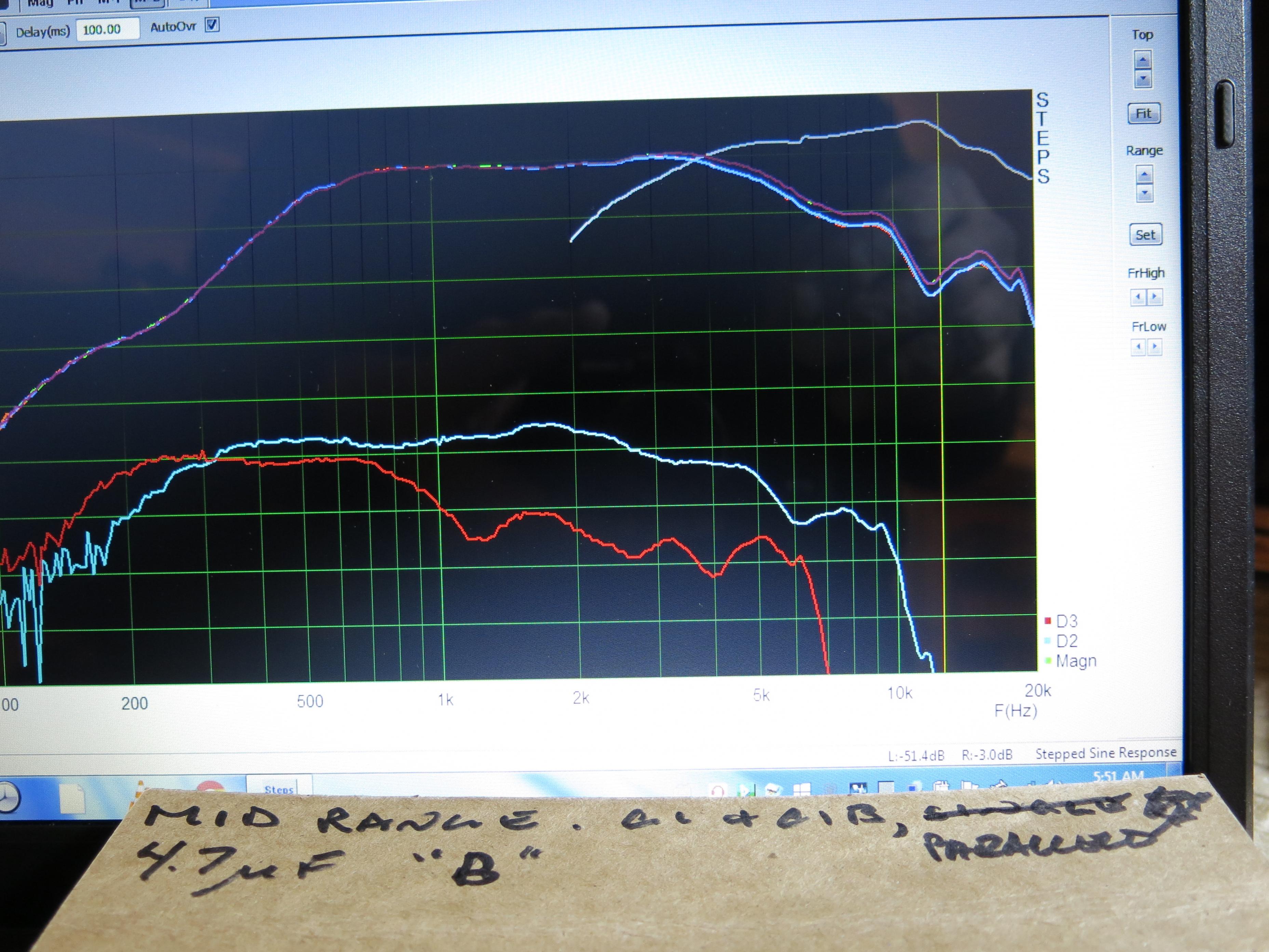

Picture 3) Just for fun, used paralleled caps (3.3 + 2.7). May as well have been the same measurement. Conclusion, the midrange is not affected by tweeter cap arrangement, only the value.

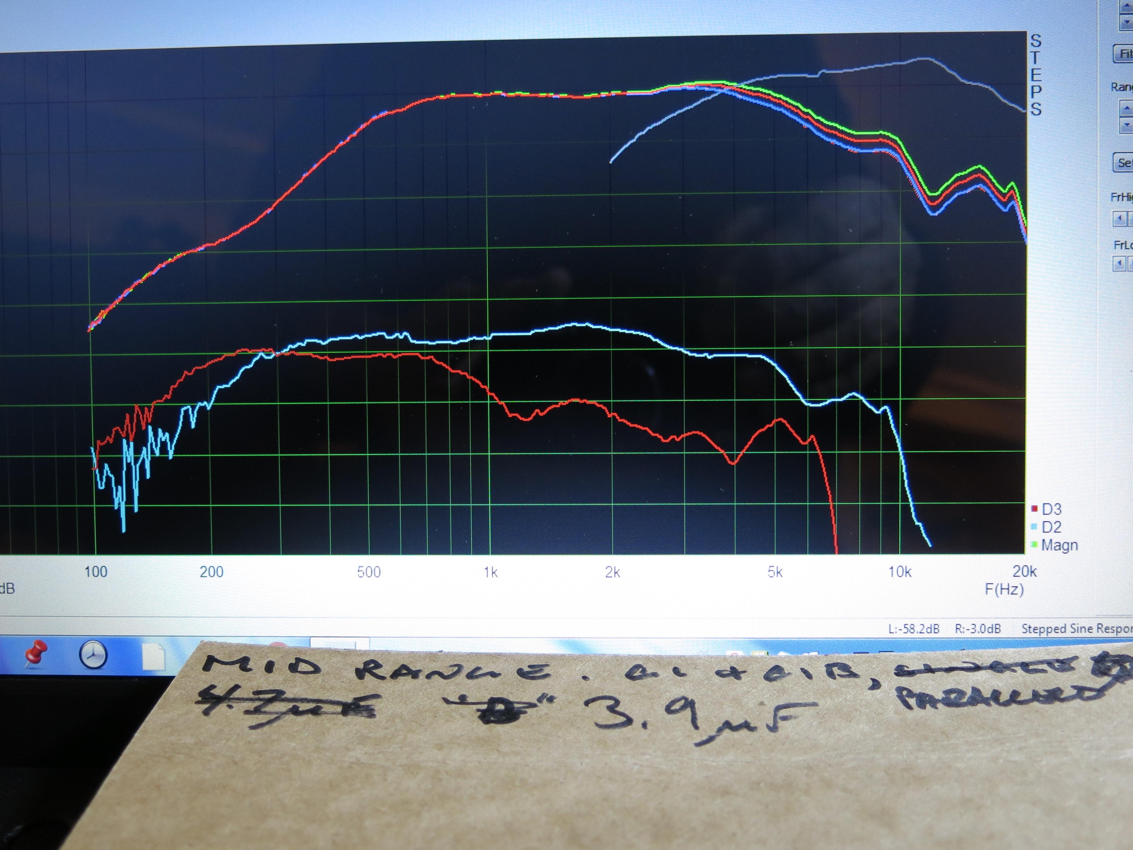

Picture 4) Dropping the tweeter cap values to 4.7uF. We didn't like this cap before. Let's see if foil orientation makes a difference.
D2; 40dB till 2200Hz. 30dB @ 5200Hz, 23dB till 9500.
D3; Under 40 till 700Hz. Mid 30's till 5200Hz (with some dips in between).
Picture 5) We just turned the 4.7uF cap around. Not a big difference from picture 4. Slightly worse than 6uF.
Picture 6) We drop to 3.9uF, and it's just plain worse.
Conclusions.
In Post # 5, sreten commented "capacitors affect the x-o point". 100% correct. The only thing we need to make sure of, the capacitors for the tweeter need to be higher than the normal series crossover ideal.
Our value of 6uF is more than twice what the parallel calculation would suggest.
In Post # 16, Bob Richard commented (near the end of his paragraph) "When you change one part's value, it throws off other parts".
Changing the caps for the tweeter affects the crossover point. Choosing a value too small adds distortion to the midrange.
Our new choice of 6uF now puts our crossover point below 4000Hz.
Not my ideal. I want the Accuton C50 (C51 in the future) to cross above 4000. Troels suggests the 2" Accuton can play easily till 5000Hz. He also calls it the best midrange he's ever heard.
I don't have any large guage (12awg) .25mH or .27mH lying around. Time to spend more money.

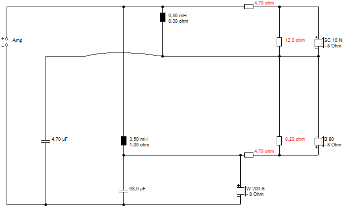

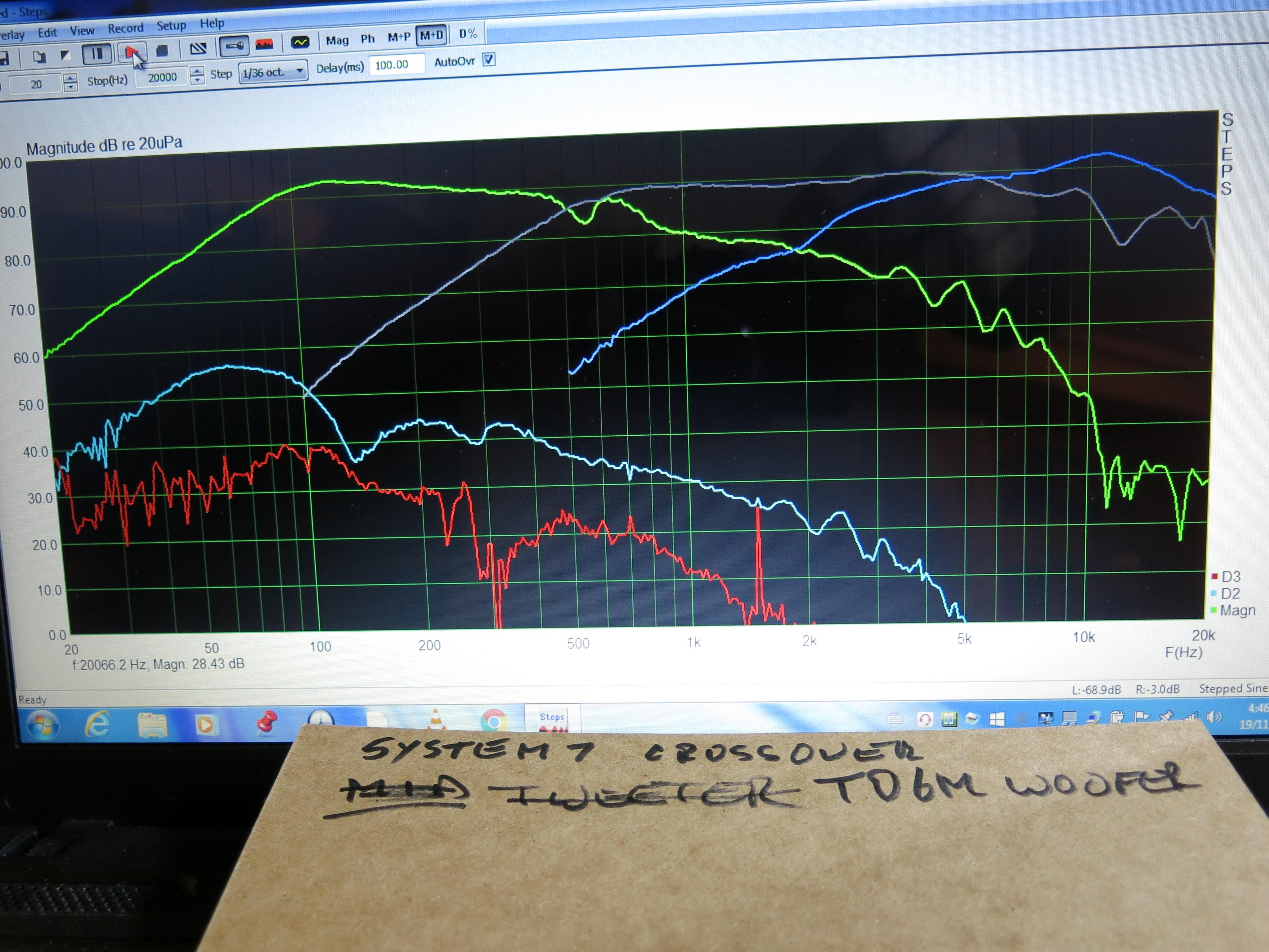

system7's crossover

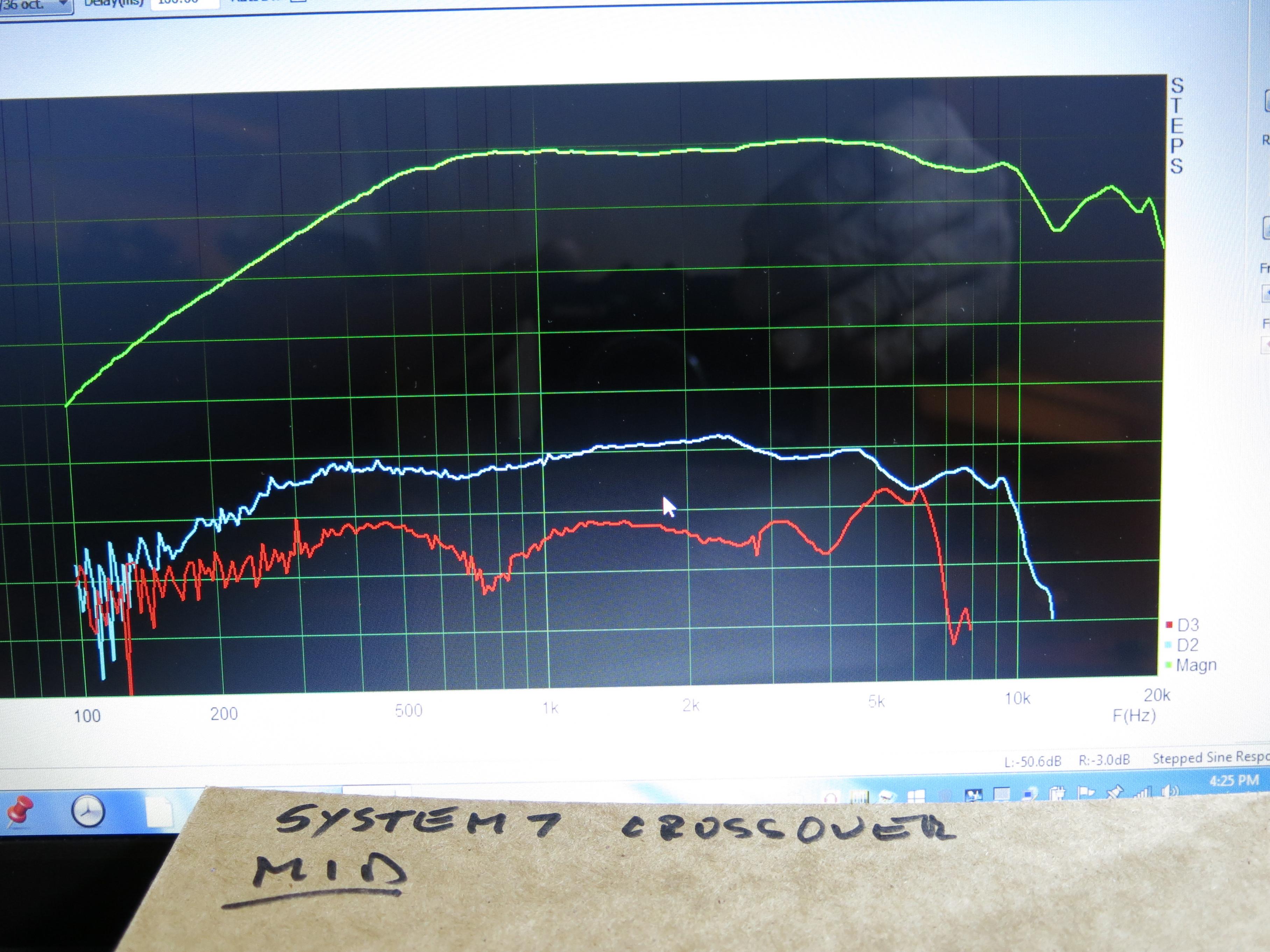

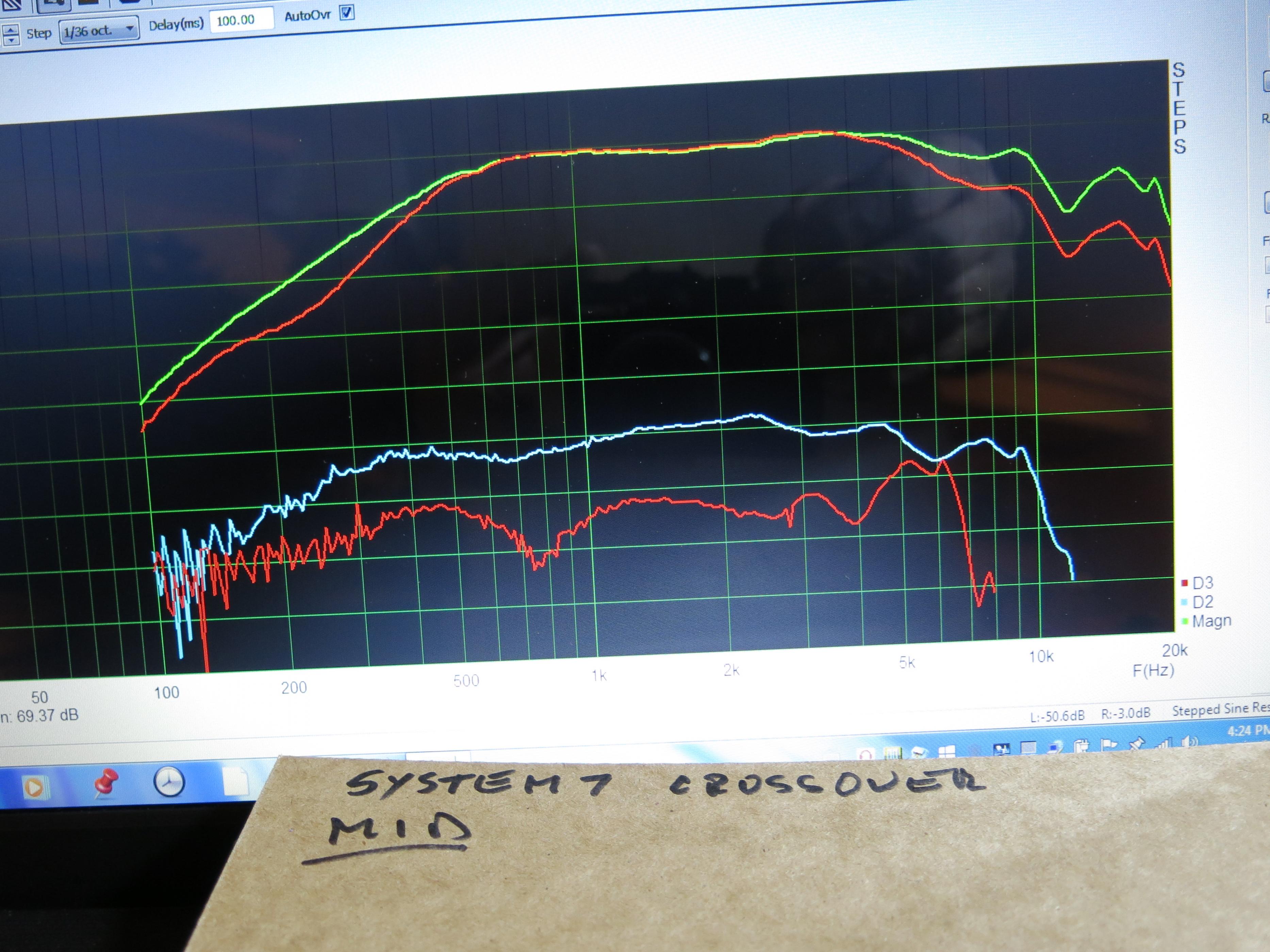

Picture 1) Midrange measurement. I left my own 4.7uF trace for reference.
Picture 2) I removed my red trace.
Picture 3) Tweeter measurement.
Picture 4) Tweeter with my trace removed.

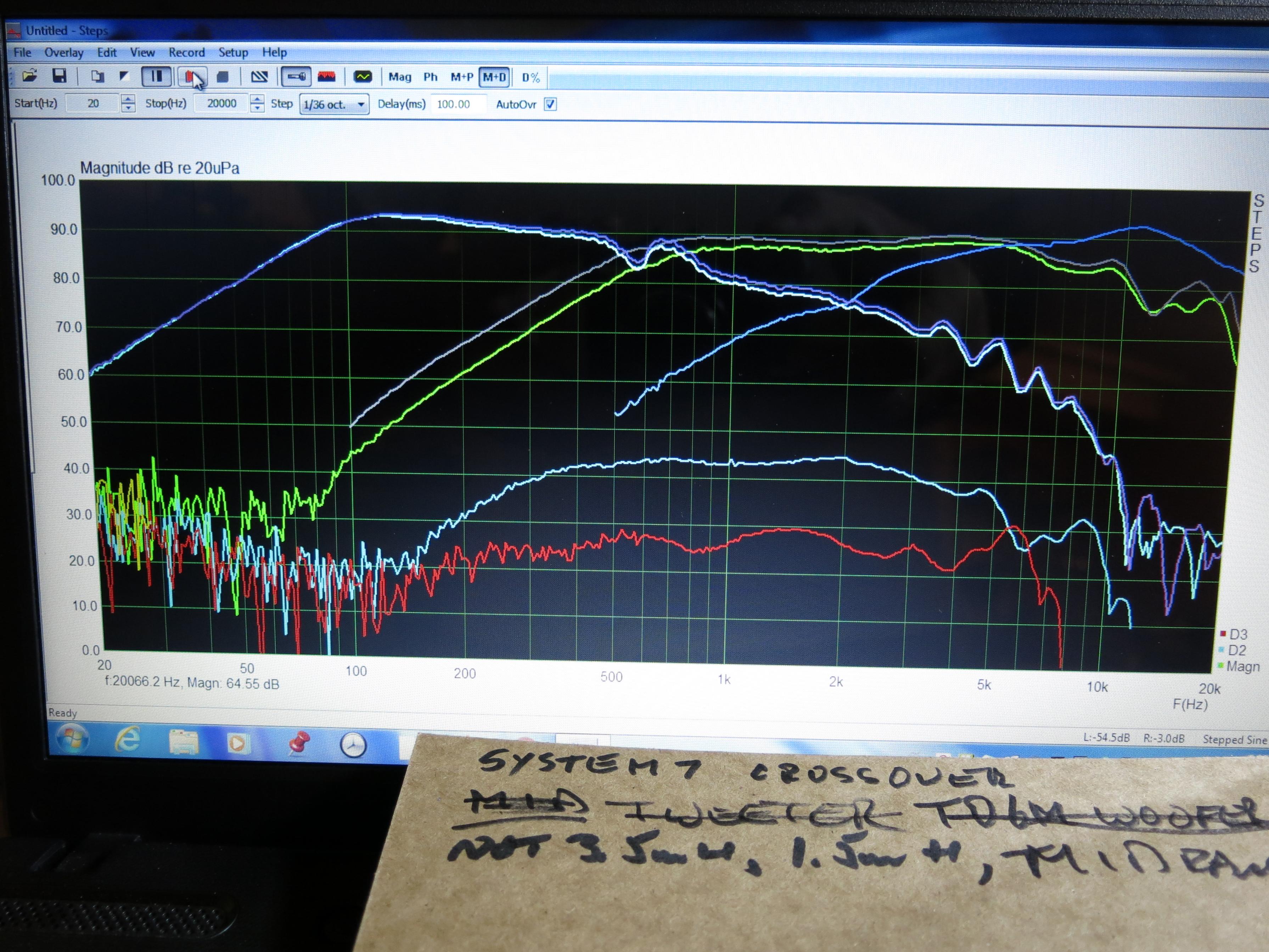

Picture 5) Woofer measurement.
Picture 6) I decreased the range.
As expected, 1st order crossover have large overlaps.
I did a quick listen with music, at moderate levels, not bad at all.
I would cut the 3.5mH inductor in half. This will significantly raise the high pass for the midrange.

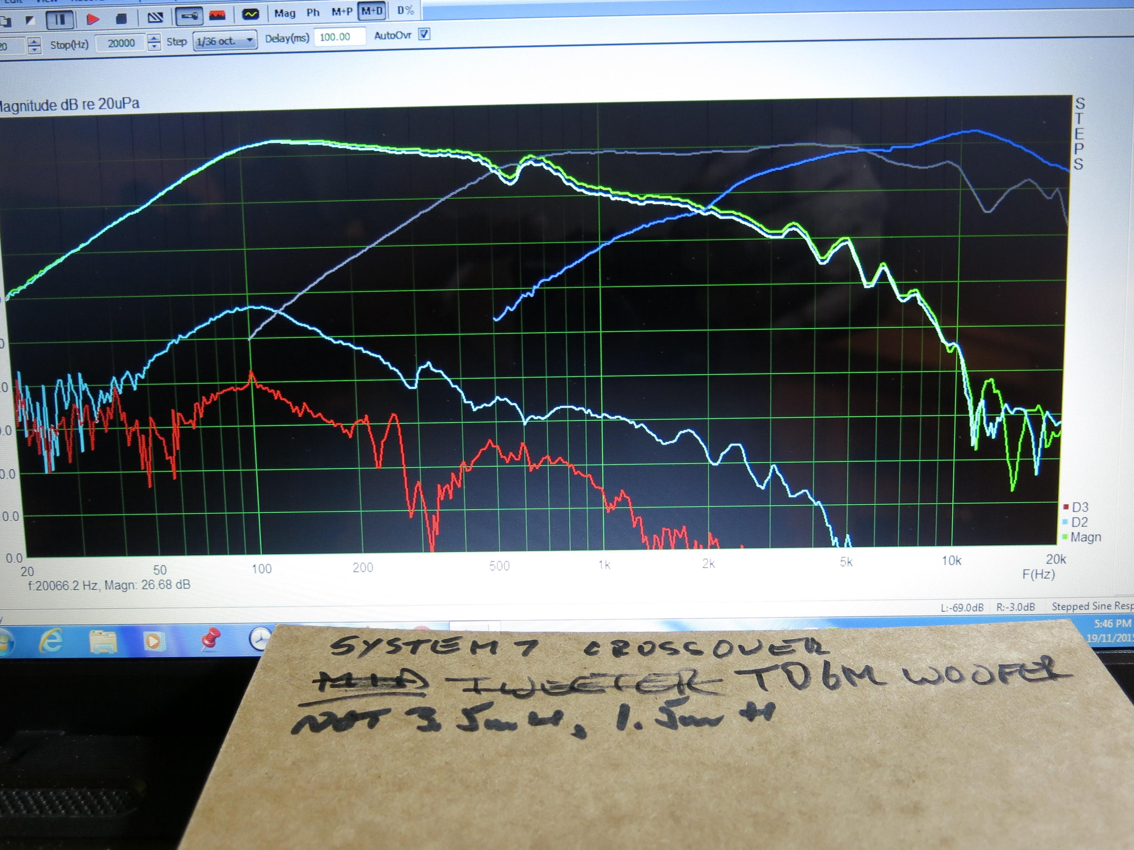

Picture 1) I've lowered the 3.5mH inductor from system7's crossover. The new value is 1.5mH.
This picture shows very little change in the woofer response. Certainly nothing near what one would expect. This shows me so much it's scary. I have no doubt very few of you will accept it.
At some point in our history, someone decided we needed to be bent over, pants pulled down, and you can guess the rest.
The theories used for series crossovers today are absolute crap.
There is no such thing as a first order series crossover. The slopes are not compatible with todays drivers.
Picture 2) The midrange. We now cross closer to 750Hz. This would be quite listenable at moderate levels. No way in hades you would turn up the volume.

system7, how did I miss your schematic from post #87.
Your values are very close to my final values.
Only changes; we add the 2nd order components (greater slopes), we raise the cap values.
If I have time today I will test system7's crossover.
I will then add the 2nd order components, and measure.
