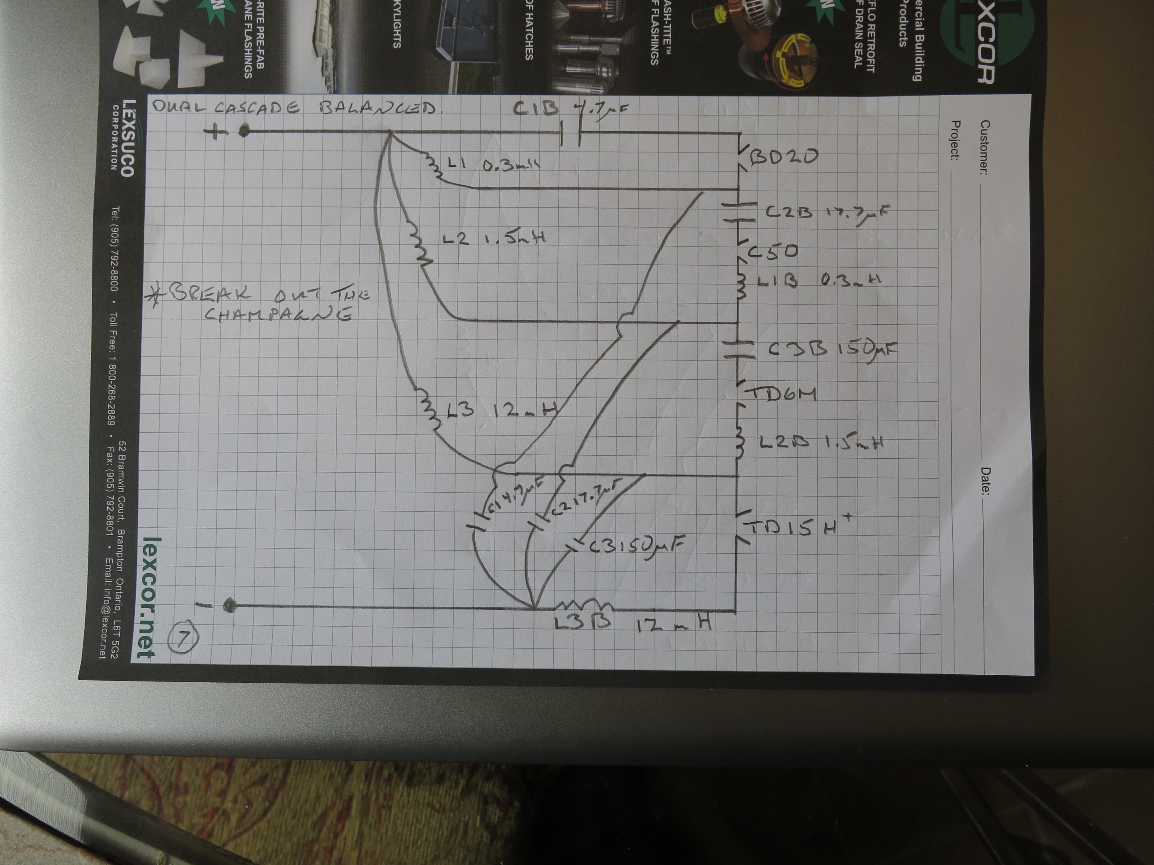

Expanding of the Dual Cascade Fully Balanced Paralleled Series Crossover.
It was the Tweeter/Midrange that caught my eye.
This might be called reverse engineering.

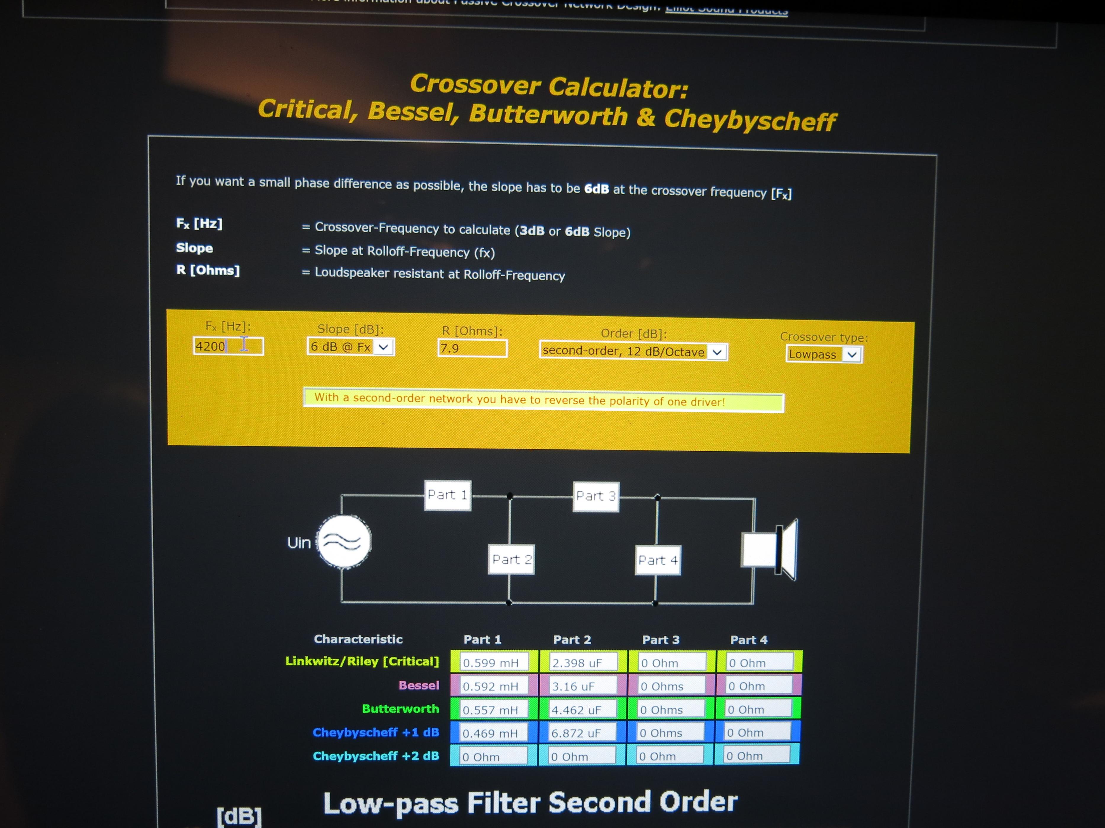

Picture (1) is from the mhaudio website. We know our inductor L1 is 0.3mH. We know we are crossing at 4200Hz. We like the trace with a 4.7uF capacitor. What caught my eye was the resistance necessary for this scenario. Why did the computer suggest a value of 7.9ohms?.
When I go to the Accuton website, I look at the impedance trace for the tweeter. Their measurements show a value around 6.8ohms at 4200hz. The value for the adjacent driver, the C50, is 9.0Ohms, at 4200Hz. If we simply add these two together, and divide by 2, we see the average for these two drivers, at that frequency, is 7.9ohms. Hmmmmmmm?
It was blind luck that 4.7uF was the target cap value. This is a standard value, and I don't expect our luck to hold out.
I will insert different cap values, and see if the crossover point is changed, or just the slope.
In my picture, when looking at the mhaudio cap and inductor values, remember the caps are double what a parallel crossover would be, and the inductors are half.

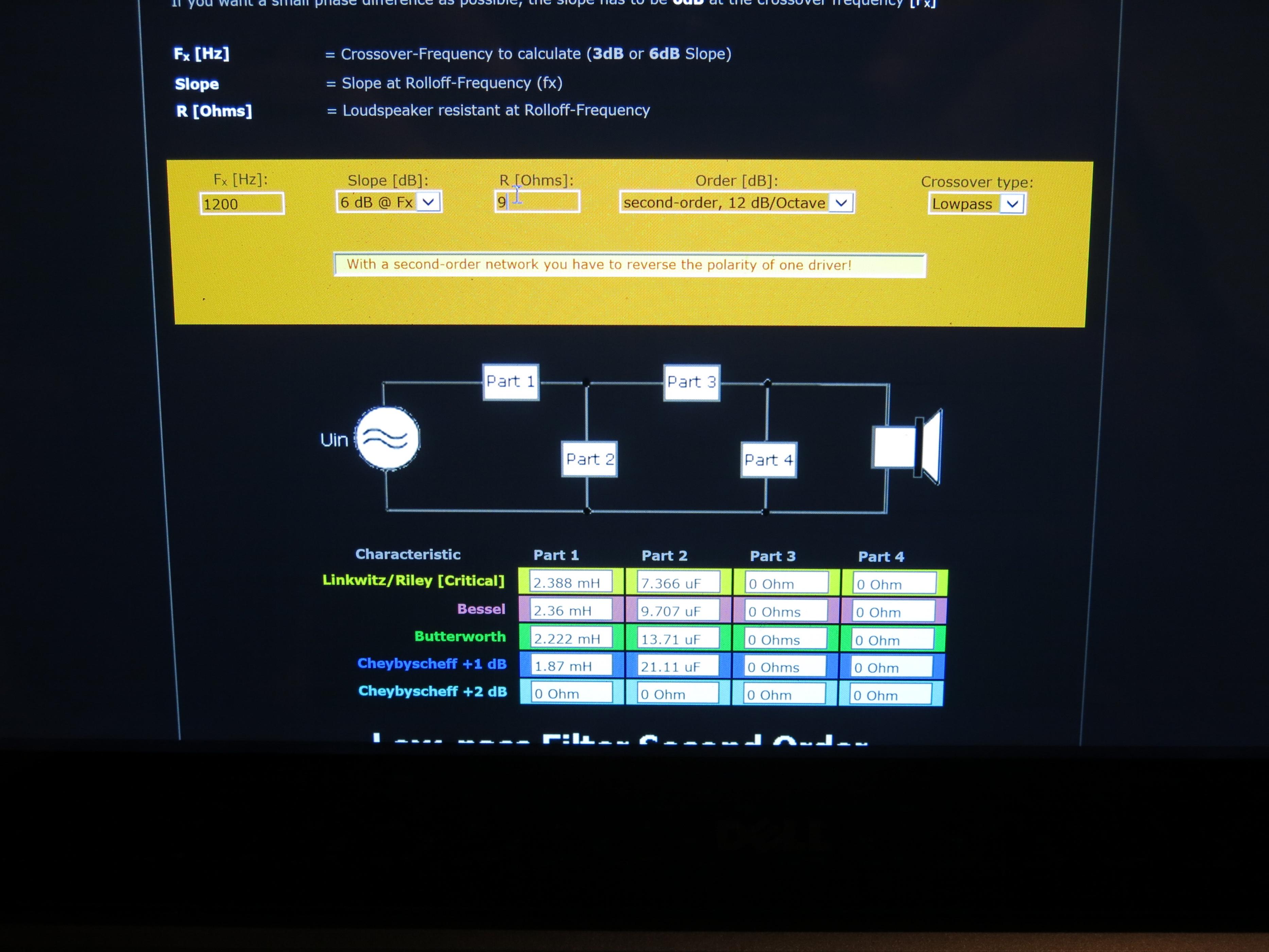

Next is the midrange to mid woofer crossover point.
We like the crossover point using a 1.5mH inductor.
We know this point is 1200Hz.
We see that mhaudio say 11.7uF is ideal. We are presently using 17.7uF. This will be changed, and all driver slopes measured. Remember, we are trying to see if a change in one spot results in variations elsewhere.
We know the Accuton C50 is 8.5ohms at 1200 Hz.
So quick math shows us the Acoustic Elegance TD6M is 14.1ohms at 1200Hz.

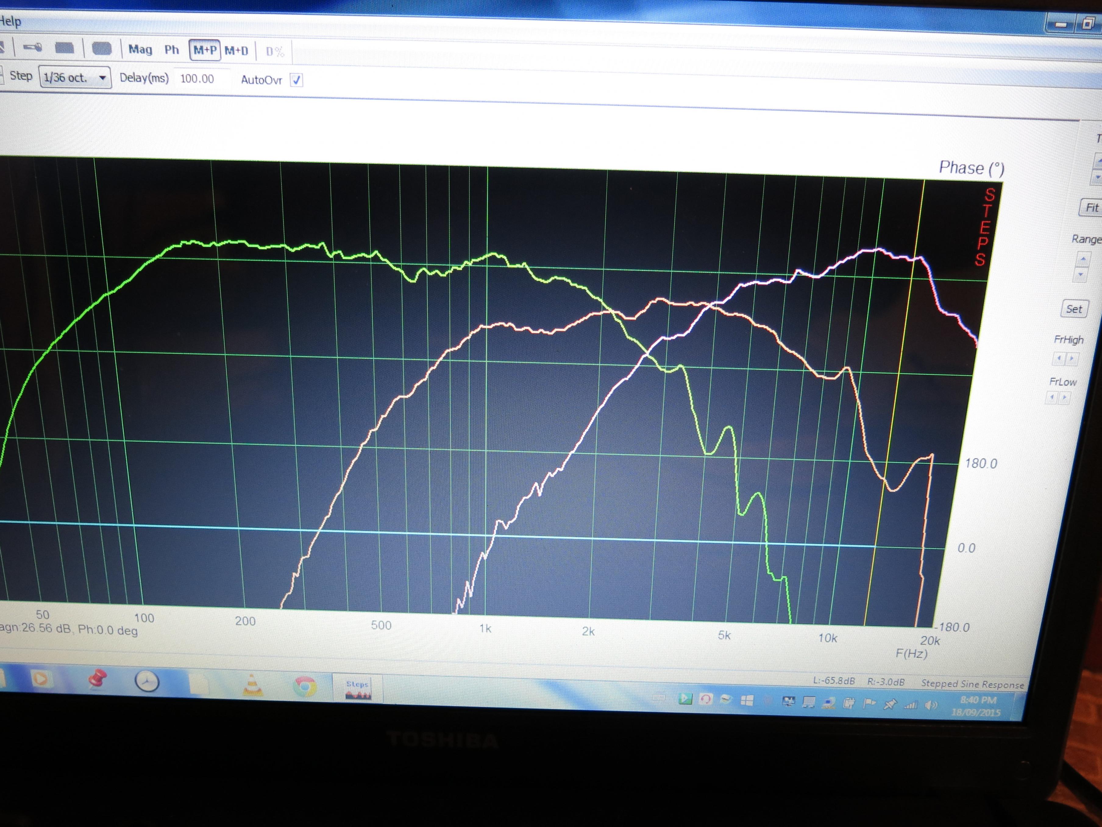

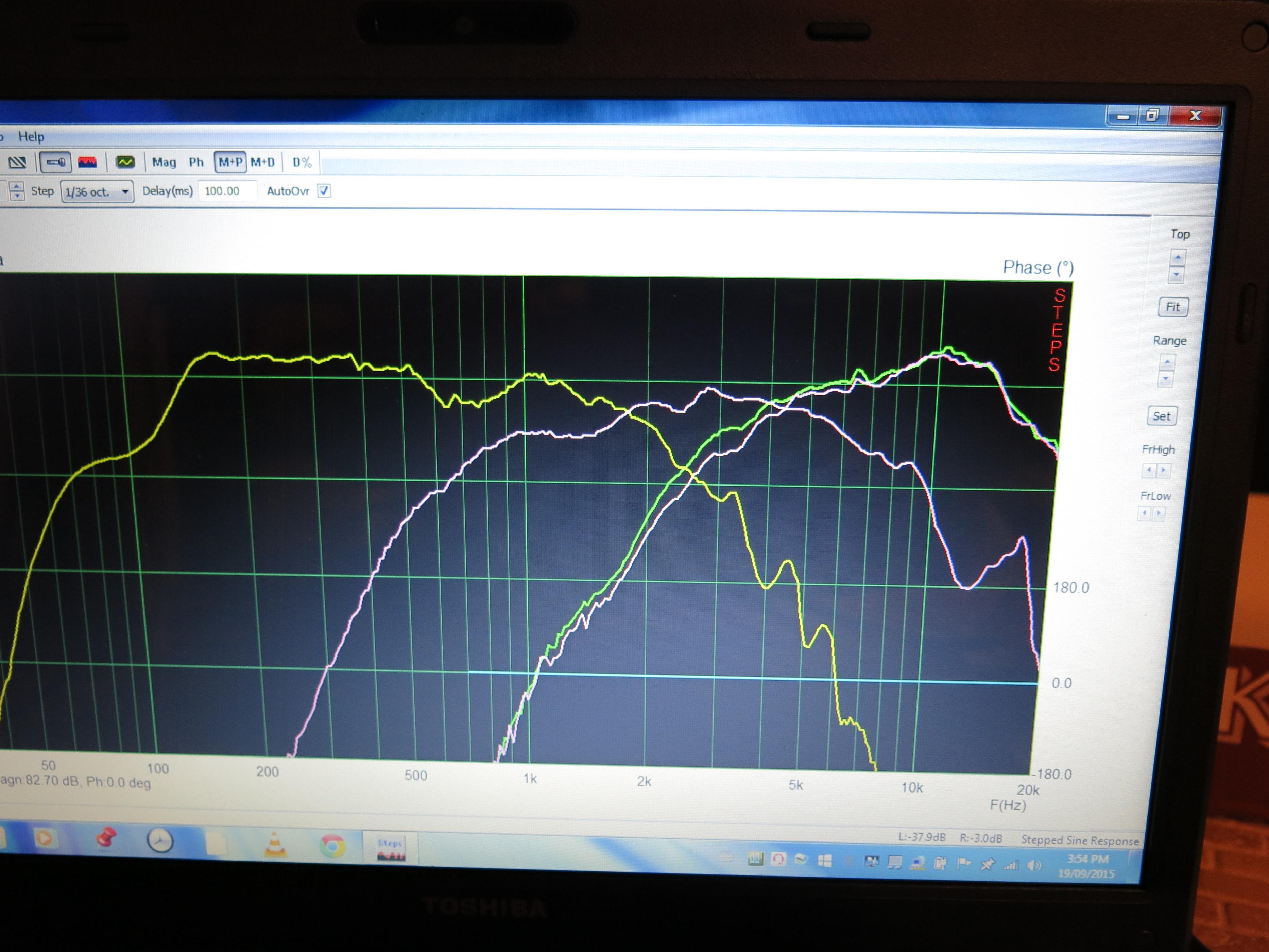

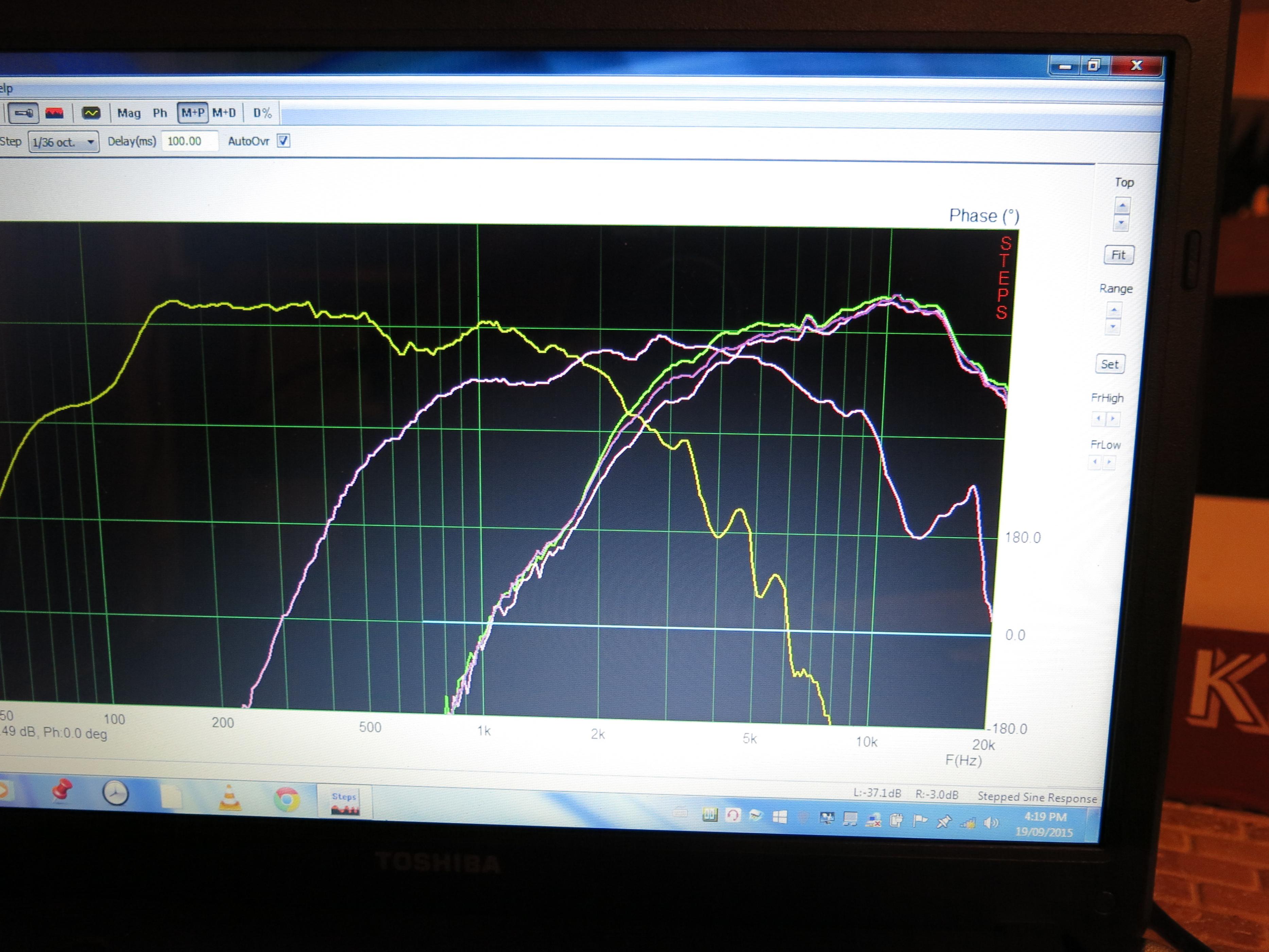

In post #19, I started to deal with the TD6M's 700hz anomaly.
Last night I chamfered the inner edge of the baffle.
This morning, I woke at 4:30 am. Was I that anxious?.

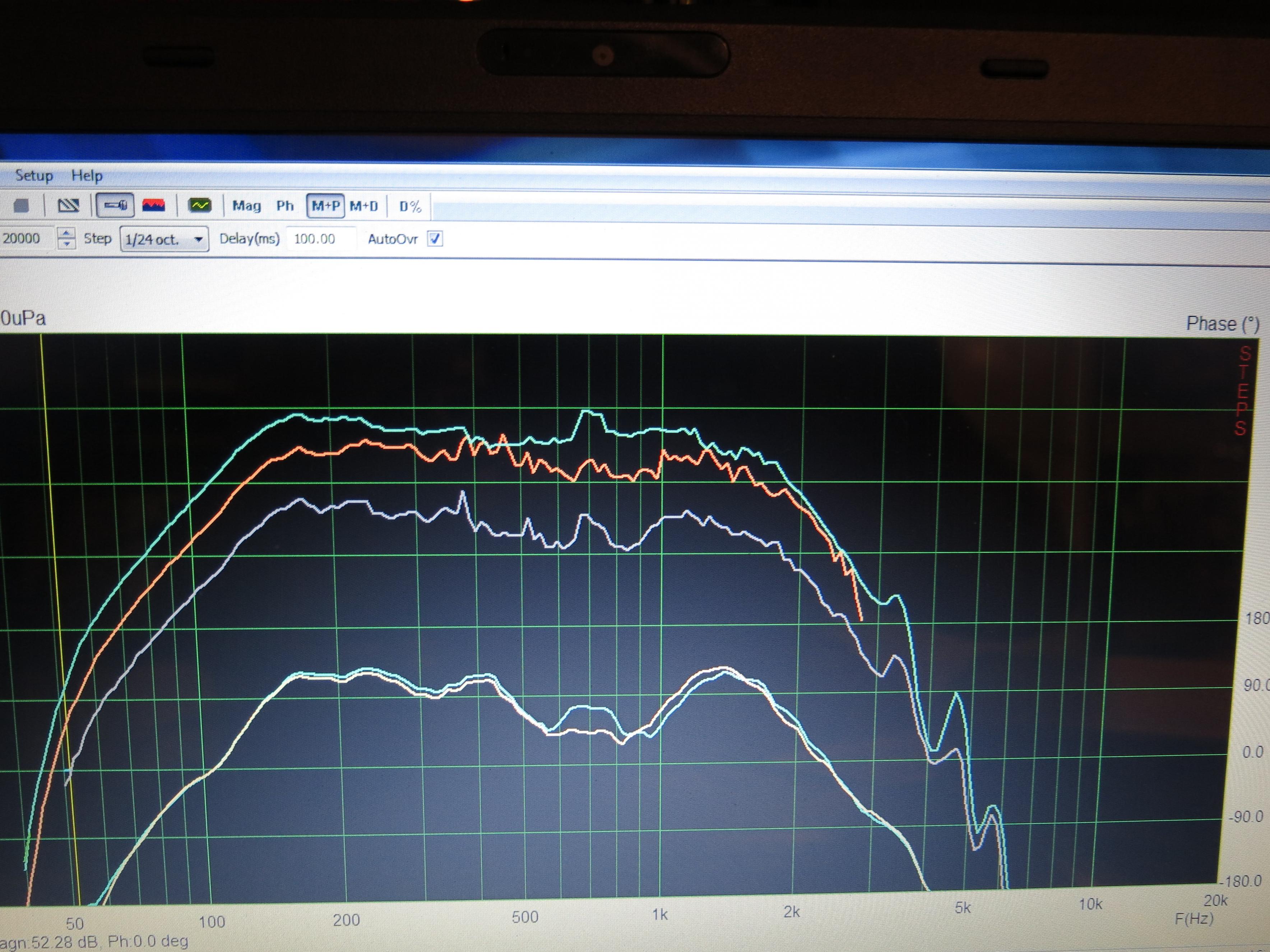

The top line, light green, is right at the phase plug. Chamfered inside baffle. This morning.
The next line, orange, is from a few days ago. This is non-chamfered. It appears to be a little more ragged than the chamfered version. So, chamfering smooth's the response a bit, but we're here for the 700Hz thing.
The third from top, baby blue, is 20" away. This is where the microphone will stay.
Time to remove the Sorbothane from the magnet. I will be leaving the closed cell foam around the basket base.
I turned the volume down. This might help with room influences.
Both the bottom two traces are smoothed. 20" away. The graph with the bump has the Sorbothane, the graph with no bump has no sorbothane. The sorbothane is gone.
Some of you are thinking, we're done. The second smoothed line worked. Sorry, there was a single spike at 700Hz. This was removed with smoothing.

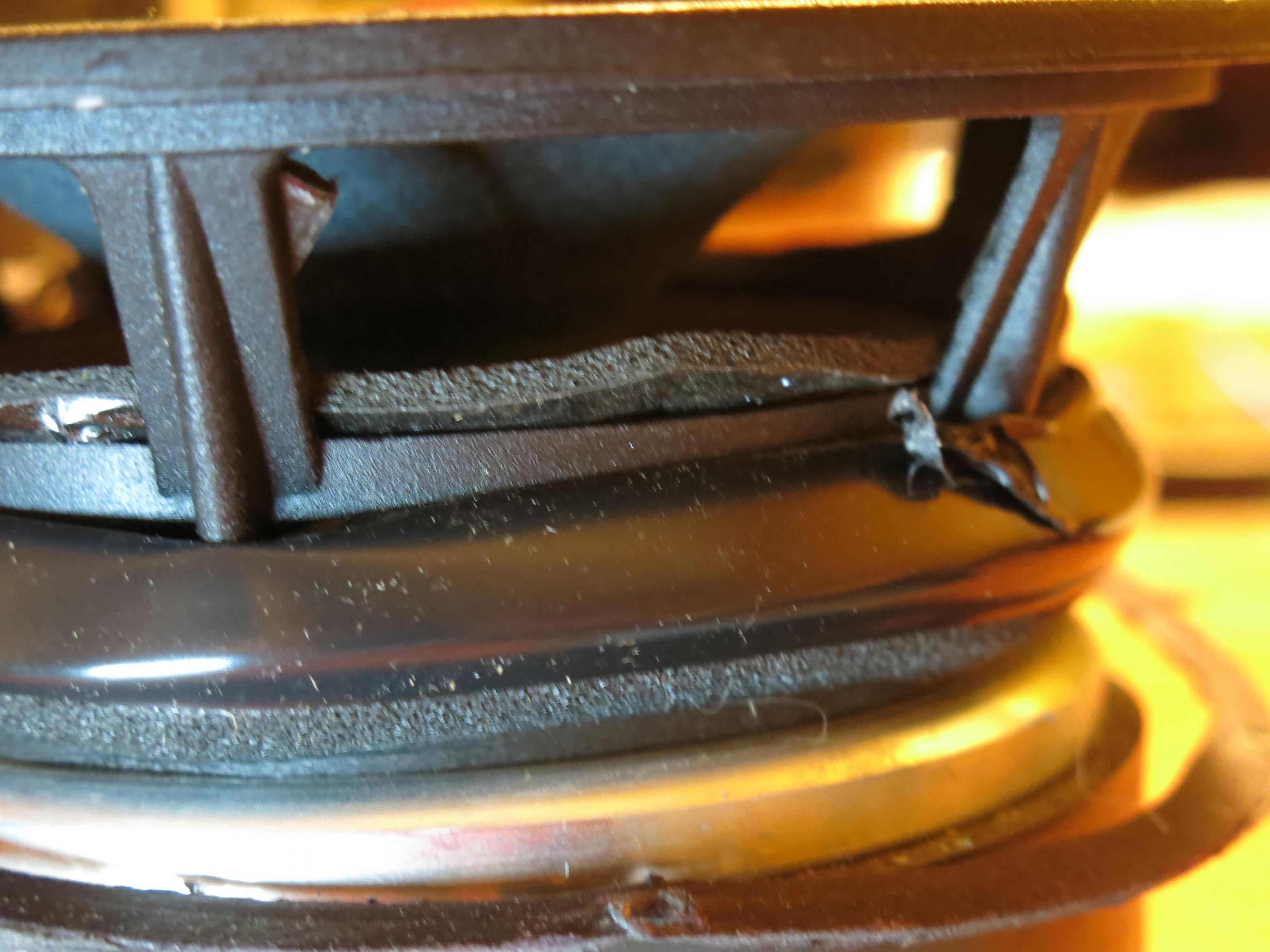

The 700Hz anomaly is coming from the spider. This spider, which centers the moving parts, is glued to a subframe. The 700Hz anomaly is a reflection from this subframe. It hits the underside of the driver cone, causes the voice coil to move slightly, and there's our impedance blip.
Next post in 20 minutes. Time to go down stairs, remove the driver, put a bit of something on the spider centering ring, and measure.

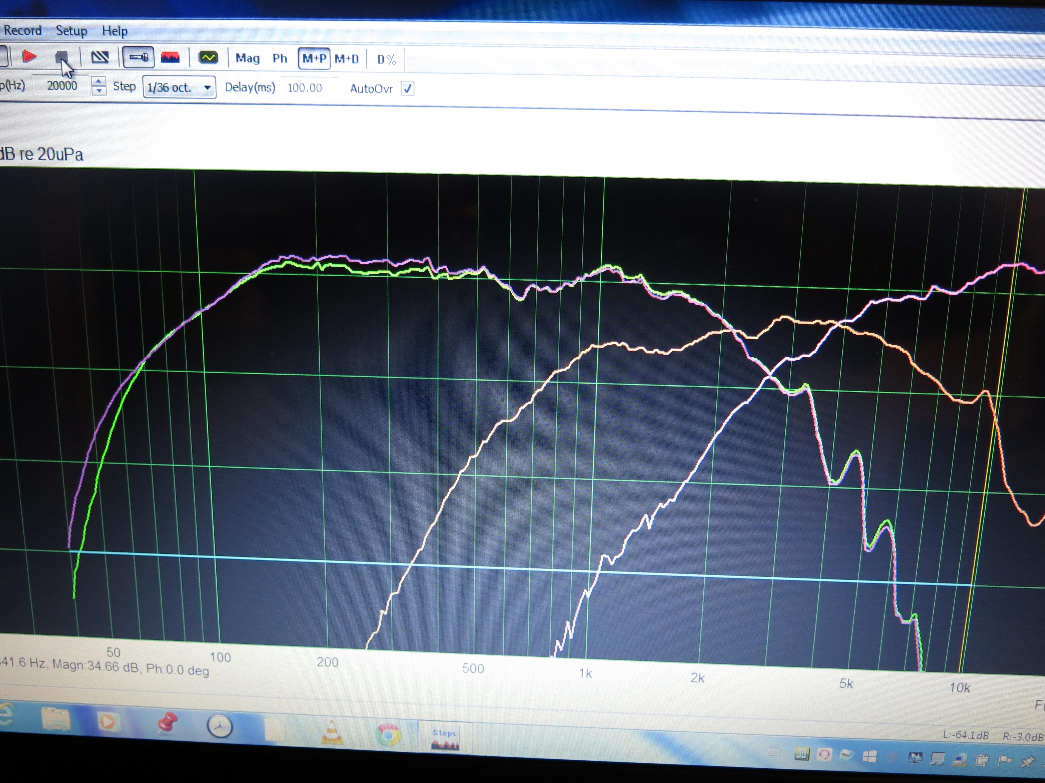

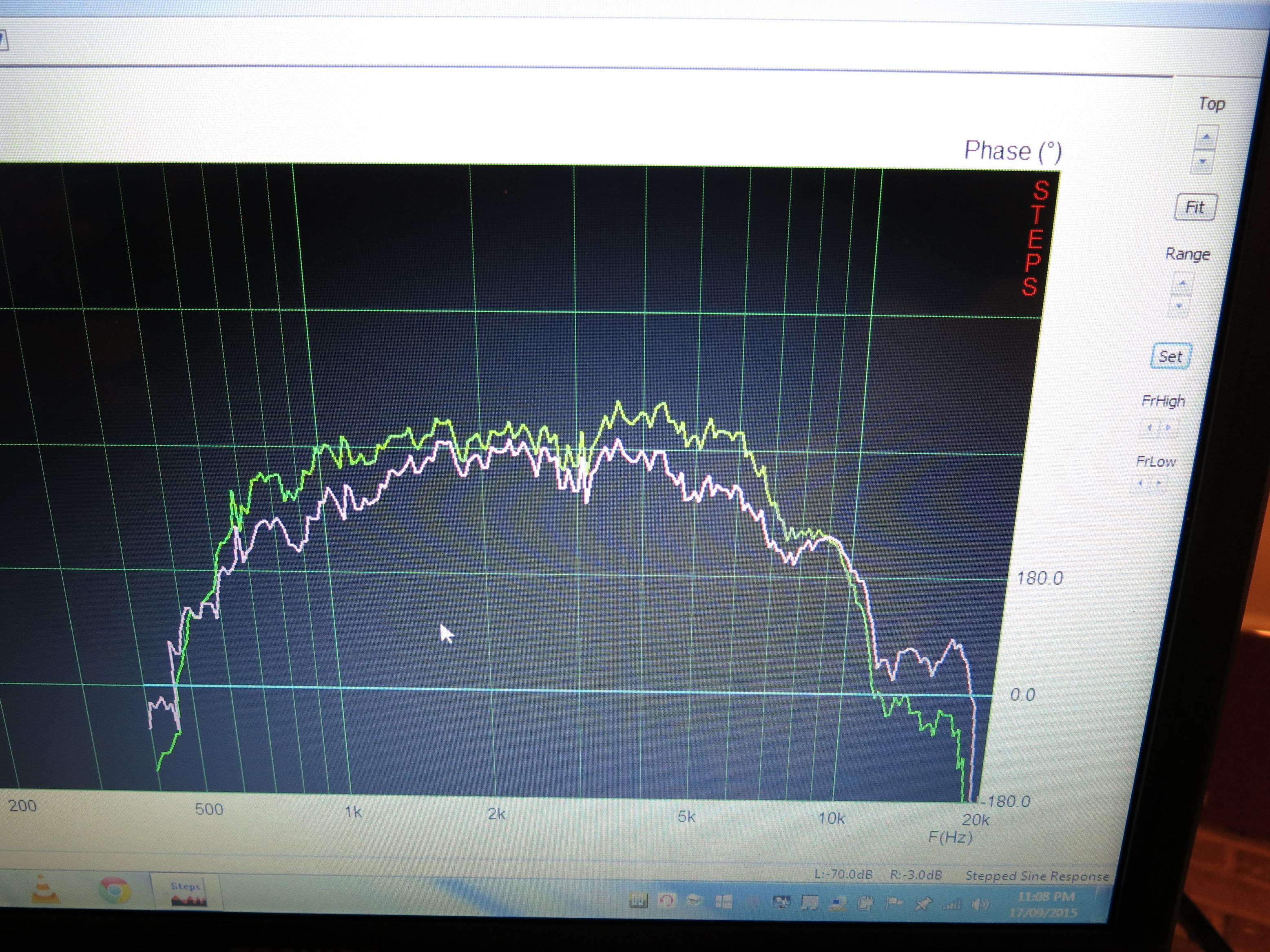

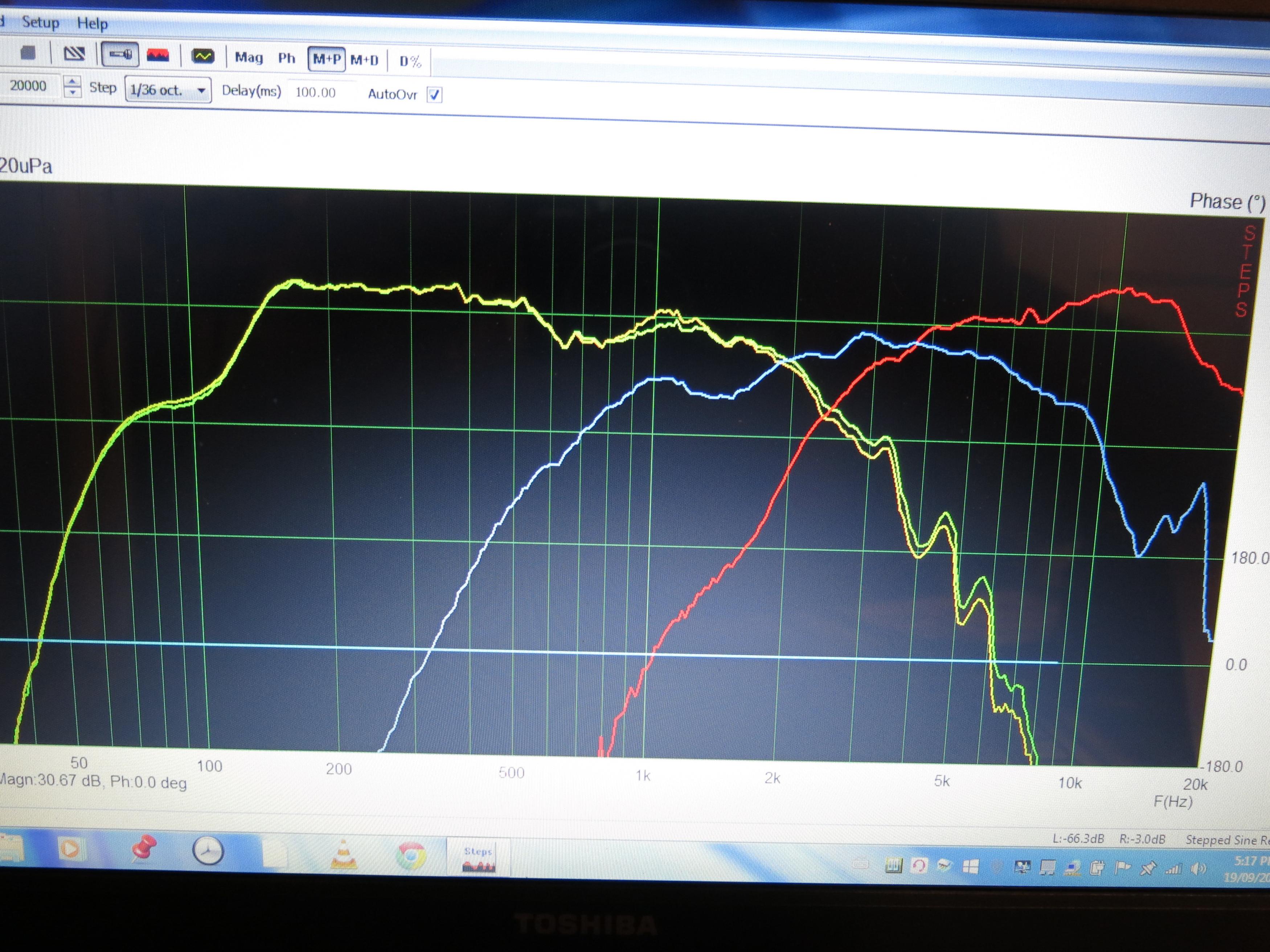

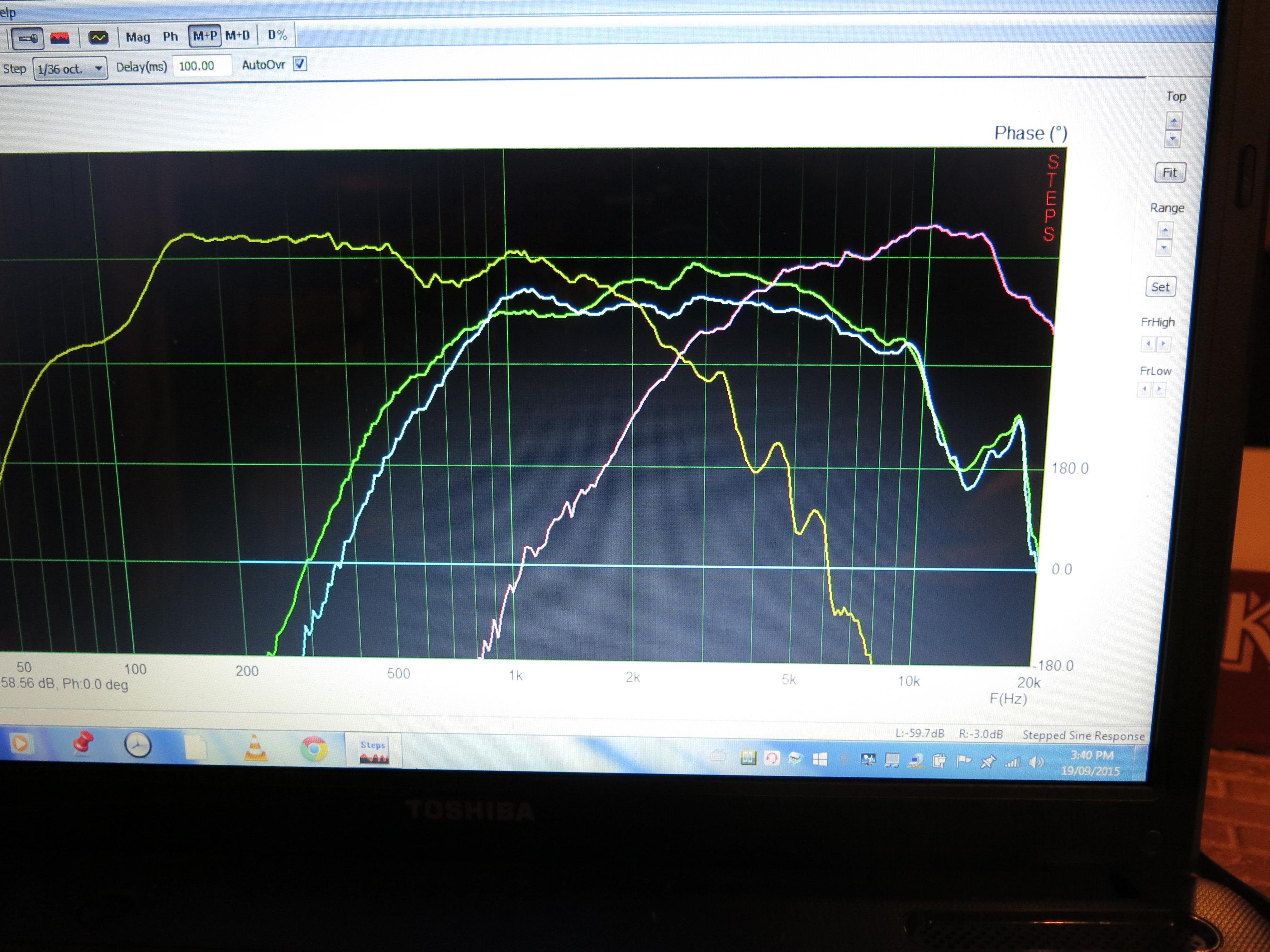

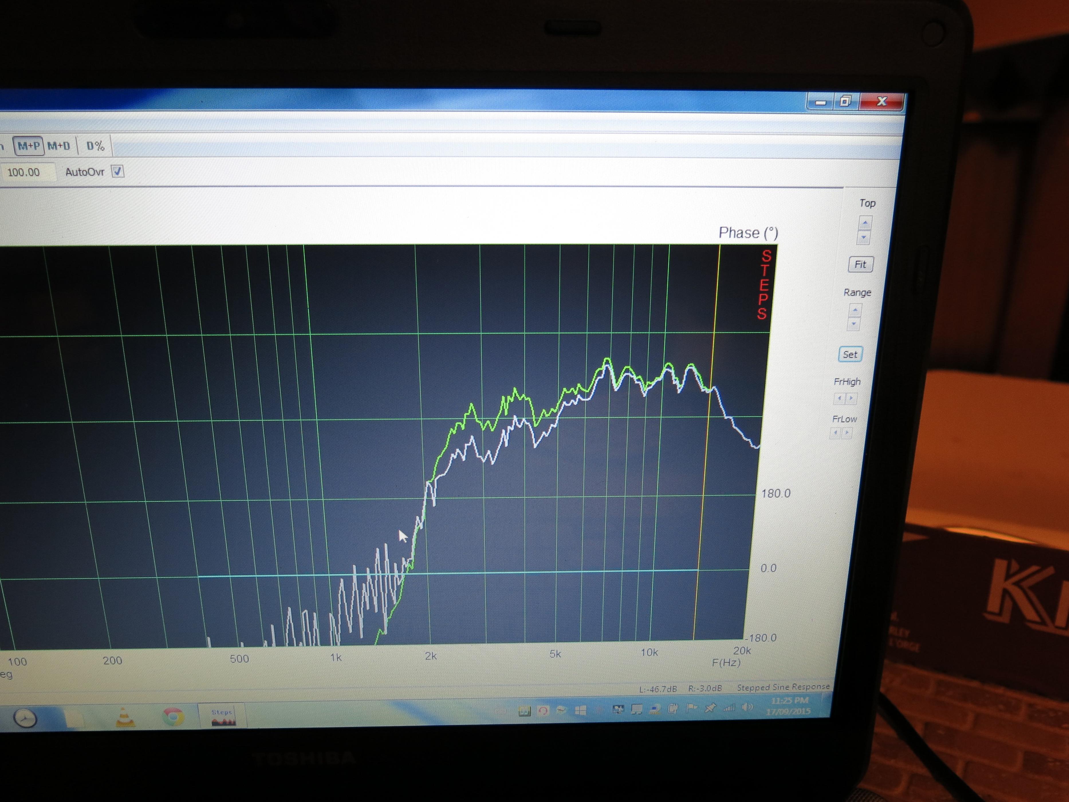

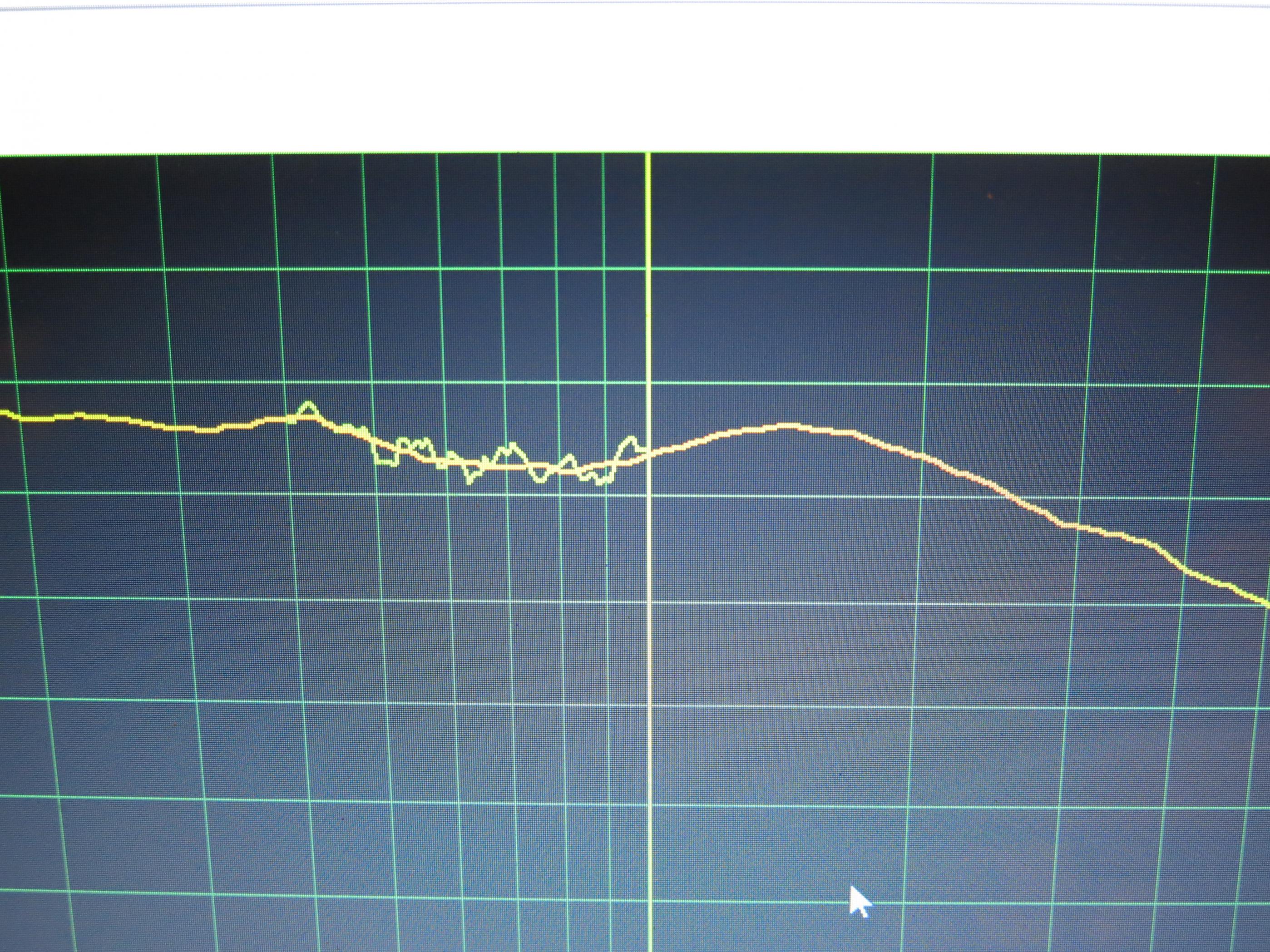

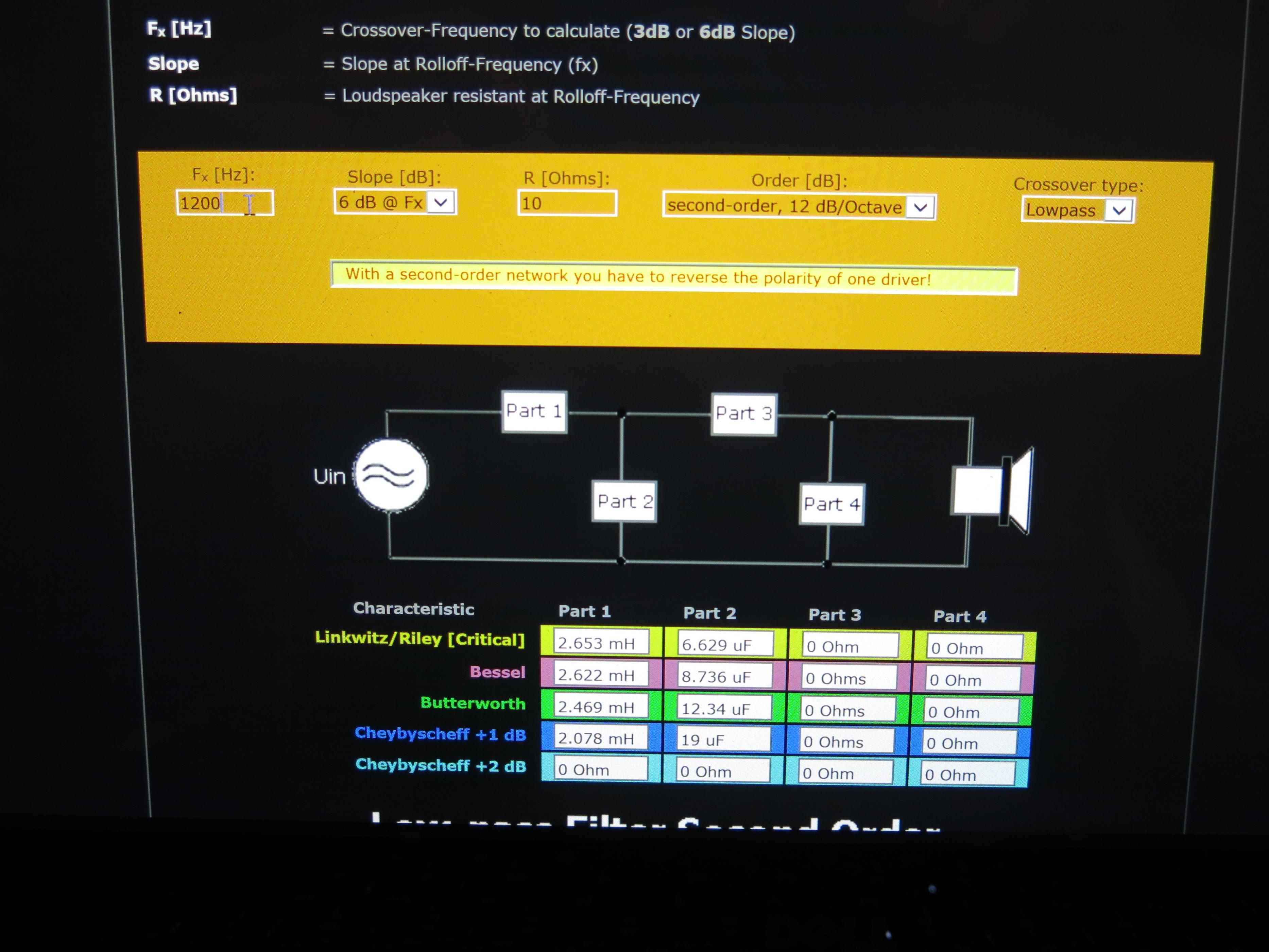

It worked.
The 700Hz thing is gone.
Picture 1) Close up of TD6M basket. Look at the size of the basket posts. I put a little mini piece of closed cell stuff on the posts. I also wrapped a long piece along the inside edge of the spider housing. Sound easy?, you try doing it with big calloused roofers fingers.
Picture 2) response, 1/24th of an octave gates. Nice.

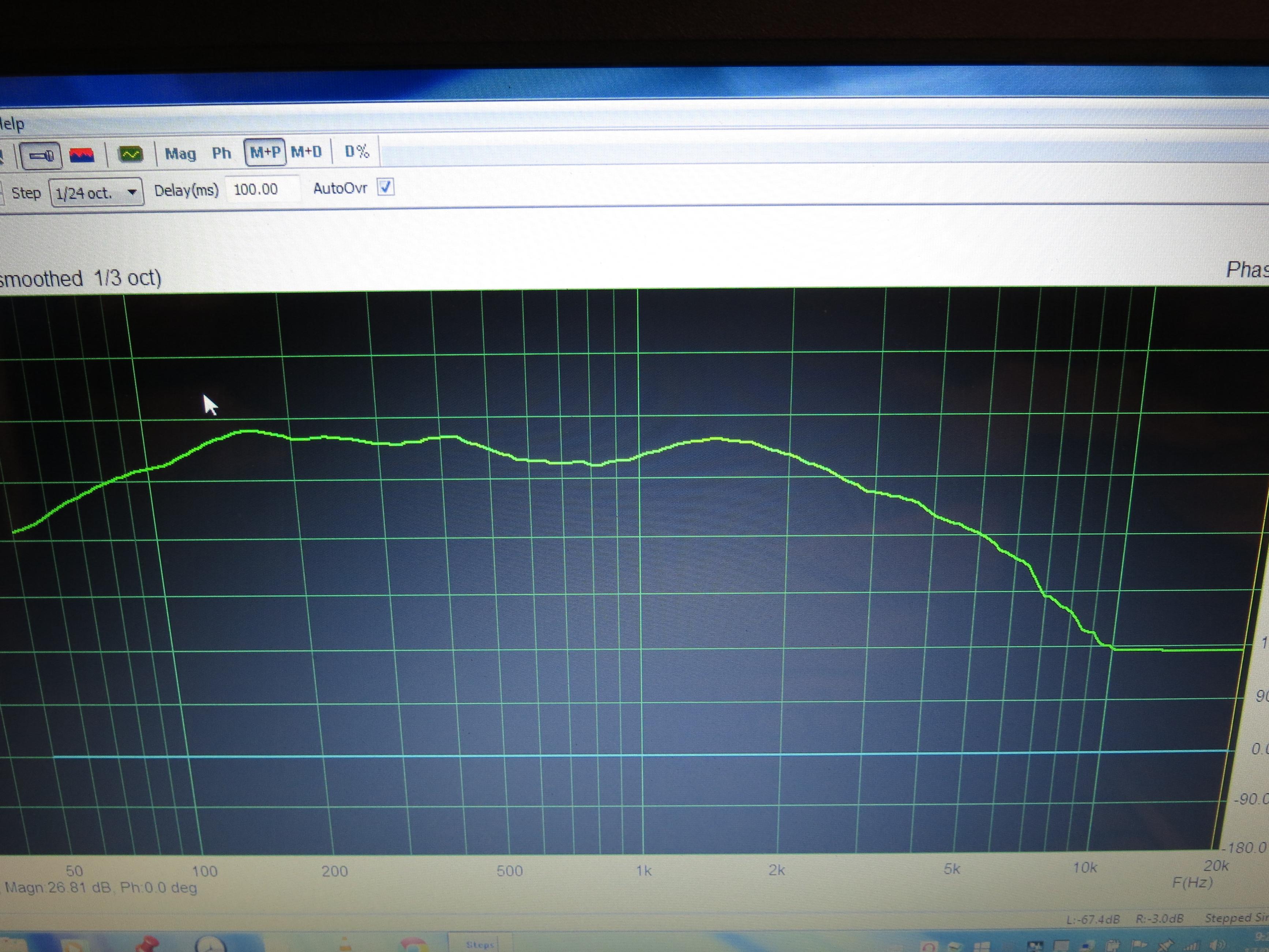

Picture 3) smoothed.
Picture 4) 400hz - 1000Hz, 1/48th of an octave gates.

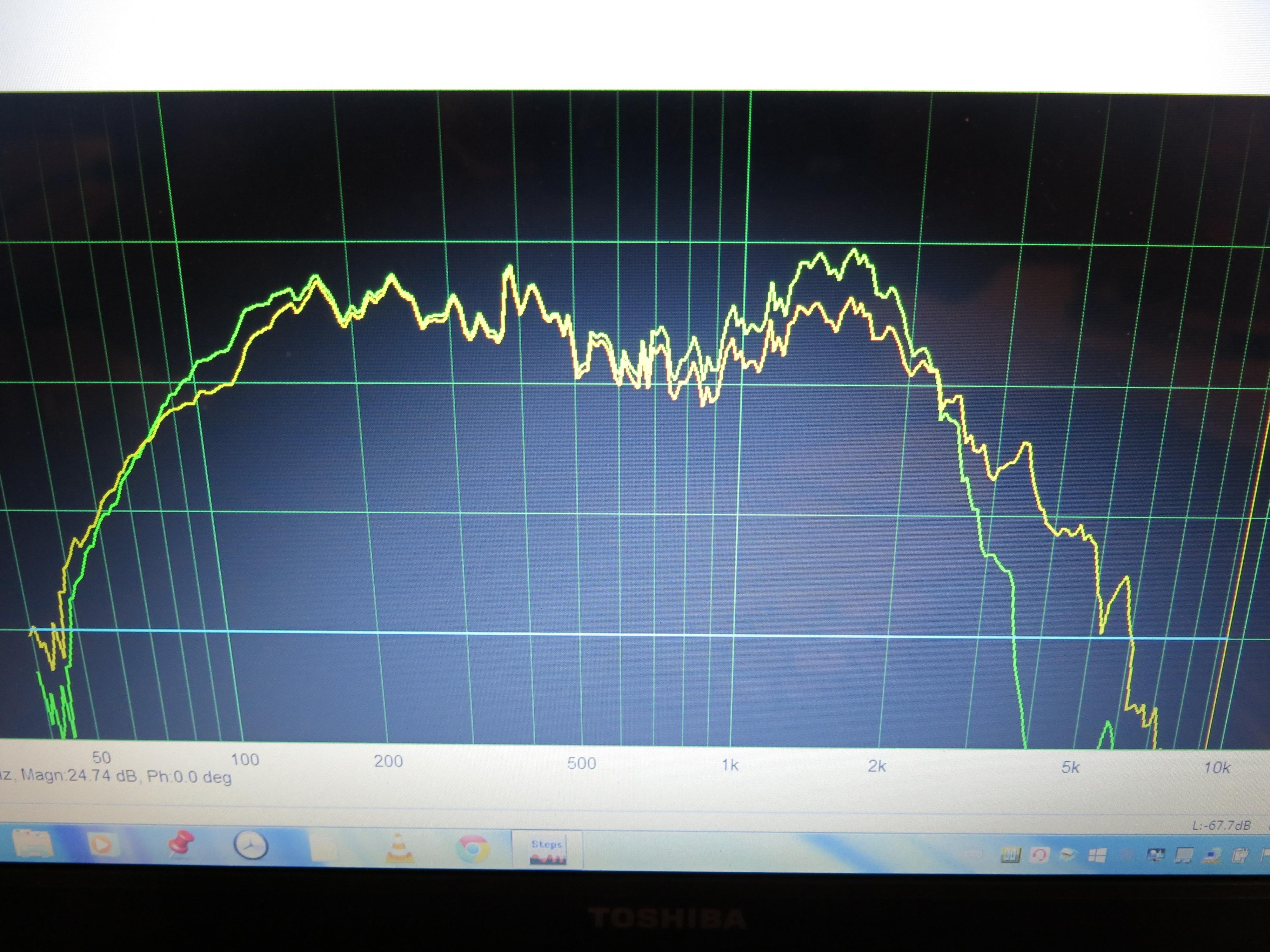

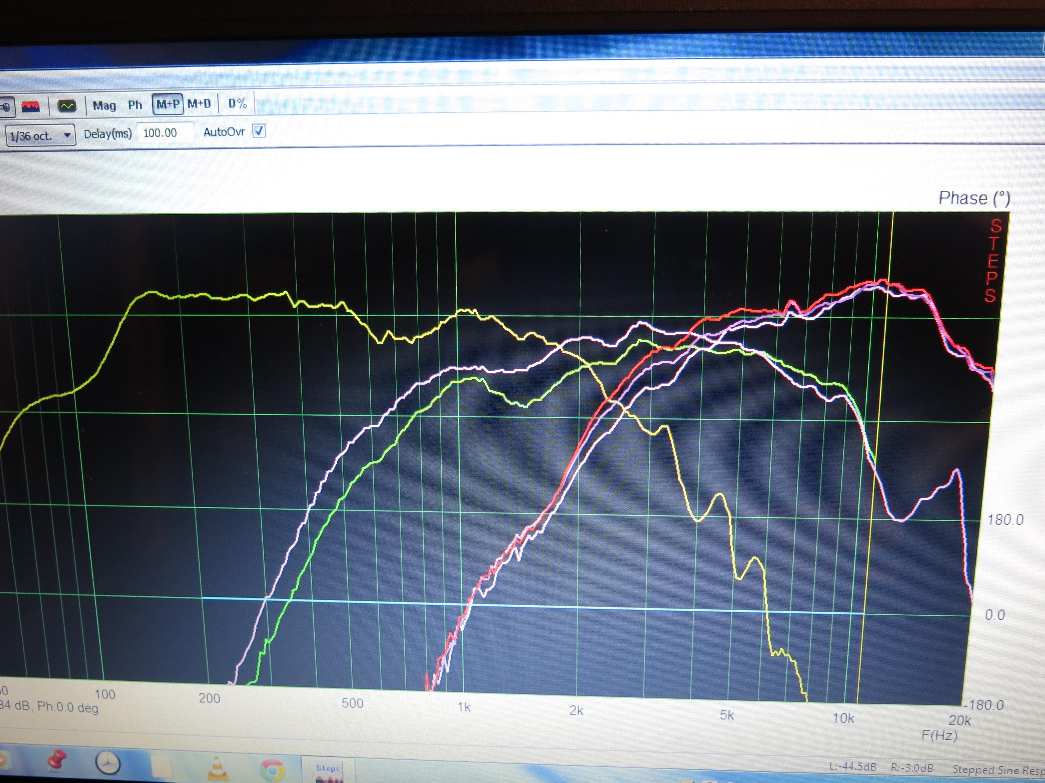

What the heck happened?
I know it's only 5:30 in the morning, but ????
Picture 1) This mornings measurement

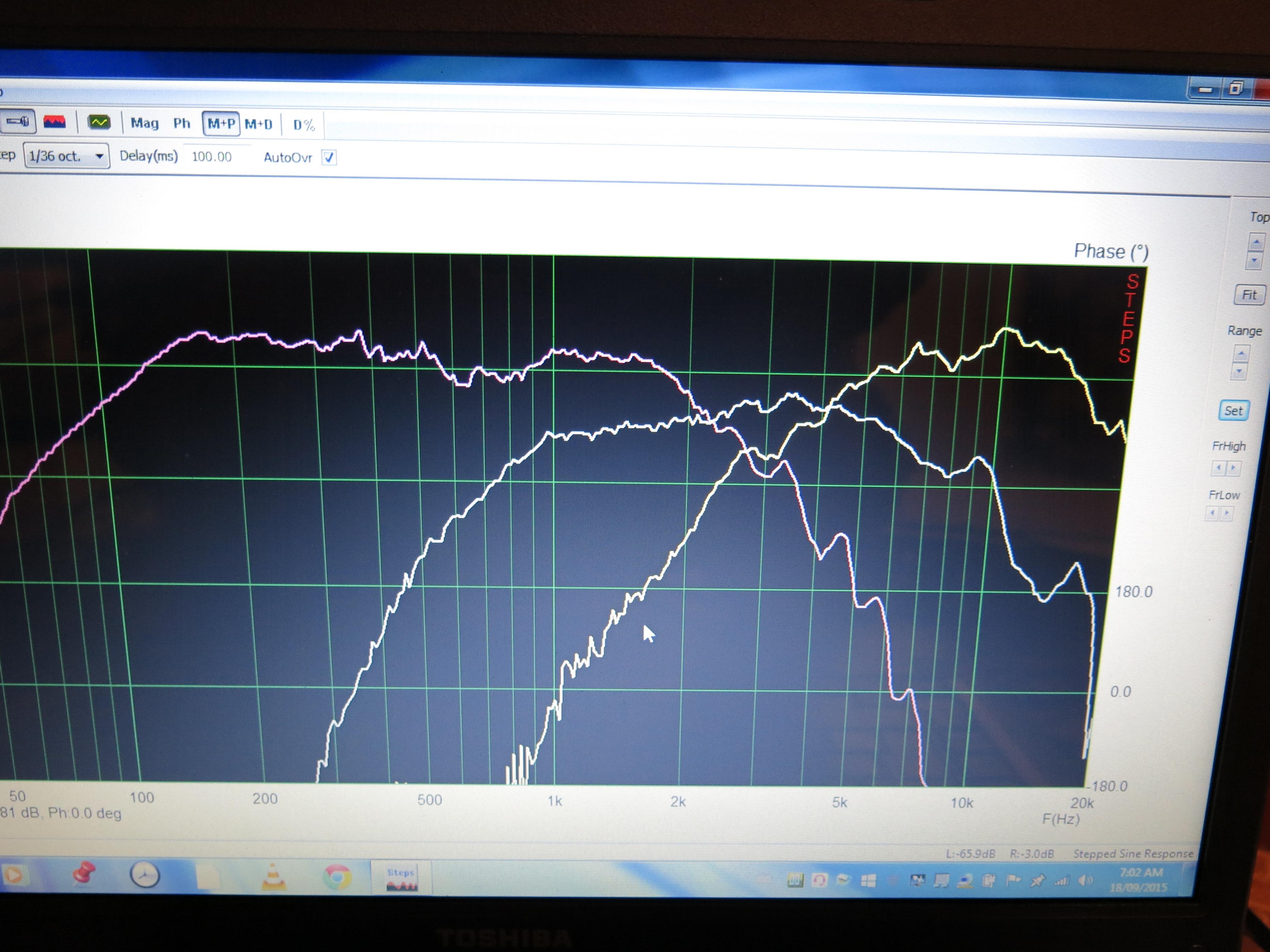

OK, the tweeter to midrange looks the same. How did the midrange to midwoofer crossover point move to 2300Hz?
Let's check our driver solder joints.
Let's take our emery cloth and re sand all our crossover copper (except of course those ends soldered together). It's hard to believe 2 weeks after sanding and cleaning the copper inductors, that copper oxide could make this big a difference.
Time to move forward.
Everything checked.
I'm going to chalk this up to drivers breaking in????
Tonight's measurement posted.
Time to start varying the capacitors.
We now know the 150uF cap which feeds the mid woofer should be closer to 100uF.

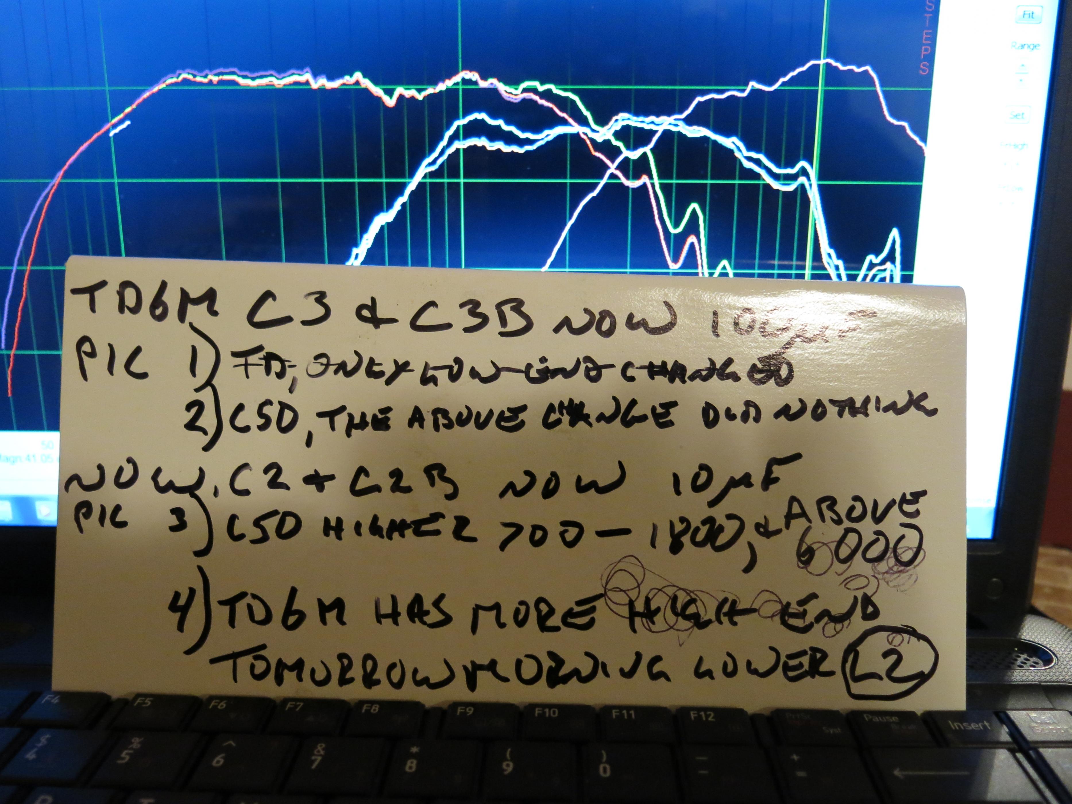

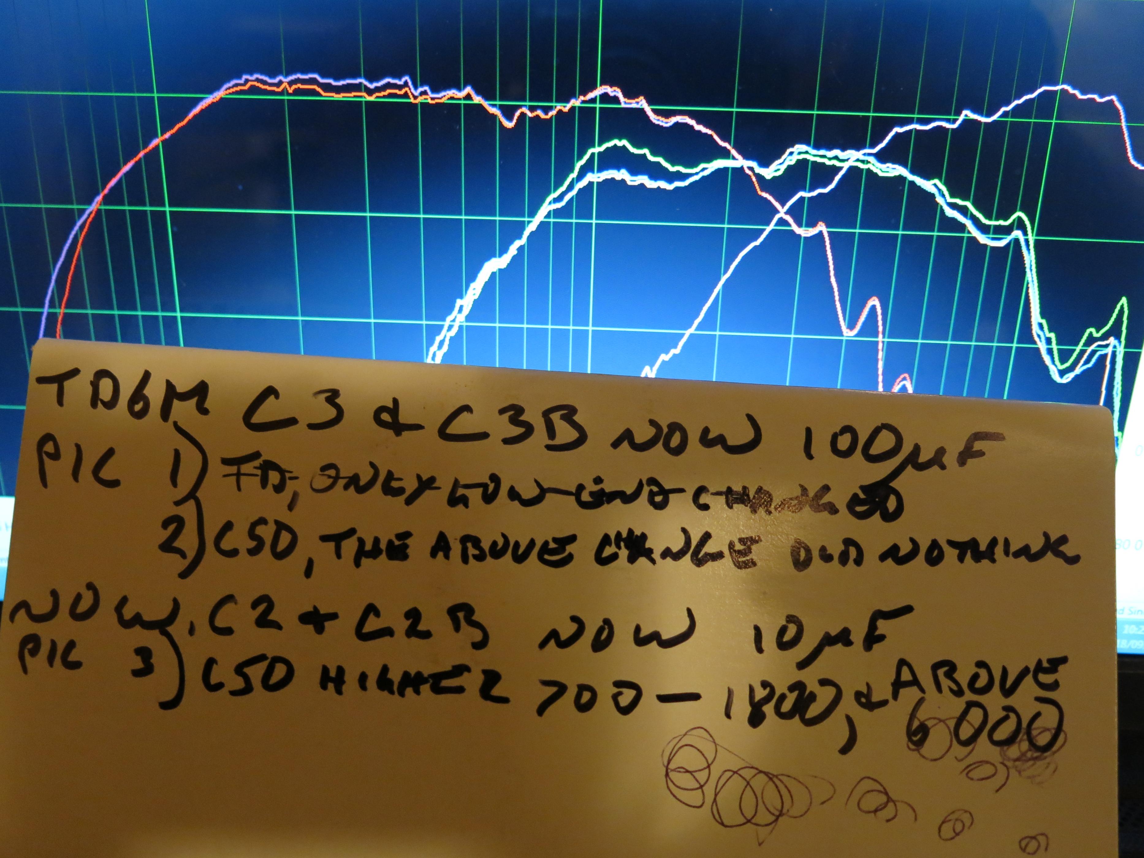

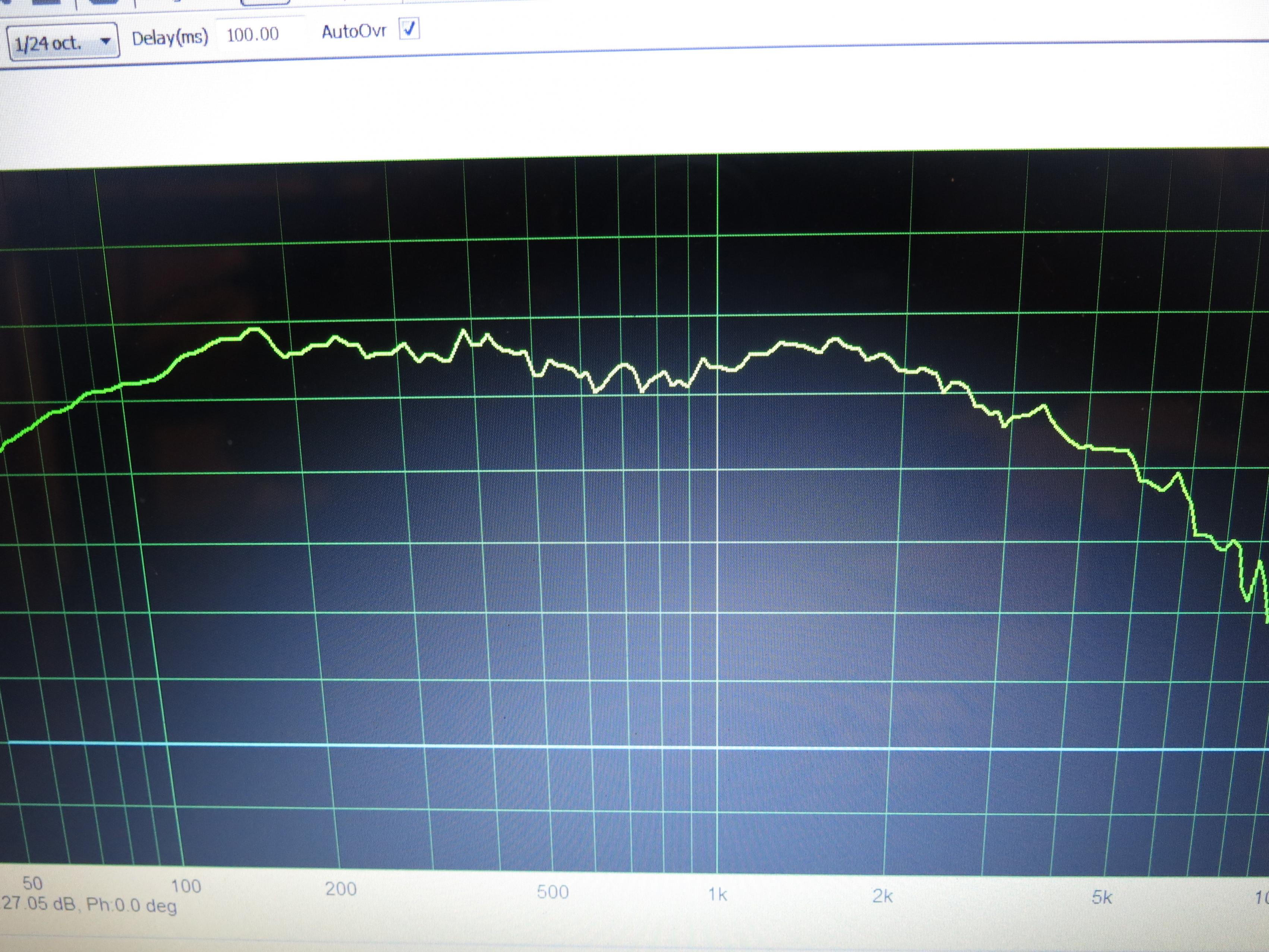

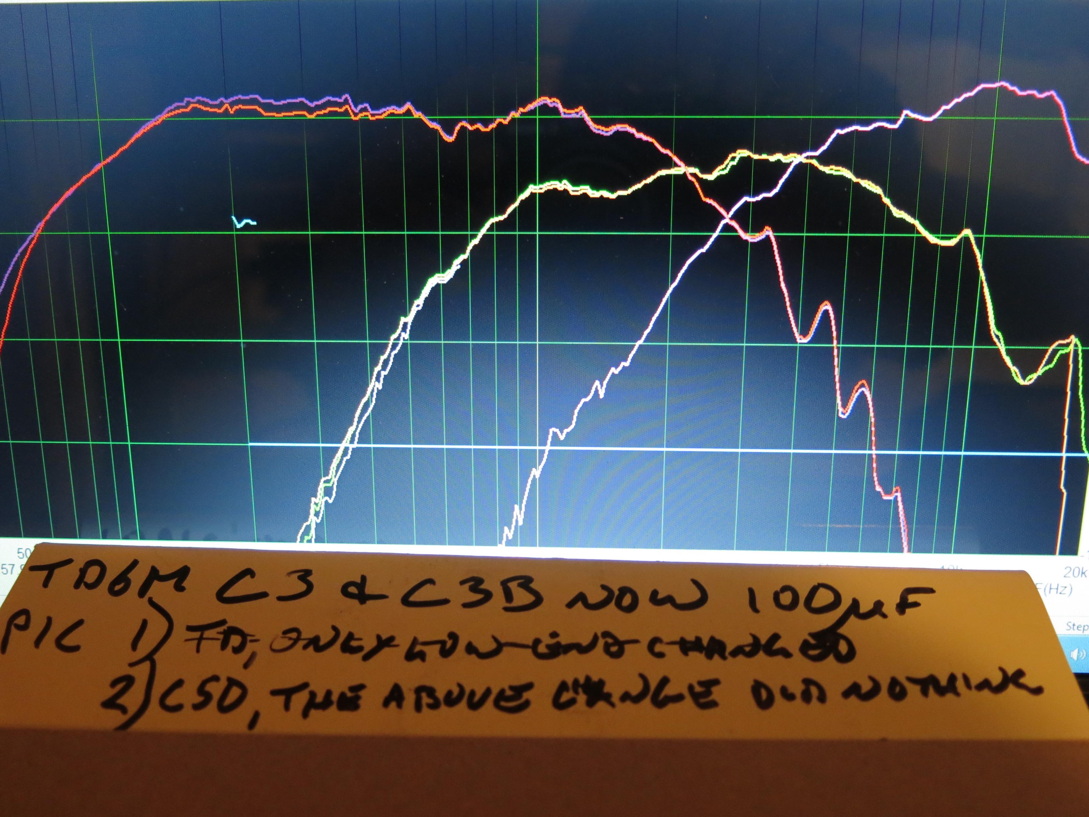

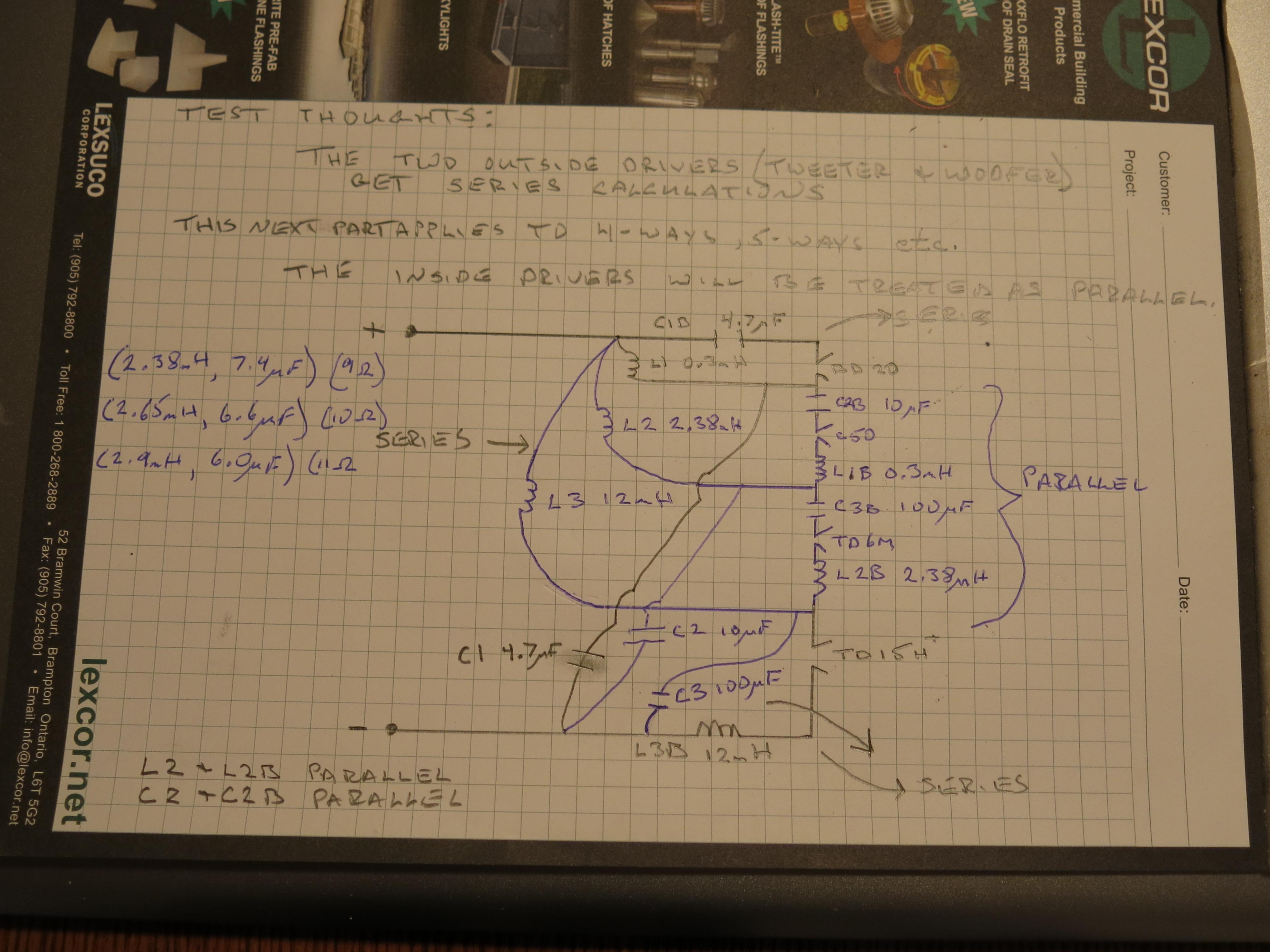

It's time to start optimizing the capacitors.
The first change is C3, and C3B. These are the caps that feed the TD6M Mid Woofer. We've been using 150uF, but we know 100uF is better.
Picture 1) The low end of the TD6M changed slightly, but no change elsewhere.
Picture 2) The C50 Midrange showed absolutely no change. I will postulate that the woofer would have changed. Should really finish the woofer box.
When designing a 2-way, every change of parts is dramatic. With this 4-way, parts changes only affects the adjacent driver. Capacitors affect the lower end of the driver (high pass), with inductors affecting the high end of the driver (low pass). A capacitor change will affect the driver below it, an inductor change will affect the driver above it.
Picture 3) We have now changed C2 and C2B from 17.7uF to 10uF. The C50 midrange has higher output from 700Hz to 1800Hz. There is also a slight rise above 6000Hz.
Picture 4) The mid woofer (TD6M) is the adjacent driver. There was a rise at it's upper end. We don't want this. Tomorrow morning I'll lower the inductor L2 and L2B.

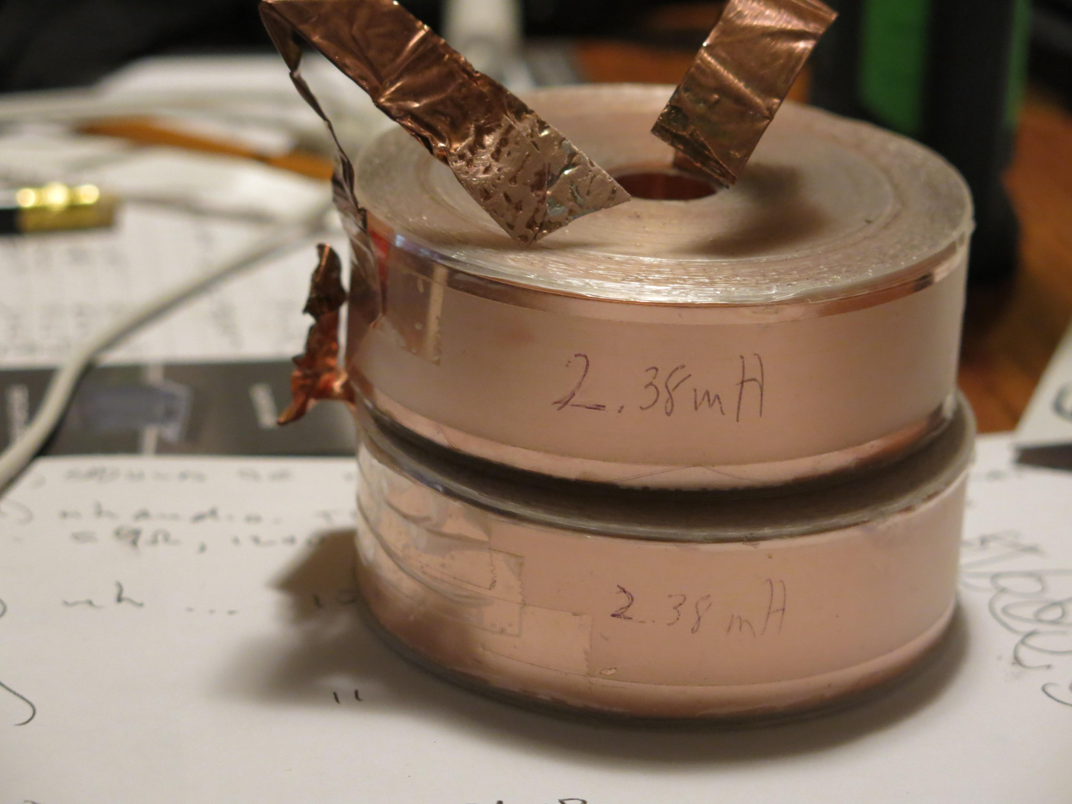

Hi Cousin Billy, Where did you learn this stuff? Most of your explanations on amp/driver workings in post 20 are incorrect, but I see that you have realised that already.
Many years ago I build a 4 way speaker with series filters. No Computers to do the simulations or the measuring. Only a few formulas, a calculator and an analogue volt meter. In its simplest form, the filter components are in series with one driver and parallel to another driver. Changing the value of one component will alter the frequency and phase response of two drivers.
Why are you sanding the inductors? The copper has a transparent coating.
Good morning Mark
Before I tell you about my dream last night, or more accurately, a final thought, let me answer your questions.
Post #20 was quite long.
You said "explanation of amp/driver workings is wrong". I am unsure which part was wrong?.
If my understanding of the amp/driver relationship is wrong, than my explanation simply helped me visualize the relationship.
You said "Many years ago I build a 4 way speaker with series filters. No Computers to do the simulations or the measuring. Only a few formulas, a calculator and an analogue volt meter. In its simplest form, the filter components are in series with one driver and parallel to another driver. Changing the value of one component will alter the frequency and phase response of two drivers."
This statement by you will be talked about in the next post. Your use of both words, series and parallel will be expanded upon, and tested.
An inductor starts as a very long piece of wire. It is then wound around and around. Any part which comes in contact with another part is coated, or a piece of something is placed between them (thin plastic, wax paper, etc.). Now we come to the two ends. These ends are outside the 'inductance producing portion' of the inductor. If a coating was used, then no voltage or current can escape. This coating (visualize magnet wire or Litz wire,) needs to be removed. If it's not, it won't allow anything to pass. You need to clean off the coating to use the inductor. In the case of my copper foil air core inductors, there is no coating. However, copper oxide does not conduct electricity. We need to occasionally sand off this 'rust'. You should ALWAYS cleans all your ends before soldering.
A capacitor starts out as TWO long pieces of wire. The end going in one side, ends inside the capacitor, and is attached to nothing. The other wire starts just inside the sealed end, is wrapped with the other wire, and it's end is what comes out the other side. I think????

Picture 1) It's been a while since we saw our final crossover topology.
Picture 2) For a parallel crossover, mhaudio tells us we need to use an inductor, L2, of 2.38mH (I just happen to have a couple of those?). We know the Accuton C50 is around 8.5 ohms. In the mhaudio resistance box I put 9 ohms. This assumes the TD6M is 9.5 ohms at 1200Hz. The next few pictures simply raise the resistance so we can check other stuff.
Picture 3) Averaged resistance now 10 ohms
Picture 4) Averaged resistance now 11 ohms.
Picture 5) Mark, this is for you. If you look at the ends of the inductor, the left side is really shiny. This is what your inductors need to look like before soldering. The first time you solder to a freshly sanded copper surface, you will be amazed how the solder flux truly draws the solder into the metal. I NEVER use the inductor manufacturers tinned ends. Cut it away, sand a new surface.
Time for breakfast, then testing my theory.

That was a long day of testing. I think I'm punch drunk.
Caveat 1. I finally removed my second 12mH inductor from an old project. You'll see the lower end (150Hz area) of the TD6M mid woofer a little different. There is also slightly more energy from there up. Until I finish the woofer box, I'm not going to worry about it.
Caveat 2. These are near field measurements, 3" microphone distance. In the back of our minds we need to remember the Baffle Step. Baffle loss'. Another fun part will be when I start testing different baffle angles to maximize acoustic centers.
Picture 1) I jotted a few thoughts on paper. Some of the values have been changed. They reflect our belief the center drivers need to be treated as parallel drivers, not series. This belief is for 4-way and higher speakers. I have to think about this before I can comment on 3-ways.
Picture 2) The mid woofers inductors are now 2.38mH (assuming we treat it like a parallel driver). We've left C2 and C2B at 10uF. The picture shows the bump at and above 1000Hz is getting better. This might indicate that 'parallel' crossover calculations might be the way to go.
Picture 3) This is the output from the midrange with the mid woofer inductor change. There is a fair bit more energy above 1500Hz. I think I like this.
Picture 4) This is the tweeter measurement. There is a slight change. This perplexes me. May I chalk it up to gremlins?
We are now going to change the midranges capacitors. We're going from 10uF to 6.8uF. If you look at my first picture today, you'll see I should be trying a 7.4uF cap. I don't have one, so 6.8uF it is.
Picture 5) This is again the tweeter. The less moving of the microphone I do the more accurate some traces will be. The tweeter now cross' in the 3800Hz area. The tweeter now has a bit too much output. I don't think I like this value.
Picture 6) The midrange with 6.8uF. Nope.
Let's change that same cap to 8.2uF
Picture 7) This trace for the midrange looks good. Let's leave it.
