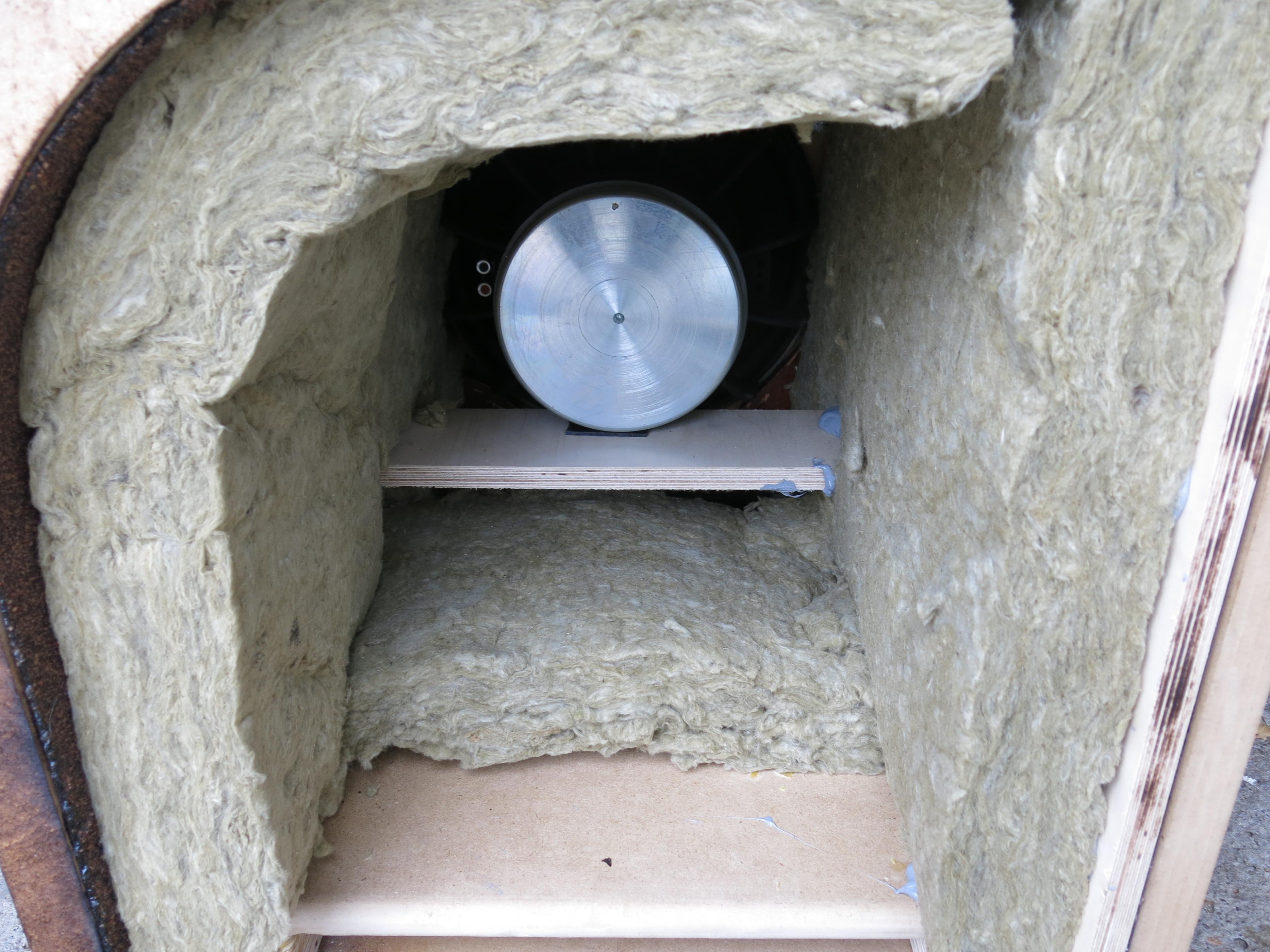

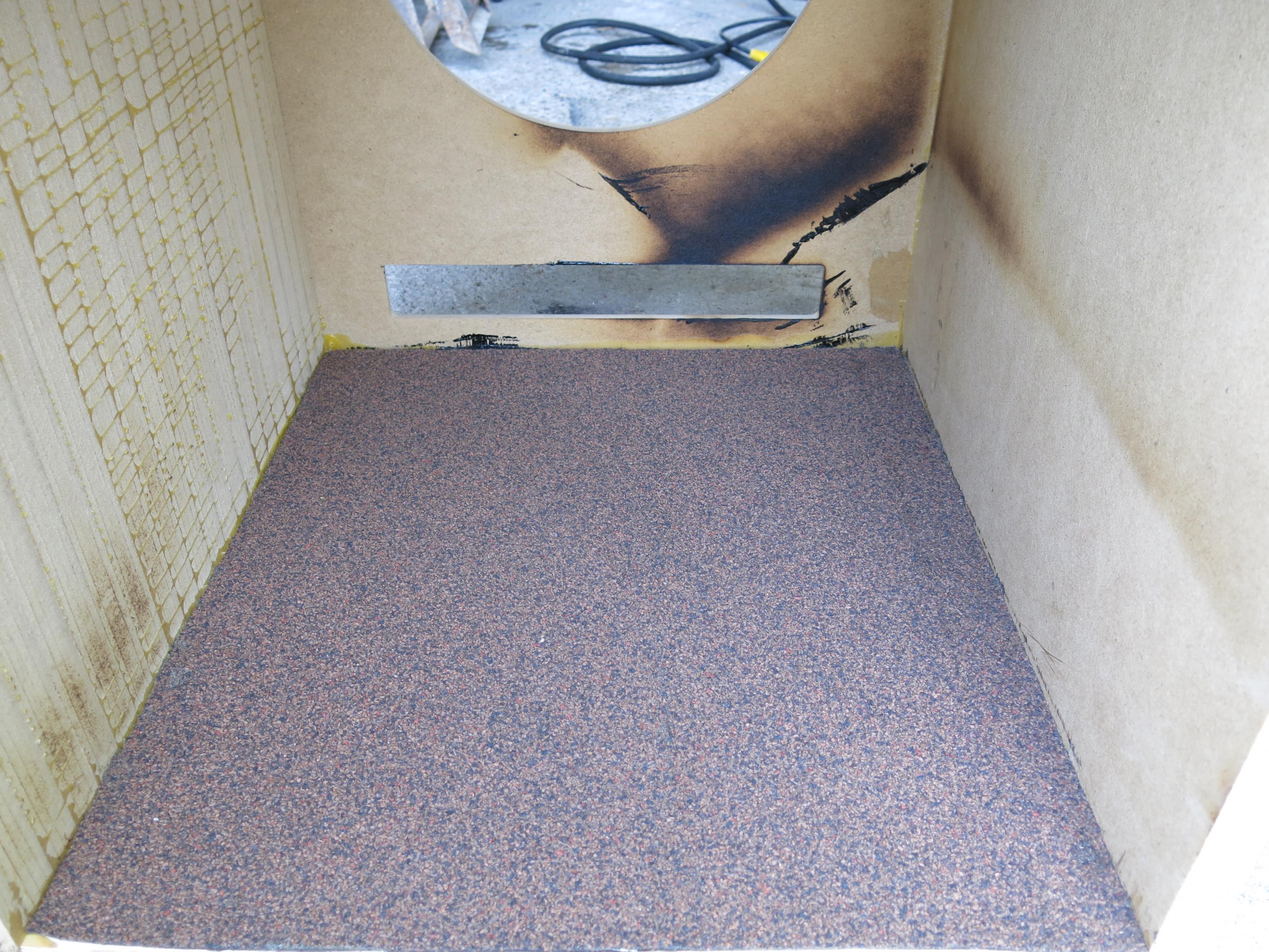

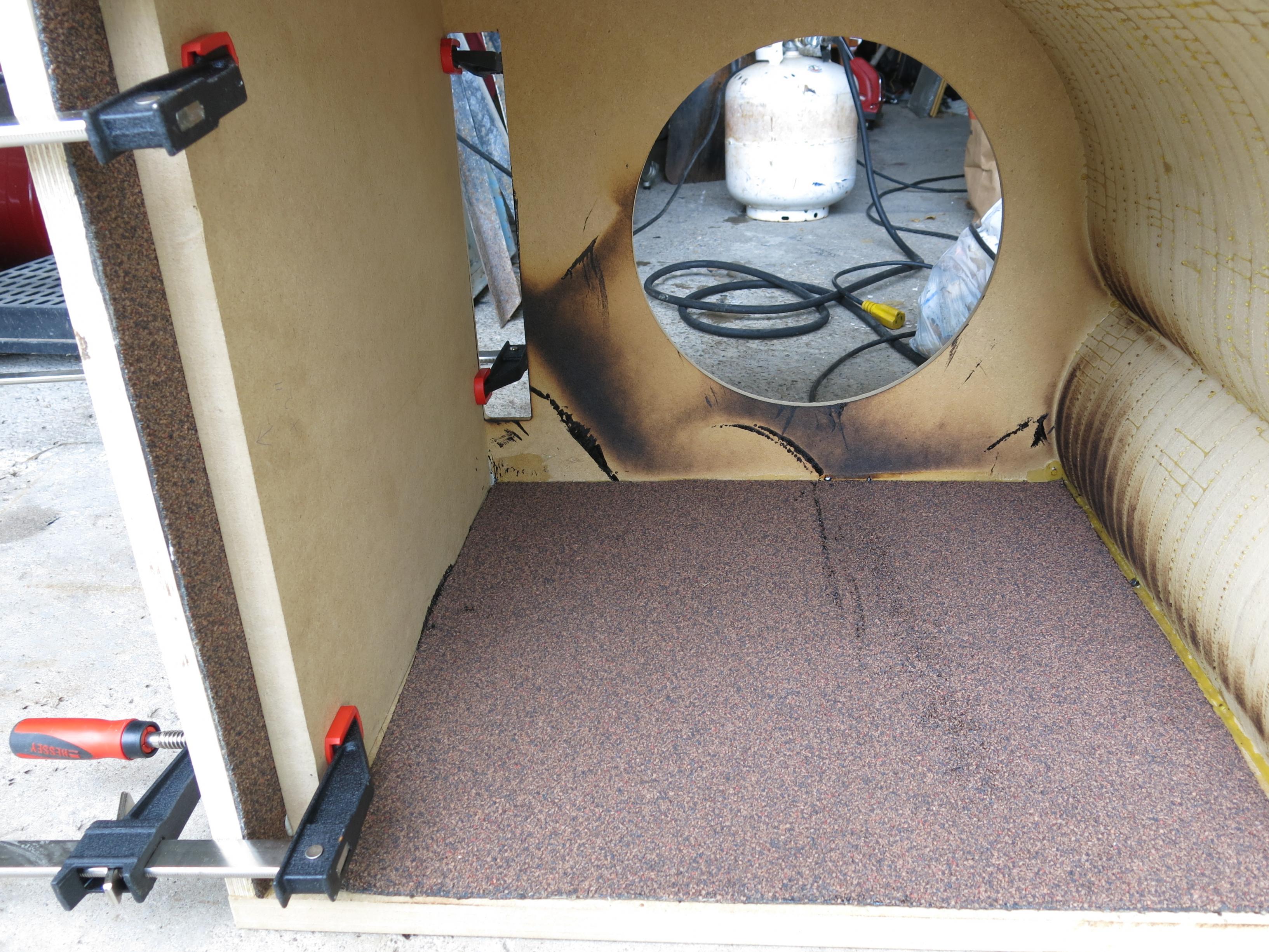

My woofer test box is finished.

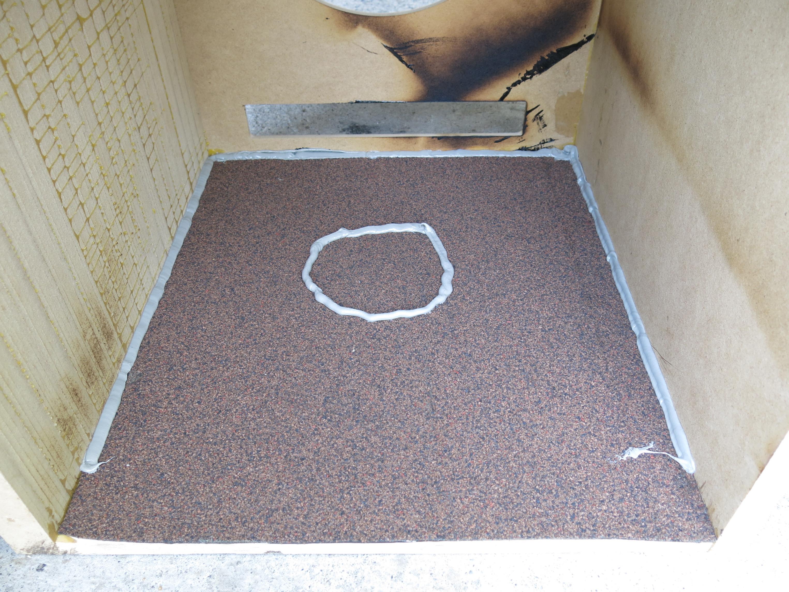

Pic. 1) The side curved wall is 1 1/2" MDF. The bottom plate is 3/4" Baltic Birch Ply (it'll grab the spikes better than MDF). The large side is MDF. The front baffle is MDF. In roofing we use SBS. This is a synthetic rubber. I'm torching it to the inner walls (dampening the walls).
Pic. 2) I'll use Dymonic caulking to hold the next piece of MDF in place. The donut caulk is to stop the MDF from slapping the SBS.
Pic. 3) I turned the cabinet on it's side, torched down the next piece, and clamped the MDF against the caulking.
Pic. 4) Installed Baltic Birch over the SBS to the large MDF face. Installed the slot port. Torched SBS to the curved side. Installed Roxul Safe and Sound insulation.
Screwed the back wall into place (closed cell foam in the gap).

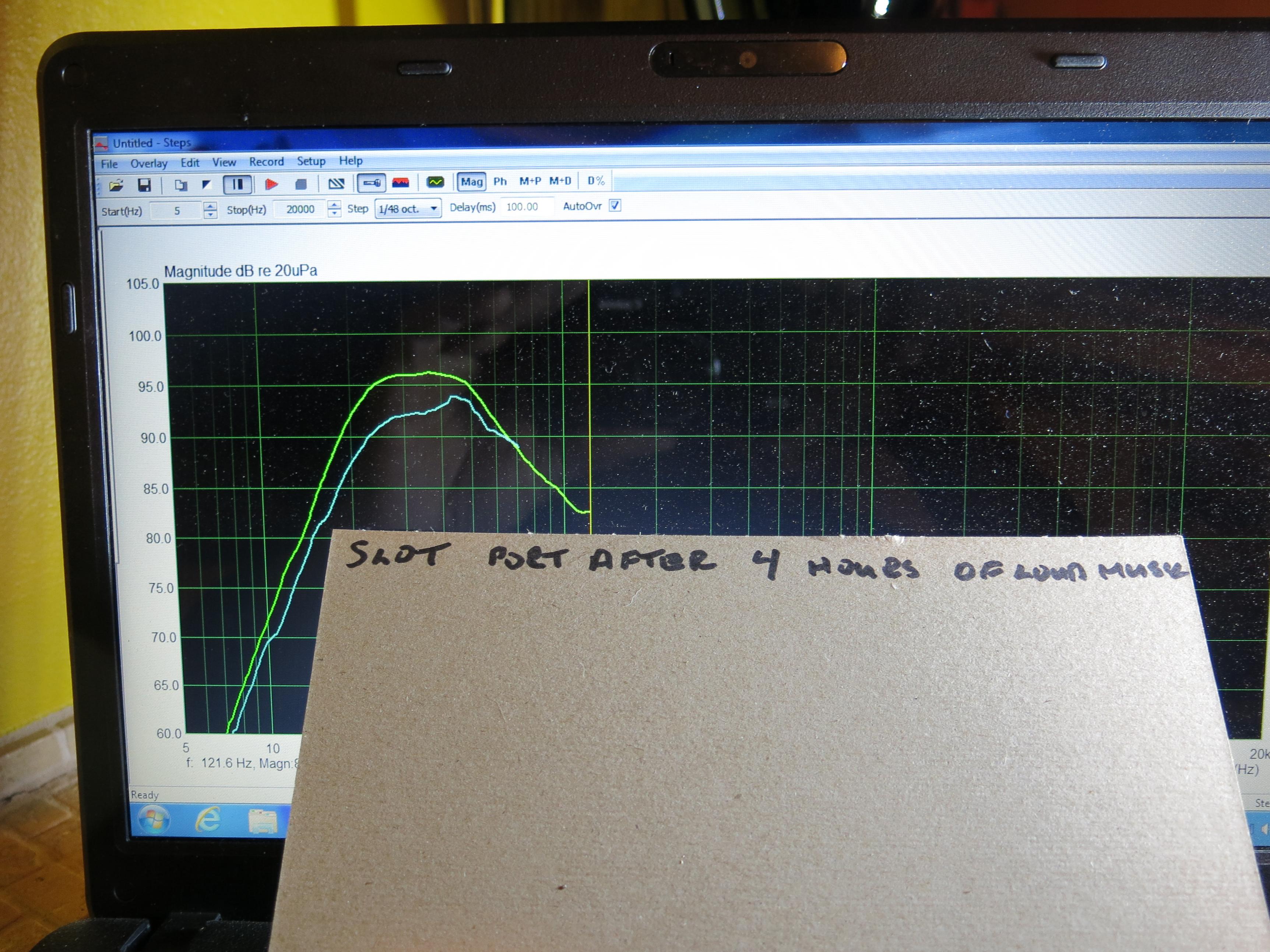

I can tell you the port tuning showed 35Hz. This is obviously wrong. I thought it might be the Roxul, so I removed it. No change. I think the woofer needs some time to loosen up. Time to listen to music.

I measured the slot port output with the brand new woofer. ???
After 4 hours of music (2 days), I measured again. Much better.

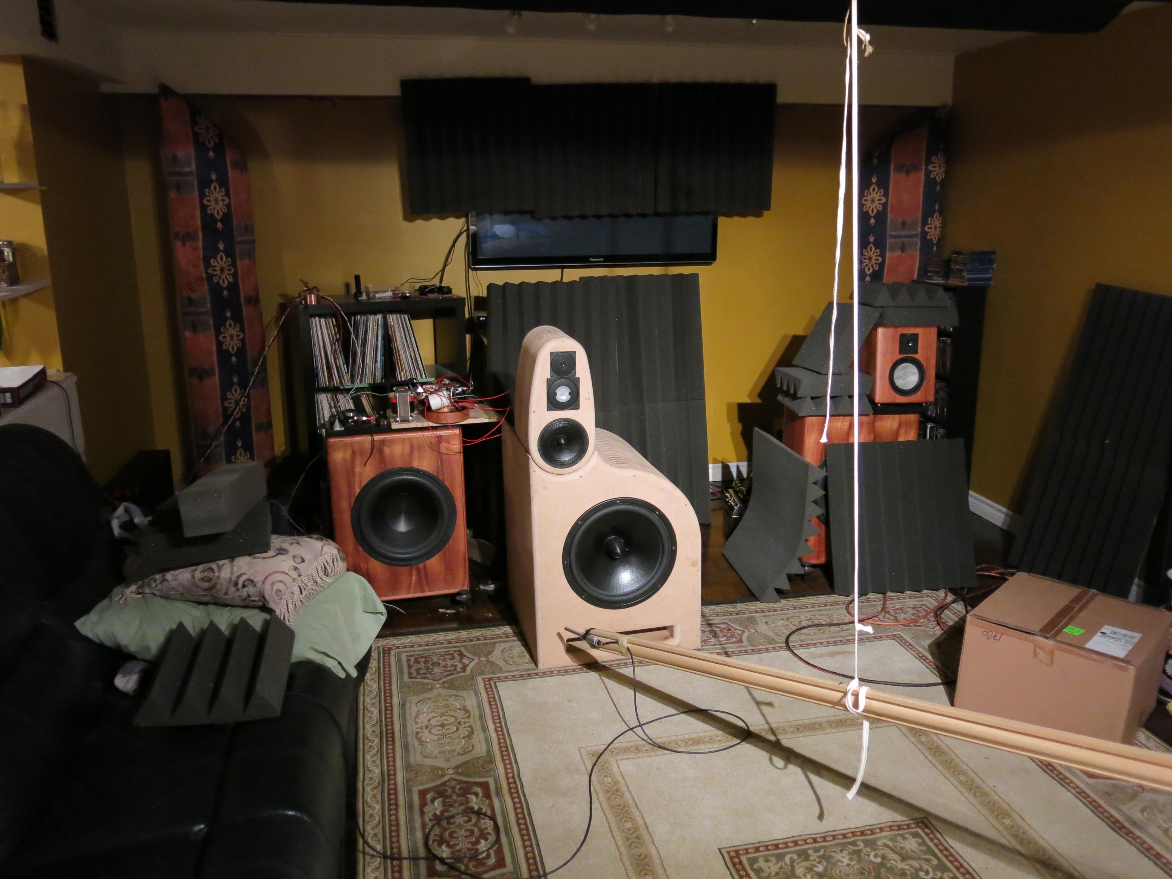

Hello Jonasz
Long story made short ish.

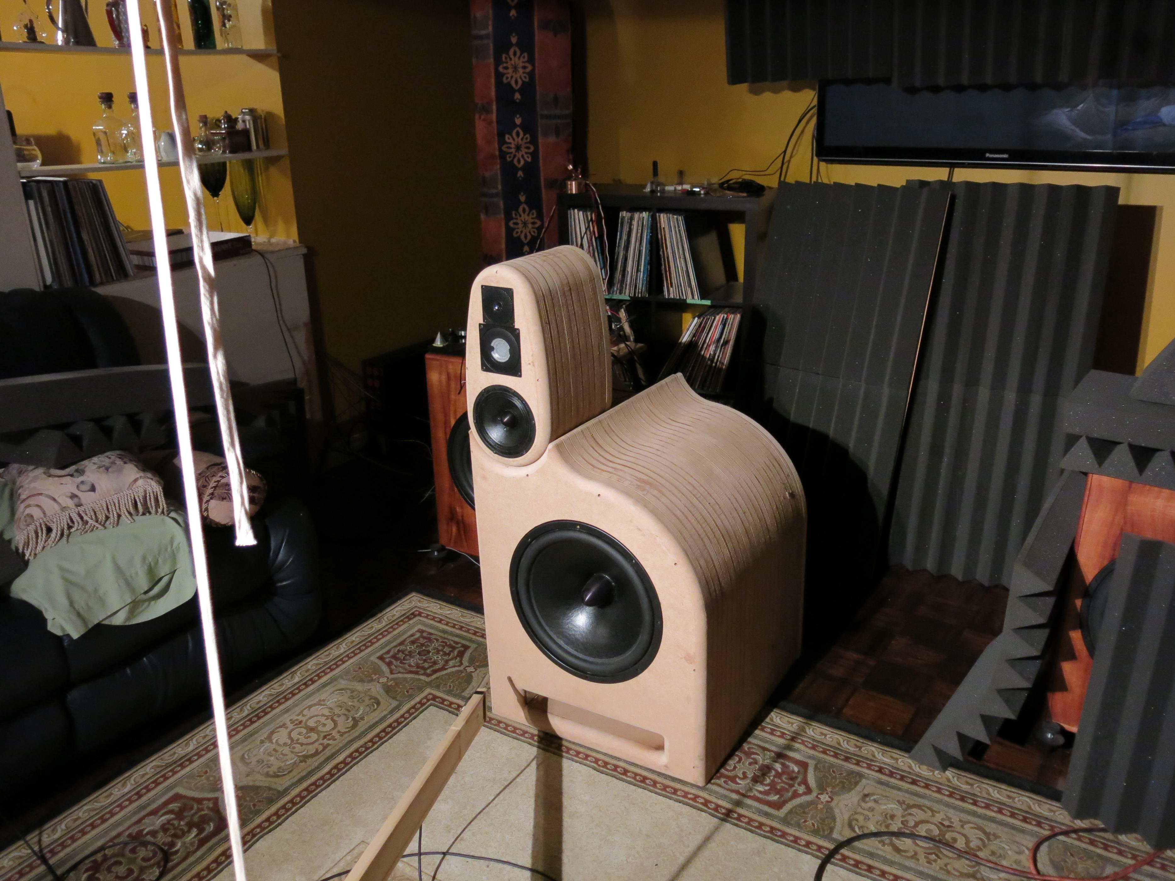

The base is out of this world. The AE TD15H+ is ripping the MDF test box apart.
My CNC guy, whose name is Guy, should have the 100+ pieces ready by next week. This time I will build both speakers.
The final speaker will be made from 24mm Baltic Birch Ply.

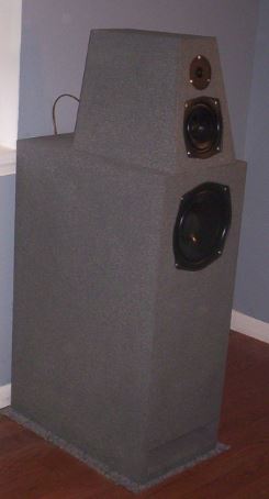

I have almost the same drivers as you laying around, although it's the TD15X and a couple different tweeters. Interesting to see what you come up with. Haven't even decided if I'm going active or passive yet or if I indeed need the C50 in the mix, guess that depends on wich tweeter I decide to use. 🙂
Jonasz, the TD15X is perfect.
It's designed to be ported, so a slot port would be my recommendation. Model your tuning below the Fs (Helmholtz I believe is the name. It sums in phase).
It's mid 90's in efficiency. The -3dB baffle loss means it will mate well with a 90-91dB mid range. A great filler for a 4-way is obviously the TD6M, but I'm also looking at some of the PHL Audio 6 inchers.
The Accuton C50 is discontinued. The C51 is around 93dB. This might require resistors.

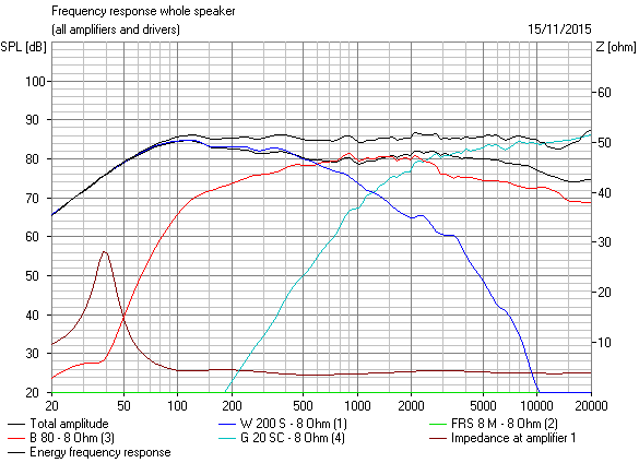

opinions
Lets here everybodys opinions on what you think would be the best mid and tweeter combo. Give your opinions.
The Fully Balanced Dual Cascade Paralleled Series 4-way
crossover is the greatest crossover in human history.
Sadly your very technically deluded. It is very boring.
rgds, sreten.
I think the mid has to be a very capable and well behaved driver. Perhaps a fullranger.
B 80 - 8 Ohm

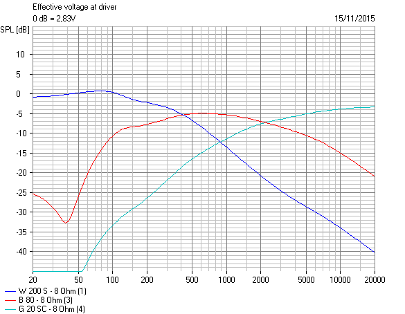

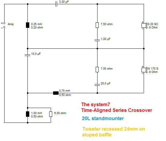

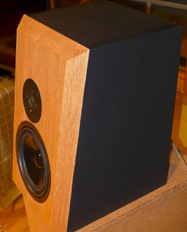

Cousin Billy is actually onto something here, despite sreten's misgivings. He's reinvented Bud Fried's ideas. Bud Fried was a great fan of damped transmission lines and employed series filters on occasion, though not exclusively. Bud used KEF bextrene drivers like B200, B110 and T27 quite often.
First I'll give you the history lesson. Then some sims with modern drivers. It's a remarkable circuit with very flat impedance, which works with a lot of stuff just by adjusting the resistors. You can put a capacitor in the tweeter section without much change beyond steeper rolloff. It gets better when you add impedance correction and some LC values are not written in stone, but that's for another day. 🙂
I've never heard this speaker, but it is certainly interesting. I would guess driver selection is critical.

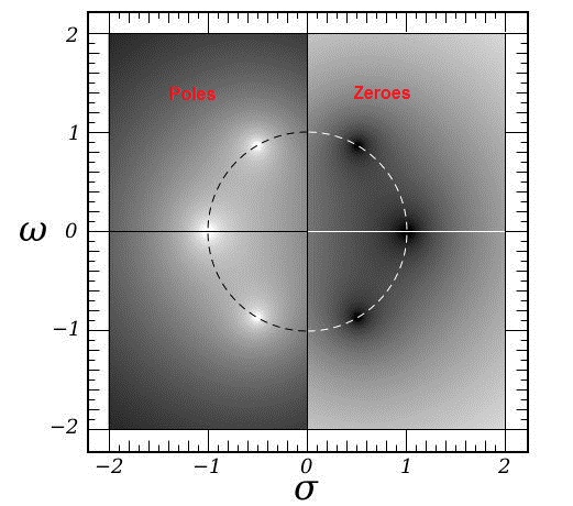

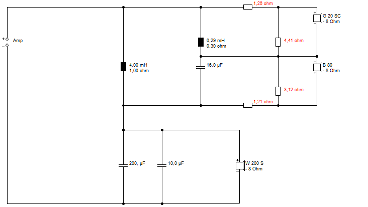

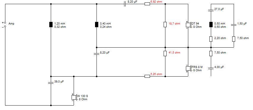

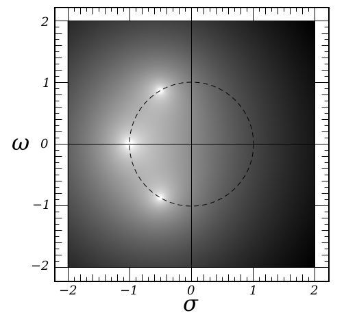

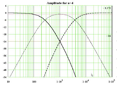

I haven't run the sim for the 4 way version of this speaker yet. But I CAN give you the mathematical justification for it. It's the sort of thing John Kreskovsky and myself find interesting.
1) 3 ways can be based on simple transfer functions like 1 - 2s + s^2 / 1 + 2s + s^2.
2) 4 ways might employ 1 - 3s + 3s^2 -s^3 / 1 + 3s + 3s^2 +s^3.
This in mathematics is function of a complex variable s representing jw or frequency. Bud Fried's ideas are based on the first function. Cousin Billy is doing something with the second.
To see the power of these ideas, look at the Steen Duelund classic 3 way filter below.
The next two images are my own take on a time-aligned two way.
The last two have a resemblance and relation to what Cousin Billy is doing in the powerful pole zero representation. Just enjoy the symmettry at this point, but be assured that those images can represent a 4 way speaker. 😎

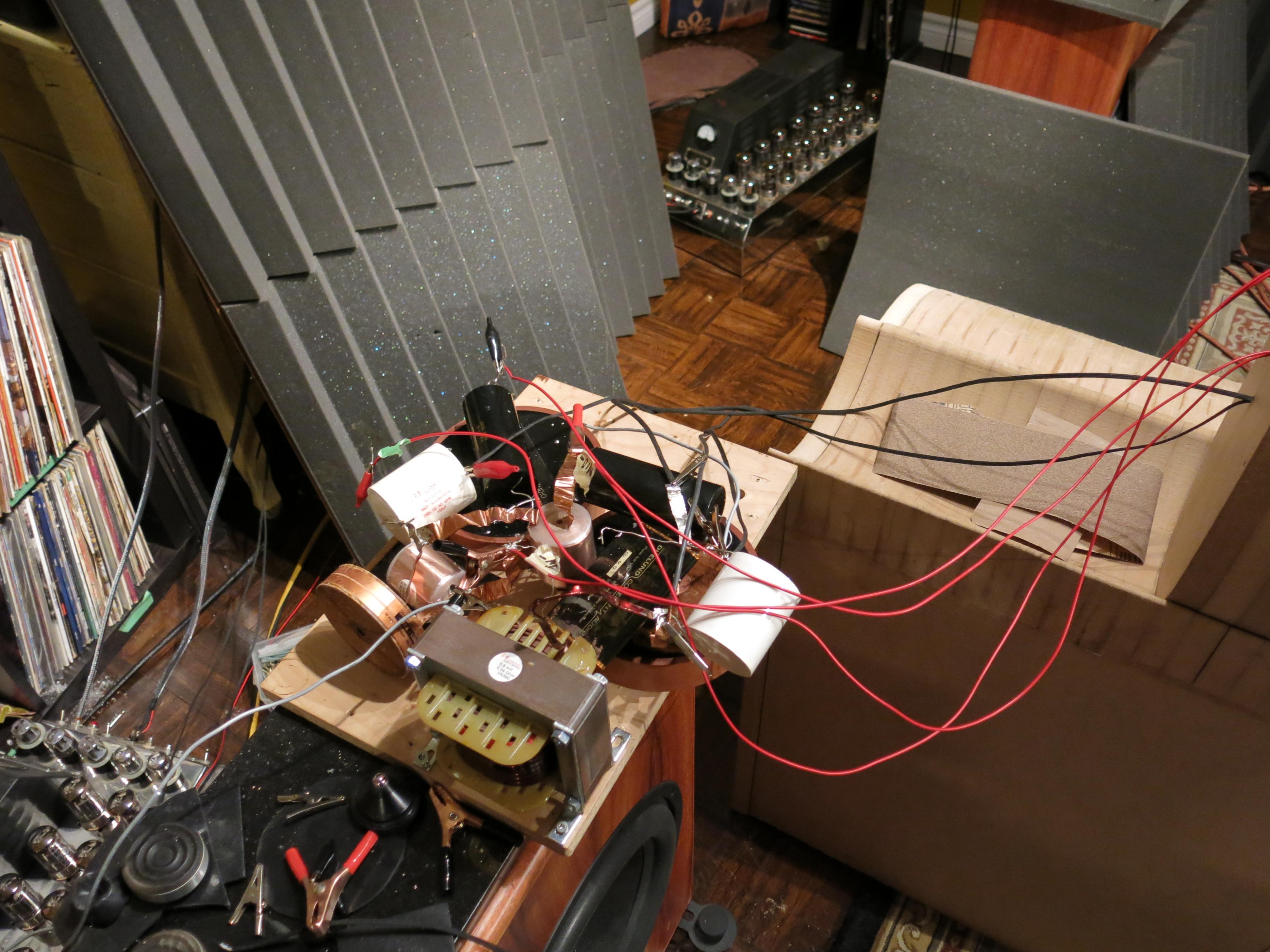

When I was testing my tweeter/midrange 'alignment' output, I used Jeff Bagley's trick. I positioned my microphone a few inches in front of the drivers. I then started 'lifting' the front of my baffle. The back of the cabinet remained stationary. I did lift the microphone by the same amount each time. This started to cause a 'perceived' slanting of the baffle. The tweeter was getting further away.
I lifted the front in 1/4" increments. I made it to 3" (that's a lot of tests). The peaks and valleys changed position, but their amplitude remained the same.
I then had a thought, what would happen if I slanted the baffle 'forward'. I returned the front of the baffle to flat, and started to raise the back.
Bingo. At the 1/2" mark the amplitude of the peaks and valleys was cut in half.
I will postulate my crossover causes the tweeter signal to 'lag' the midrange signal. Positioning the tweeter in front of the midrange brings things together.
Did I do that correctly?

It's hard for me to answer that without a lot more work.
I always find time-alignment is critical with shallow series filters. Having said that, there are some tricks to employ with flipping polarity and you sometimes get lucky with shallow mids which are nearly time aligned anyway.
You MAY find that polarity alternatively flips on each of the 4 drivers. IDK.
What often helps is impedance correction. In the below example, I had good success correcting the Fs resonance and rising inductance of the tweeter and mid. Those correction circuits may be wired in simply.
Bear in mind that my own interest is mainly mathematical.
- 4-Way Series Crossover. Accuton and Acoustic Elegance Drivers
