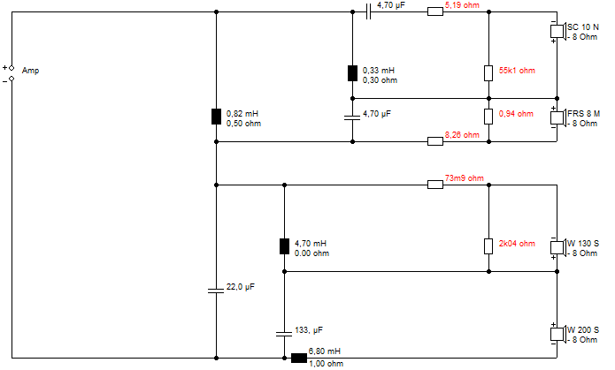

Next question, and this one is weird.
First I will try to explain what happened.
The very very very first time I hooked up my woofer to the circuit, it produced a loud 'thud'. I was perplexed. I disconnected it, reconnected, and nothing. No thud.
I then hooked up my mid woofer, a gentler thud. Disconnect, reconnect, no thud.
The same for the midrange, and a mild pop from the tweeter.
This happened for all 8 drivers. But only once.
Being mathematically inclined, could you do me a favor?
Is my circuit a pseudo de-gauss'r?
Could it be a combination of air core inductors connected to feron 'cored' inductors?.
This is way beyond my abilities to figure out.
Hoping you can shed some light on this.

I'm not sure I quite grasped what you are describing there, but in general it is incorrect to run a filter without the drivers connected. It can produce a very reactive and difficult undamped load to the amplifier.
Since most amps have a DC offset around 0.1V anyway, thuds and crackles would not surprise until the amp gets a chance to settle. A feedback amplifier is very "aware" of the load's impedance. It's how they work.
Gotta dash now, but will try to get a sim of your filter going in the next few days. I'll be watching the phase and time alignment with interest. My intuition tells me it's going to be something about 18dB/octave and 9dB/octave. But time will tell.

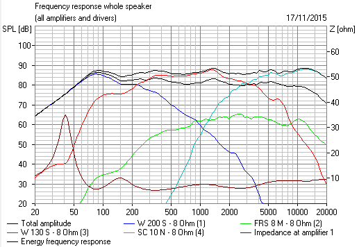

Shallow filters are not usually my bag, but some people swear by them. Vandersteen and IIRC, didn't Dali make a series filter with 5 drivers that looked like a Quad ESL with cone drivers? Can't remember, can't find the circuit. KEF did some series filters too, years ago. The mid got an LC parallel shunt IIRC. The bass and tweeter got regular second order series. Again I can't dig it up right now, but it used the old elliptical B139 Concerto bass.
The simming is a bit of a nightmare so far, because Boxsim Optimiser keeps trying to ditch the upper mid and make a regular Fried style shallow three way.
But it's looking quite good so far. 8" plus 5" plus efficient dome tweeter. More of a regular three way though. Phase is saying alternate polarity for sure. Early days, I haven't tried very hard with time alignment or impedance correction. 😱

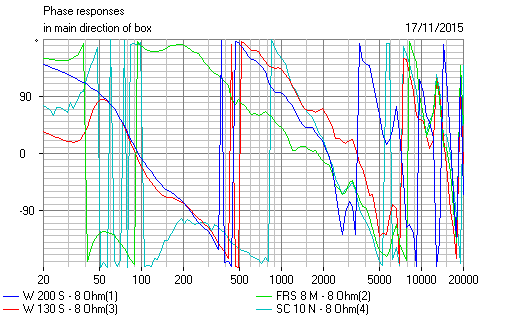

I mentioned the classic 3 way transfer function, which is 12dB/octave on bass and tweet and a 6dB slope on the mid in either direction. It can be either all pass or a phase network depending on polarity of the elements. s being jw, a complex variable. The three top terms are the three filters on a common denominator, here added up. They are, in effect LR2.
1 - 2s + s^2 / 1 + 2s + s^2
What the transient perfect speakers do is wire the bass and tweeter out of phase, then fill the alarming hole or null with the shallow mid. Interestingly the s terms each have a 90 degree phase change about them in the j term, which is the root of minus one. Or 180 degrees with s^2, you follow?
So the above filter has a 90 degree relation between each of the three driver's phase. This is not Linkwitz-Riley phase aligned at all.
This why Visaton Boxsim always messes them up, because its optimiser always tries for flat Frequency Response and flat phase. Which is not 90 degree butterworth at all. So you have to force it where you want it to go, and that can be done.

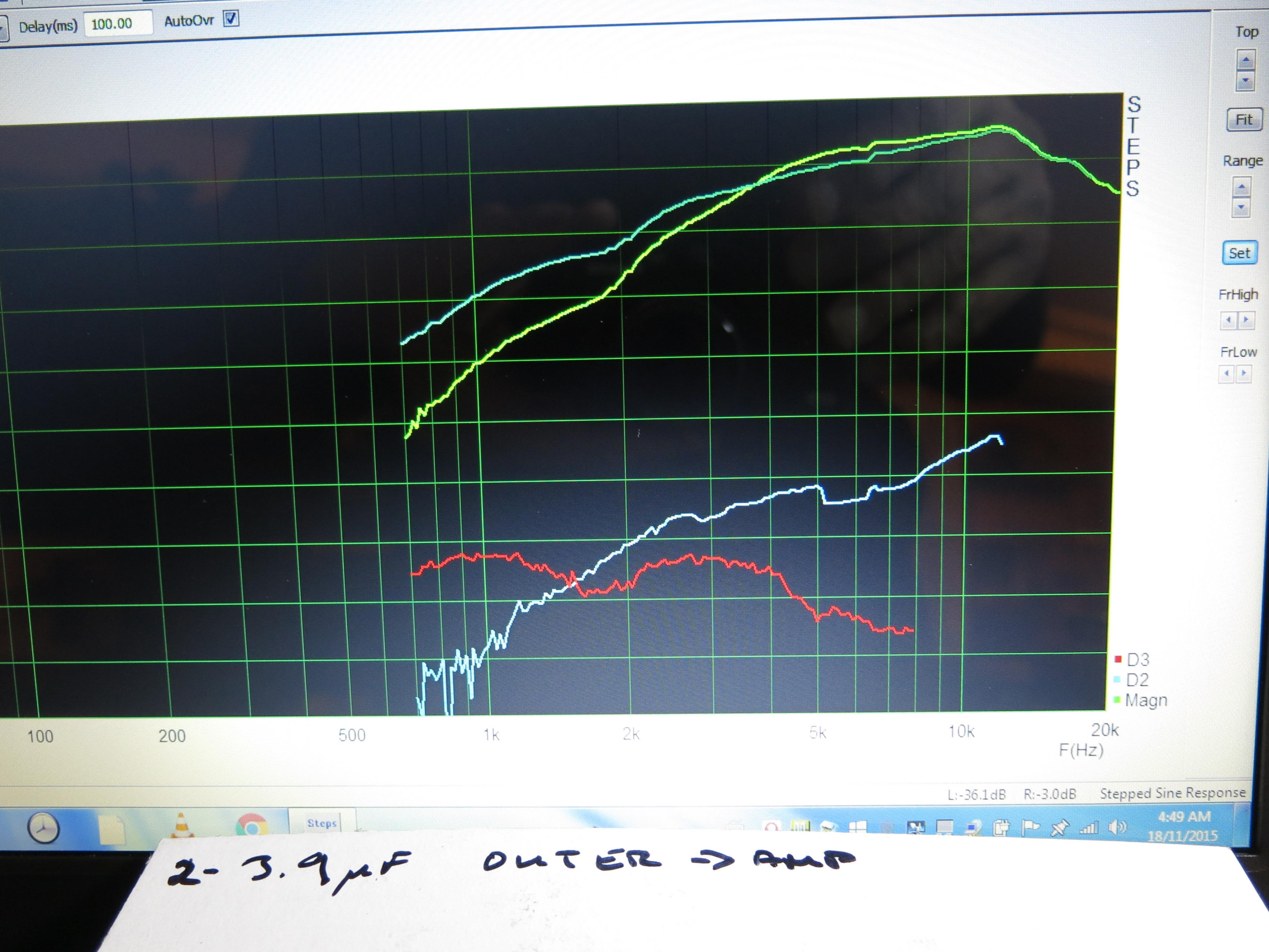

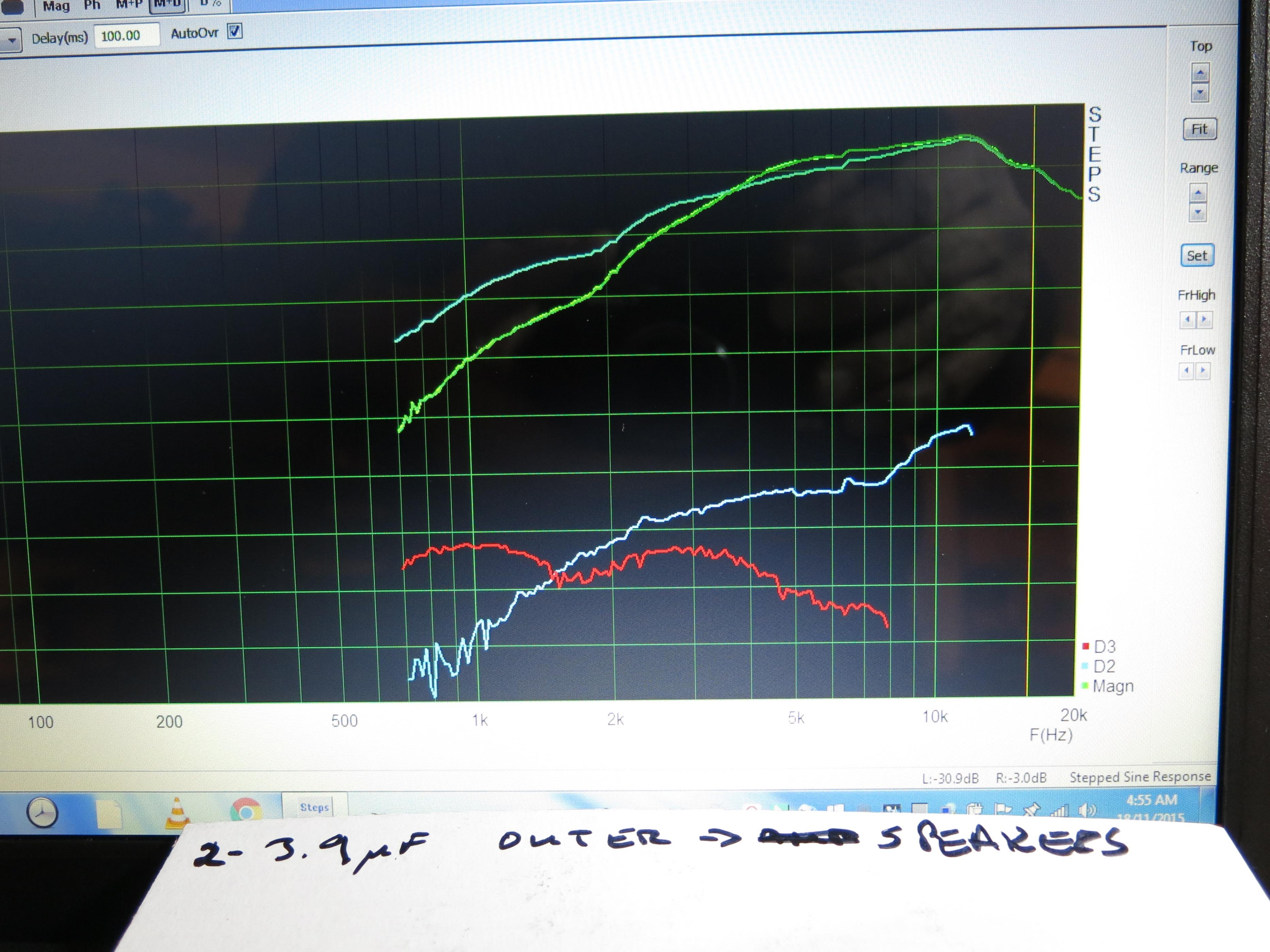

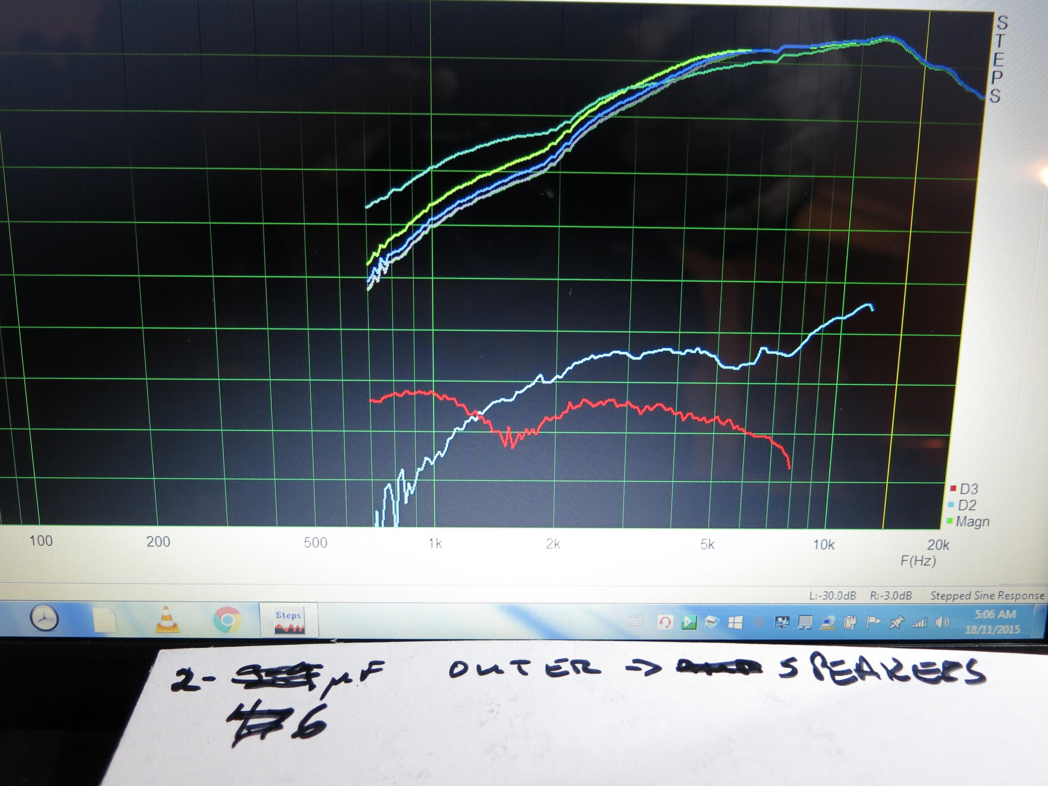

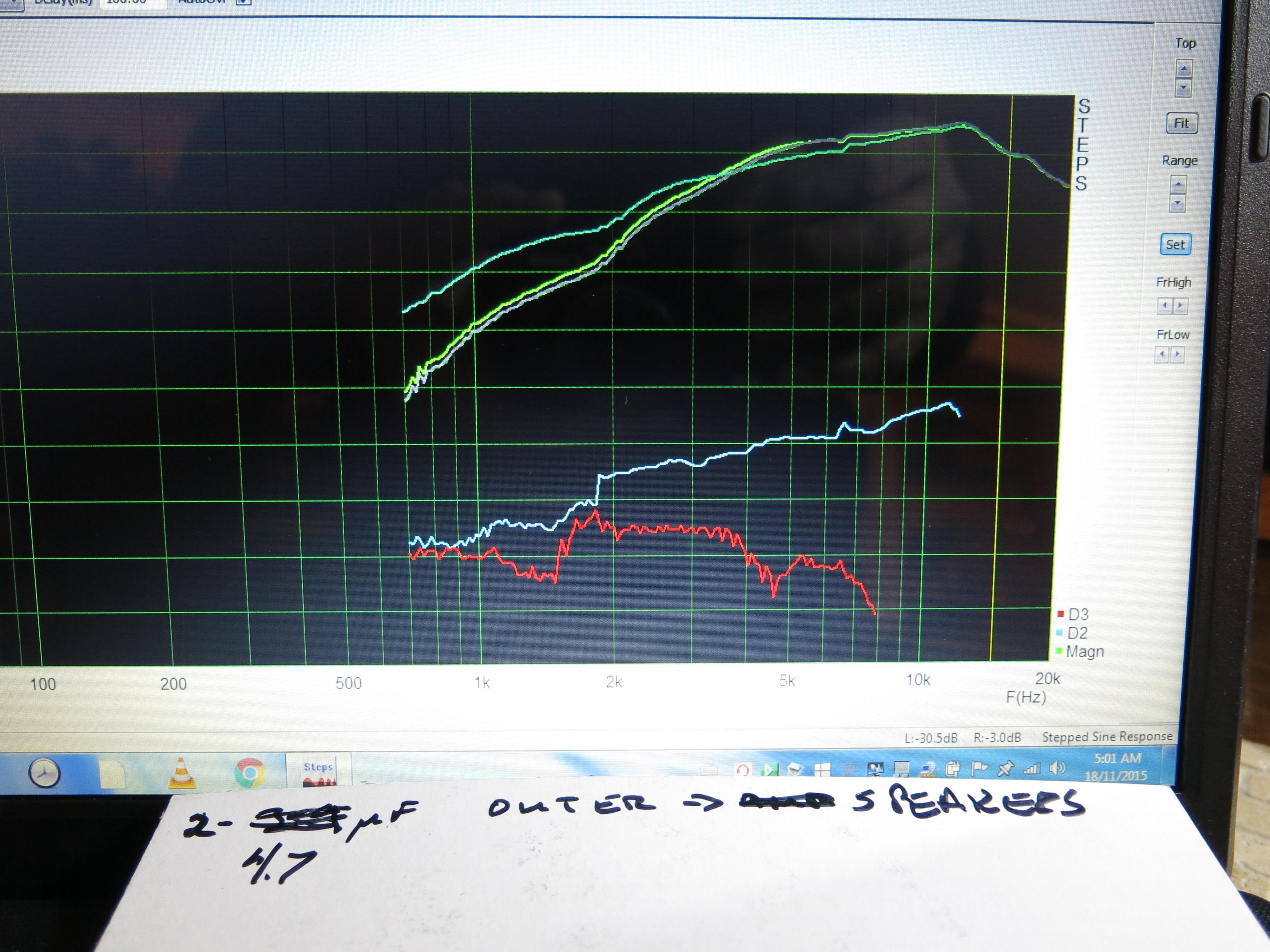

system7 made a comment, post #56.
He said "Your additional capacitor on the tweeter will help distortion too".
He may have meant the added slope is good for tweeters, but I'm going to look at the distortion across the entire frequency range. Measurements taken at the tweeter output. Near field (microphone 1" away, well below 1watt)
Let's test his theory.
Let's also see if the outer foil of the capacitor needs to point in a specific direction. (I have read this is important in preamplifiers and amplifiers, but is it important in crossovers?).
Let's see if lower than ideal values and / or higher than ideal values make a difference.

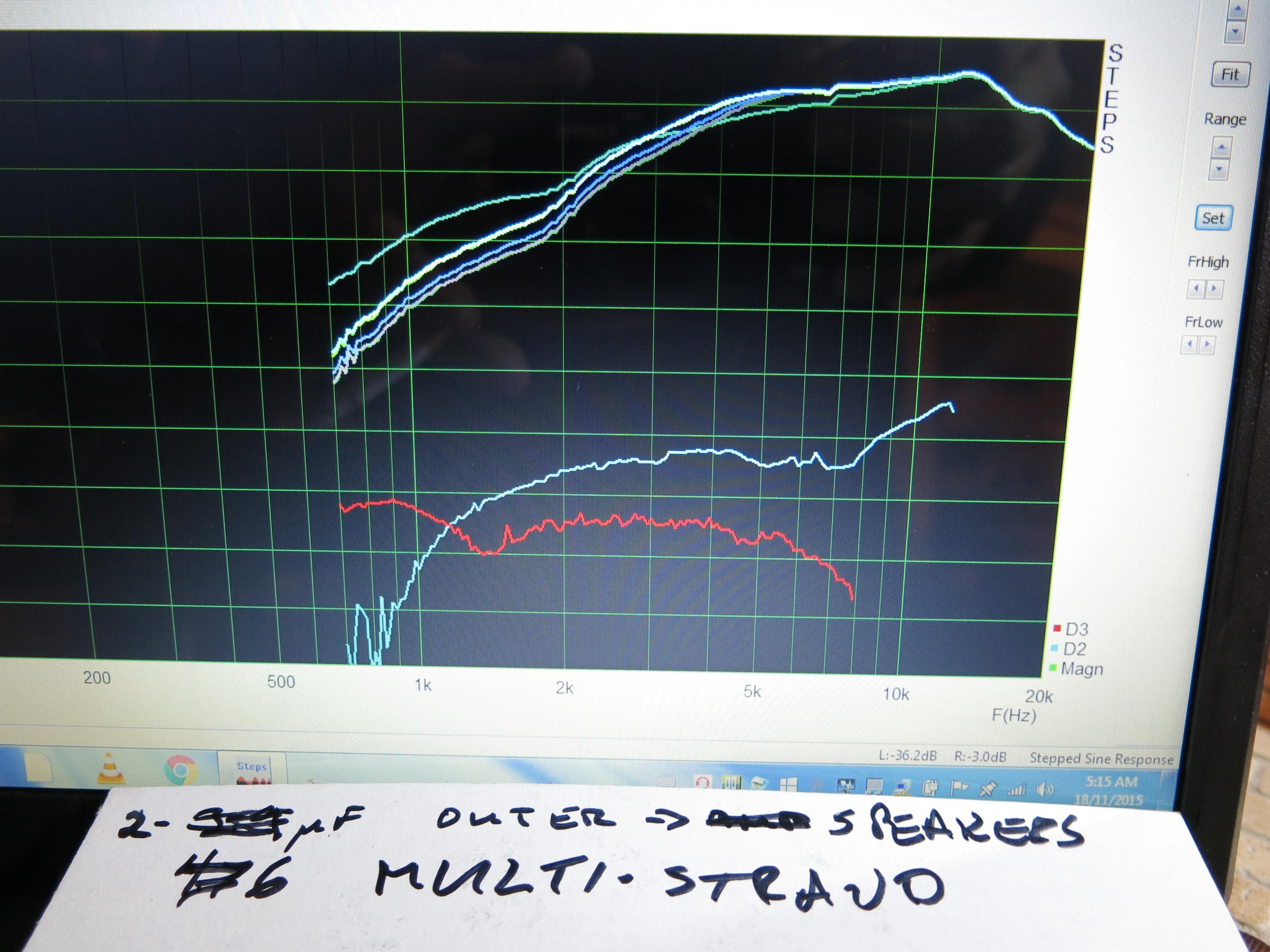

I'm not a fan of multi-strand wiring. Let's see if I can test this.
Time doesn't allow me to test if paralleling two smaller value caps together makes a difference. (again, pre and amplifiers don't like paralleled caps. Is it important in crossovers?). Maybe I'll test that tomorrow.
These measurements are for the tweeter only, with the tweeter caps being changed. Tomorrow I will test the midrange distortion, when changing the tweeter caps. I know it sounds weird, but rigor is necessary.

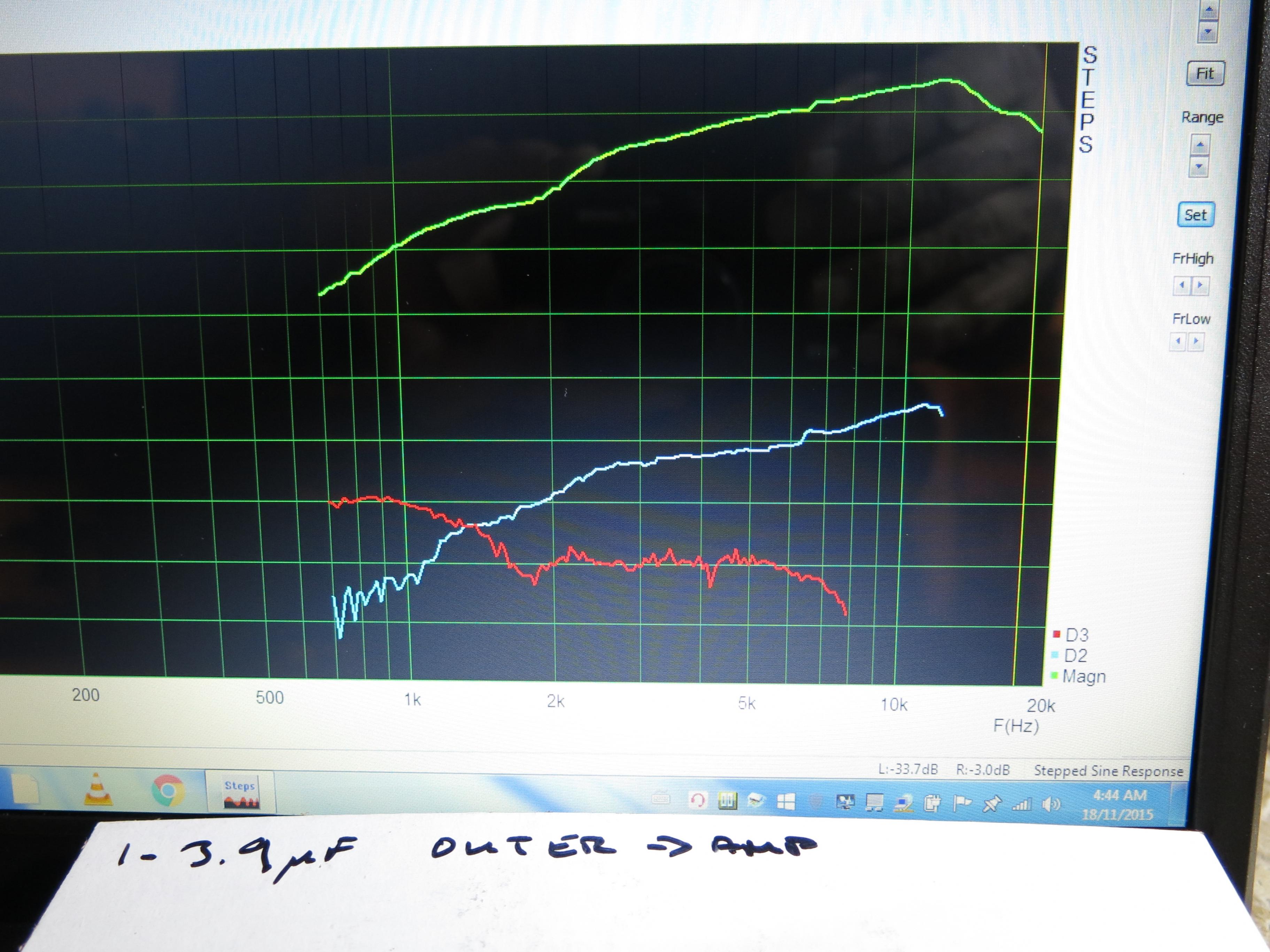

Picture 1) This is a full screen shot. This shows a range from 0dB - 100dB with 10dB increments. A single capacitor, 3.9uF. The outer foil of the capacitor is pointing towards the amplifier. The inner foil proceeds to the tweeter.
The value of 3.9uF is below our ideal of ~4.4uF.
Picture 2) Simply a close up of picture 1.
D3; this distortion stays pretty steady at 20dB. At 5800Hz it drops below the 20dB line.
D2; hits 30dB @ 1800Hz. Rises to 37dB @2700Hz. 40dB @ 6300Hz.

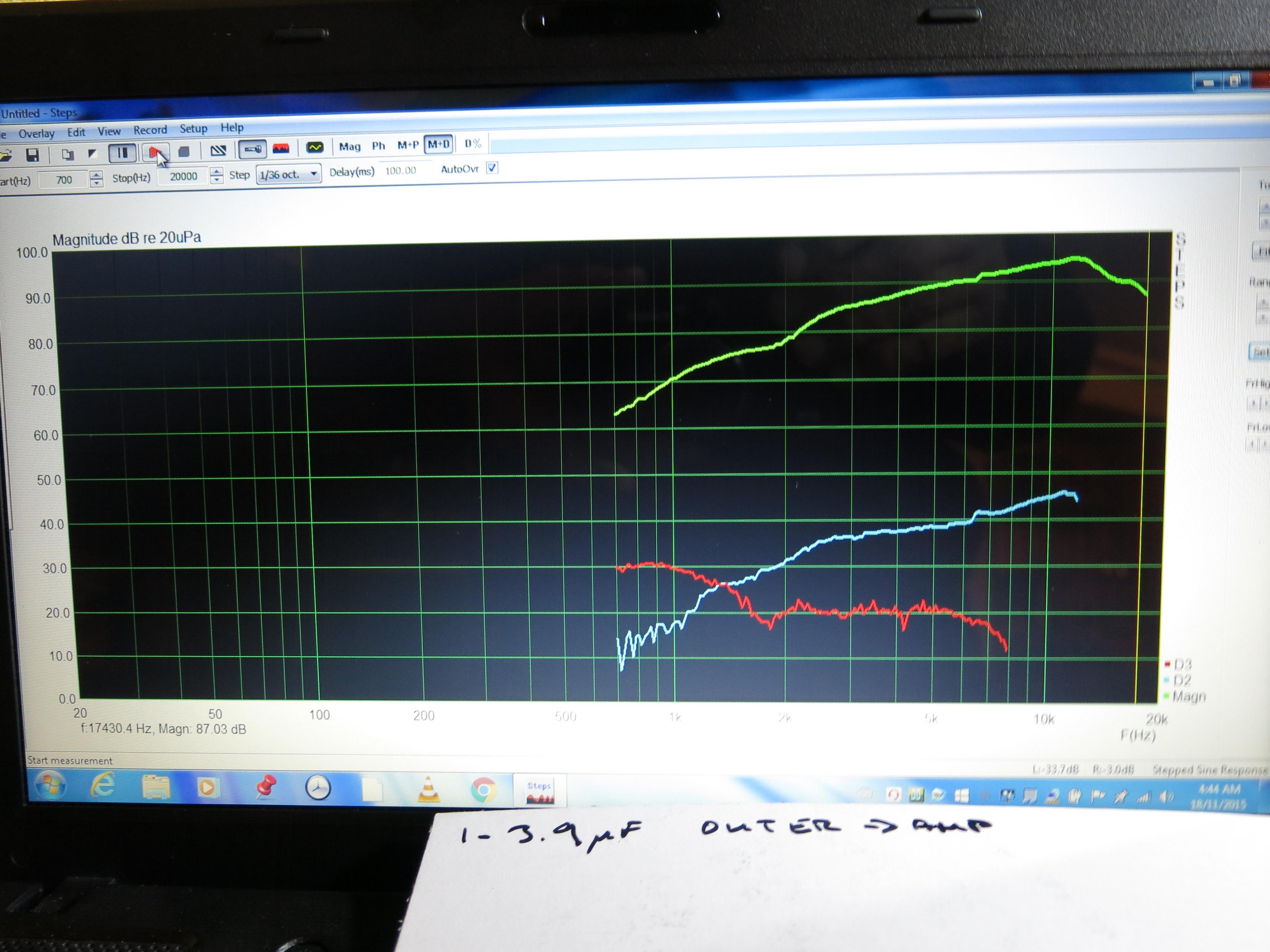

Picture 3) We added our second 3.9uF capacitor to the circuit. There is now a capacitor feeding the positive terminal of the driver, and one feeding the negative terminal. The outer foil of the cap is still pointing towards the amplifier.
D3; 28dB till 1200Hz (not a good start), +8dB. Drops to 20dB for a while, and back up to 27dB. Drops below 20dB @ 4600Hz.
I will postulate capacitors add D3 distortion.
D2; hits 30dB @ 2100Hz (not 1800Hz, therefor better than a single), 37dB @ 4200Hz (also better than at 2700Hz), hits 40dB @ 8000Hz (better by 1700Hz).
I will postulate 'balancing' the signal to the tweeter is better for D2.
Picture 4) We simply turned our two 3.9uF capacitors around. The outer foil is now at the tweeter end, with the inner foil now pointing to the amplifier.
Stories stories stories. I have so many stories.
When I was a young man, I assumed lightning traveled from the clouds to the ground. It wasn't until I was older that I learned the truth. Current 'first' travels from the ground to the clouds (choosing the path of least resistance, so going to a high point first). This happens at the speed of light, but we don't see current. Almost instantly voltage now travels along the path, from the clouds, ignites air molecules, and we now 'see' the return voltage.
Let's talk amplifiers. I use Tube amplifiers. Tube amplifiers are current source's. Current travels out of the amplifier, so keeping with the laws of physics, voltage travels in the opposite direction (away from the driver, and towards the amplifier).
Capacitors are 'voltage' devises. I've read capacitors sound better when the outer foil is where the voltage enters, and the inner foil for the exodus.
D3; no change. Therefore cap orientation does not affect D3.
D2; hits 30dB @ 2300Hz (just slightly better than 2100Hz, but not a big enough difference). Hits 37dB @ 6500Hz (now that's what I'll call an improvement. 2300Hz after 'foil pointing towards amp' did). Passing 40dB @8200.
All testing from this moment forward will have caps orientated so outer foil is at driver end.
This is only for tube amplifiers. If you are using a voltage source (read solid state amp, the outer foil should point towards the amp).

Picture 5) A pair of 4.7uF instead of 3.9uF. We are now slightly above our 4.4uF optimal value. The 3.9uF was a Mundorf Silver Oil. The 4.7uF an inexpensive cap.

Picture 7) multistrand wire.
